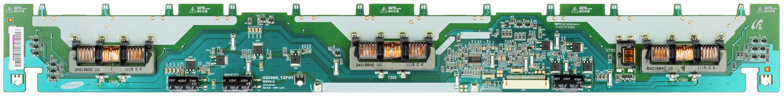

    RCA 46LA45RQ bad inverter board
    I found that my inverter board was causing my tv to shut off right as it tried to power up. The backlight would try to come on and then the tv would shut off. Blue power light stayed on. I checked the outputs of the power supply to be good and then started looking at the transformer coils on the inverter board. It is a Samsung SSi460-12F01 REV0.2 board with Samsung part number LJ97-03319A. This was a later model of the 46LA45RQ with only one lead from the power supply to the inverter board. There are three coils and the top one has melted the top coil of the transformer and when I check continuity it is open. I looked at it under magnification and the copper is in pieces and burnt on one end. All of the other coils check good. I was wanting to know if anyone has found a supplier for the transformer coils or have ever changed one? Transformer has part # 340158AD UO 10CD C K on it.

    Re: RCA 46LA45RQ bad inverter board
    I wasn't able to find a good deal on a new board in the US so I went to ToaBao which is based out of China and got a board and shipping from mainland China for $15 US. That's for the board and shipping combined. I'll have to wait a month before it gets here probably but I will post if it worked out or not.

            Finally got a tracking number from DHL. It is being processed and should ship out of Hong Kong shortly. I found that I had to pay an additional $15 for international shipping. That is the price for up to 1 KG. I found that TaoBao offers putting your parts in a warehouse location if you are buying from several different vendors. Then you can combine all of them and if they weigh under 1 KG it is $15 shipping for all of it. I only needed the one board so I'll know next time. I might order some Gundam toys for the boy just to make the shipping price worth it.
                If either of you are interested in selling your old bad board i am interested.
                As long as it has 1 good transformer 340158AD U0 1187 c k
                Better yet pull the good transformer.
                I did find 2 boards for sale at about $60 and $100+s/h but I wont share that info until i have a plan. Plus the $60 board I am waiting to make sure it is in stock.
                It took a long time to find these 2 that should be in stock. I had to search all 7 model tv's this board is in.
                fyi shopjimmy will repair the board for $60
                I called them to try and buy just the transformer with no luck.
                  currently the best price for this board is at buyqual.com..... $30 plus $20 shipping
                  At least the website is in english and they do respond to emails within a few days.
                  http://www.buyqual.com/ssi460-12f01-...-inverter.html
                  Ordered mine the other day.
                    Sorry for the delay on updates. My board came in but was broken............. snapped off on one end. So I just took the transformer off and put it on my old board. TV is up and running great.
                      So for $30 and a couple of weeks time it wasn't too bad but I'm not likely to buy from TaoBao again.
                          Funny the way it showed up at the house. DHL dropped it off and my wife was home from work to sign for it. I got home and she says "Hey, your parts came in!". She picks up the package to give it to me and the end was flopping around. I knew right away it was dead lol!!

                                    Thanks for the reply. I ended up ordering a replacement board from an ebay seller in China. It came 3 weeks later, and even though it was packaged very well it arrived broken. To the sellers credit, they refunded my money. So I then had a donor board, I used one transformer for the TV I was working on, and I sold the other two transformers on ebay
                                        looks like it is used on Samsung LJ97-03319A and Sony 1-857-986-11
