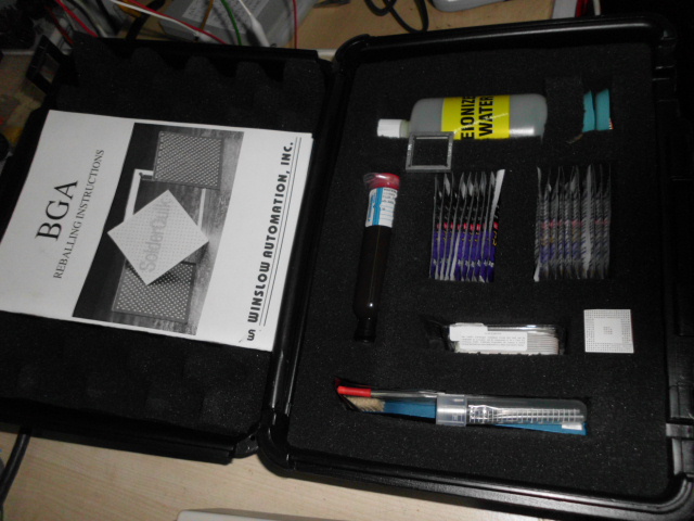

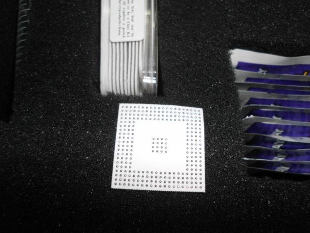

                                This is this is the kit I use to use 15 years ago when re balling had only just been invented so I doubt the makers of this are still in business , the solder balls are mounted in a paper pre form which you just sit on top of the BGA and then re flow, after re flow you just wash away the paper in de ionised water . I bought this in 2001 so I could re use secondhand BGA s as the one I was changing most cost over £69 to buy new.
                                • michael dranfield
                                  • Jan 2016
                                  • 232
                                  • England
                                  Re: TNPH0784 14 Blinks SOS Repair
                                  Sorry forgot to add the photos !
                                    Wow ok thats neat, when I get my own place (currently work from home due to age) I will deffo be investing in alot of equipment like that, and deffo a bga station as have a few xboxs and this mobo to do as well
