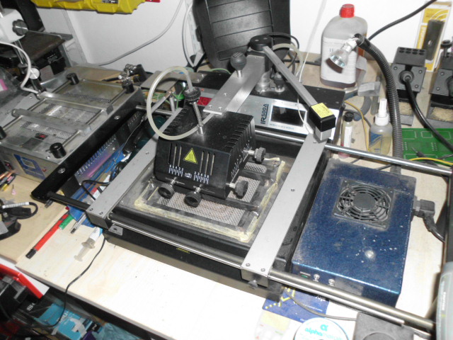

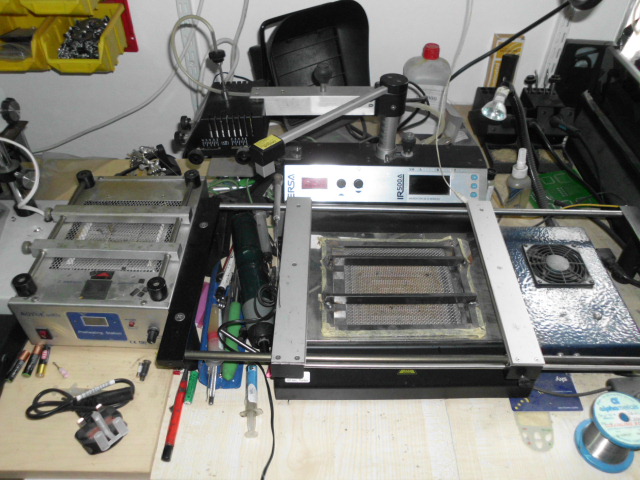

      I could do with investing in a bga station too that kit does look good imo as have 3 xbox 360s here to look at asap.
      Peanuts now , have a look on e bay , you can buy Chinese station for less than £300 , this kit cost me over £4,700 when I bought it 15 years ago.
