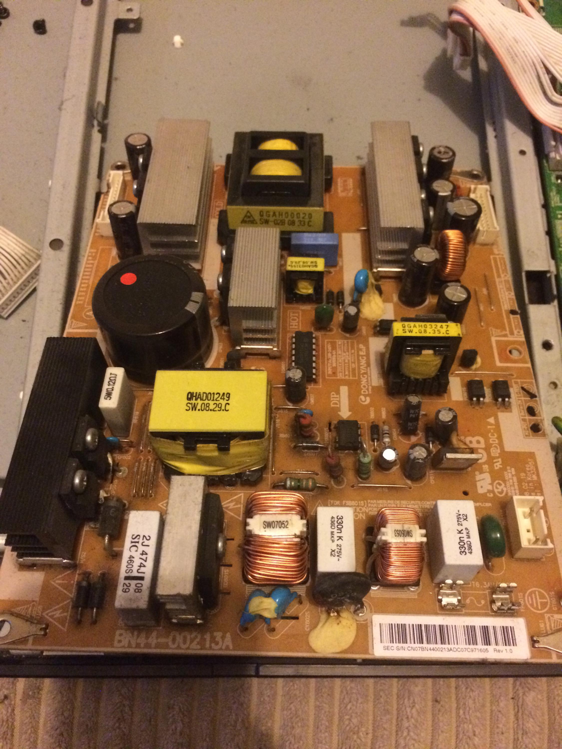

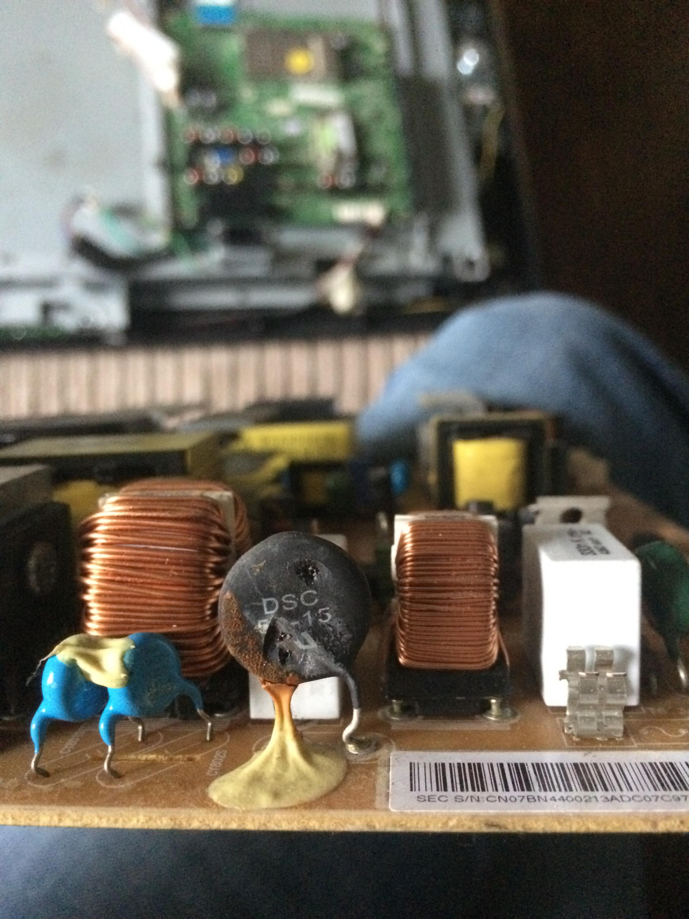

    I have a samsung 32" lcd tv that has recently blown the internal fuse. I've taken the back off to inspect the board for any obvious component failure and found what looks like a blown ceramic capacitor (pictured) How would i go about finding the specifications of this component to replace it and are there any other components i should replace besides this and the fuse?
    The power board in question is BN44-00213A. If wanted i can post full board pictures front and back.

    this thread has a pdf of the power supply it looks like a thermistor to me im sure a more experienced member will comfirm also if the board has anymore of that brown glue on it remove as much as you can as it can cause issues over time

      I think its a (NT811S) DSC 5D15 thermistor

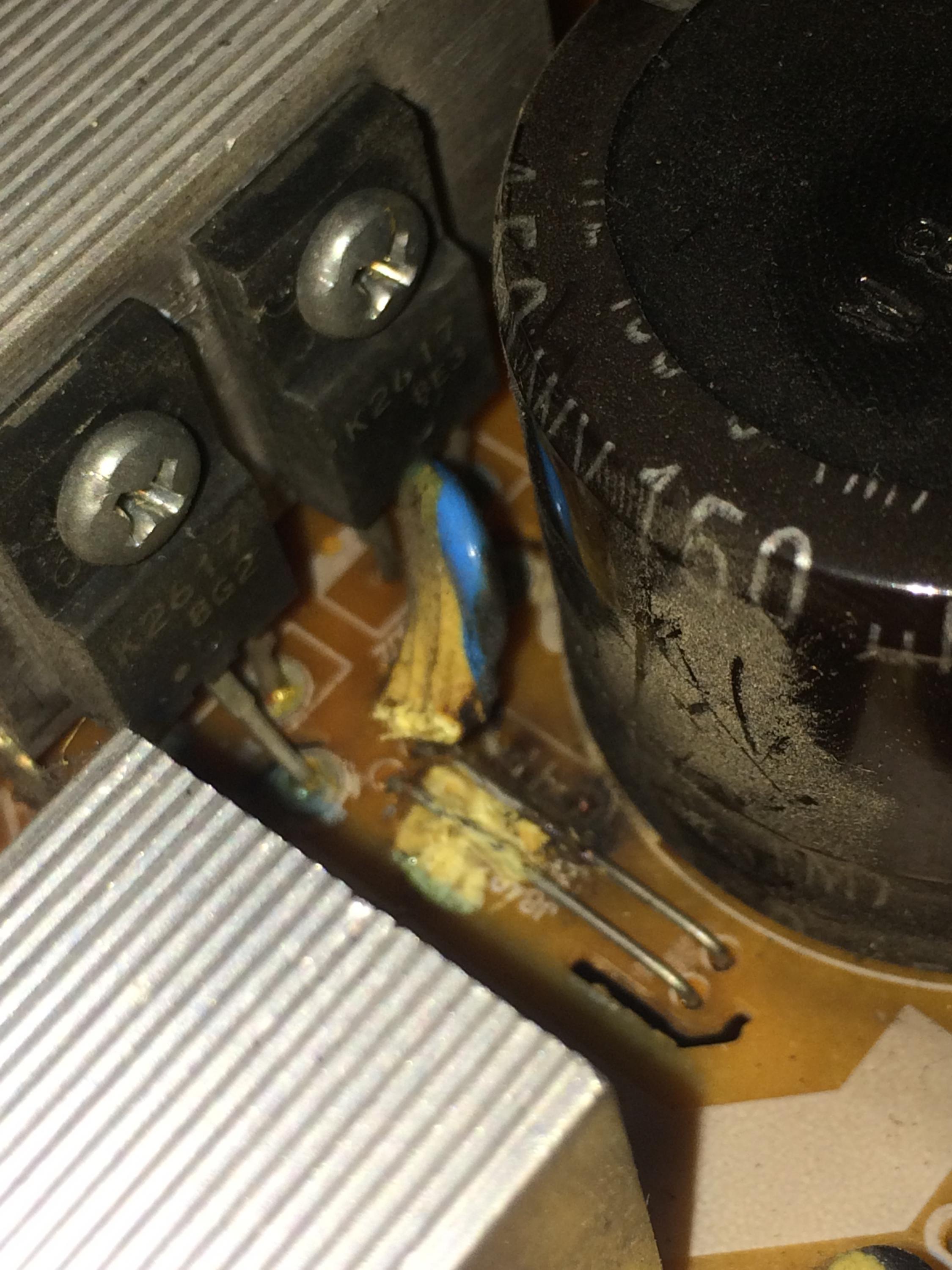

      but i would firstly remove all the bad glue from the board and components this becomes conductive after a while
      also check mosfets QM801 and 802

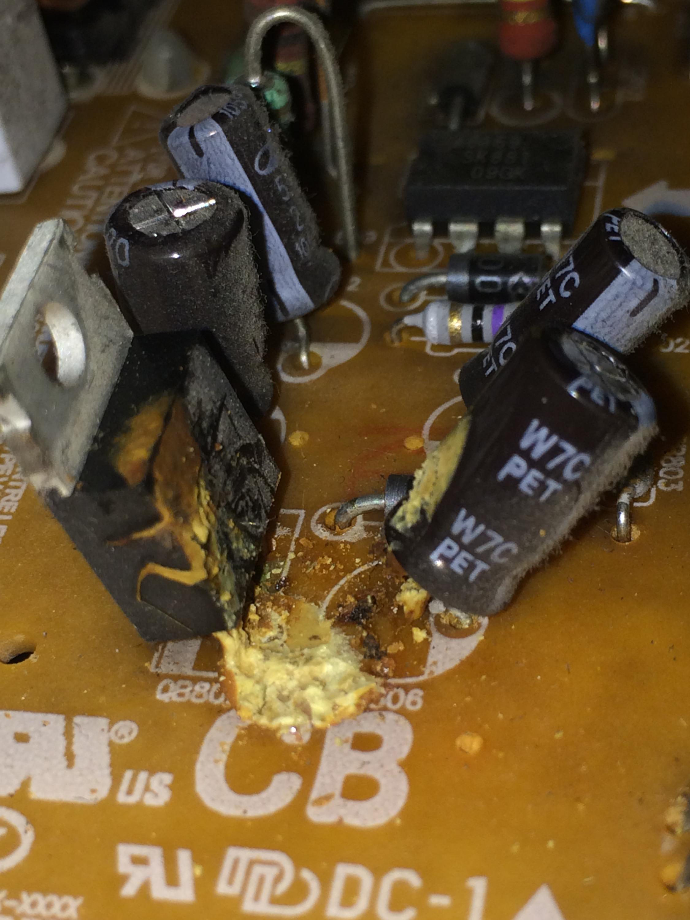

        I took your advice and checked all of the areas with glue and just as you said the glue has become conductive and caused several shorts!!! I think this board is toast

          Yep conductive glue and failed solder joints on these cause the thermistor to explode. Check the solder joints and remove that glue buddy.

              A quick look on the net and it does not look as though there are cheap replacements, so I would be thinking about repairing it yourself following ReeceyBurger123's advice.

                I have the same thing on my Samsung TV I just checked it out blown fuse and a blown thermistor my identifying numbers are DSC 5D-15 U406, which you have any idea where would be the best place to get replacement parts? I want to take a moment to say thank you for everyone on this forum this is my first time here and I find it quite interesting and informative. I am pleased to know that there are people out there who will not hesitate to share problems and their advice!
                Thank you to all and I hope you all had a Merry Christmas
                  Re: Samsung LE32A330J1 Blown internal fuse
                  DSC 5D-15
                  5 Ohms @25c 15mm dia.
                  http://www.dscelec.co.kr/k-products-2-5.htm
                  http://www.dscelec.co.kr/e-products2...9360cd13f9ce93
                  http://www.digikey.com/product-detai...158-ND/4862348
                  Better check for shorted loads first.
