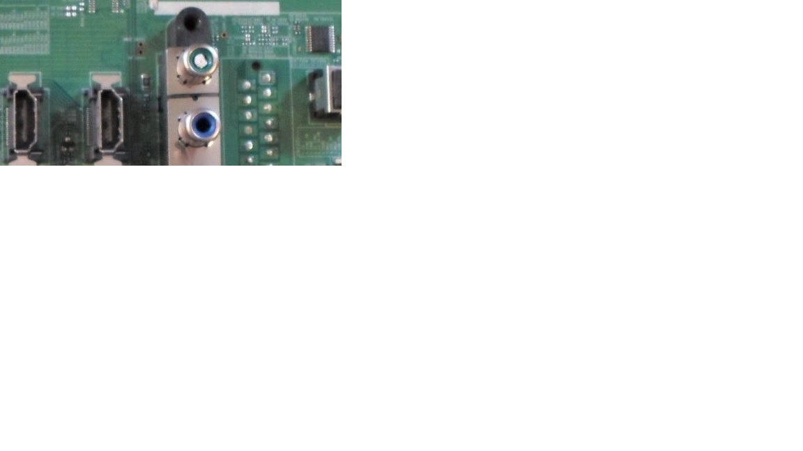

    Removing Broken Component Cable Pin
    I have a main board that has a pin from a component cable broken off inside the port. Any tips on removing this safely?
    • 31283
    Re: Removing Broken Component Cable Pin
    not without a foto
    • kevinm34232
      • May 2012
      • 1884
      OK then...
      • tw2005
        • Oct 2011
        • 6458
        maybe you could get a couple of fine jewellers flat blades either side and lever it up
        or see if that pin will take solder, solder some wire to it and pull it out
        • kevinm34232
          • May 2012
          • 1884
          OK I can try that thx. I don't have the board in front of me but wondering how hard to get to it from underneath.
            • 31283
            show the bottom of the board there - if the solder hole is big enough you may be able to suck the solder out and push a needle up past the solder-pin into the socket.
