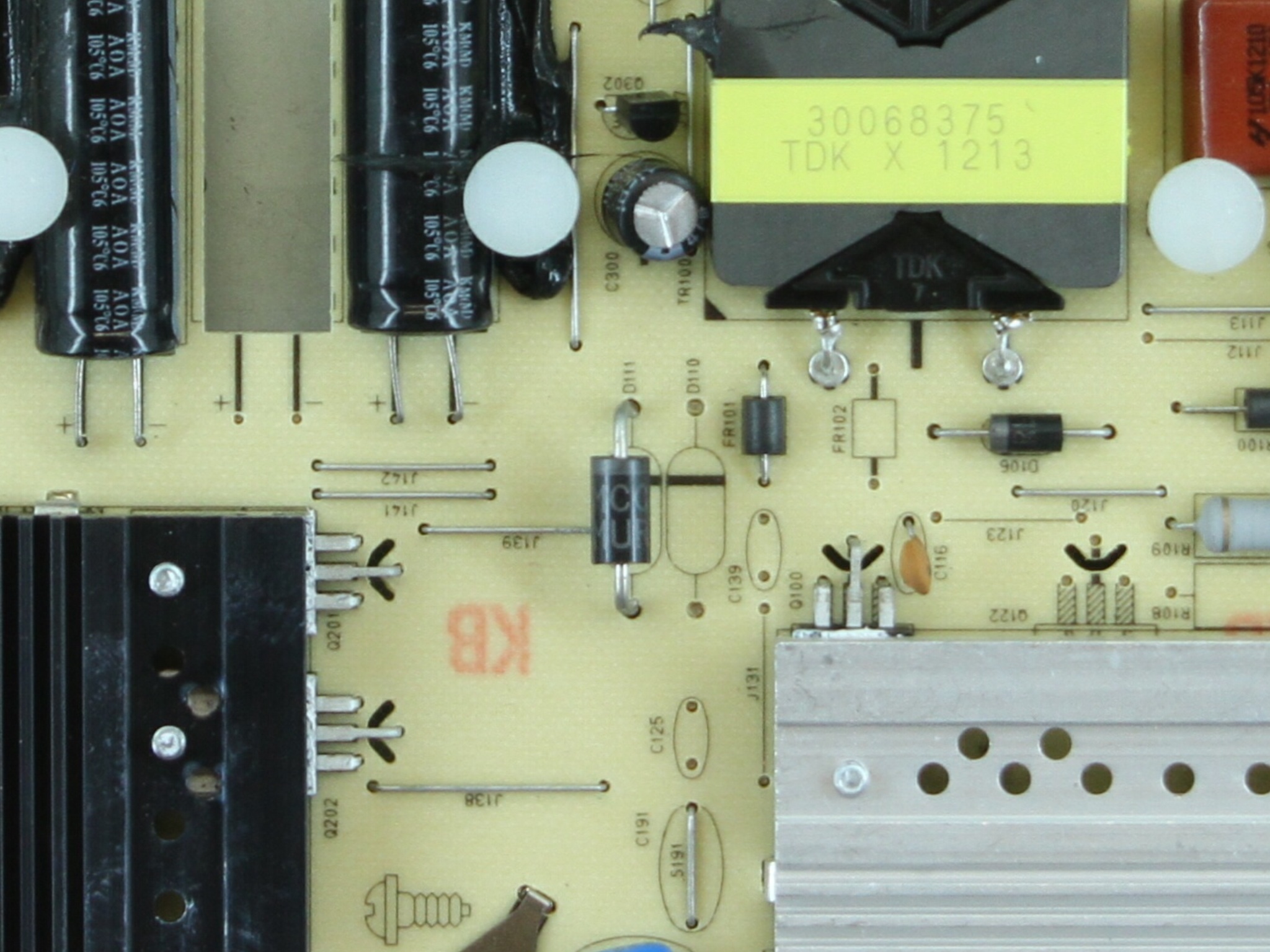

    There is a diode near the filter caps its large check if for reading both ways out of circuit ! It tends to not fail shorted on these but leaky. The diode is normally a Mur460

      Re: Finlux LED 32.7 CTS turns on and off in cycles when plugged in
      This is the diode, check out of circuit.
        I have checked it already, the measured resistance of all the diodes of the PSU is in my opening post.
        This was the first thing i tested, current flew only in one direction, the resistance in the right direction was measured at 484.
        I forgot to say that all the measurements were made with one leg out of the circuit.
          Let me rephrase that, you need to check this one out of circuit mate. If its good I will tell you what to do next.
            I have already checked that diode out of circuit, it seems okay.
