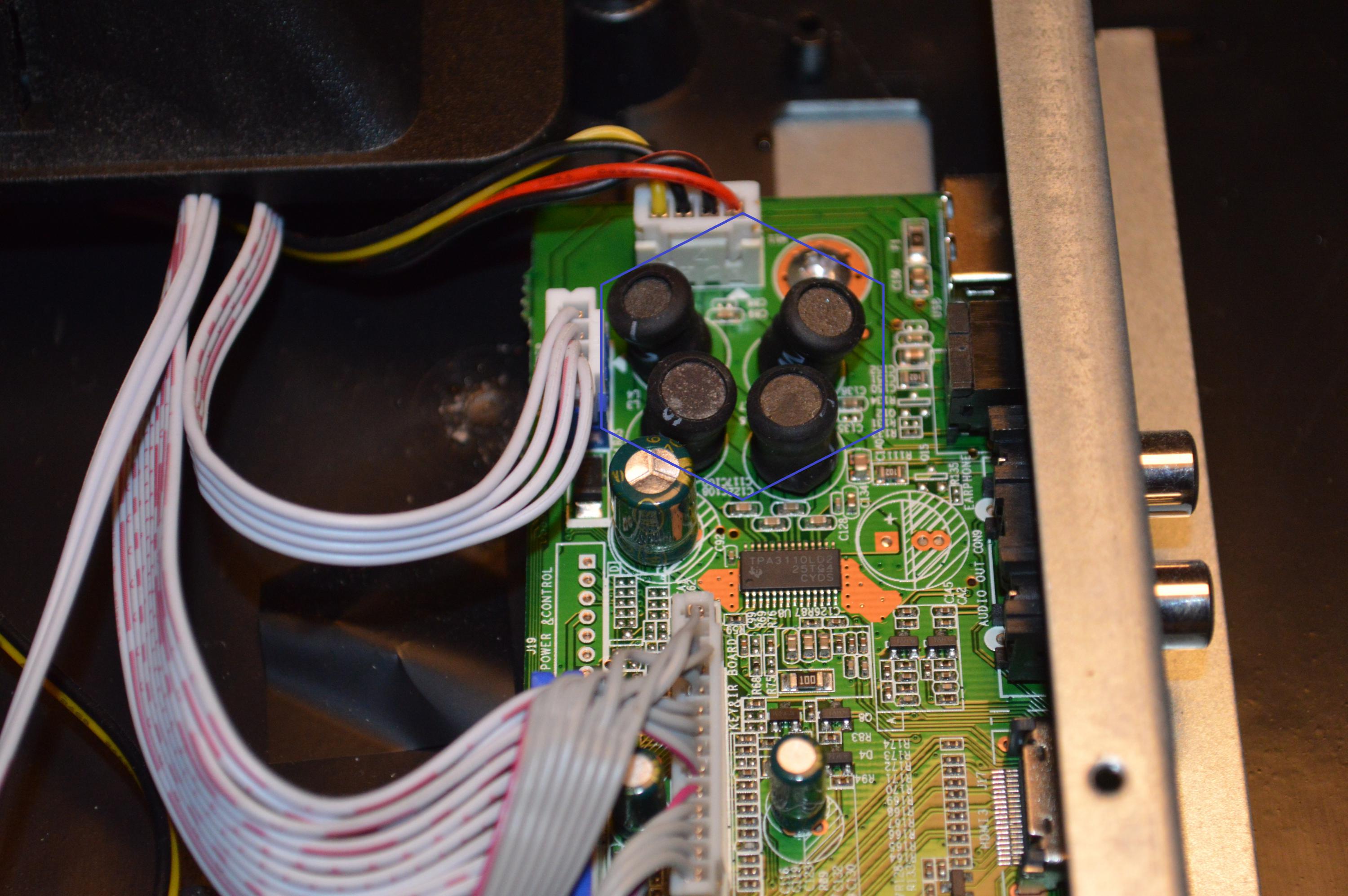

    Noob member here, I would appreciate any help you might be able to dispense.
    My 32" RCA TV is acting up. I use this as a spare and it's connected to an antenna, I get a dozen decent HD channels.
    The TV turns on and works on one channel. I can't change anything, not the volume, not the channel, not the input selection, no mute, nothing. Neither the remote nor the side panel buttons do anything. Occasionally it turns itself off after about five minutes.
    Model RLDED3258A-B

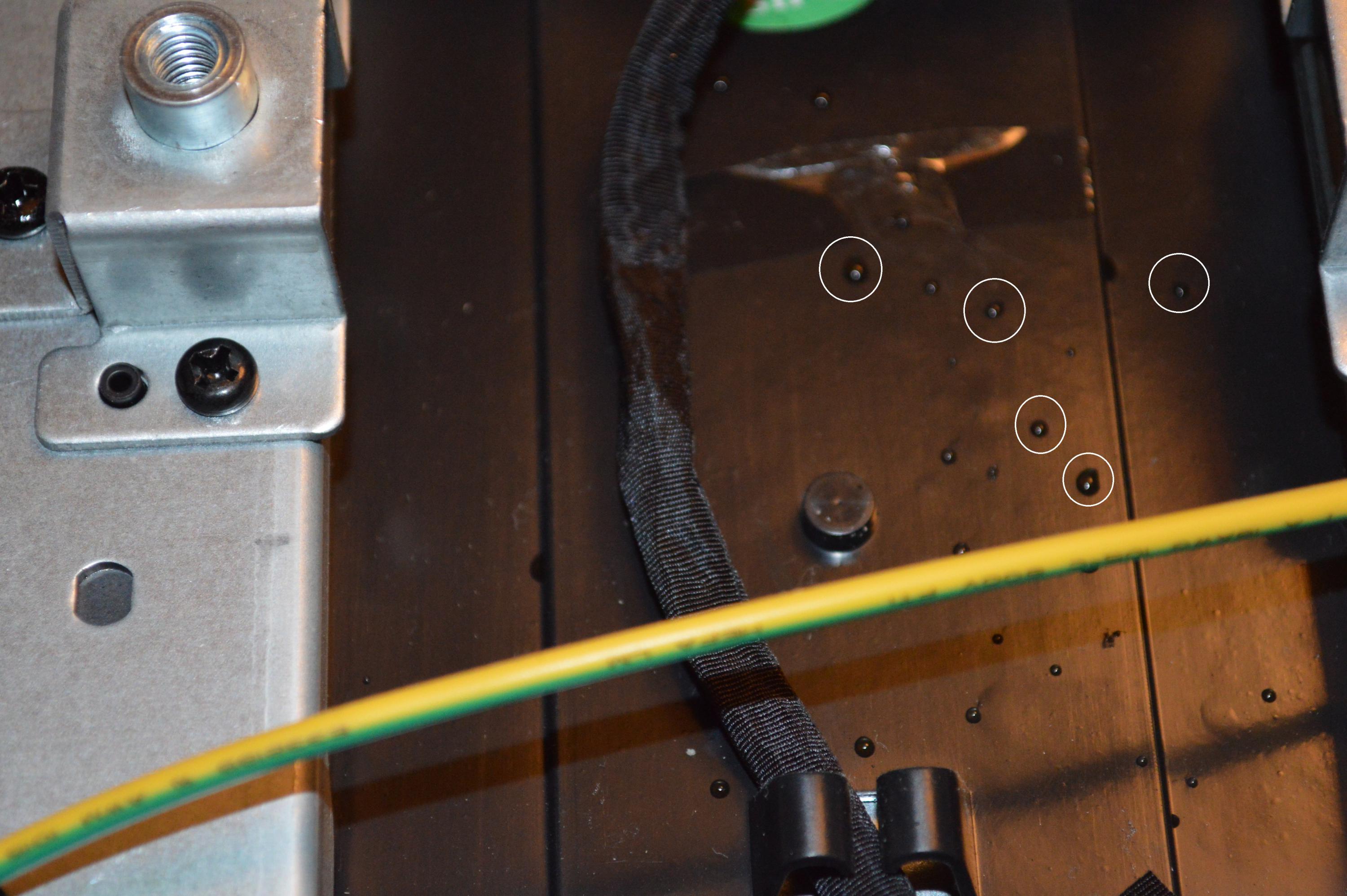

    When I opened it up, four capacitors have blown up on the CV318H-K board, there are oil drops inside the TV and on the perimeter.
    My problem is the caps that blew up have no info on them, so I don't know what to replace them with...

    I just peeled the cover off, they are inductors, I suspect they fine.

      Re: RCA Capacitors Failed - What Size To Buy?
      Those arnt capacitors they are coils, they wont normally ever fail.

              BTW, those 4 inductors are the output filters for the Class D Audio power amplifiers IC TPA3110 which drives the speakers, nothing to do with the problem you have. Main board problem.

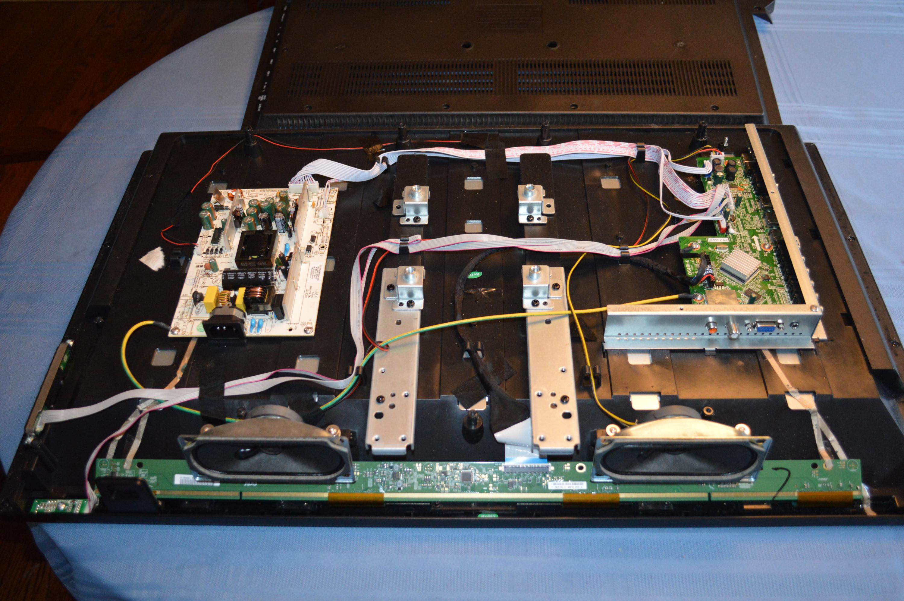

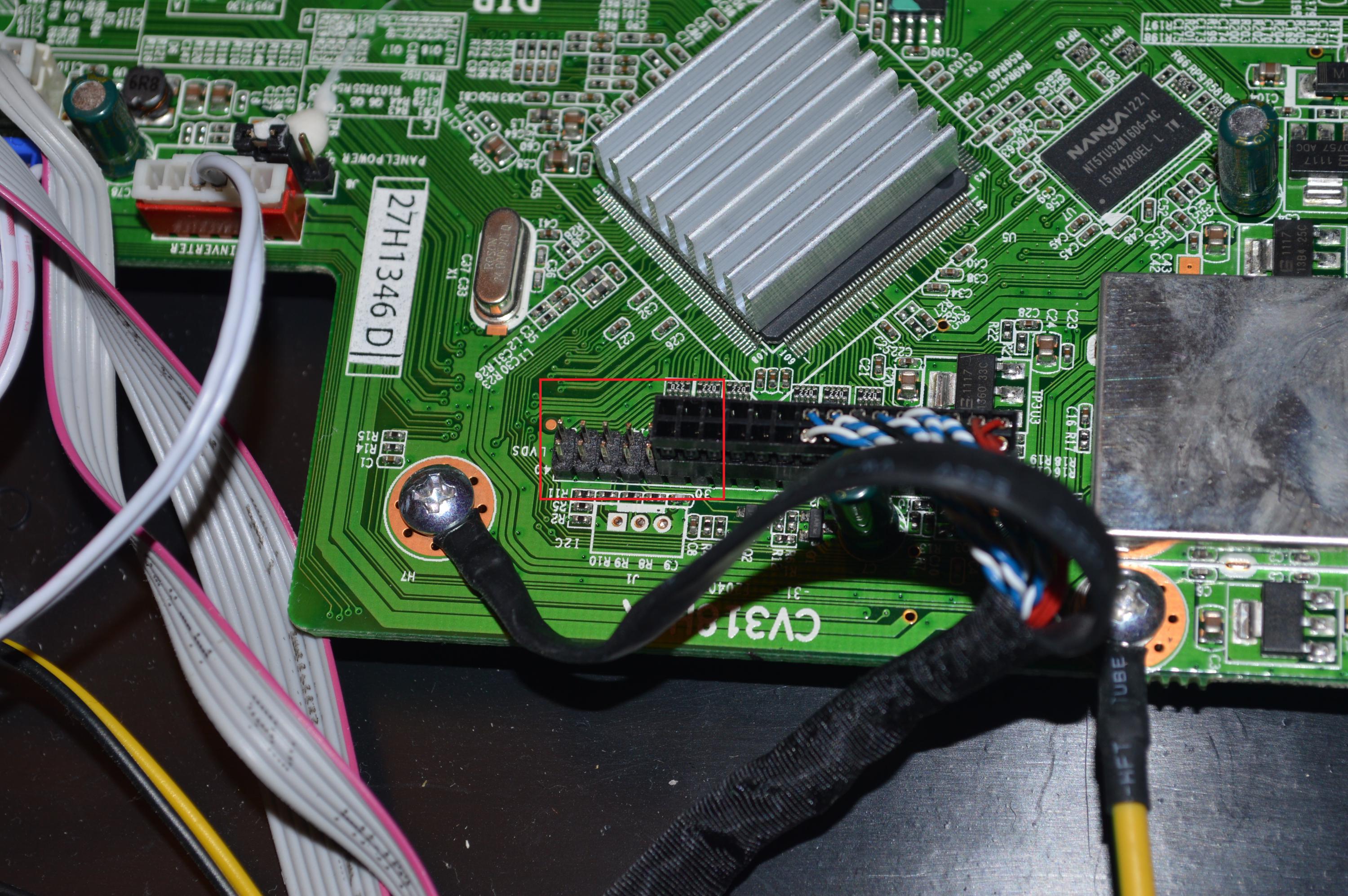

                          So here is the 'entire' TV. I had a good look at the circuit boards on both sides, no burnt marks, no signs of failed capacitors.
                          Re-assembling the board I removed I realized one of the connectors was not keyed and can fit in multiple positions, so, yes, I'm an idiot. I need to sort that out before I power the TV up again...

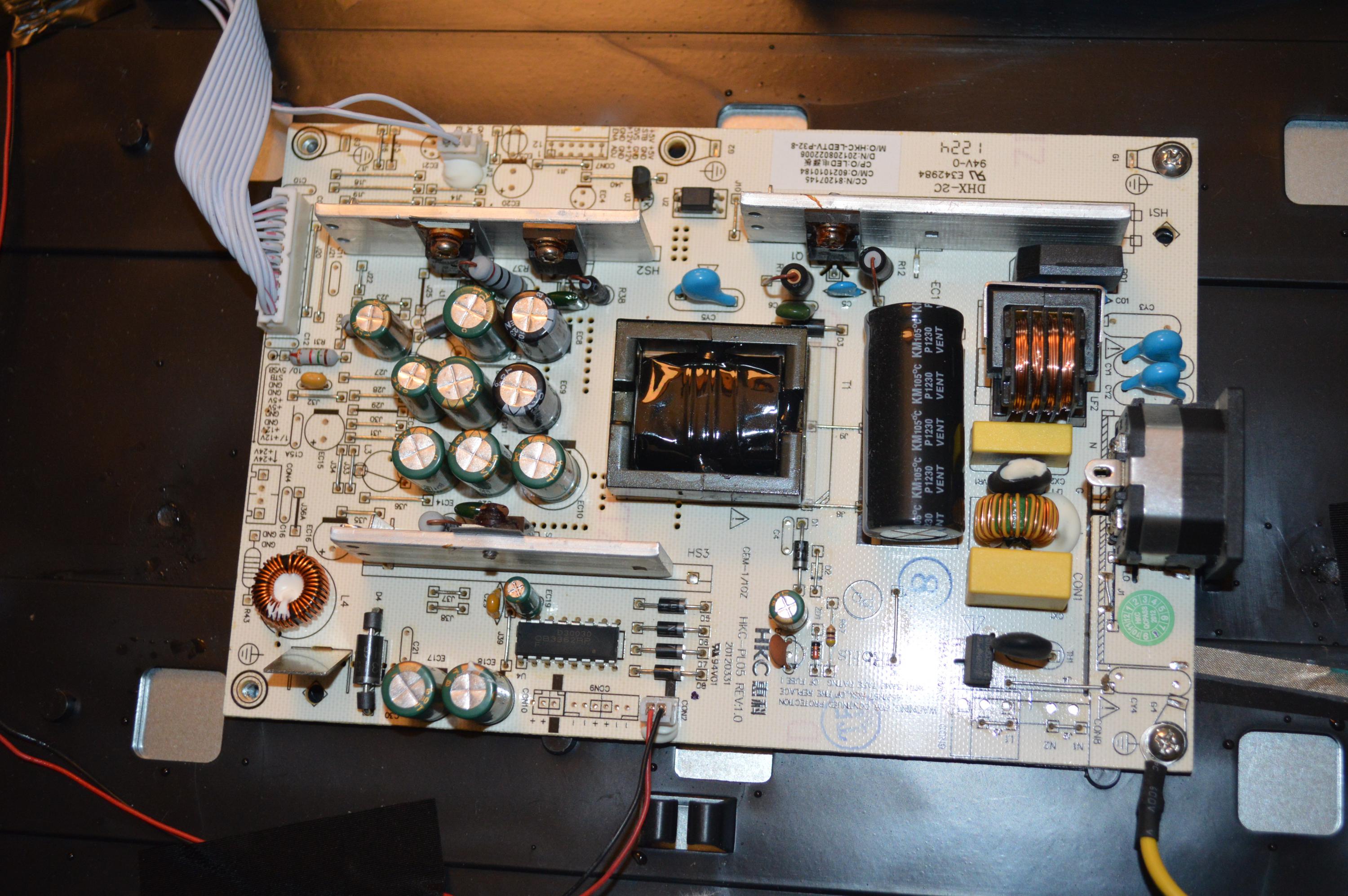

                            You need to replace the capacitors on your Power Supply board.
                            It looks like yours has Capxon KF and KG series which are known defective series. Please post a list here of the capacitors in the following format:
                            1) Voltage, Capacitance, Diameter (width x height), Series
                            ...and someone should get back to you with a list of replacements.

                                First problem, I think this is the correct location for the plug, but since it's not keyed (and I was too dumb to notice)...
                                Any suggestions how to confirm I have this right?
                                I need to sort this out to power the TV up and measure the voltages.
                                  The caps are
                                  470uF 15V
                                  56uF 100V
                                  680uF 25V
                                  470uF 25V
                                  470uF 35V
                                  None of these have any visual signs of failure. But then again, 'something' distributed an oily residue inside my TV.

                                    Which does sound like a PSU capacitor problem. You're right though that the other symptoms could be indicative of something else.
                                    Originally posted by PBH
                                    The caps are ...
                                    Please follow the instructions.
                                    As for the caps not showing actual signs of failure, CapXon don't necessarily always bloat when something is wrong.
