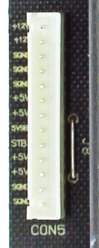

        Re: Apex LD4088 Wont Turn on & No Standby Light
        OKay, I got it on the bench today and tested a few things. I dont see any visible bad caps. Noticed it does have an on/off rocker switch on the back, but that did not change anything. It still does nothing in any state. I unplugged the inverter and tried it in all states, didnt get any change. I unplugged the connector and tested the pinouts, I get nothing on STB and nothing on any of them for that matter except I get a 5v out of 5VSB (see pic ) I dont really know what that one is unless it stands for SOund Board 5V. ANyway let me know what you think.
        http://imageshack.com/a/img633/3423/oT4BbK.png

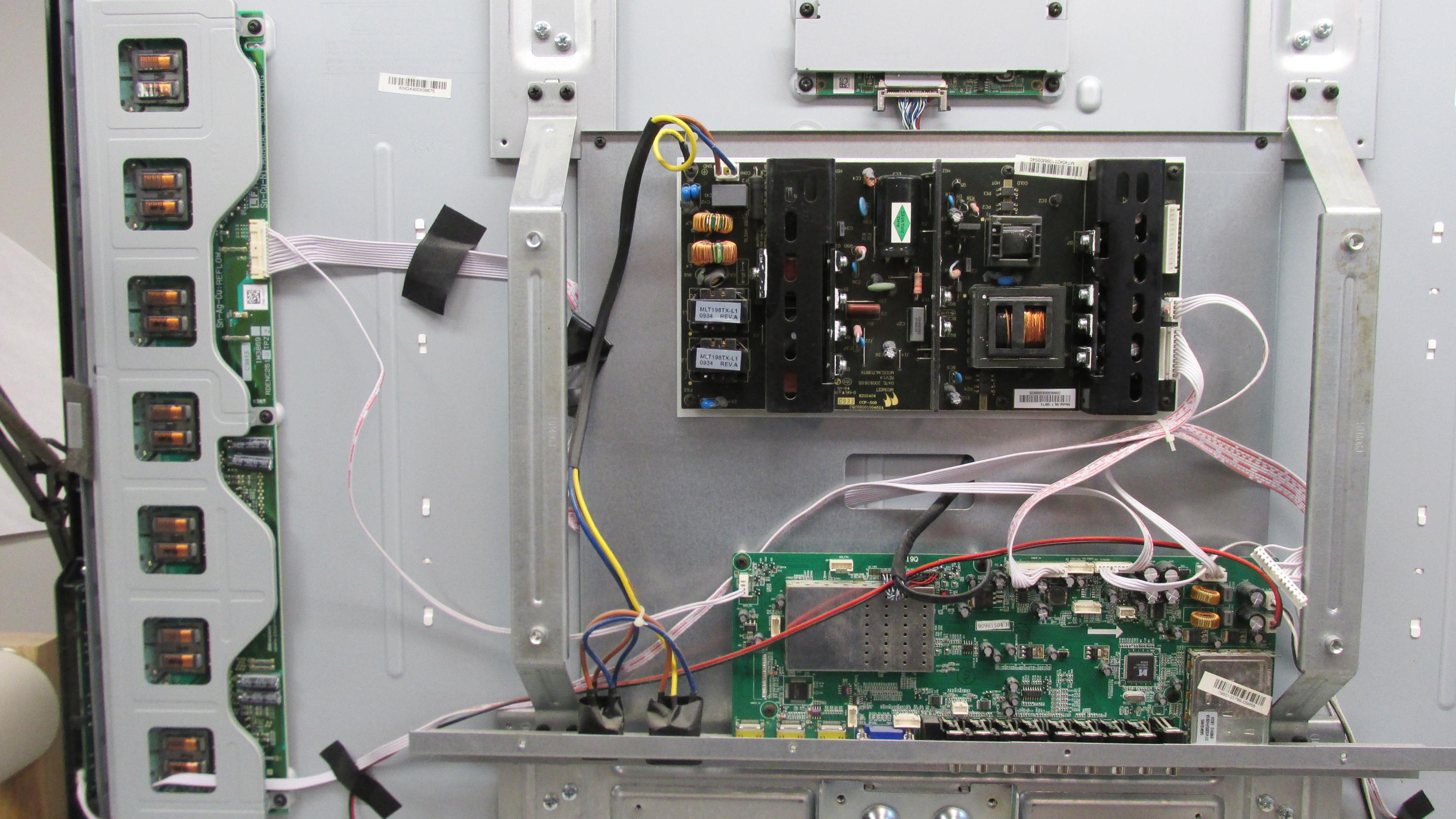

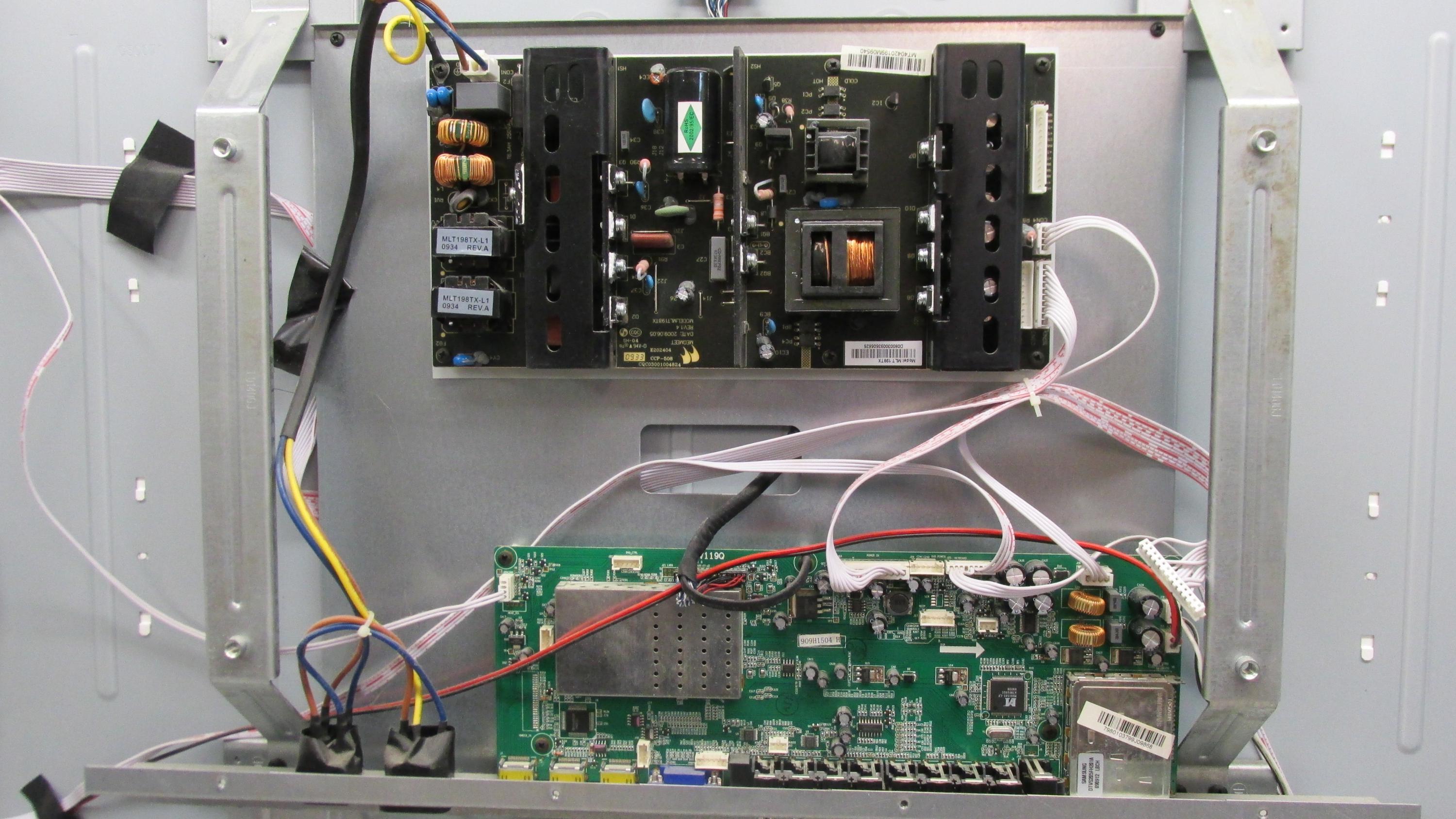

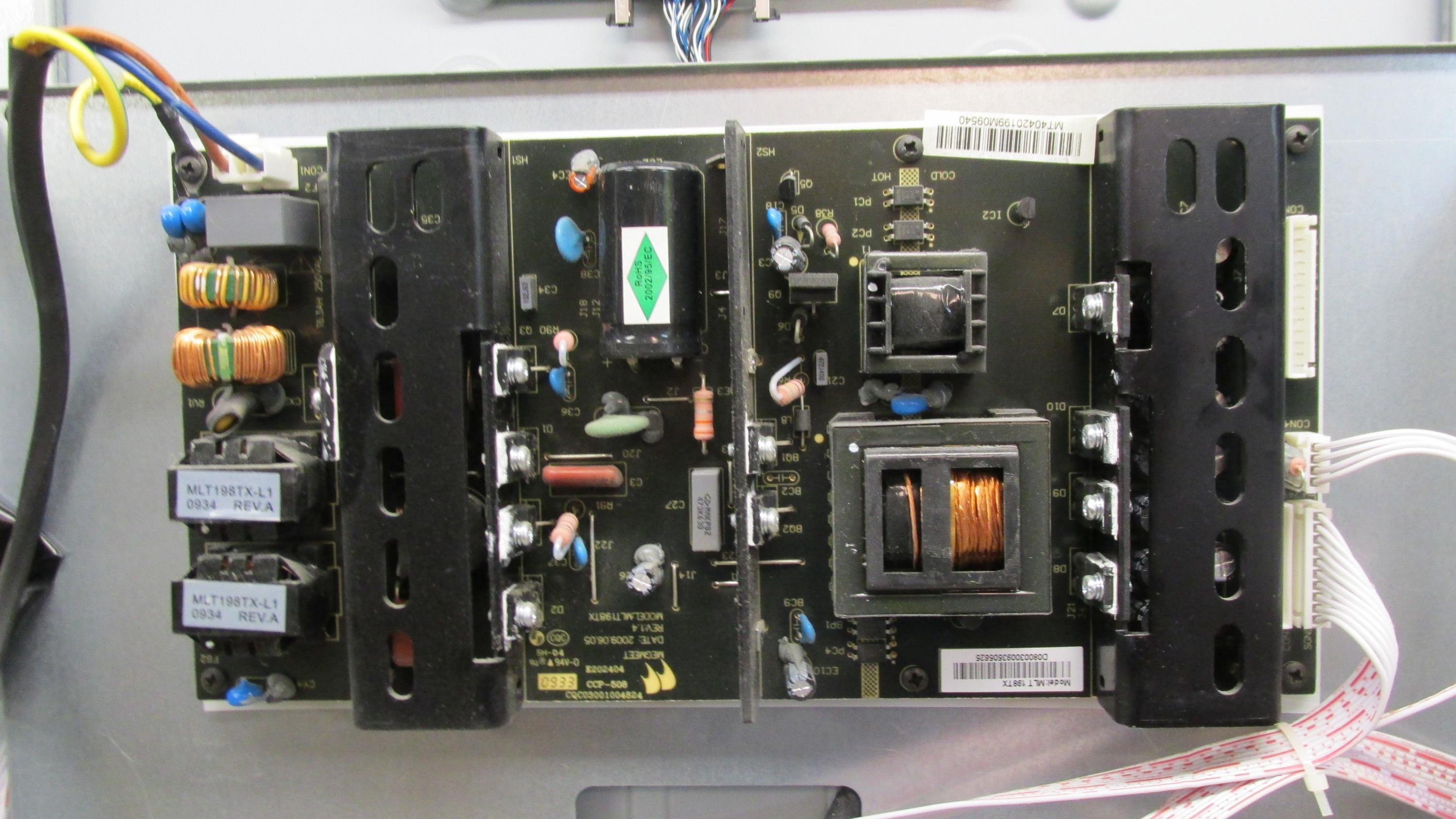

          Can we get good clear pictures of the whole boards, the whole back side of the TV so we can see how all the boards are connected together?
          • rebelkustoms
            • Sep 2015
            • 150
            Here are some pics of the board setup
