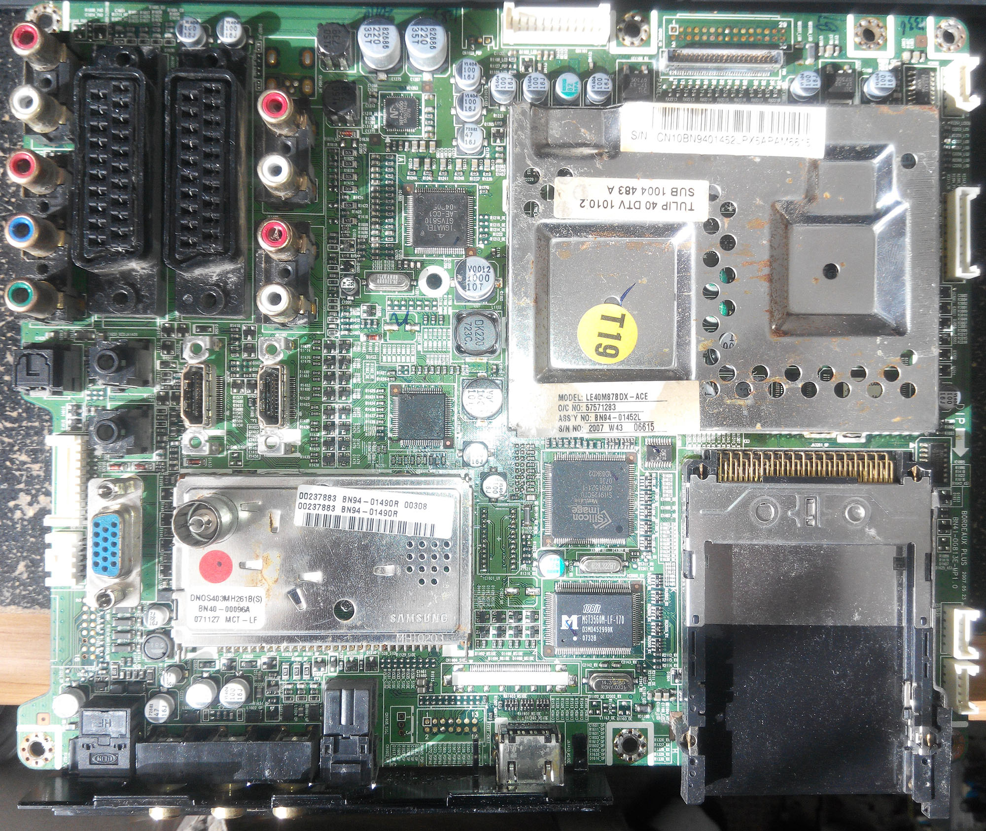

    As I have said in title TV relay is clicking.
    Opened back, someone have tried to resolder caps on BN44-00167A power supply board. So I have just installed known good BN44-00167A board and TV still clicking. Then taken out BN41-00813E mainboard and replaced eeprom with blank chip. Installed back to TV. 1 click and after 15 seconds back into usual clicking.
    Where is a problem, I have already 2nd mainboard exactly the same?

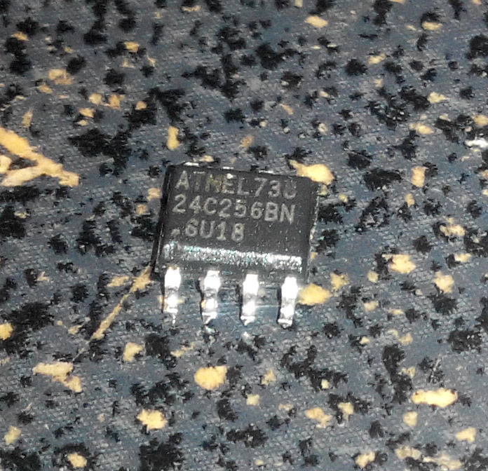

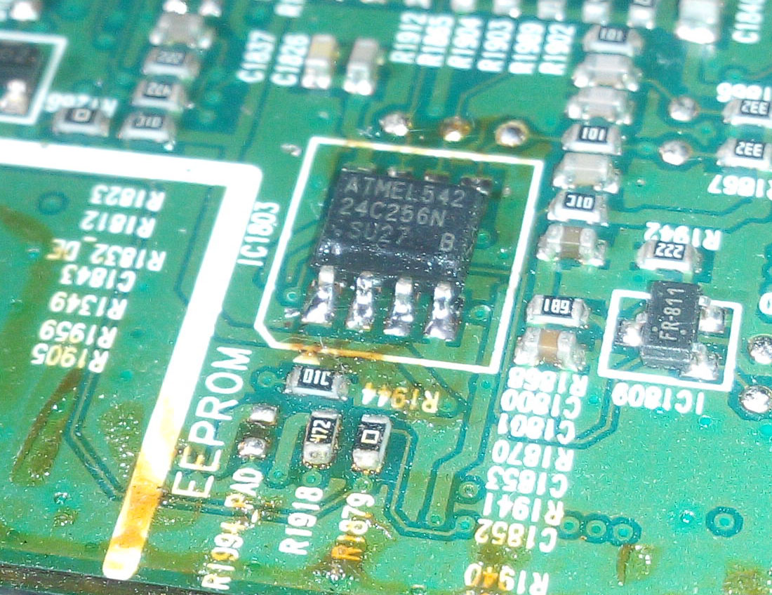

    First photo original eeprom
    Second photo empty eeprom

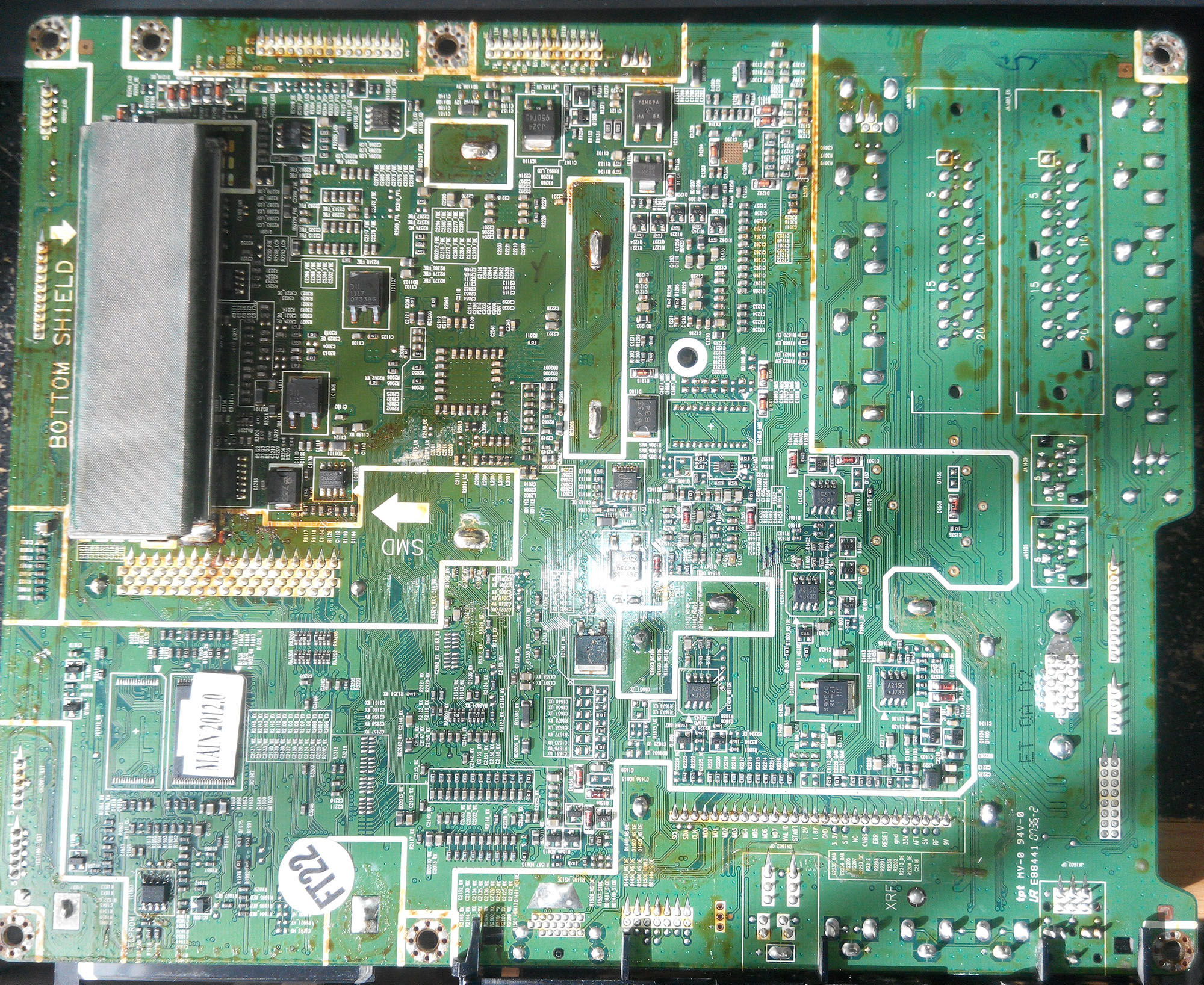

    Third photo BN41-00813E Bottom
    Fourth photo BN41-00813E Top
    Am I doing something wrong?

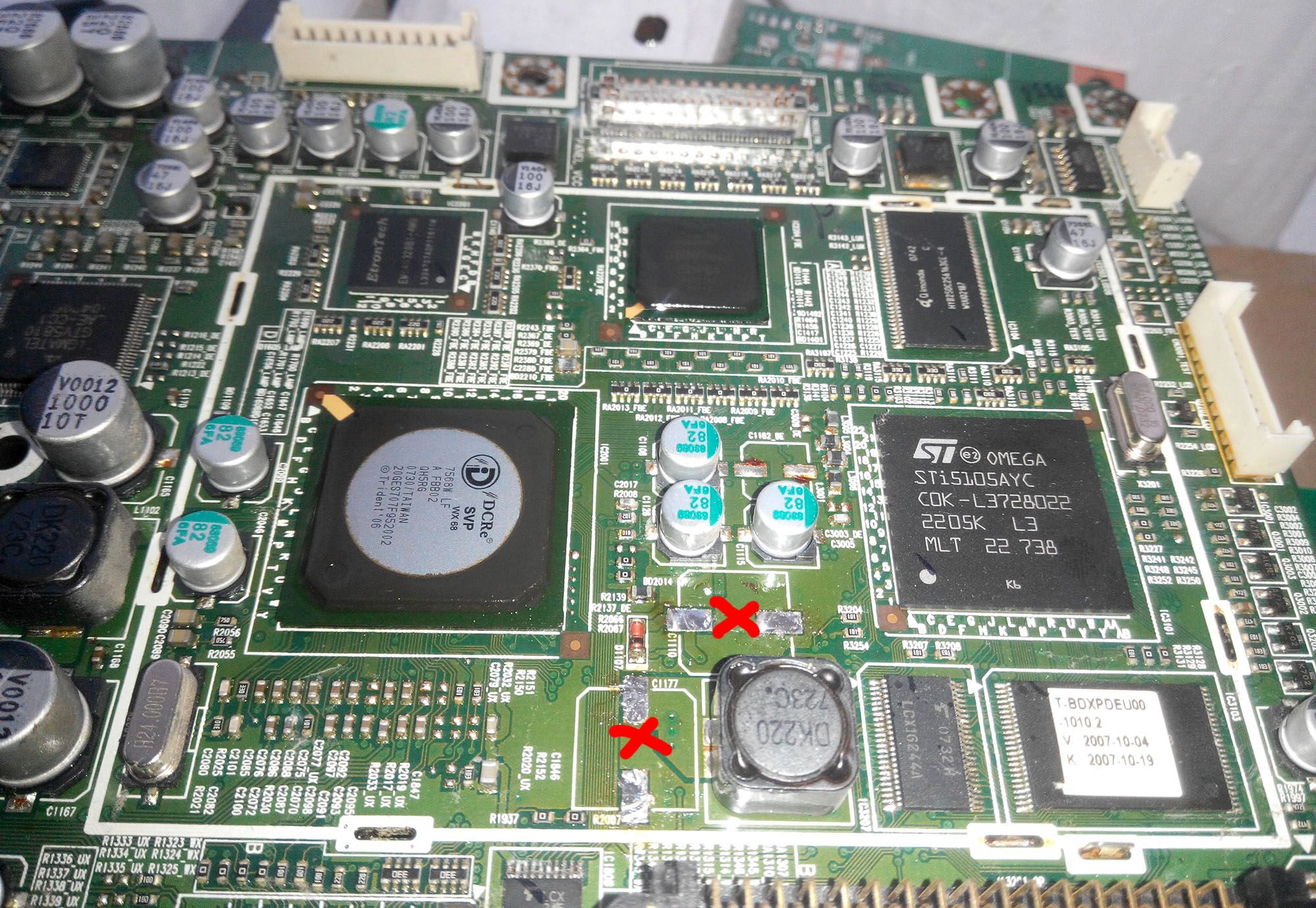

    i have had a problem with these model tvs not turning on, and found though this forum that there are 2 SM caps under the shield on the main board that needed replaceing,
    think it was 100uf, tv is now fine with no probs.

      I will try to remove shield. Will check caps this evening. Are you talking about those bigger ones next to BGA chip?

        yes, just replace them 2, thay are a bit of a prob to remove so be carefull, i have pulled the tabs before,
        i replaced with normal caps and layed them down so the shield would still fit

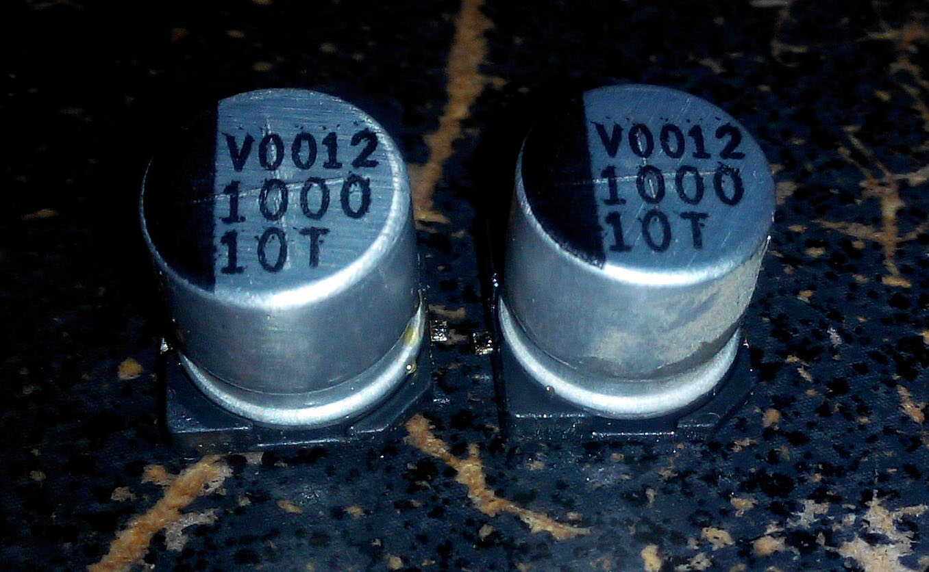

          Finally I have manage to remove cover. Removed caps. I imagine they are 10V 1000uf. One measuring 960uf the other one measuring 910uf. I will try to replace them.
          I am wondering could I try mainboard without metal cover? I know that this is as heat sink, but how hot are those two BGA chips?

              I have removed two big caps underneath of cover on top of them says V0012 1000 10T. I imagine this is 10V 1000uf capacitor see photo. The other photo of the space where metal cover was. I have highlighted places with red cross where capacitors were.
              Unless I have removed wrong ones. There are only one that looks like 100uf, one is 47uf and others are 82uf.

                Re: Still clicking after replacing eeprom Samsung LE40M87BDX
                They look big so you probably correct that they are 1000uF (some cap companies will use 1001 = 1000uF), 101 = 100uF, 100 = 10uF) since you verify with cap meter.
                They are part of switching power supply. Do you have ESR meter?
                Did you also try heating up that section under the shield to see if the TV will function mormally?

                  yes,those caps are quite often faulty.Another problem that can also arise with those is a loud crackling through the speakers as it tries to start up.
                  Becoming increasingly common,it also seems the solder cracks underneath the dtv processing ic,also under the screening tin,causing the same issue of clicking,usually as the set is warming up.

                      Update. Replaced those two capacitors with 10V 1000uf. TV turns on. No clicking. Will do more testing now.
                        Great! The old caps are still within 20% tolerance so they probably have high ESR.
