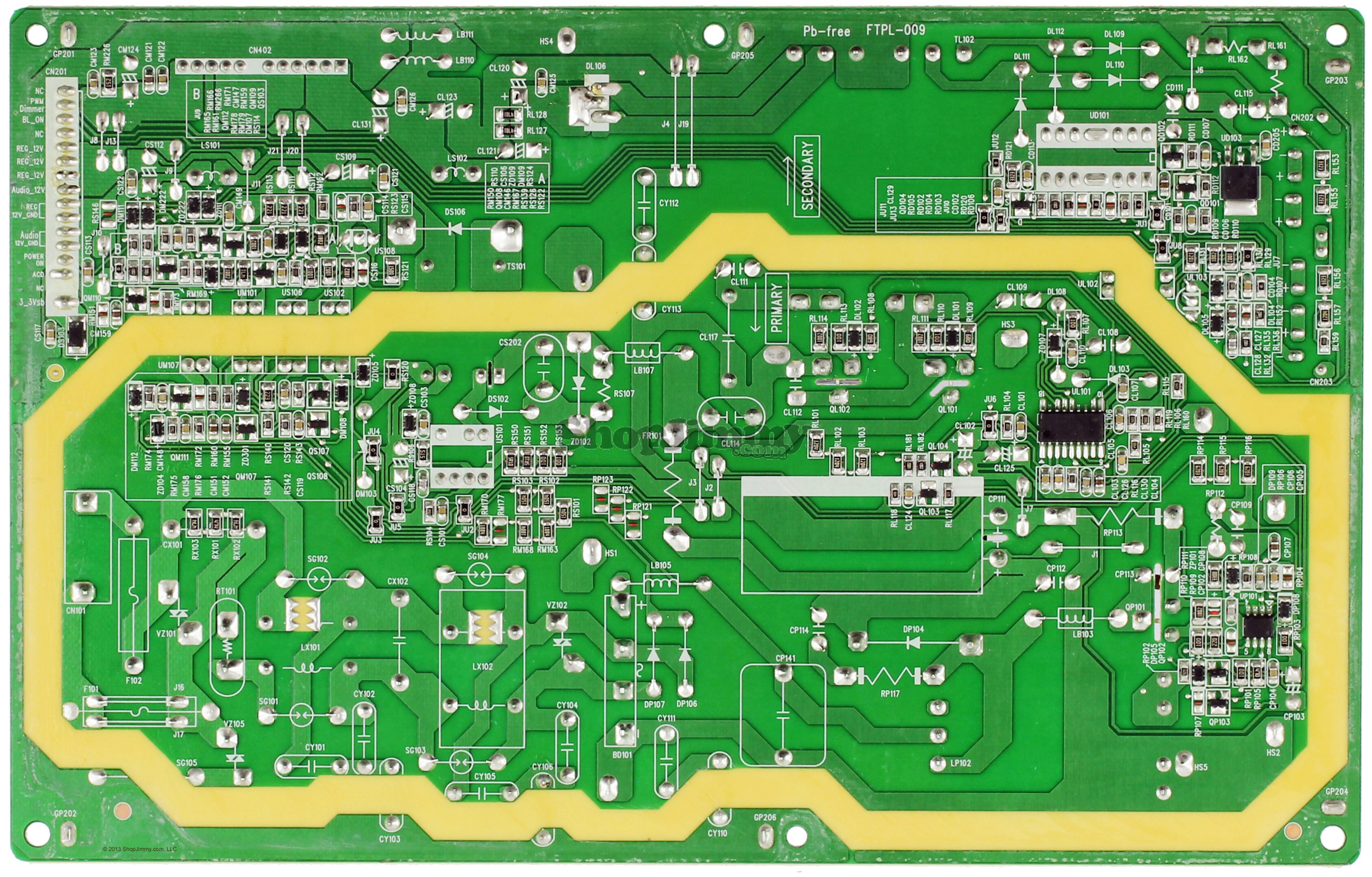

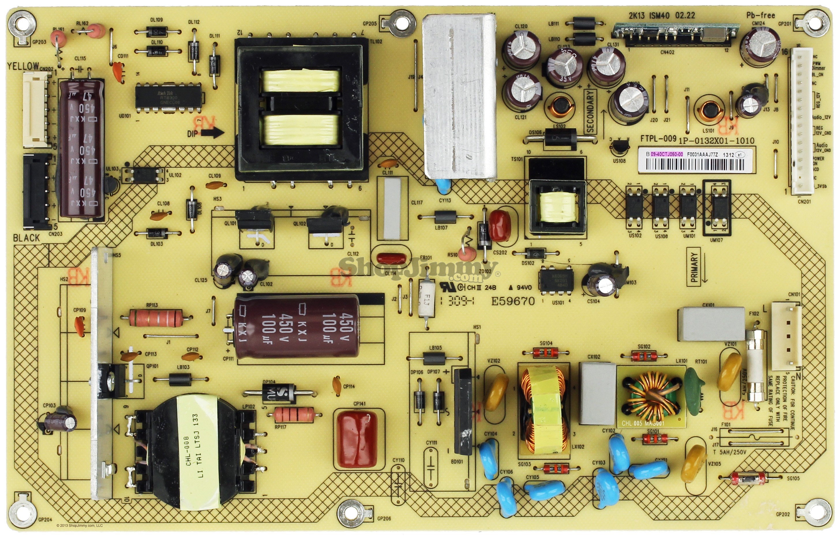

        Re: Sharp LC-40LE550U no backlight
        If you look at the LED connectors in deatails, you can see that the LED strips are connected in series to form ONE long LED string, if ypu look at the bottom side of the power supply board where the LED connector CN202 PIN 1 (+) is connected to the LED power supply filter cap CL115 positive leg, the pin 1 of CN202 goes to the first LED string ANODE, the negative return goes to CN202 PIN 2 (-) this (-) is then connected to the Anode (CN202 pin 3) of next LED string, and on and on to the fifth string.
        So as you can see, the LED connectors are terminated as series connections for the 5 LED strings, if one goes open circuit then the whole backlights will not be on.
        Pictures provided by shopjimmy.
        Sharp 9JY0940CTJ05000 (FTPL-009) Power Supply Unit.
        http://www.shopjimmy.com/sharp-9jy09...pply-unit.htm#
              Surge Arrestor, as you can see, some of them are connected in parallel with the inductor windings so you see very low DCR.
