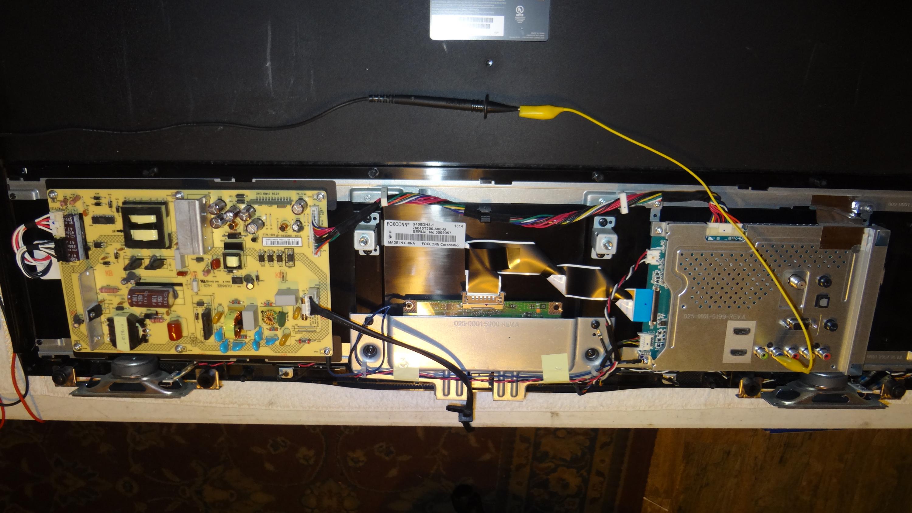

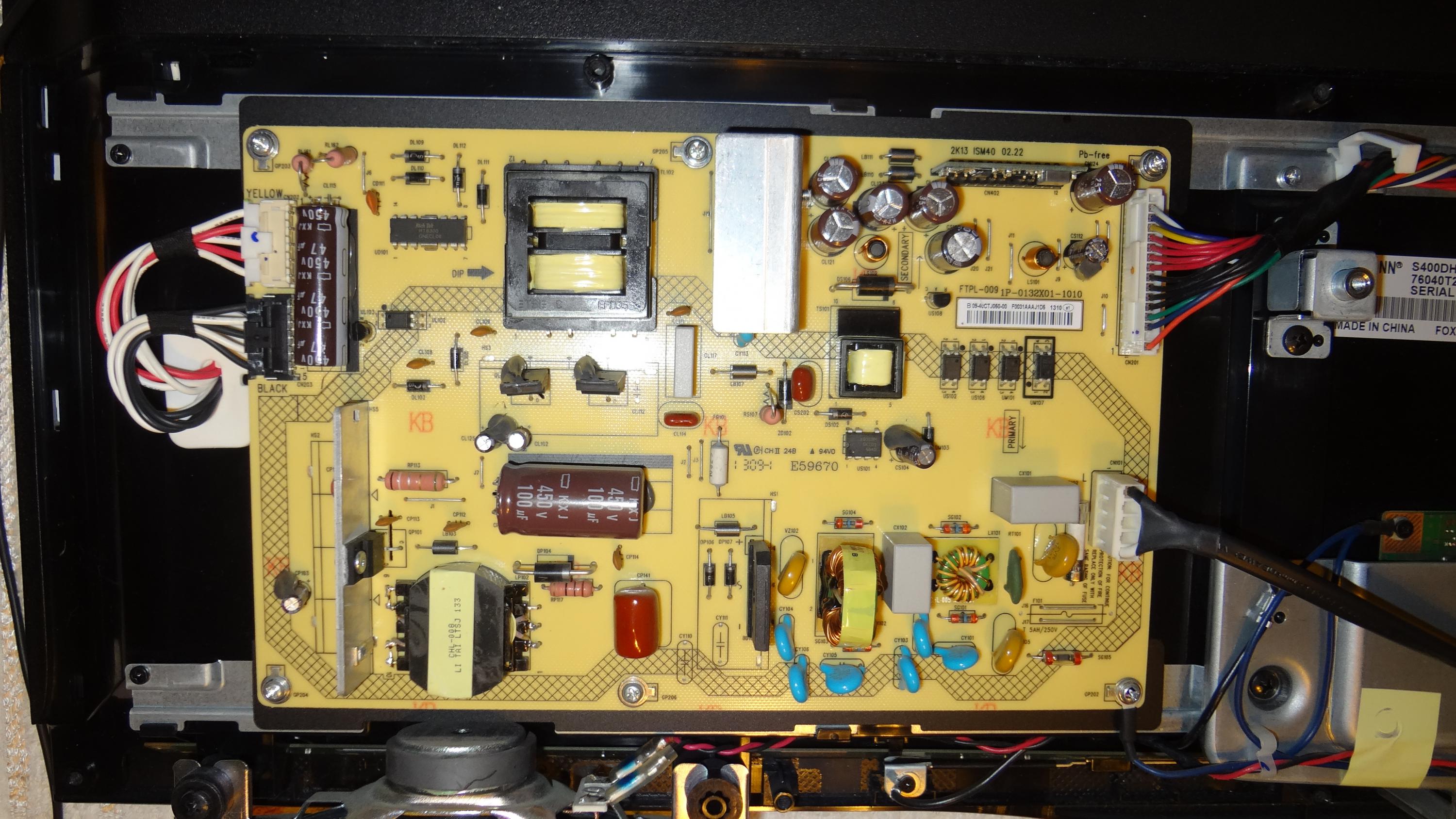

    This TV powers on and off and I can see the floating screen saver very faintly with a flashlight.
    I've measure voltages and here is what I've found

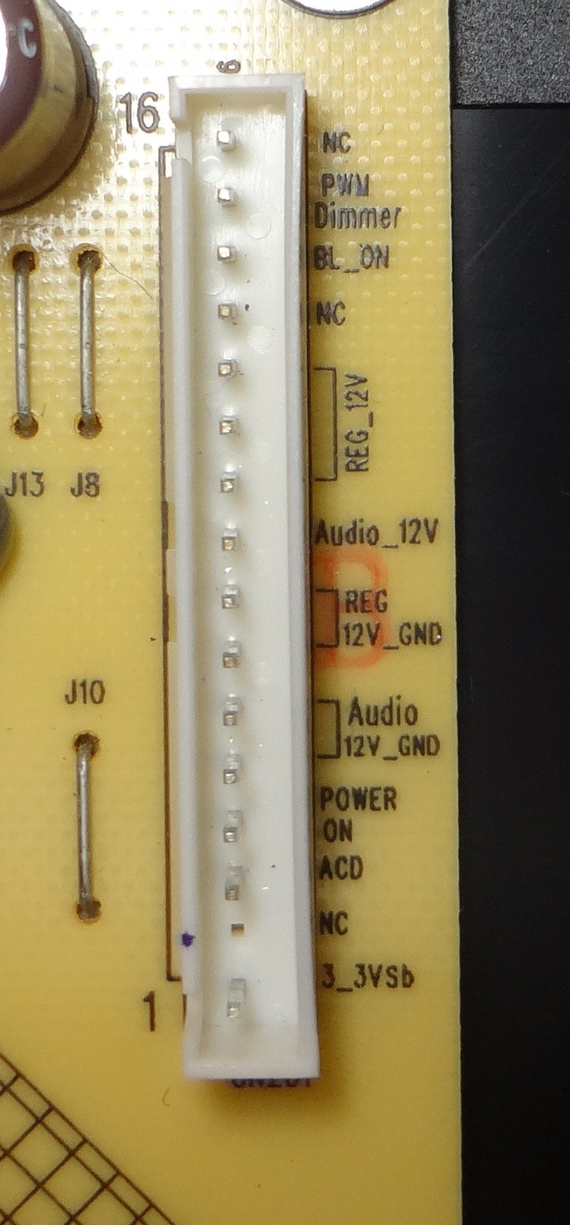

    CN201
    3 - 112mVDC
    14 - 3.18VDC
    It would make things easier for us if you put the description of each pin next to the readings.
    CN201
    pin 3 - ACD
    pin 14 - BL_ON
    On most sets, BL_ON (backlight on) going high (> 3) means turn on. On some sets, it might be the opposite.
    ACD might be AC Detect. On some sets, ACD high might be needed to turn on. Or it could be the opposite.
    When the TV is in standby mode, what is the voltage of pins 3 and 14? When turned on what is the voltage of 3 and 14? When the set is turned off, what is the voltage of 3 and 14?

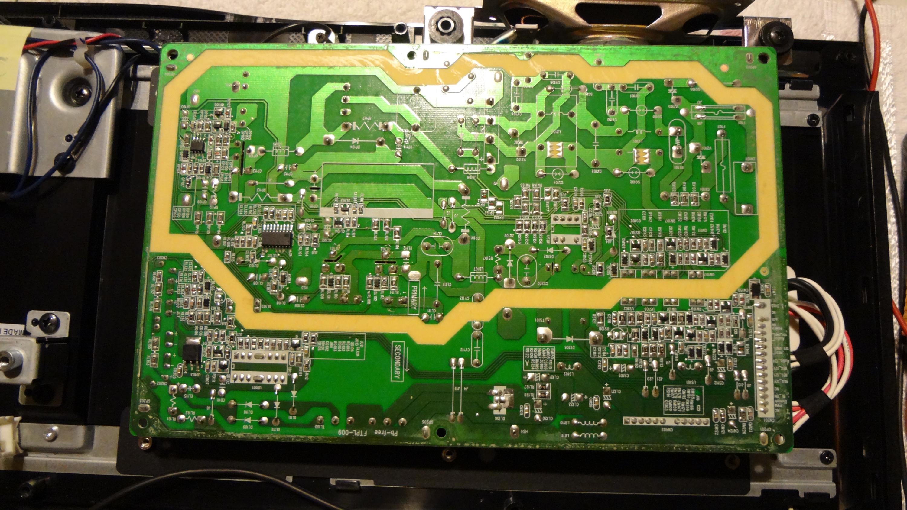

            Re: Sharp LC-40LE550U no backlight
            BTW, what is the marking in IC UD101, just right of 47uF 450V cap?
            --- begin sig file ---
            --- end sig file ---
            • krygods
              • Dec 2014
              • 257
              P/N for UD101 is RT8300

                disassembled the panel to test the leds, found bad solder joints on one the of the connectors that join the two separate strips into one long strip. turned it on and the leds blinded me.
