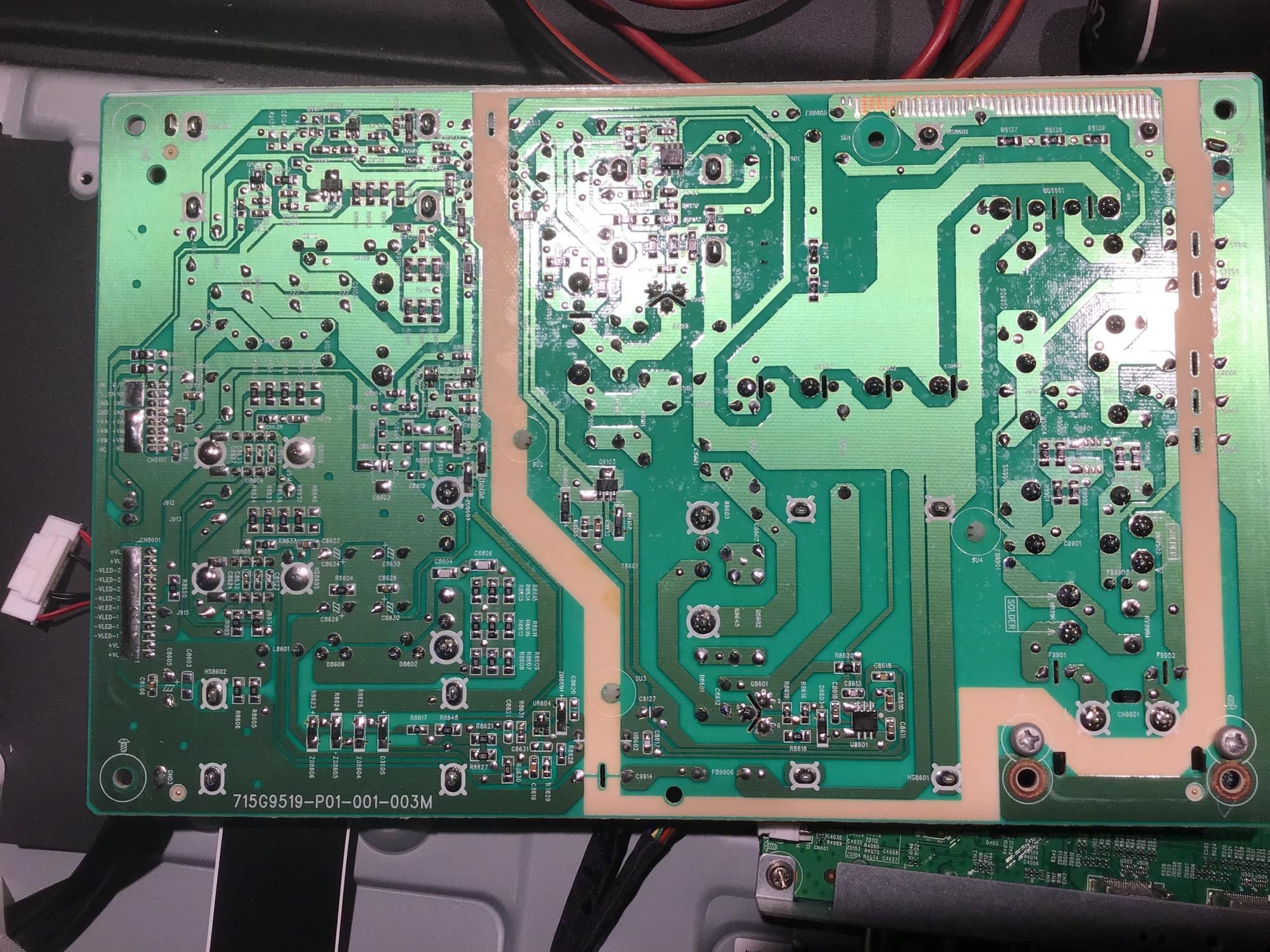

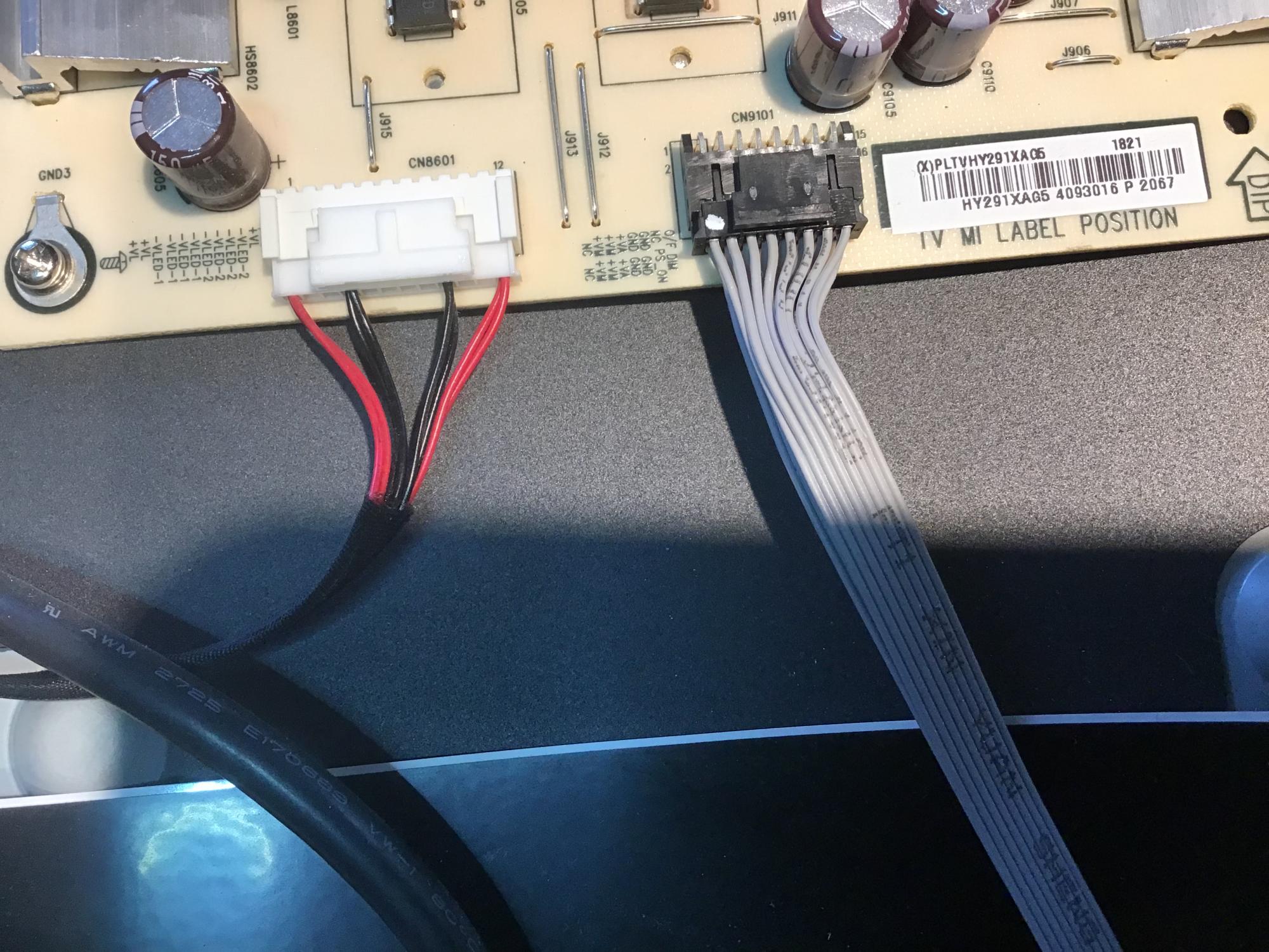

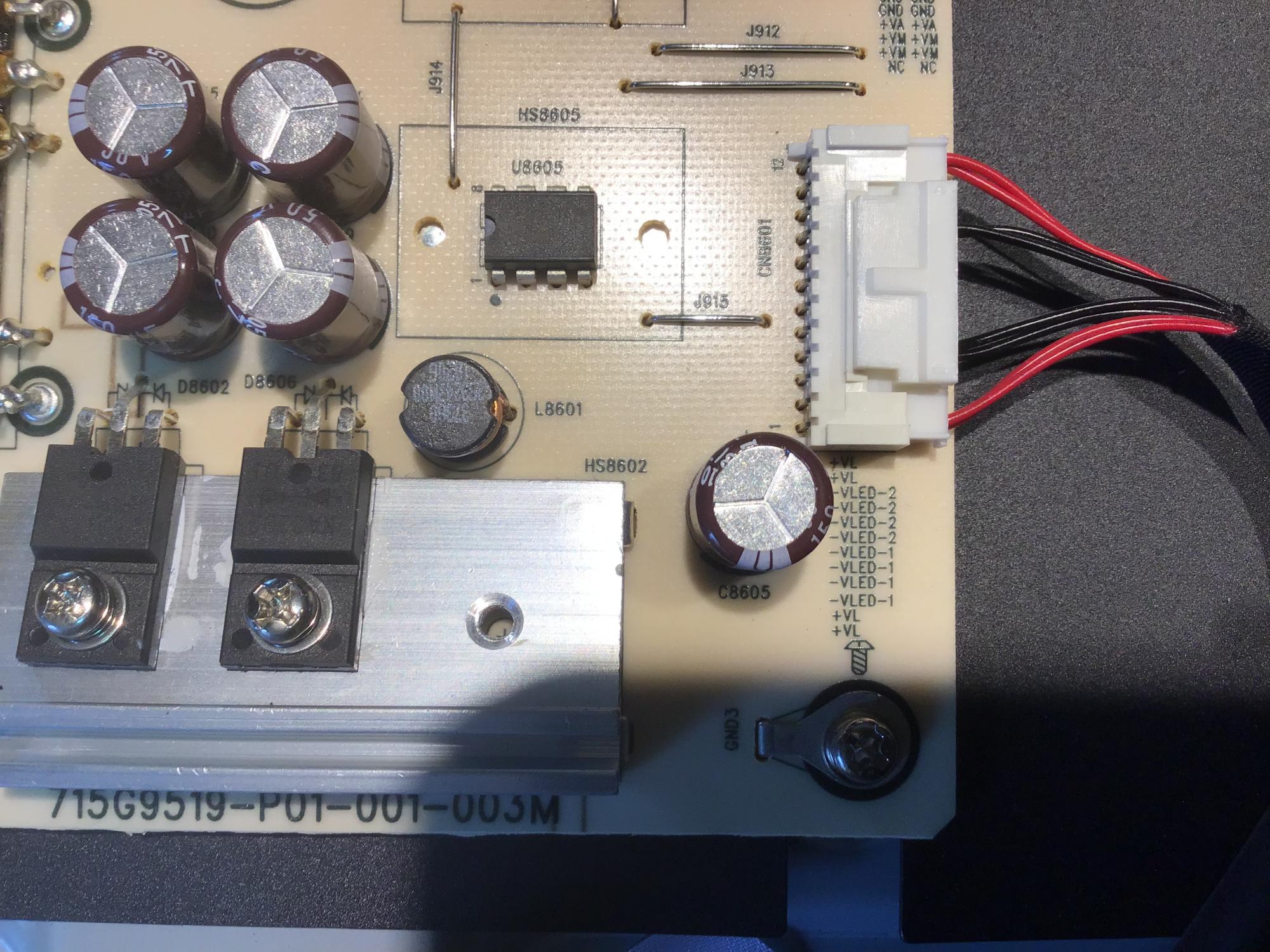

    I have a sharp LC-50LB601U that has no backlight. It starts up fine, and has sound, however, I can only see the screen using a flashlight. I took the tv back off and measured voltages at the power supply connector CN-8601. As you can see by the picture, the led connector has 2 sets of 2 red wires and 2 sets of black wires going to the led backlights. Between each set of black wires and corresponding red wires, I measure 30 volts (pins 1 and 4) and 30 volts from pins 8 and 12. From ground to each set of red wires ( pins 1 and 12 to ground), I measure 35 volts. This voltage seems very low compared to other led TV connections from, the power supply to the backlight leds on other sets. In looking at the back of the power supply circuit board led connector or cable to main circuit board, I cannot see any printed voltages of any mention of the typical 5volt pulse to turn on the power supply for the backlight. I would appreciate any help or even a service manuals that anyone has on this set.

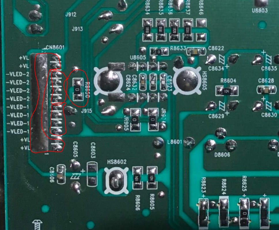

    You need to measure the voltage at the output of the LEDs immediately at the moment the TV is turned on, it should be high, but if the LEDs are not working properly, the protection in the led driver will work and the voltage will immediately drop at the output.
    You need to measure between +VL and -VLED1, also between +VL and -VLED2.

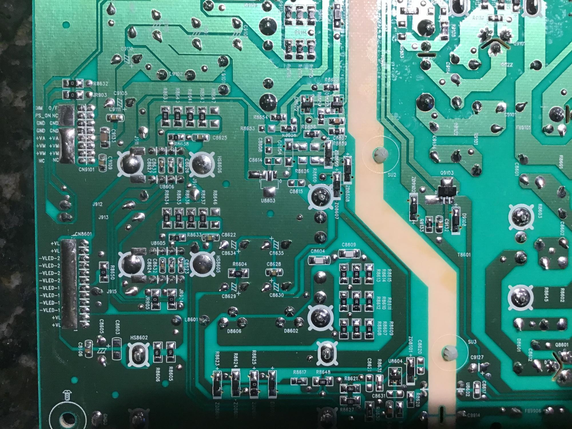

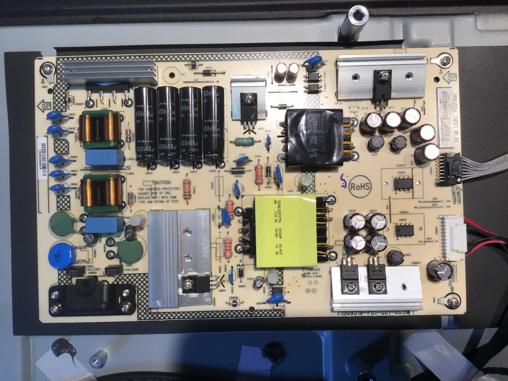

      Here is a picture of the complete back of the power supply to the above post.

          You have only one output (led1 is connected to led2), four lines of 8 leds (3V), so 30v is normal at the output, these 30v are fed to each bar separately. What voltage are the electrolytic capacitors at the output (according to the photo, it seems to be 50v)?

            Yes Lotas, the voltage rating of capacitor c8605 is 50 volts. Also, C8634,c8635,c8629 and c8630 is also 50 volts. By the fact that you sent me the Ali express link for the backlight led strips, do you feel pretty confident that I have a serious of failed led backlights? Thank you
