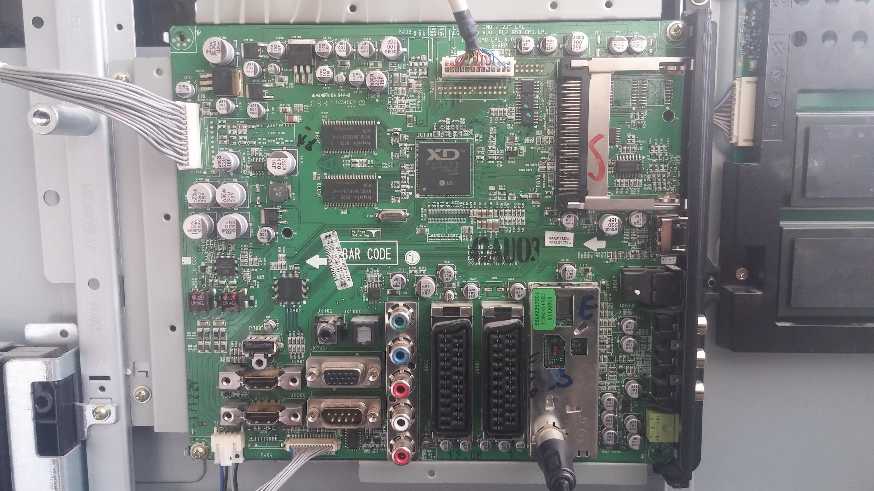

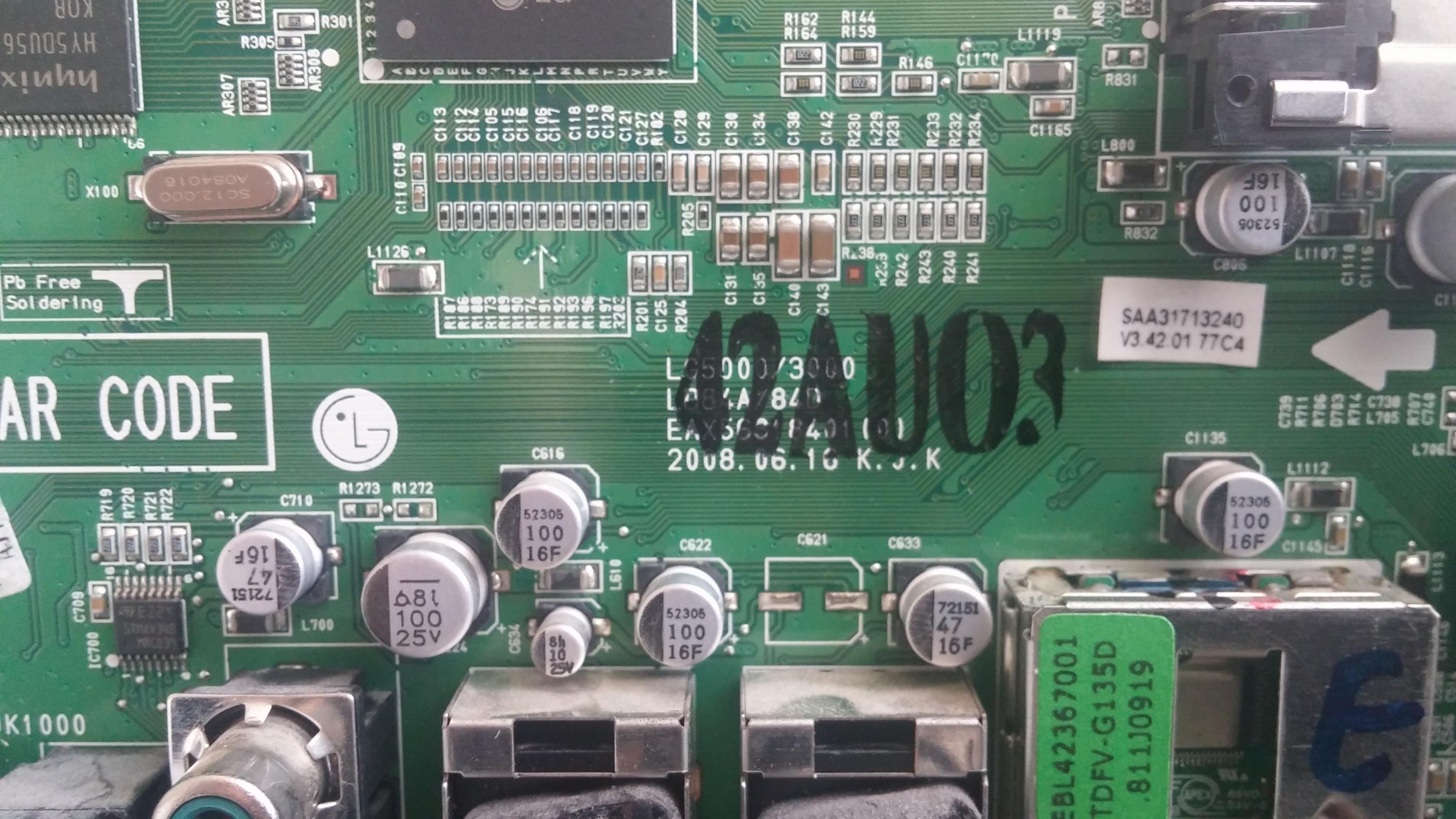

          Re: LG 37LG3000 weird mainboard dtv turn on/off loop fault!
          pictures as promised...
          • vinceroger69
            • Mar 2012
            • 6714
            • uk
            Im not sure too be honest but im sure a more experienced member may have ideas what to check. main board faults seem hard to trace/find hence why a lot of us end up board swoping we would all like too fix the old one ofcourse but some times we just cant i guess.
