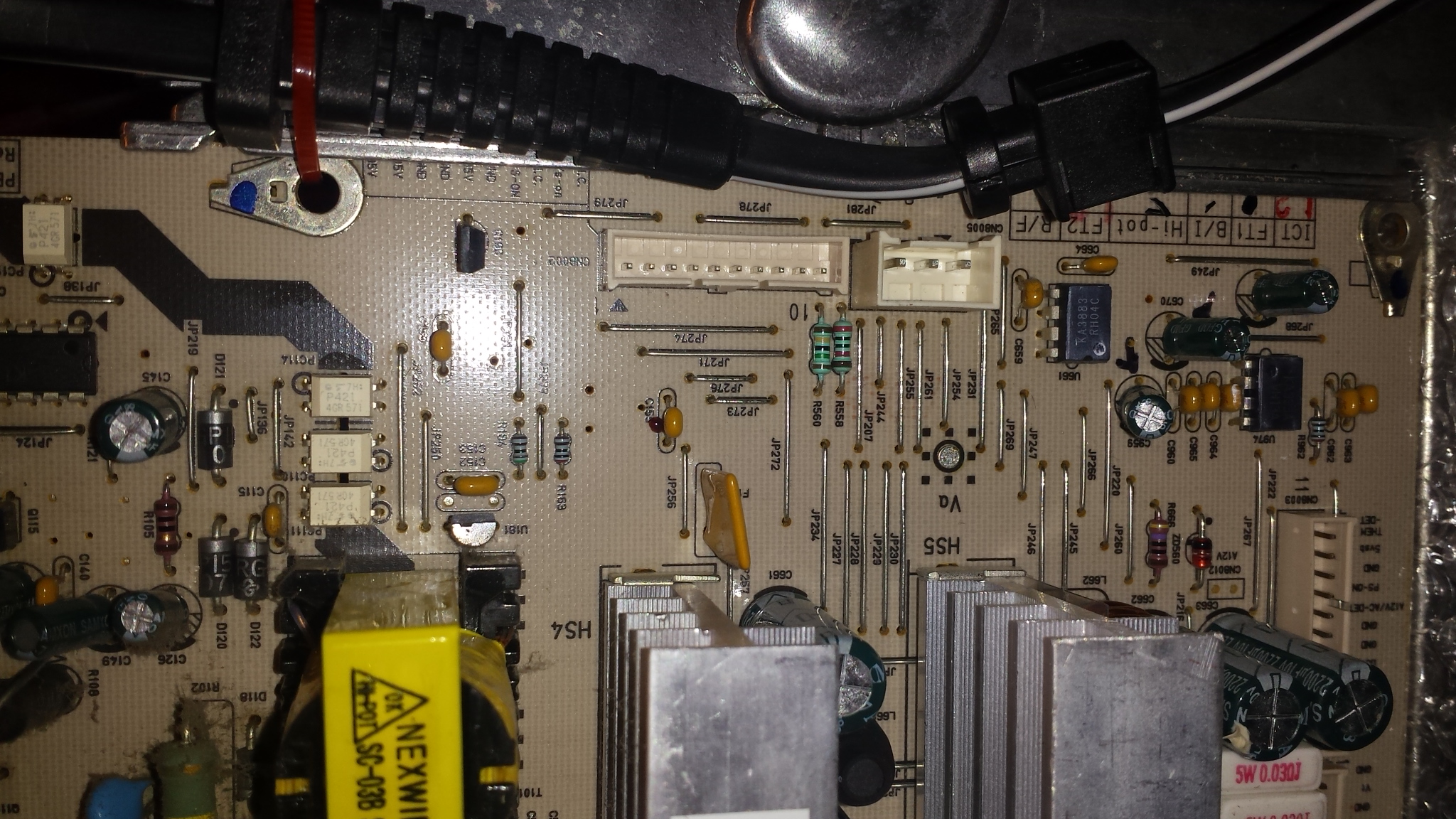

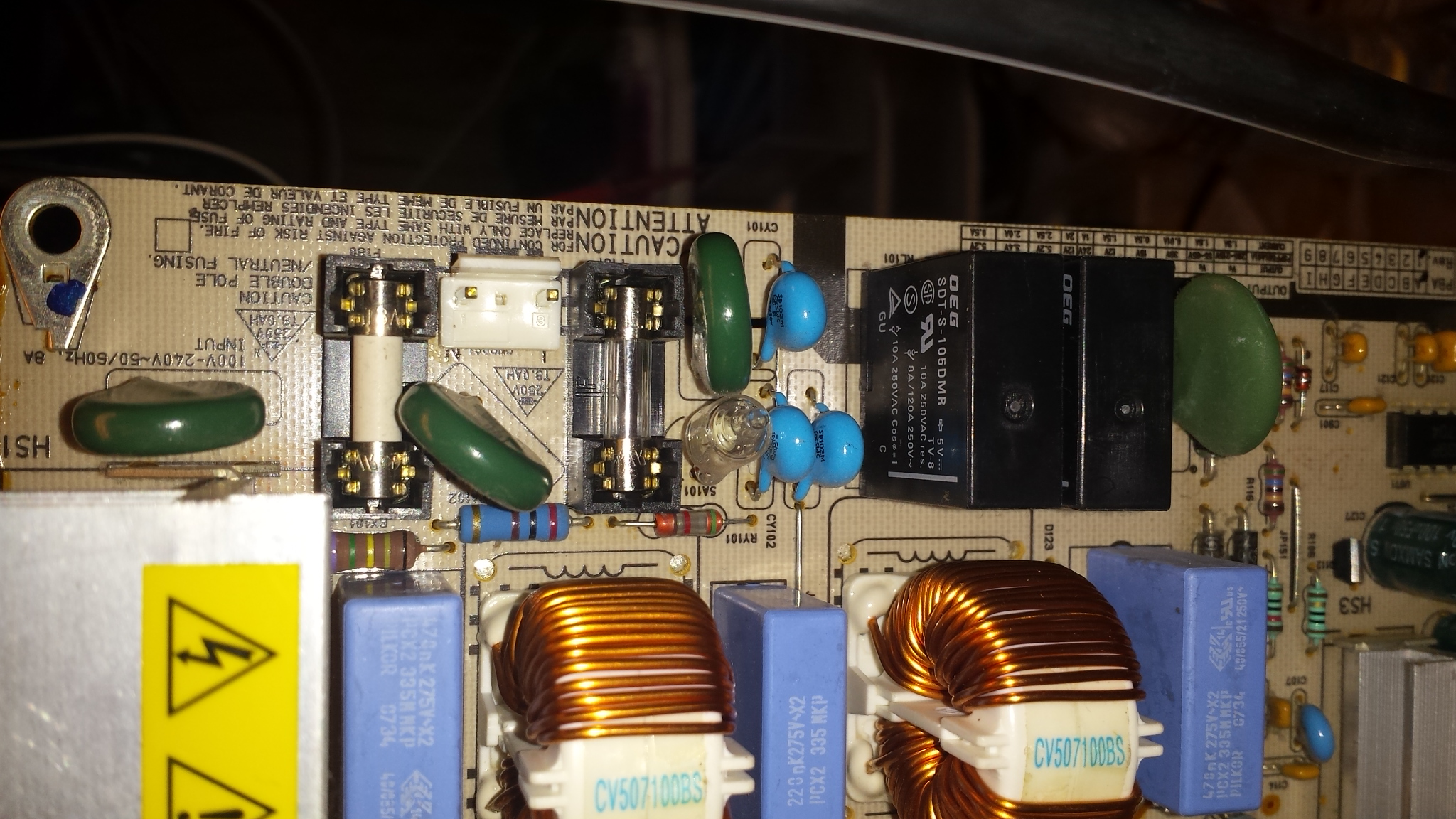

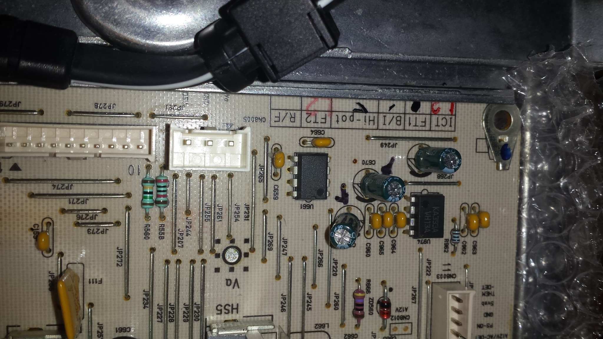

    Pics of P.S. and led 2002 that was flashing when set was working for a few minutes

      So you are saying that your STBY voltage is gone and thus the TV died? What about the other fuse on the PSU (there are 2)
      Did you check the STBY voltage to GND pin on both boards, maybe there is a short? You are correct, if you don't have 5V STBY, than nothing is going to happen on that PSU. It will not turn on.

          Both fuses are good. I measured several kohms on the 5vdc to chasing gnd.

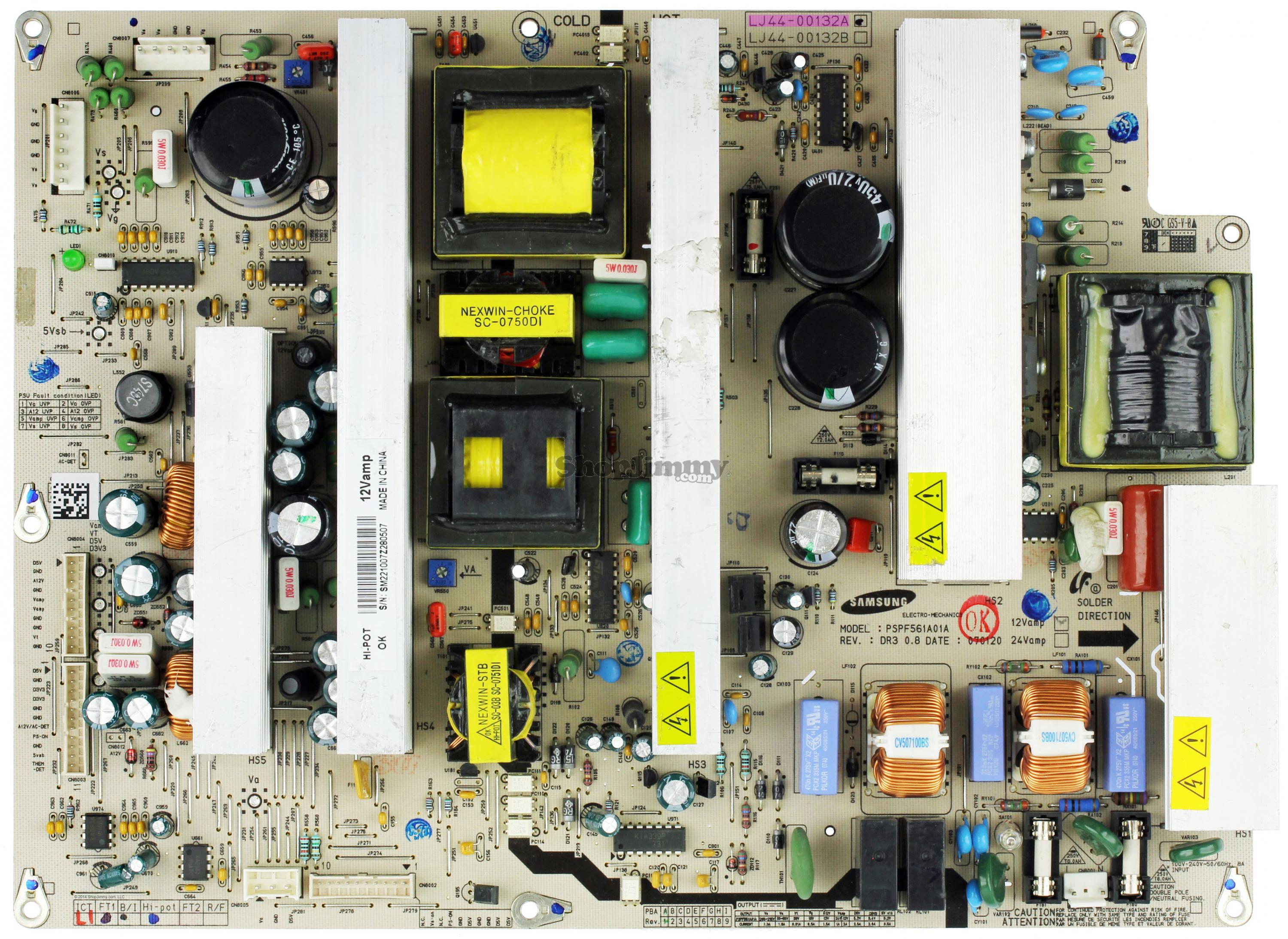

              is that your power supply? http://assets.shopjimmy.com/media/ca...132a-top_2.jpg
              When you plug in your board, do you get 170V on the filter cap?

                  Re: Sanyo DP50747 No 5vdc LJ44-00132A
                  "I place a jumper from CN8002 pin 1 to pin 7"
                  I look at the board, the pin 1 for 5V is labeled as 5VD, that is a switched 5V.
                  The standby '5Vsb' is at CN8003. So check and see if you do have 5Vsb at that pin.

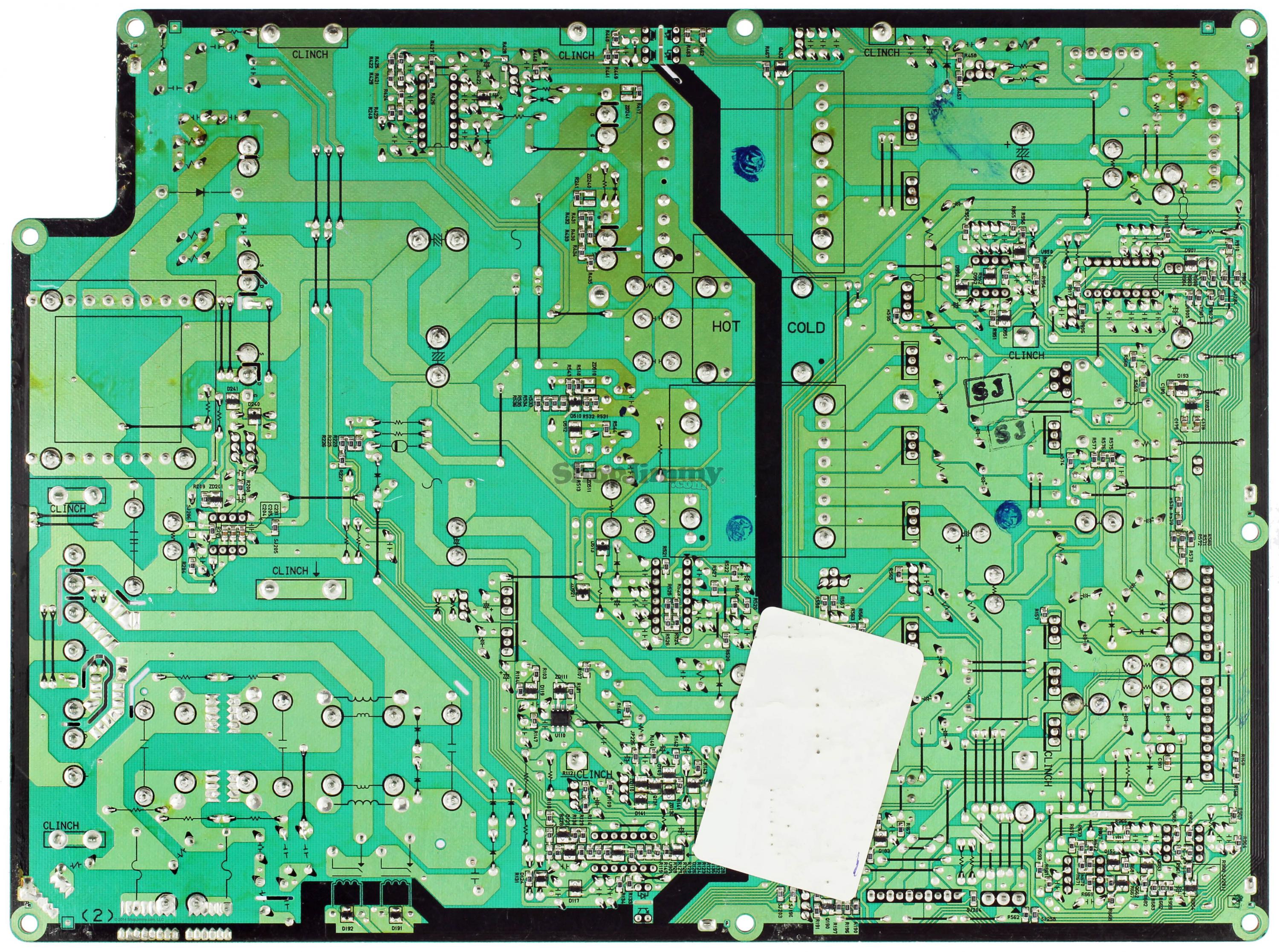

                  Too bad shopjimmy picture of the bottom side of the board has a big white sticker on it so I cannot see the traces to verify the connections.
                  Pictures provided by SHOPJIMMY.
