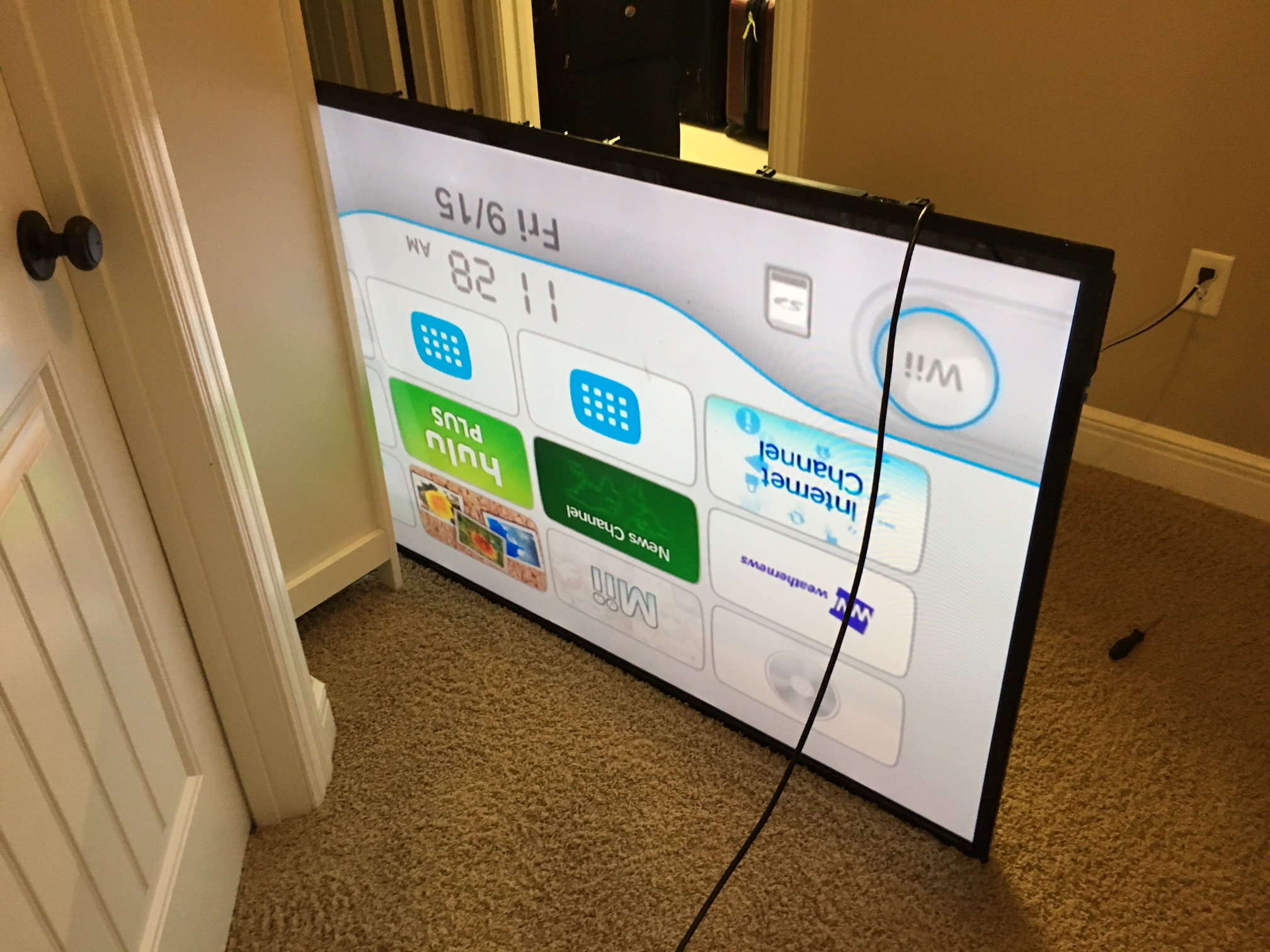

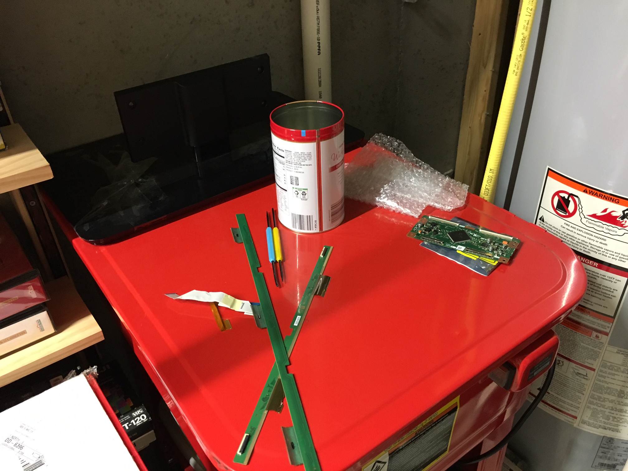

                              #774
                              Re: e701i-a3 no picture but backlights
                              Pretty uneventful tab-ripping ceremony (thankfully). The TV looks sharp and the wife's happy. An eBay remote clone's on its way in the mail. Thanks, all, for keeping this thread packed full of information and success stories.
                              First photo: Testing the TV after pulling the tabs
                              Second: Leftovers
                              Third: The 70in Vizio in front of a 50in Panasonic plasma TV (a previous repair job)
