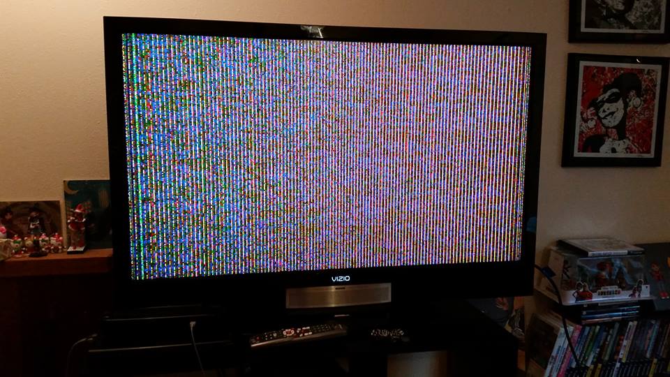

    Hey all
    Been awhile since I have posted, TV repair has been on hold for me since other things have taken over.
    I am trying to finish up some back stock I have left.
    Anyway I have 2 of these panels, and both of them are doing the same exact thing.
    When powered on the panel functions perfectly fine and in (about 10-30 min later give or take) the display becomes corrupt, audio cuts out, starts squealing, pink noise ect and the buttons/remote become un responsive and the unit has to be unplugged.
    After I unplug it and plug it back in it will function 100% fine and the issue will not comeback unless the panel has been powered off for a while.
    I am guessing it is a bad mainboard/EEPROM but the mainboard version I have in both of these panels is the one that cannot be changed (talk about luck).
    So I assume I will need a new mainboard, but has anyone experienced similar issues with these series of Vizio panels? I would like to find out how to prevent this from happening again.
    I know vizio likes to encase their mainboards behind a stupid metal box/shield that traps heat like crazy, I am working if I drill some more vent holes in the top of that would help keep the heat off the main.
    Anyway, all the voltages are correct, nothing seems off about them, I did not get to a component level but the SMPS, CCFL inverter and standby and power voltages were all present.
    thanks!

    Have you checked voltage regulations on mainboard?

      Sounds heat related.
      1) try heating up the mainboard and tcon boards with a hair dryer to see if you can quicken the screen corruption.
      2) after screen corruption, are the power supply output voltages still good?
