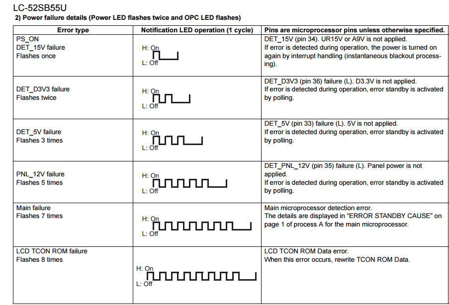

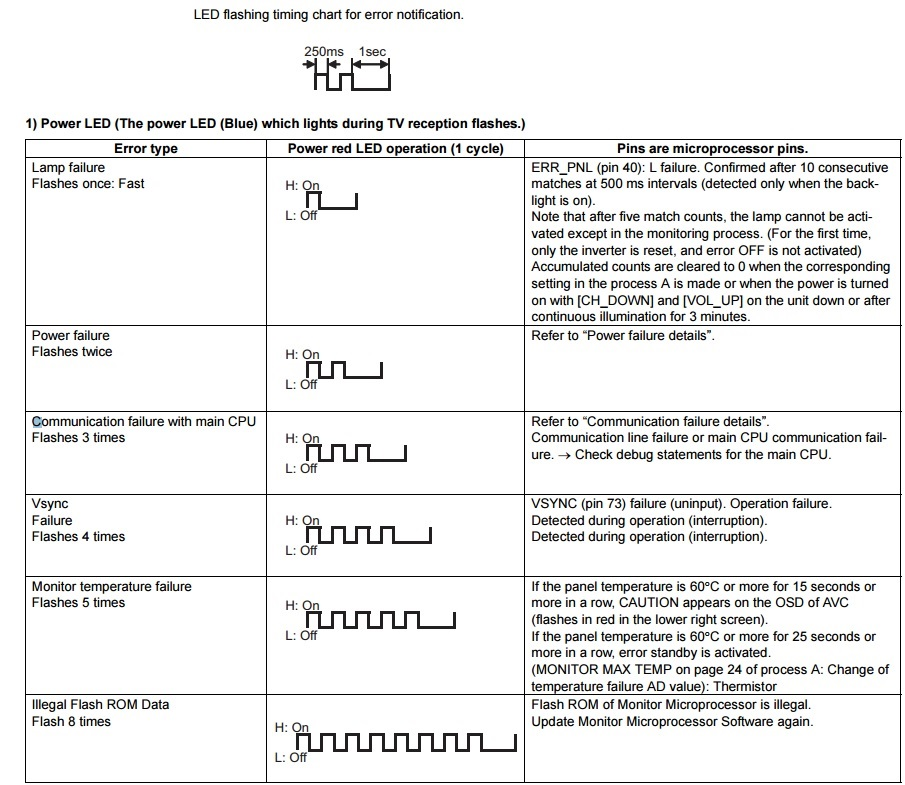

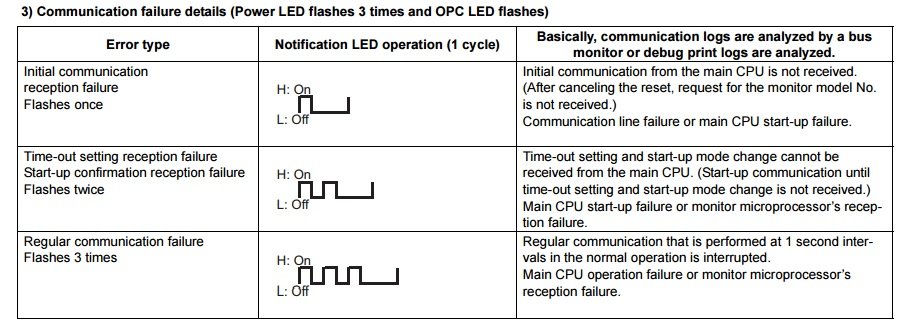

          Here are excerpts from the Sharp Service manual concerning the LED/OPC codes. Also I'll take full pics later tonight of the main board and post tomorrow.
          According to the manual (assuming I am reading it right) my codes are:
          Power LED flashes 3 times. Communication failure with main CPU. See Codes and Codes3
          OPC LED flashes 2 times. DET_D3V3 failure. D3.3V not applied at CPU (pin 36) See Codes 2.
