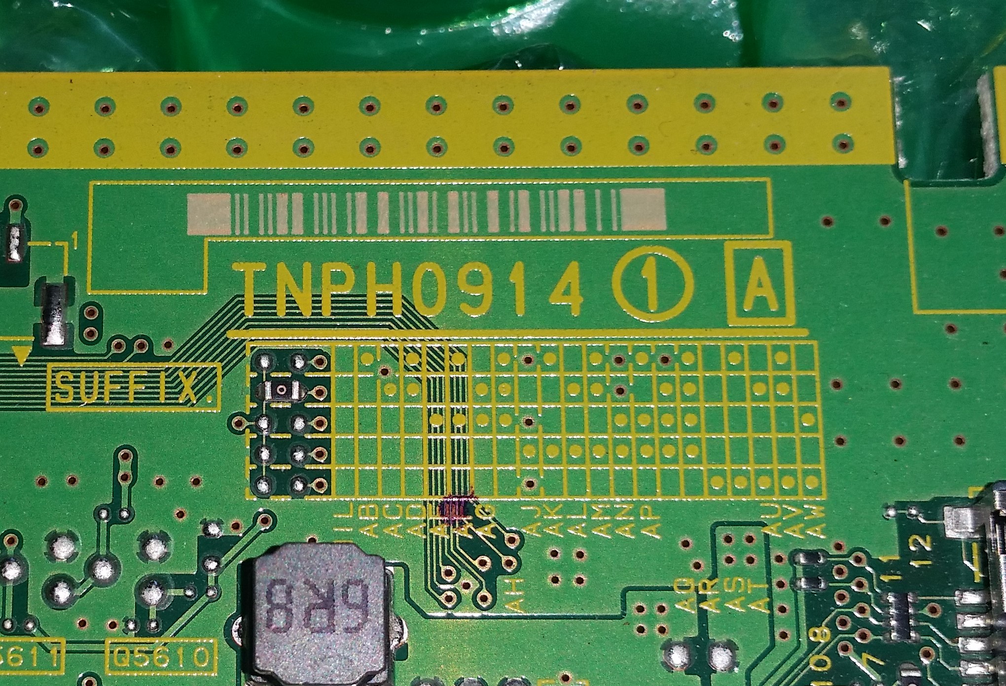

    Lightning took out the xbox 1 and the TV. Tampa is indeed the lightning capital of North America First it would not turn on. Replaced the main board, now the TV looks like //SEE ATTACHED//
    I am thinking I am at a loss and the panel is gone "see burned areas that are different than the box's and distortion." Let me know what you guys think

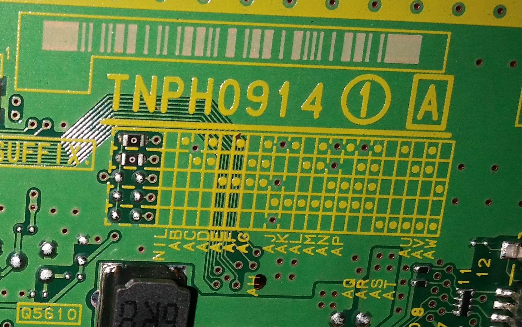

      I tested for standby power and had it, so i determined the main board was bad following a youtube how to. I received another board with the same part # from amazon. Everything is connected. At first i thought i had a PS problem. I disconnected and removed it, but my replacement part was bad (PS). I re-installed the original and now i am where i am at today.
      I think I may have the wrong revision of main board. On the suffix there is a component on the top left and corner on my old board. My replacement board does not have one not sure if it is a diode or capacitor because there is a mark on both sides and did not test it with a meter. In the pictures i have all old parts installed... See pictures

        I have cropped the 2 main boards i have. My bad one (original) has 2 components in the suffix, far left hand side before the punch holes and dots. The new board only has 1 component and does not have the one on top. See attached.

            You have purchased a TNPH0914AC which is the 50" model board. like Reeceyburger suggests it does look like a SS board issue but need to know what other variables may have been introduced. Even with the wrong mainboard I would not expect it as bad but then I don't know either what would happen precisely.

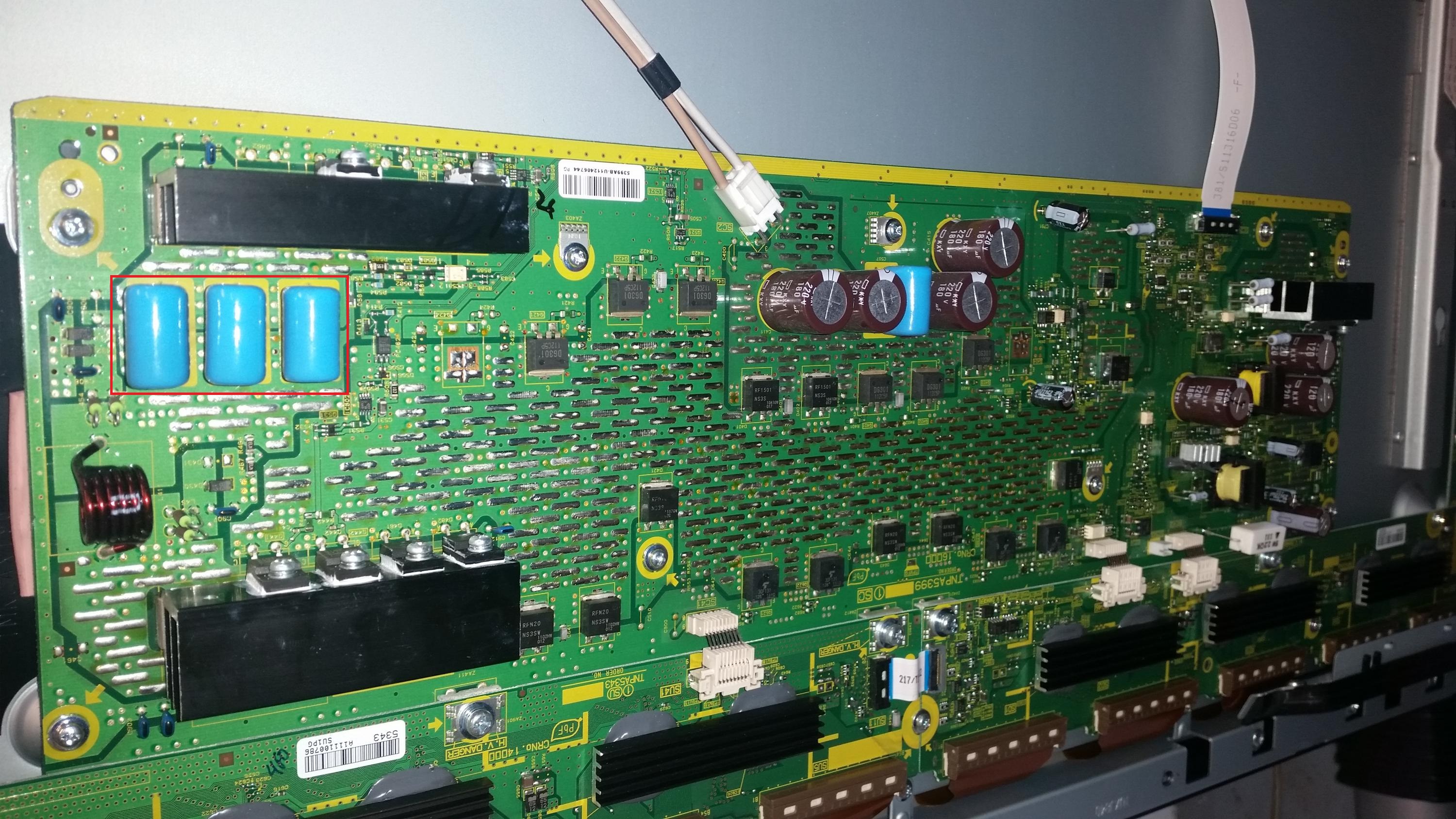

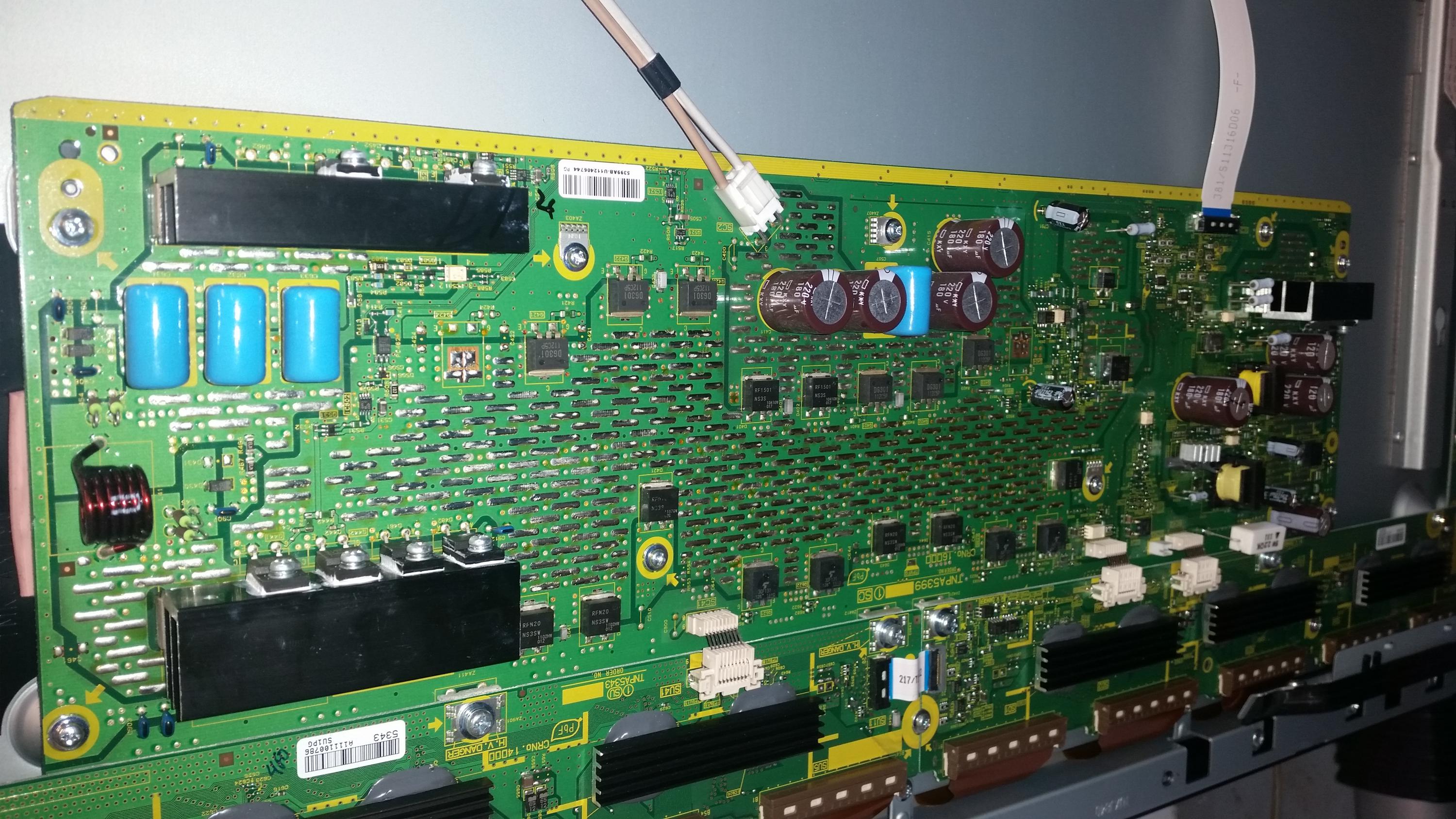

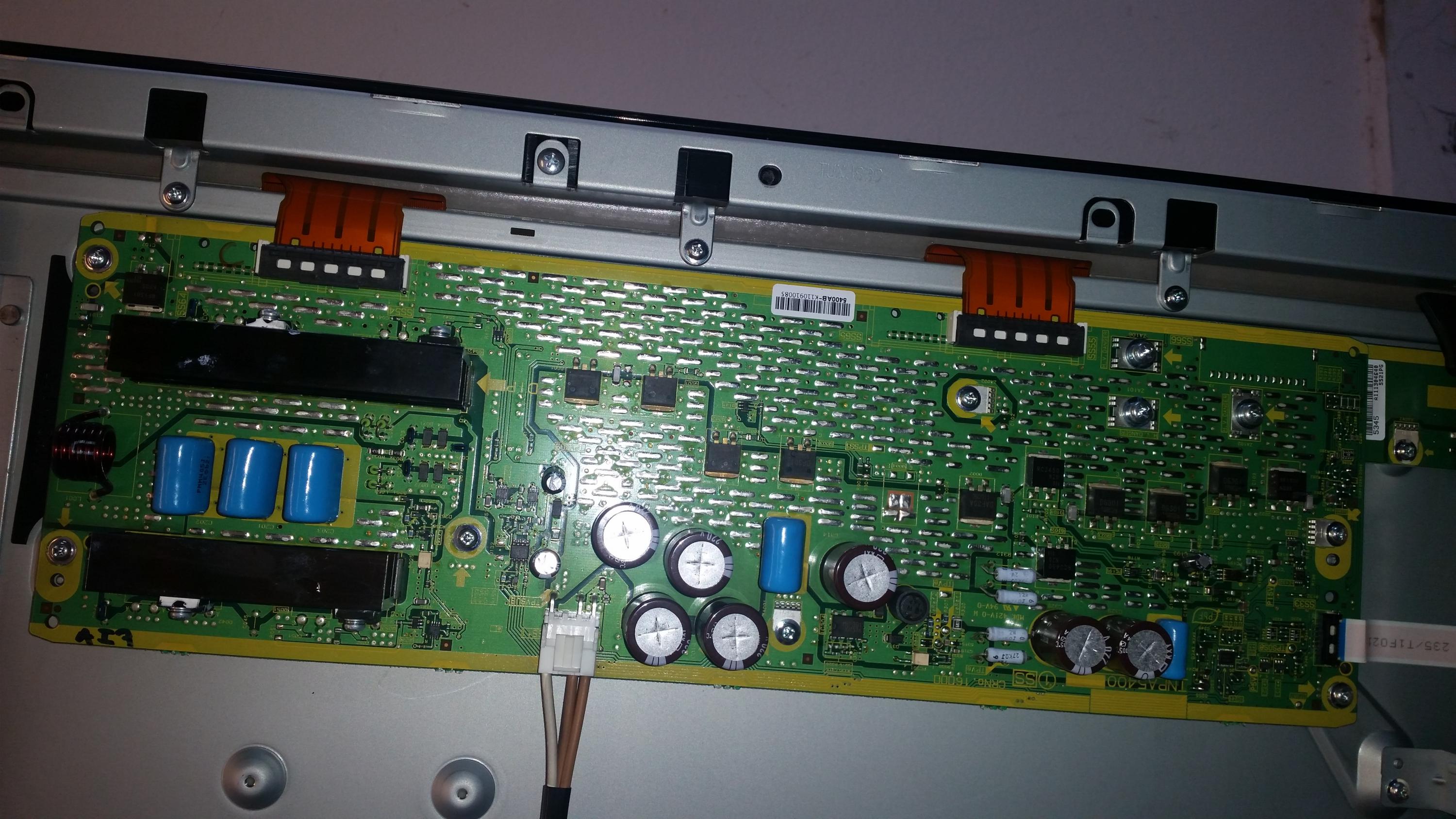

                This looks a lot like an SS board problem. A quick test can be done on these boards to see if the SS and SC are working. Can you supply a picture of these boards?

                  Re: TC-P60S30 lightning damage
                  SU and SS pictures attached.

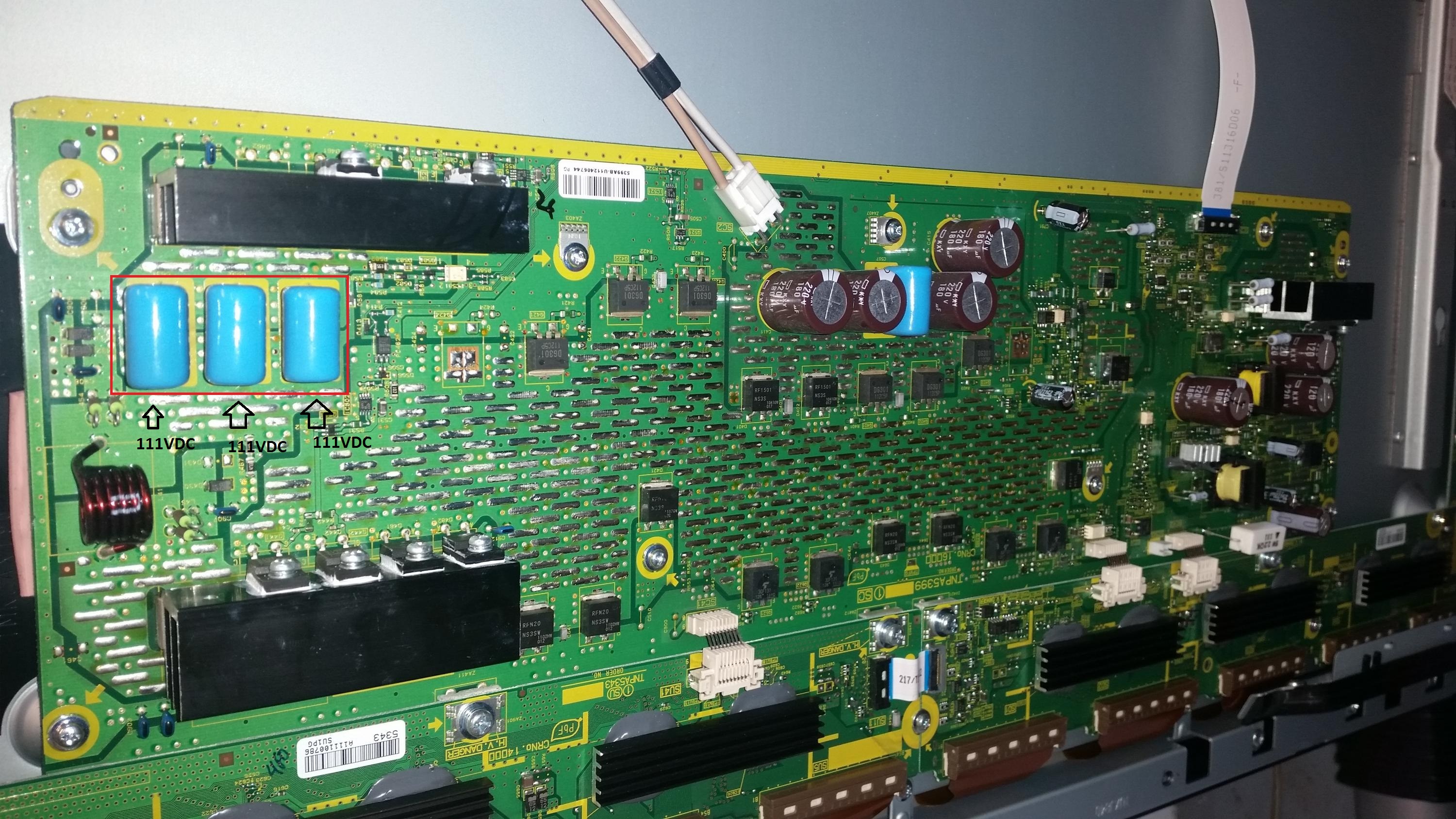

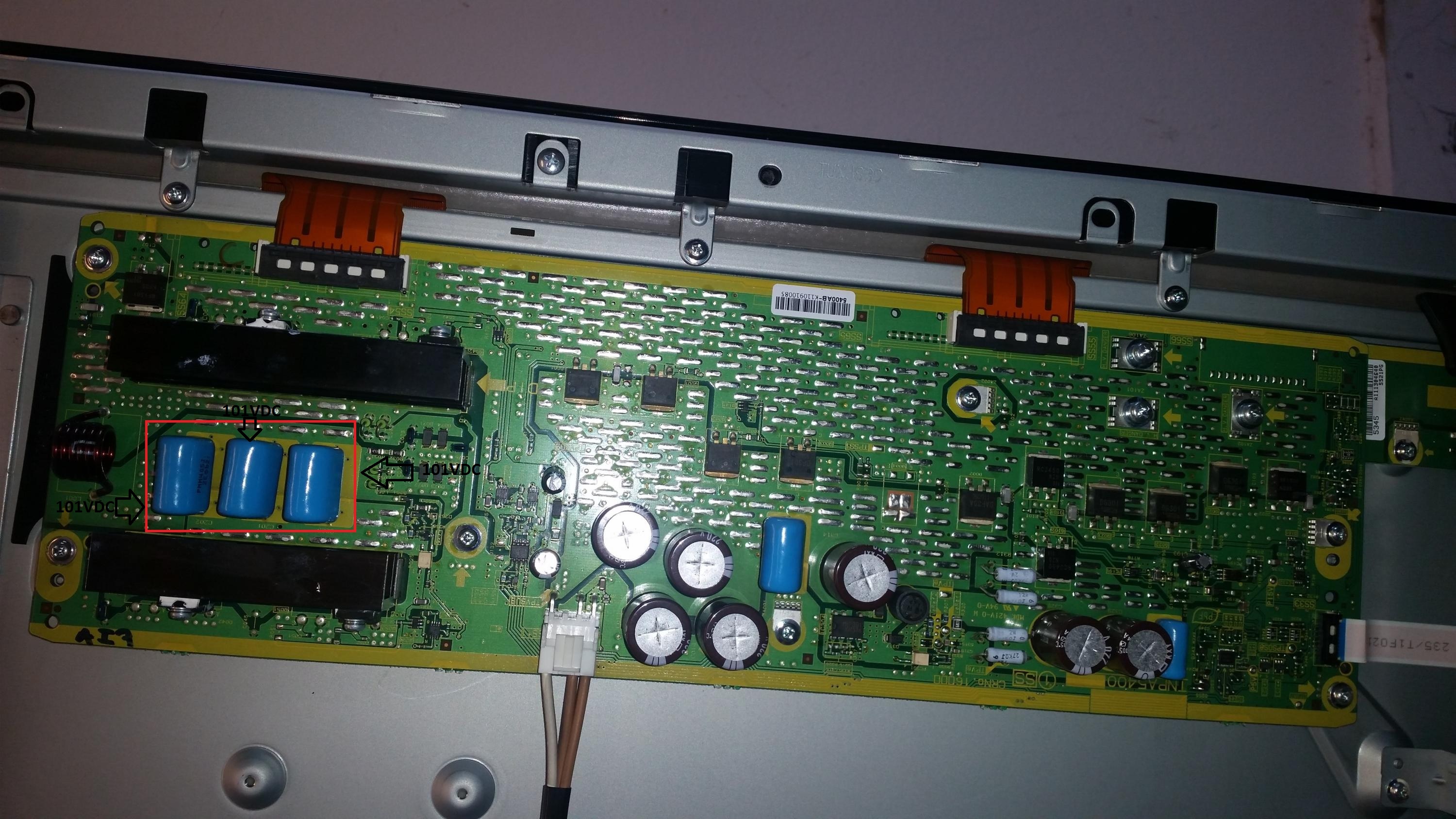

                        OK, check the voltage across any one of the highlighted caps in the bank.
                        Should be approx half Vsus if the board is sustaining the panel e.g. for 215V panel about 107V is expected (tolerance of around 10V is ok, maybe more. boards should match each other.)
                        • will00771
                          • Sep 2015
                          • 11
                          Board 1 has 111VDC with 210VDC coming in.
                          Board 2 (above the main board) has 101VDC with 210VDC coming in.
                          All three Caps match each other on their board
                          //SEE ATTACHED//
