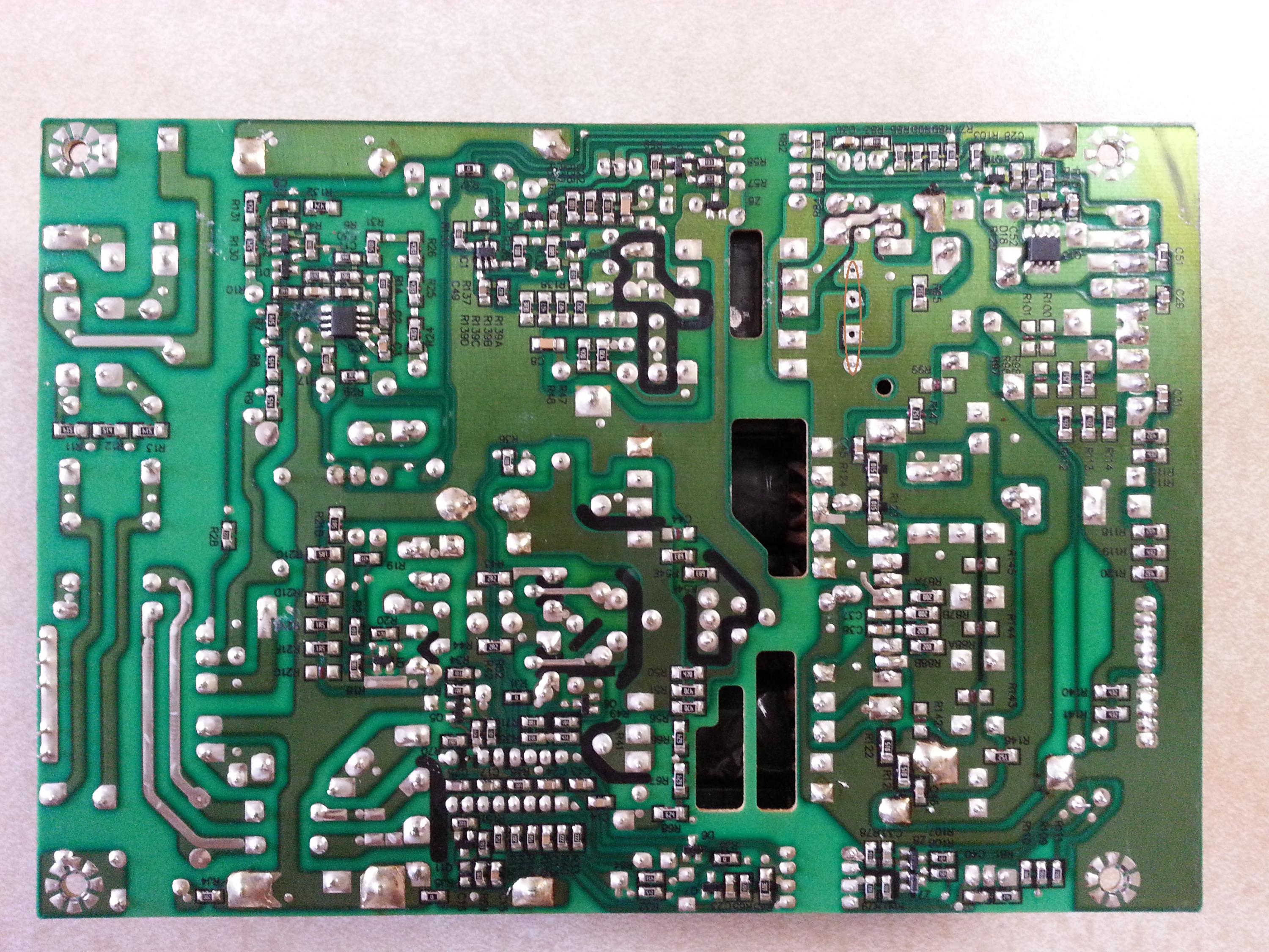

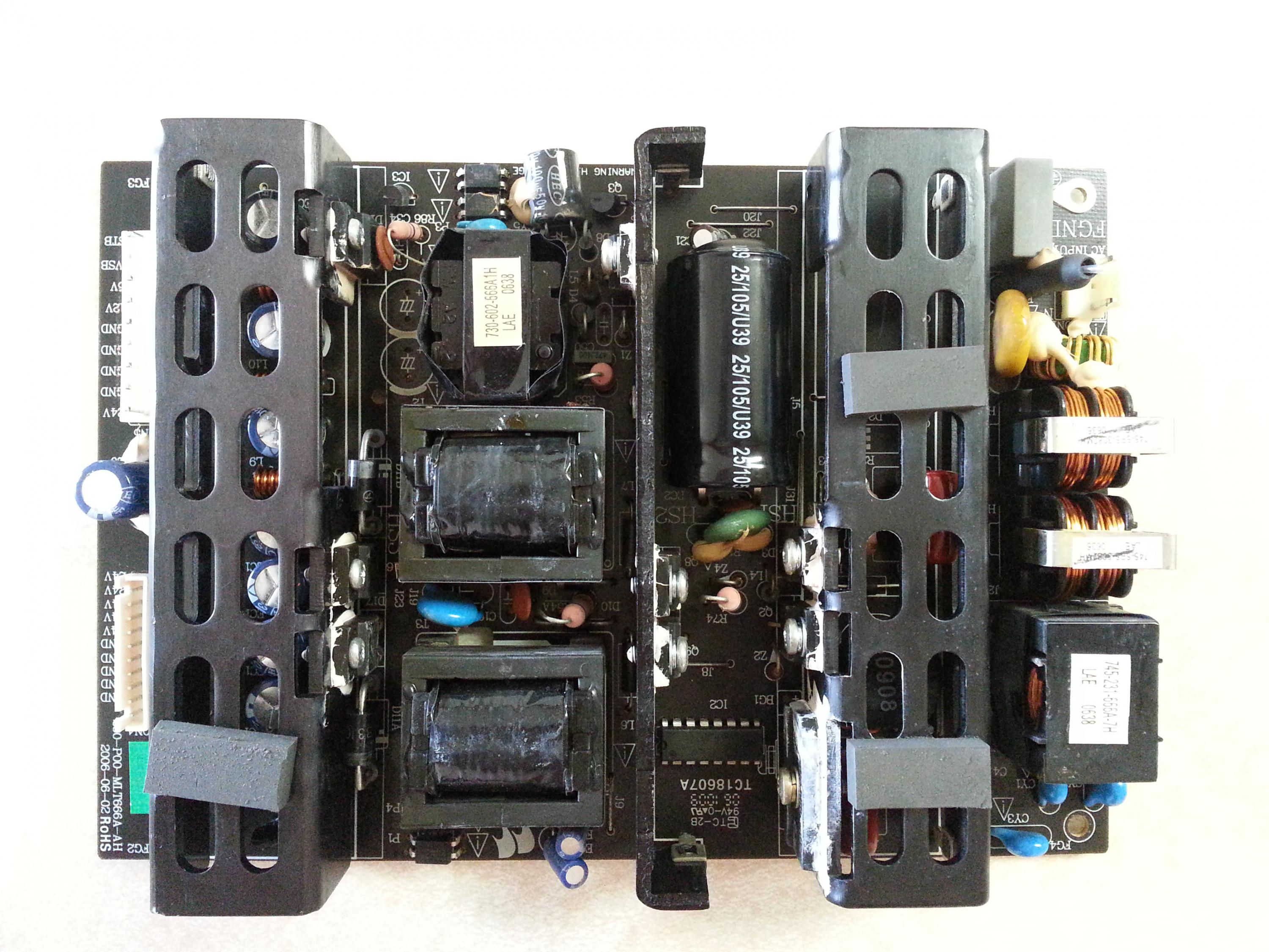

    So this 3211-tlxb has a worsening problem. I'll turn it on and after it comes on it makes a pop sound in the speakers and turns back off. The red stand by light is on and turns to blue when it powers up but back to red when it shuts down.
    I was hoping it had the same board as my Element 3211b since I had the two caps but it doesn't. All the caps look fine to me.
    The place I circled had 2 HEC ZD 1000uf 10v caps. Any ideas?

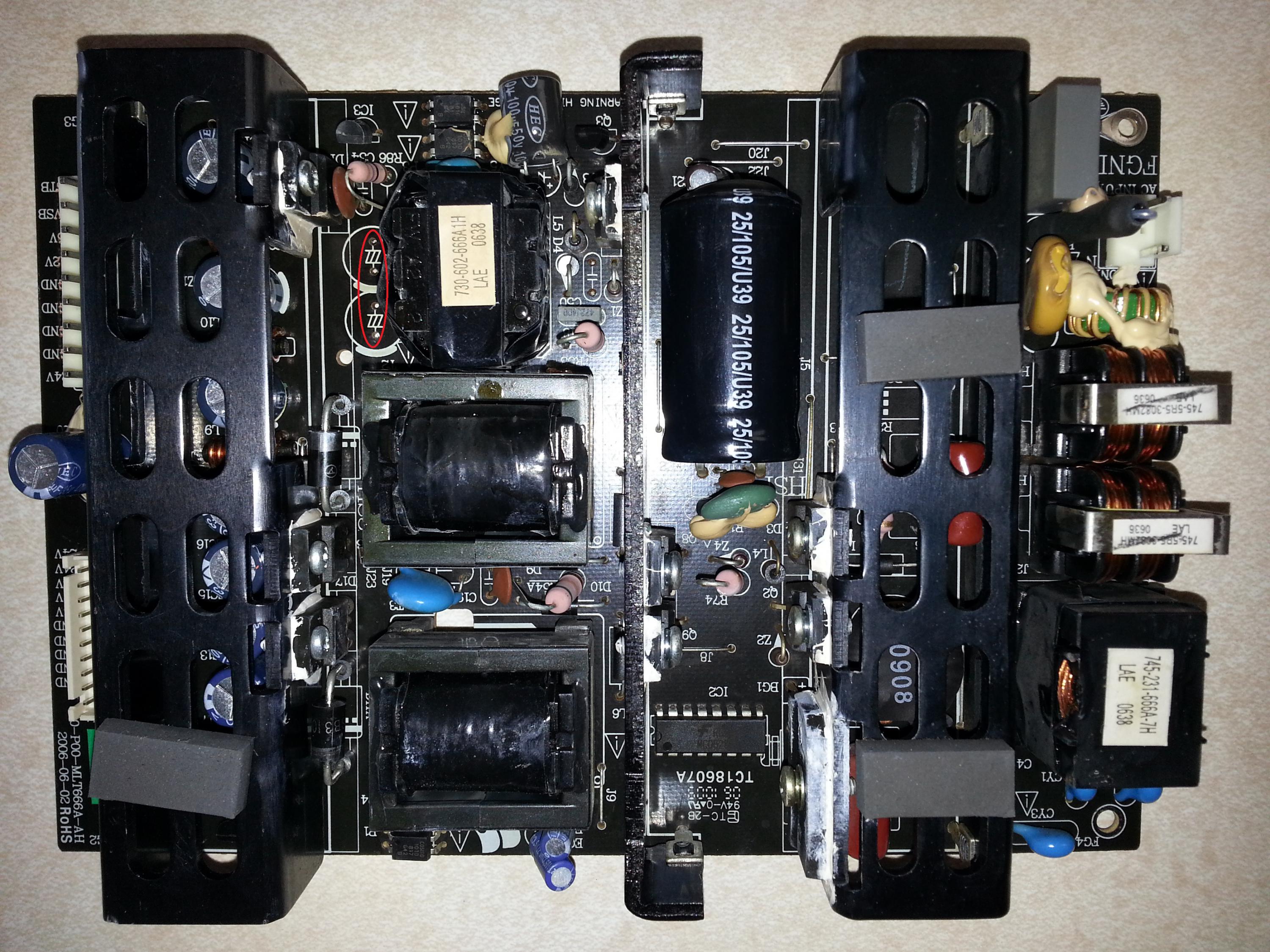

    Going to buy a new tv anyway but would like to get this one going. Does this even seem like a problem that would be in the power supply or something in the main board?
    Tv off is
    5v is 5.12v
    12v is 0v
    24 is 0v
    Tv on is
    5v is 5v
    12v is 11.7v
    24vis 23.8v

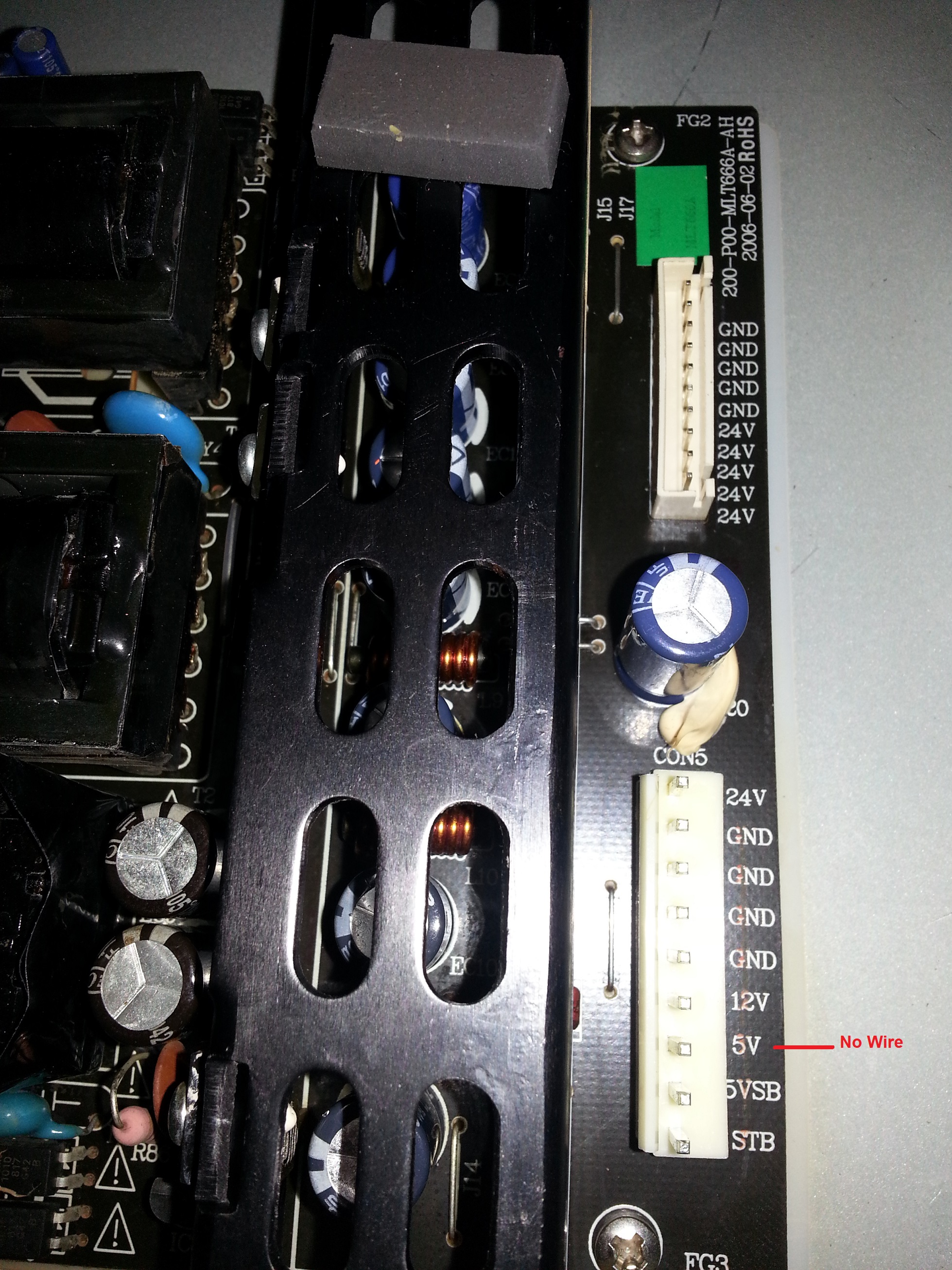

                            So you want me to unplug the main board then jump from 5vsb to stb on the power supply and also 5vsb to BLon which is what pin?
                            Am I just seeing if it kicks off this way or should I be measuring?
                              Re: Polaroid 3211-tlxb
                              The BL-ON (invr-on) signal is NOT routed through the power supply board connector in this TV, the BL-ON (INVR-ON) pin will be right at the Inverter board connector.
                              That is why we always ask for the pictures of the whole backside of the T so we can see how all the boards are connected together. Polaroid is one of those bad design and hard to get to some of the boards.

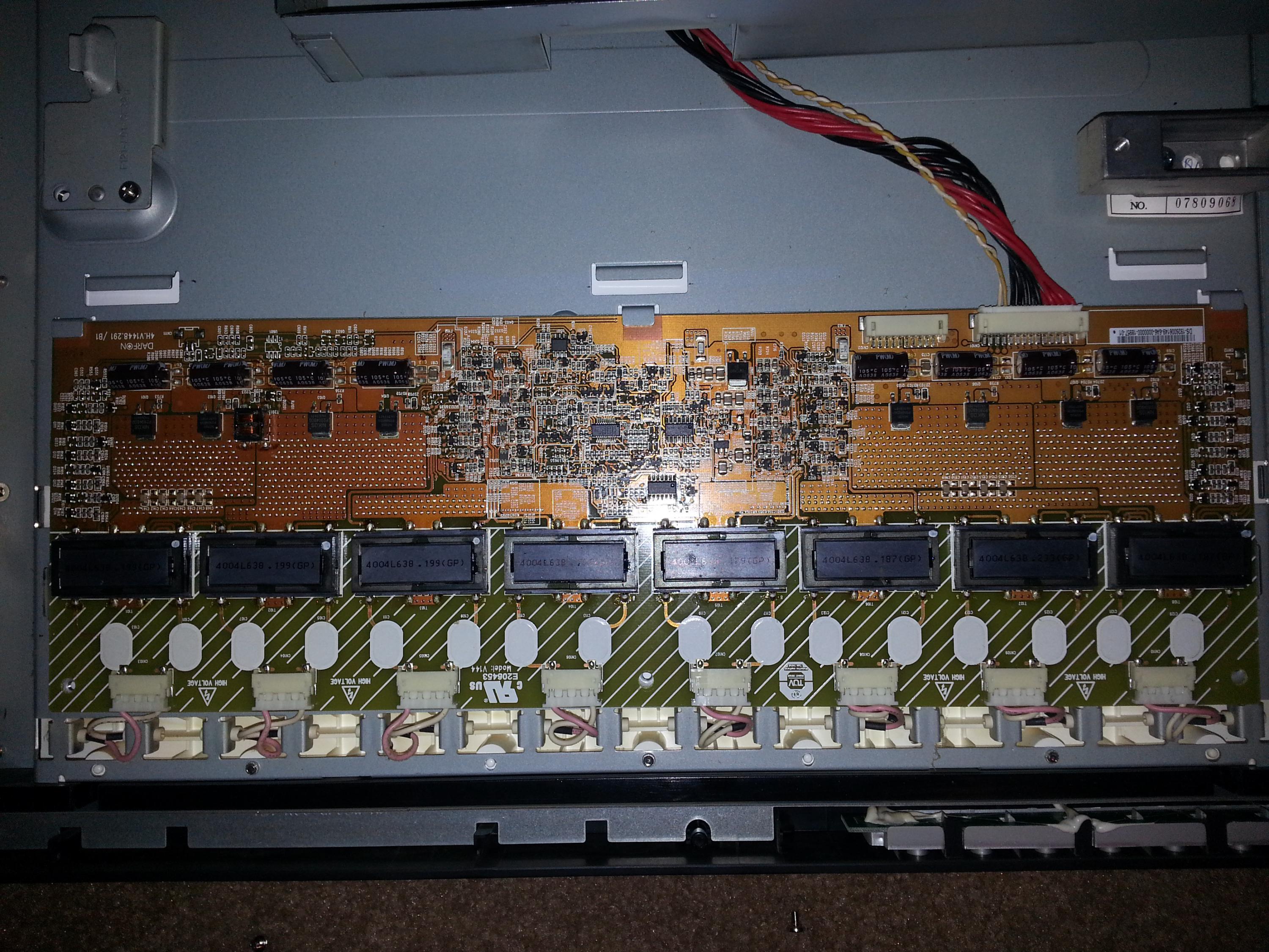

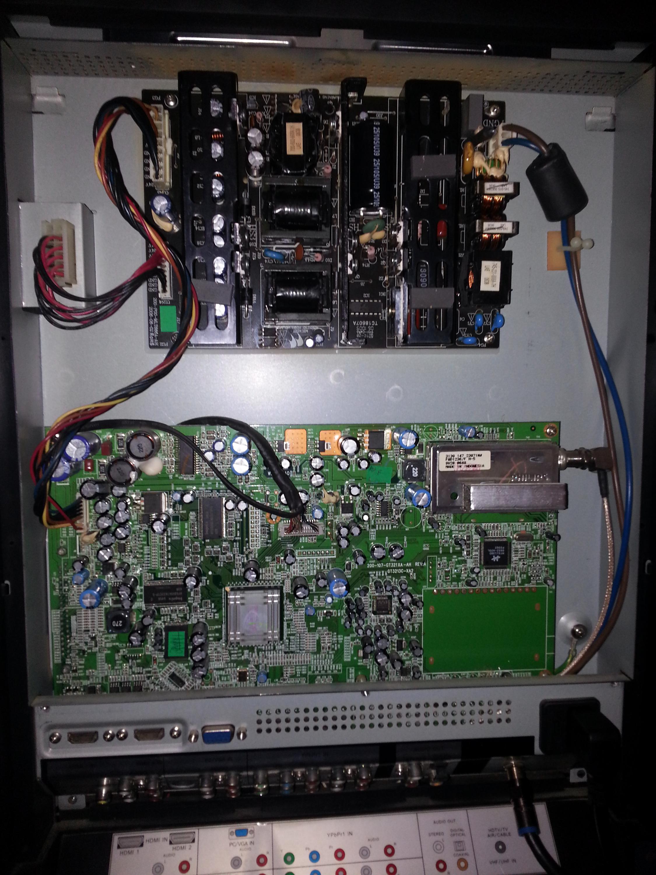

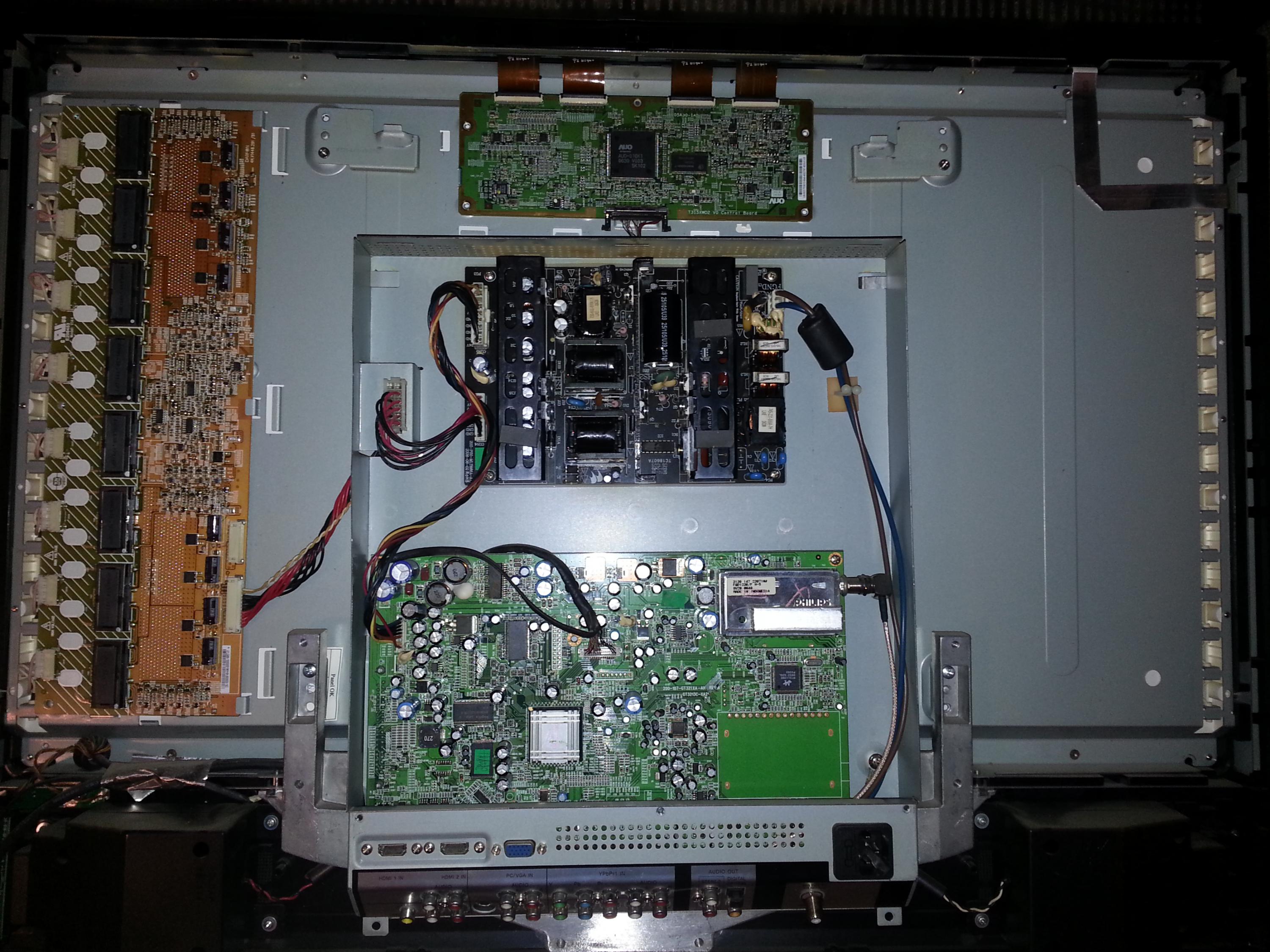

                                This shares the same body as my element and yes it is a pain to get to the back light boards. Sounds like that will be needed. Here is what is easy to get to.
                                  Yep, I hate their design, there is big connector on the main board (bottom left of the board, 50 pin connector) that goes to the inverter board.
                                  • junktv
                                    • Nov 2010
                                    • 3065
                                    I don't actually see a connector on the bottom of the main other than for inputs. I guess I'll yank it apart and update.
                                      When you pull that whole assembly out, you will see the connector underneath.
                                      • junktv
                                        • Nov 2010
                                        • 3065

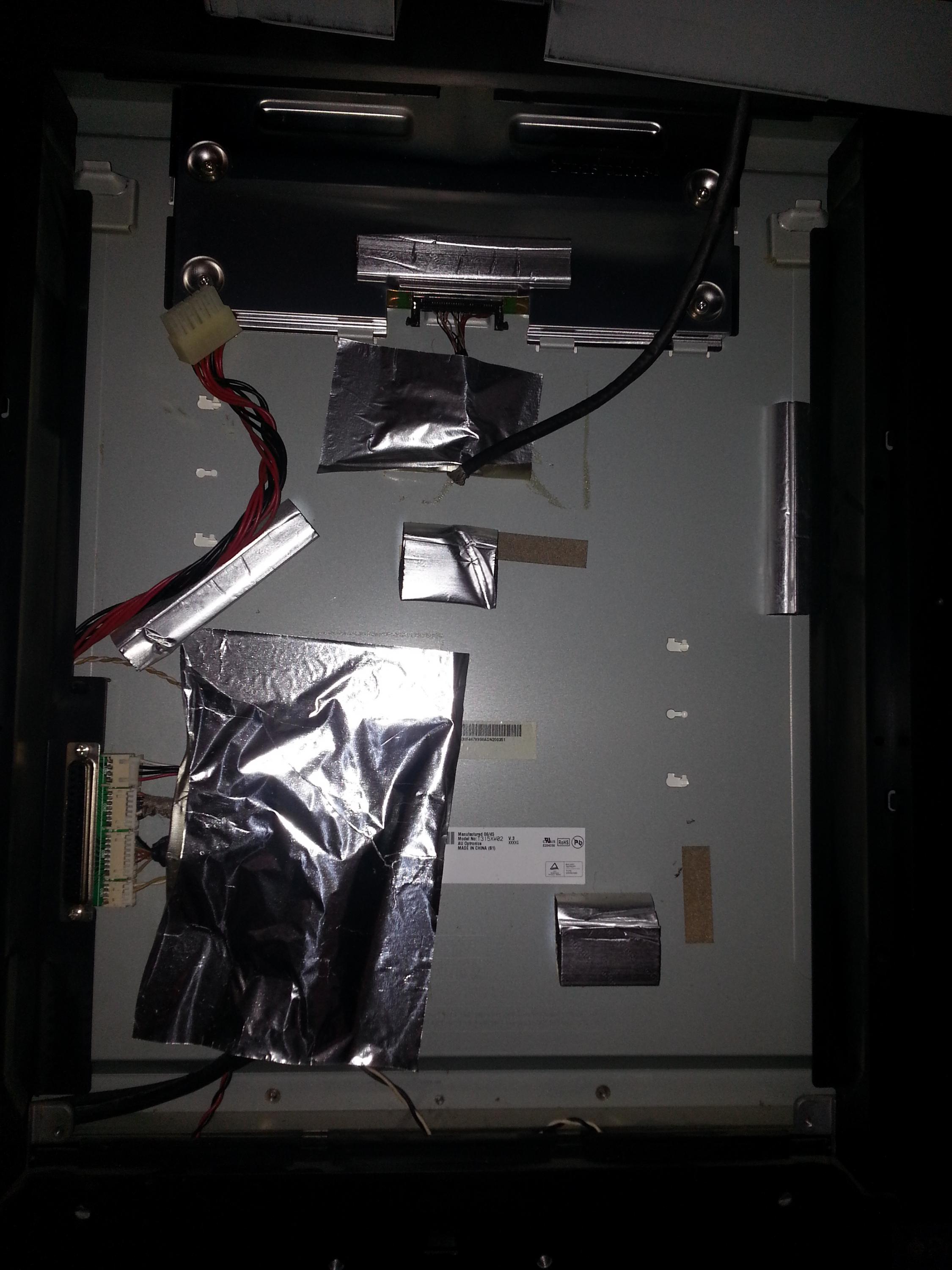

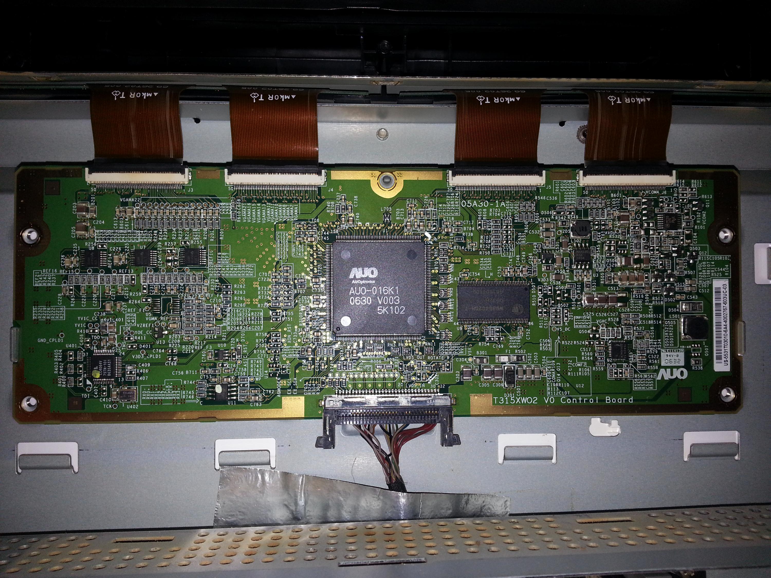

                                        OK got it apart.
