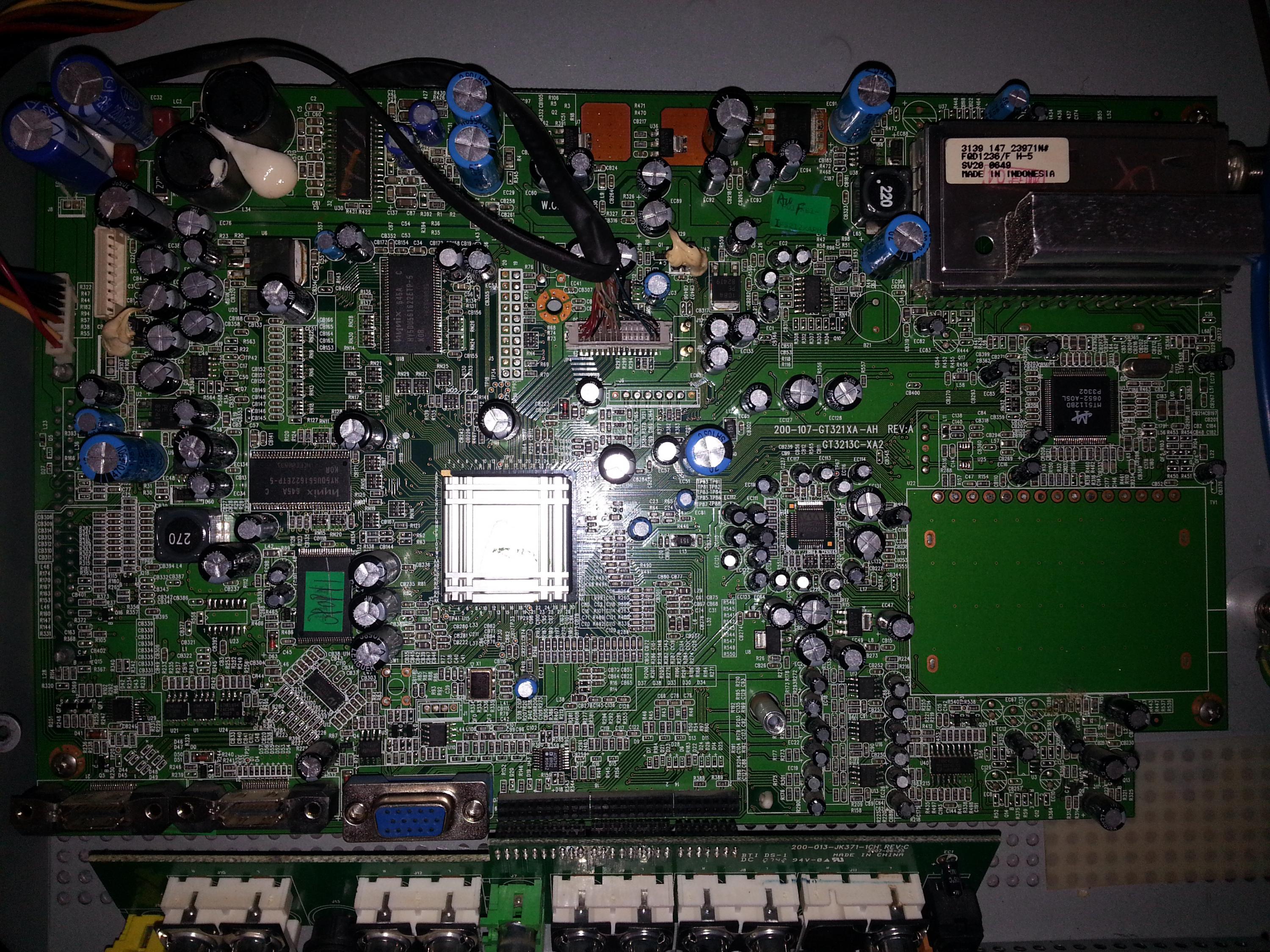

    Not seeing a 50 pin connector.
    • CapLeaker
      Leaking Member
      • Dec 2014
      • 8130
      Re: Polaroid 3211-tlxb

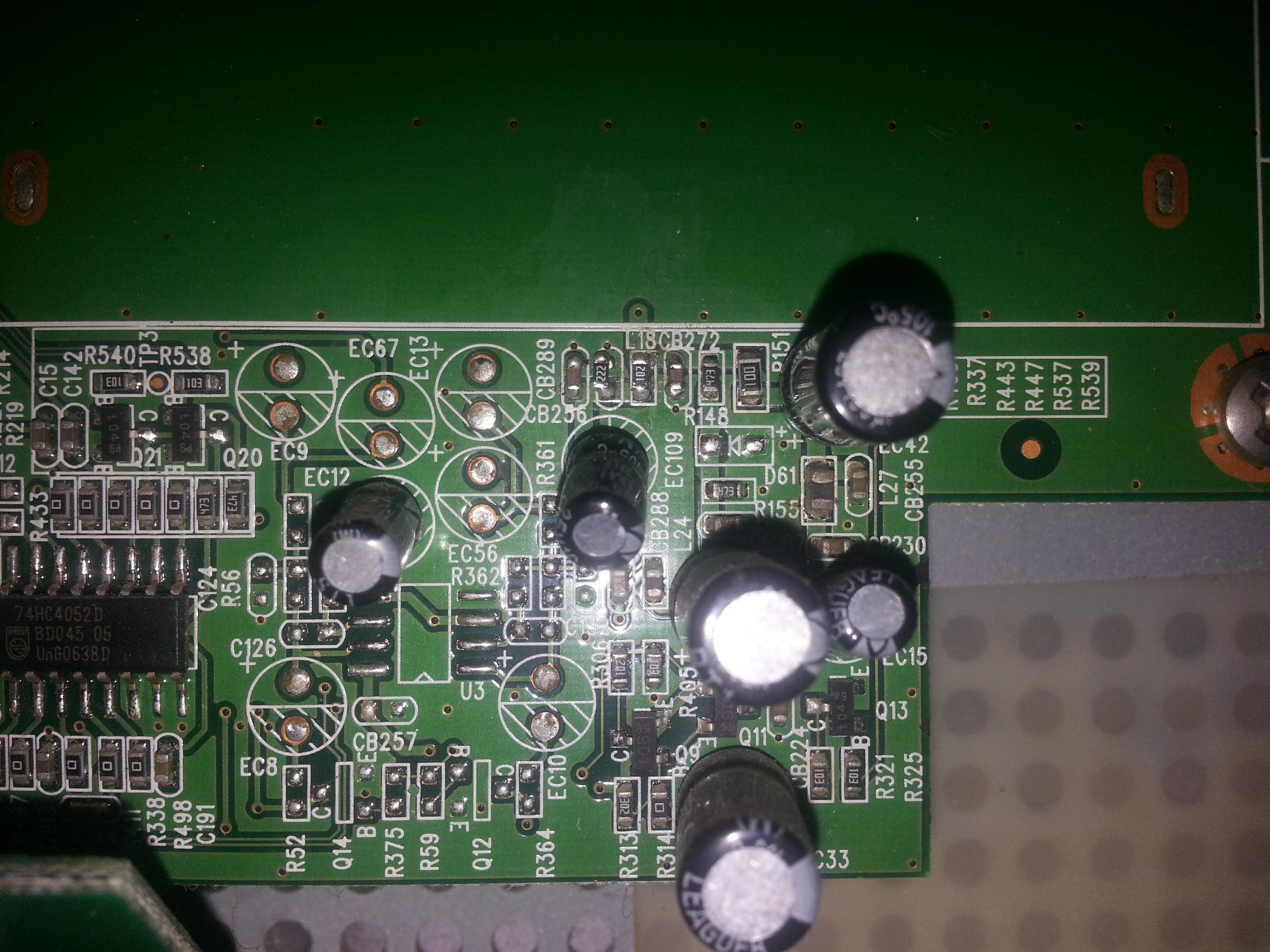

      I see corrosion on the bottom right.
      • junktv
        • Nov 2010
        • 3065

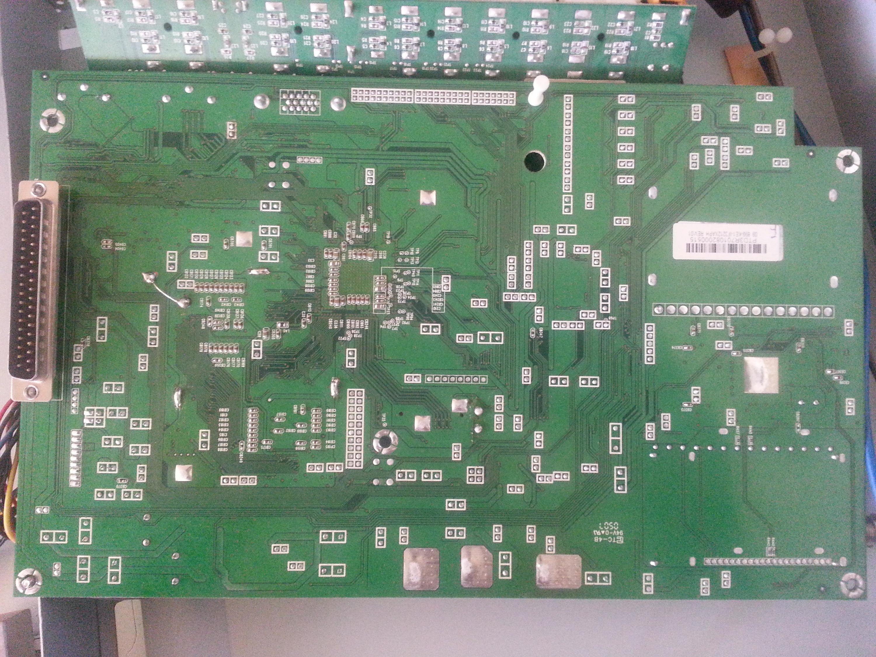

        I noticed that and cleaned it up already. Also noticed a weird jumper on the back.
          He meant that big 37 pin connector on the back side.
          I got no clue what that's for.

              Nope... I don't... That's just randomly throwing parts around. Got to find what is acting up first. Is it the mainboard not sending the correct signal or is it PSU. We still haven't confirmed yet what the state of STBY, PSon and BL on is when your TV acts up.
              Frankly I don't really think it is a PSU problem, I am leaning more towards the main board.

                              Your problem is on the 5V rail on that main board and x2 what budm said in his last post, problem being either the processor itself or around it. Since there was corrosion on the board earlier, I would not be surprised if there are cold solder joints underneath the processor itself ( the one with the silver heatsink on it) You could try a reflow or bake it for a while as a last ditch effort.
