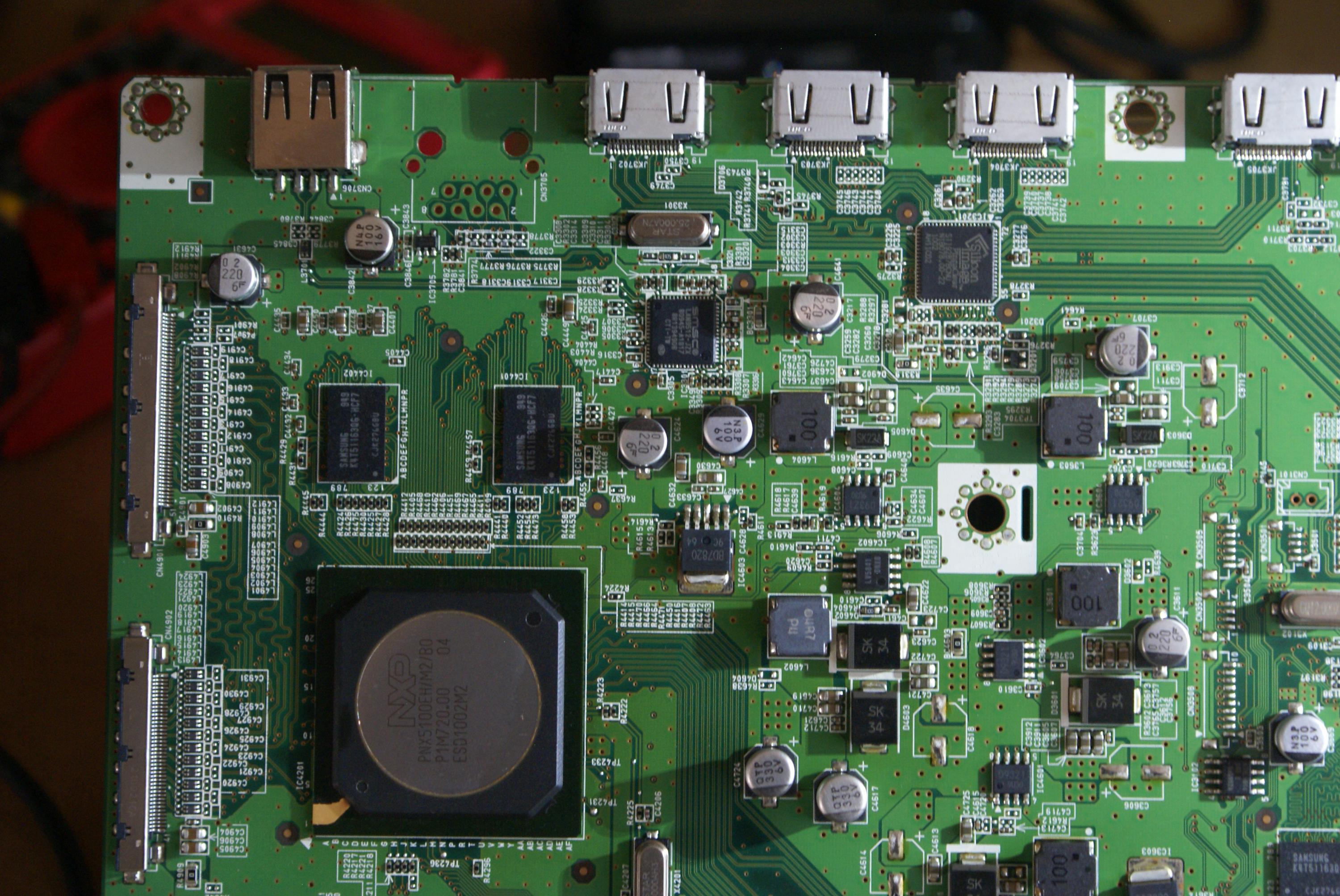

                              • krygods
                                • Dec 2014
                                • 257
                                #75
                                Re: Philips 46pfl5505d/f7
                                Here are front and back shots for the time being. As soon as the DSLR is done charging I'll get some Hi-Res pics of the front and back.
                                I believe this is a link to the service manual if I'm not mistaken.
                                http://www.manualslib.com/products/P...7-1477495.html
                                • CapLeaker
                                  Leaking Member
                                  • Dec 2014
                                  • 8352
                                  #76
                                  Yeah... unfortunately I can't read it. Too small
                                  On pic 1 the lower left corner, that should be the plug for the PSU. Can you make another pic of that section?
                                  Also with pin is the BLon pin on there?

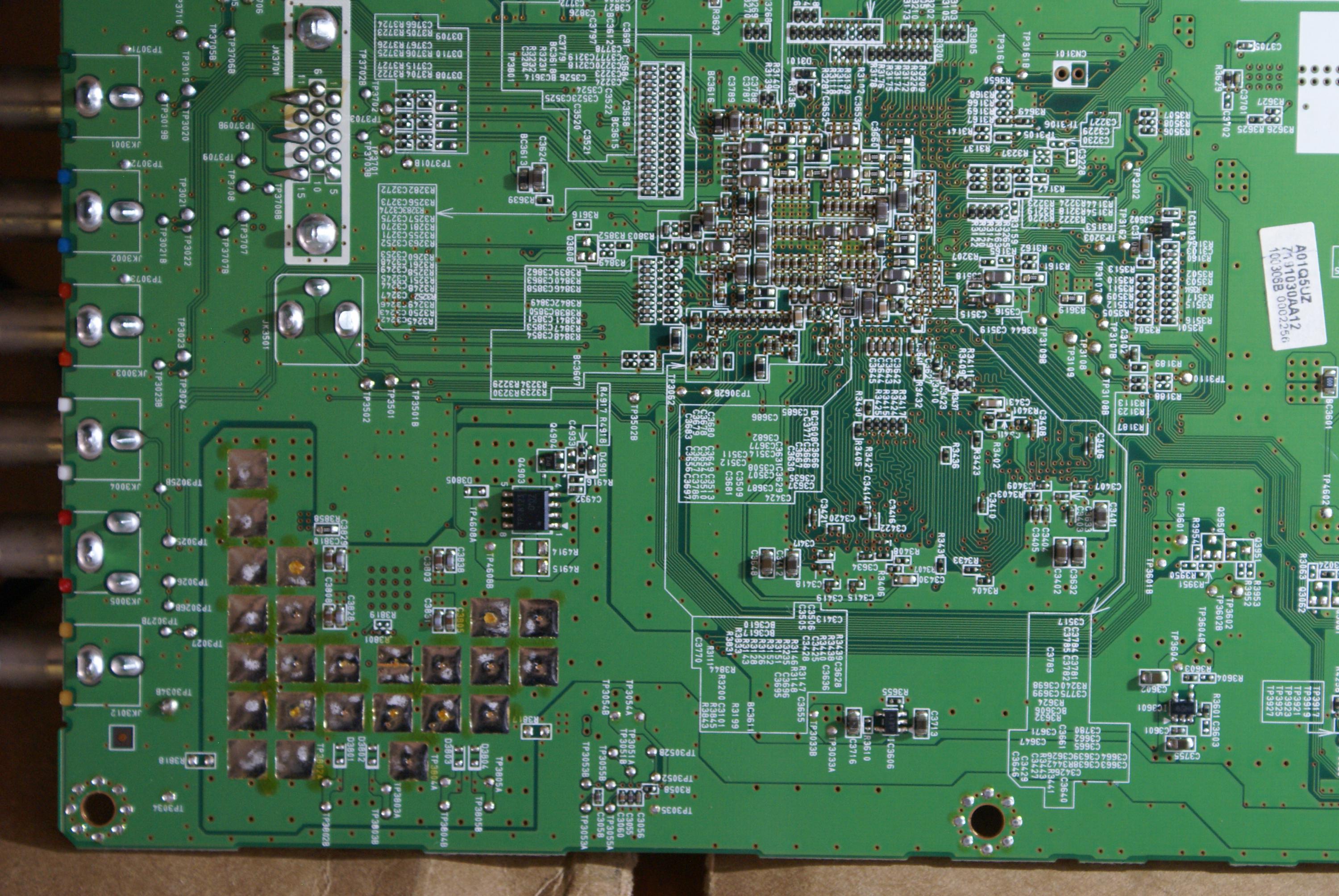

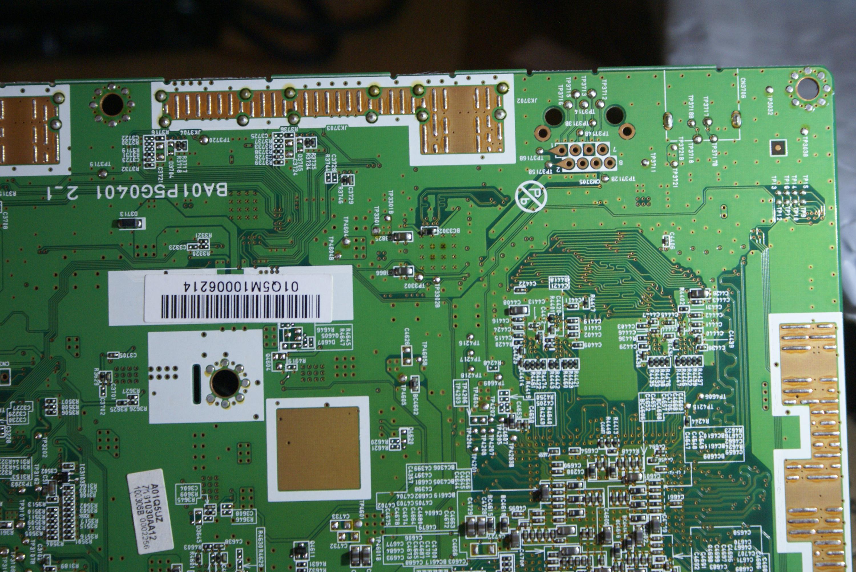

                                  • krygods
                                    • Dec 2014
                                    • 257
                                    #77
                                    Here are some pics of the front side with DSLR camera.
                                    I think the images are being re-scaled after I upload them. The original files are 4MB and now under 1MB after uploading. Hope it doesn't affect legibility.
                                    • krygods
                                      • Dec 2014
                                      • 257
                                      #78
                                      Back side of main board
                                      • krygods
                                        • Dec 2014
                                        • 257
                                        #79
                                        BLsw is Pin 1 of CN3002
