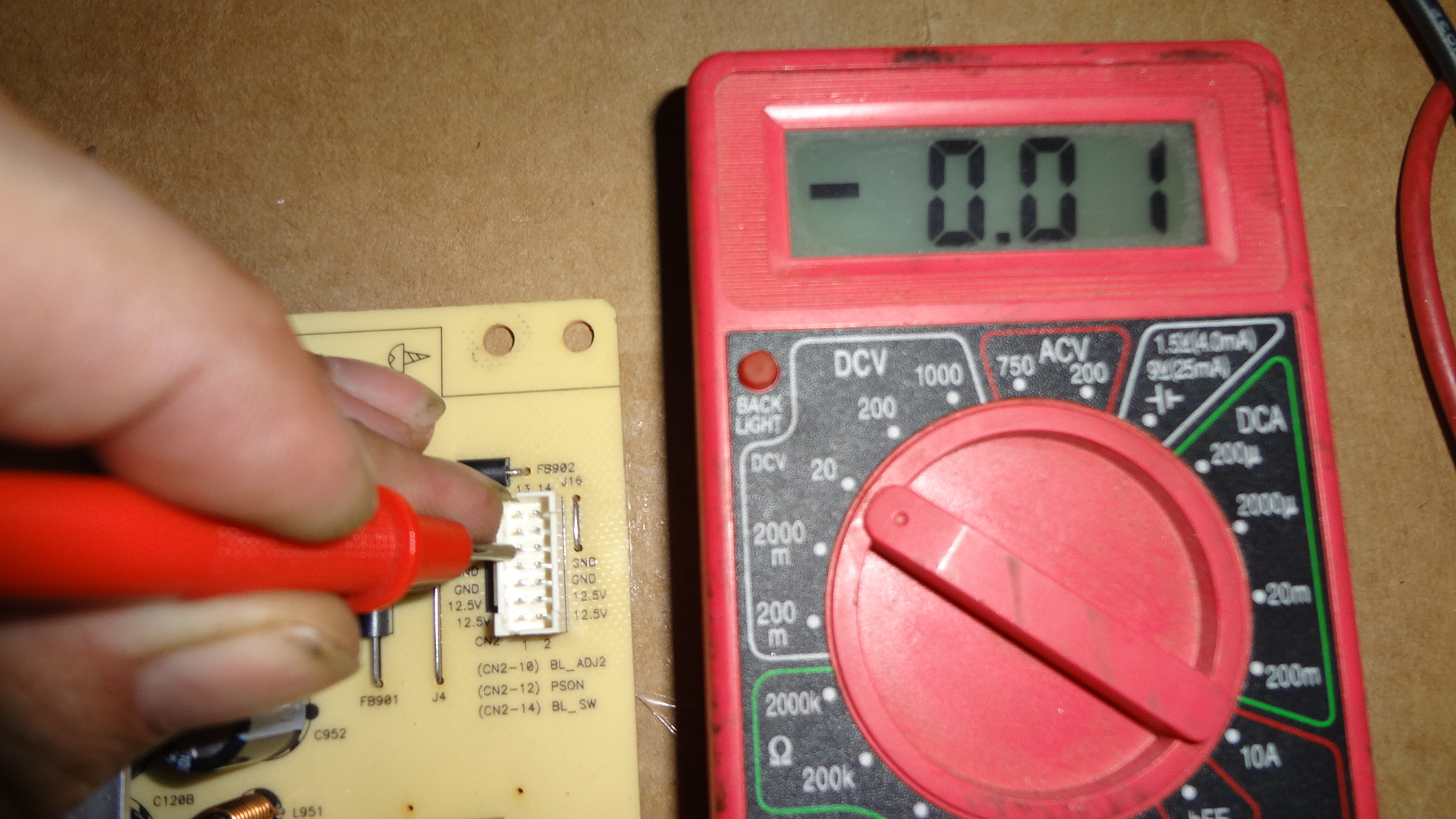

      Here are a few pics showing pins 9 and 11 being tested.
      Using GND pin on CN4 as GND
        #43
        Re: Philips 46pfl5505d/f7
        Where is your Black probe? The Black probe should be on pin 11 (GND), Red on pin 9 (5.3VDC).
        The board is not mounted to the chassis so CN4 24V GND will be tied to the GND of the CN2.

          did you blow that diode again on the 5VSB?
            #45
            He used the wrong ground.

              #46
              I just saw that on the back side of the board.

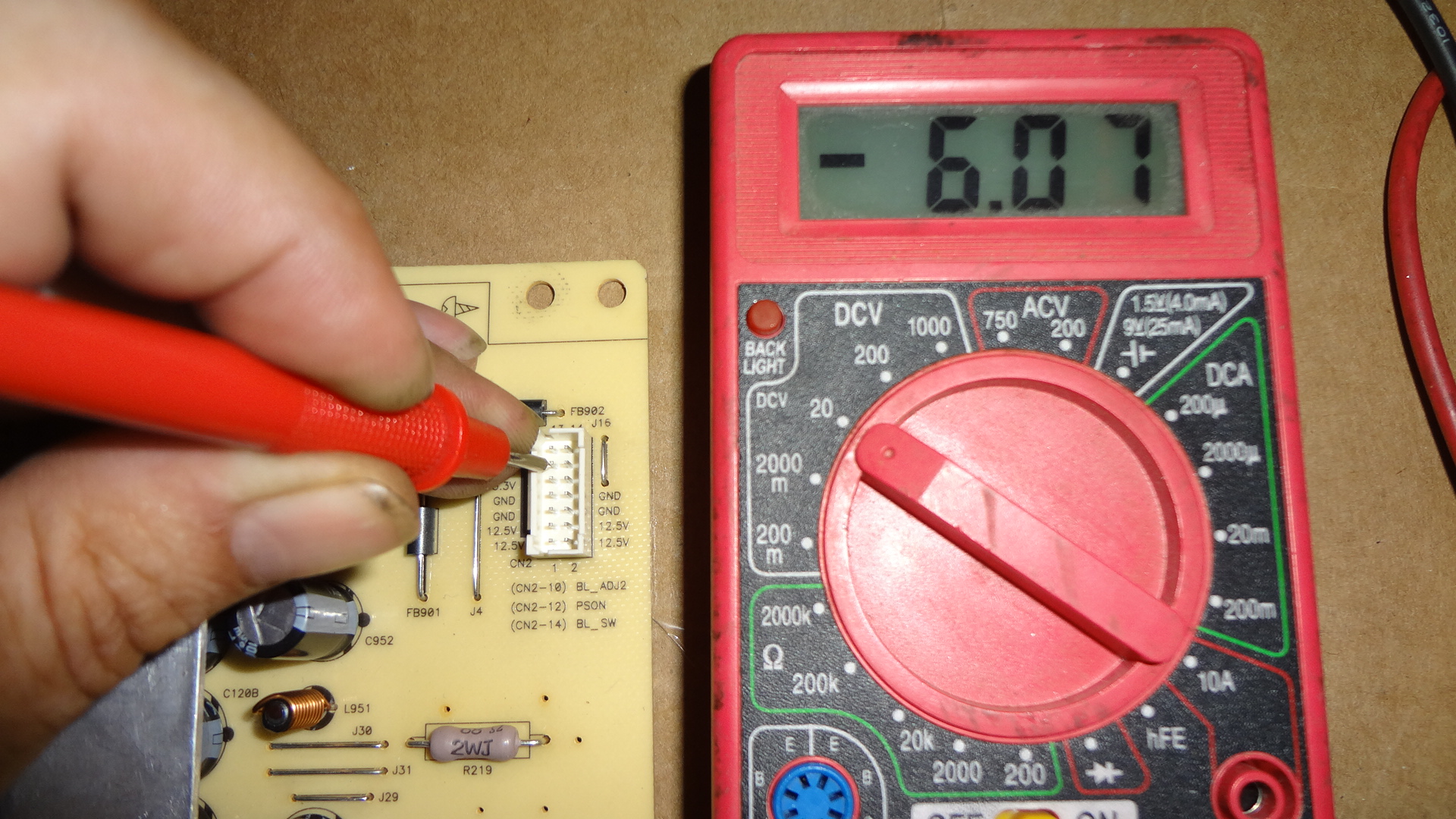

                #47
                Ok after using the proper GND (Pin 11, thanks for teaching me something new) Pin 9 does shows 6.1VDC

                  #48
                  That's better! With the main board disconnected, force the PSU on. Check all the voltage rails (and watch the GND) lol.
