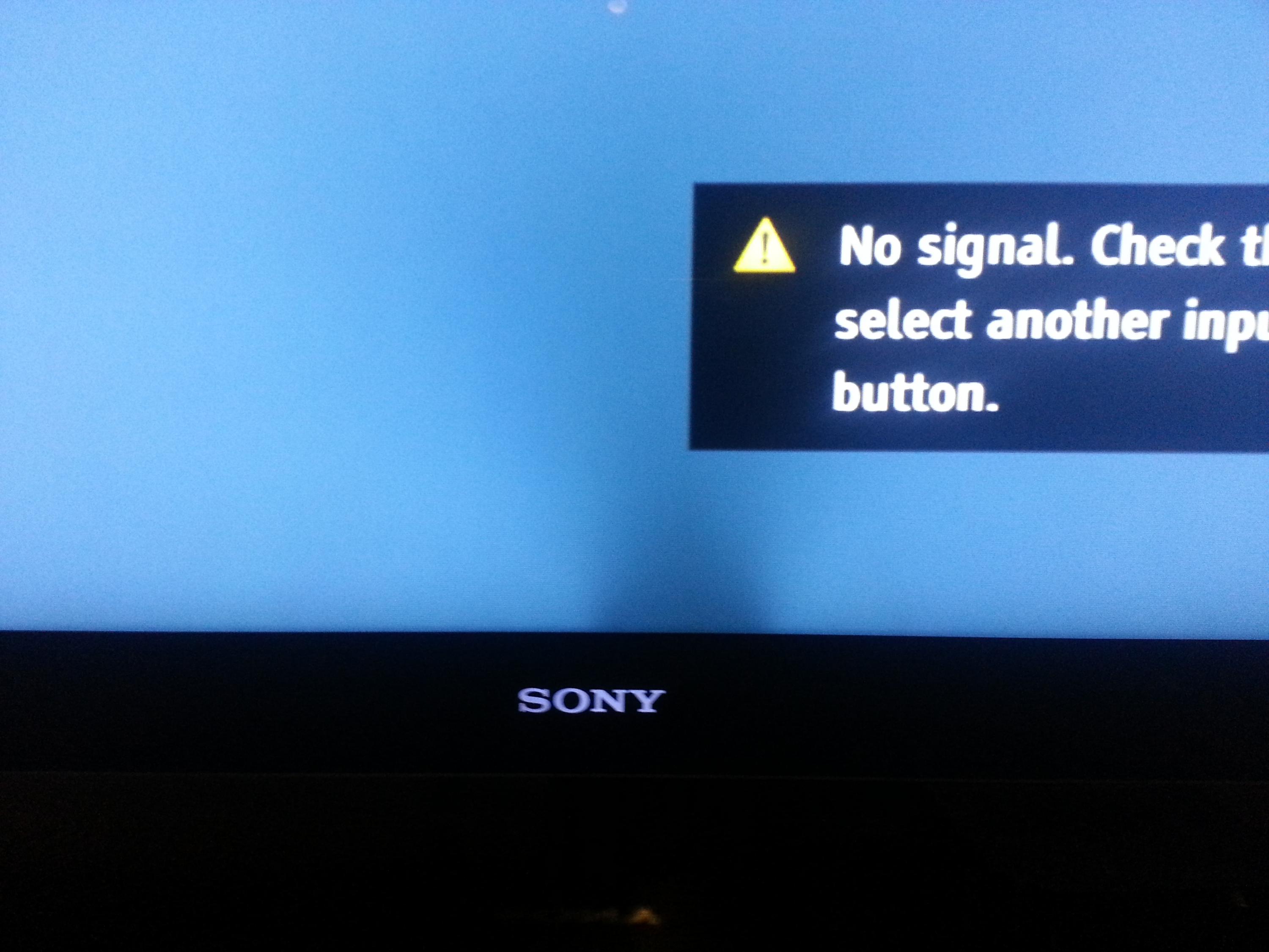

          Re: Sony KDL-46NX720 4 Blink error (with pictures)
          bad led would appear as in the pic attached.

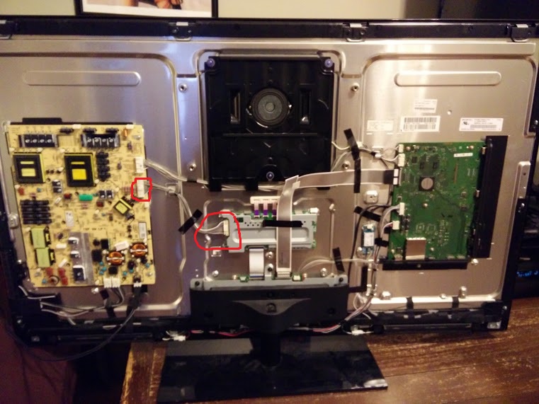

              On the circled connectors are any of these labelled
              BL-err
              If u have bl error wire
              You can gorund this to bypass the error and see what happens..
              • icethecold
                • Aug 2015
                • 10
                Alright, I grounded BL-ERR, I attached a better picture of which pin it was and how I grounded it, though it wasn't on either of the connectors you circled.
                Here is a video of what happened also:
                https://drive.google.com/open?id=0Bw...nVGdFcyc2tSRDg
                Basically it turned on like normal with sound, sound disappeared before the picture (also normal), then the screen goes blank (also normal), but the TV stays on and does not produce the 4 blink error code. So what does this tell me?
                I also tested all of the fail test points on the LD board. All the test points read 2.82V-2.83V when the screen was lit and 0.077V-0.078V after the screen goes dark.
                Also, I'll start using the bad caps file attachments for historical purposes, so in case the links to my google drive get broken, people can still see what the discussion is all about.
                Thanks again for all the help so far guys.

                                      Hmm, so I took off the psu board and tested a few components(apparently my multimeter doesn't do capacitance...) they do seem to give the correct values taking into account the components are generally hooked up in parallel, and are charging capacitors due to the meter being in ohm mode and the circuitry.
                                      I think I've come to terms with spending money on this and just buying the boards(now that they are up on ebay)...could someone give me some reassurance, or some tests I could perform that would give me reassurance that even if I do buy a replacement board for every board in this tv, that it will eventually work?
                                      Thanks,
                                      Sean
                                      • icethecold
                                        • Aug 2015
                                        • 10
                                        Hey guys,
                                        I wanted to update you all, I got the TV working! Thanks so much to all of you for your help and feedback. It turns out that the first LD board I bought was not working.
                                        I bought a new PSU board, and it luckily came with a new LD board too. I installed just the PSU board assuming the LD board I bought first was good. However the problem persisted. So I put in the new LD board that came with the PSU, and it all worked!
                                        The first LD board came in bubble wrap, so I figure if the board did work before the seller shipped it, it might have been fried by ESD. The PSU and second LD board came in an anti-static bag.
                                        I suppose it is possible that the original PSU board was faulty and fried both the original LD board, and the first LD board, but I kind of doubt that.
                                        tl;dr: The problem was the LD board.
                                        Edit: I couldn't find anything to make this thread as solved, maybe an administrator could do it.
                                        Thanks again,
                                        Sean
