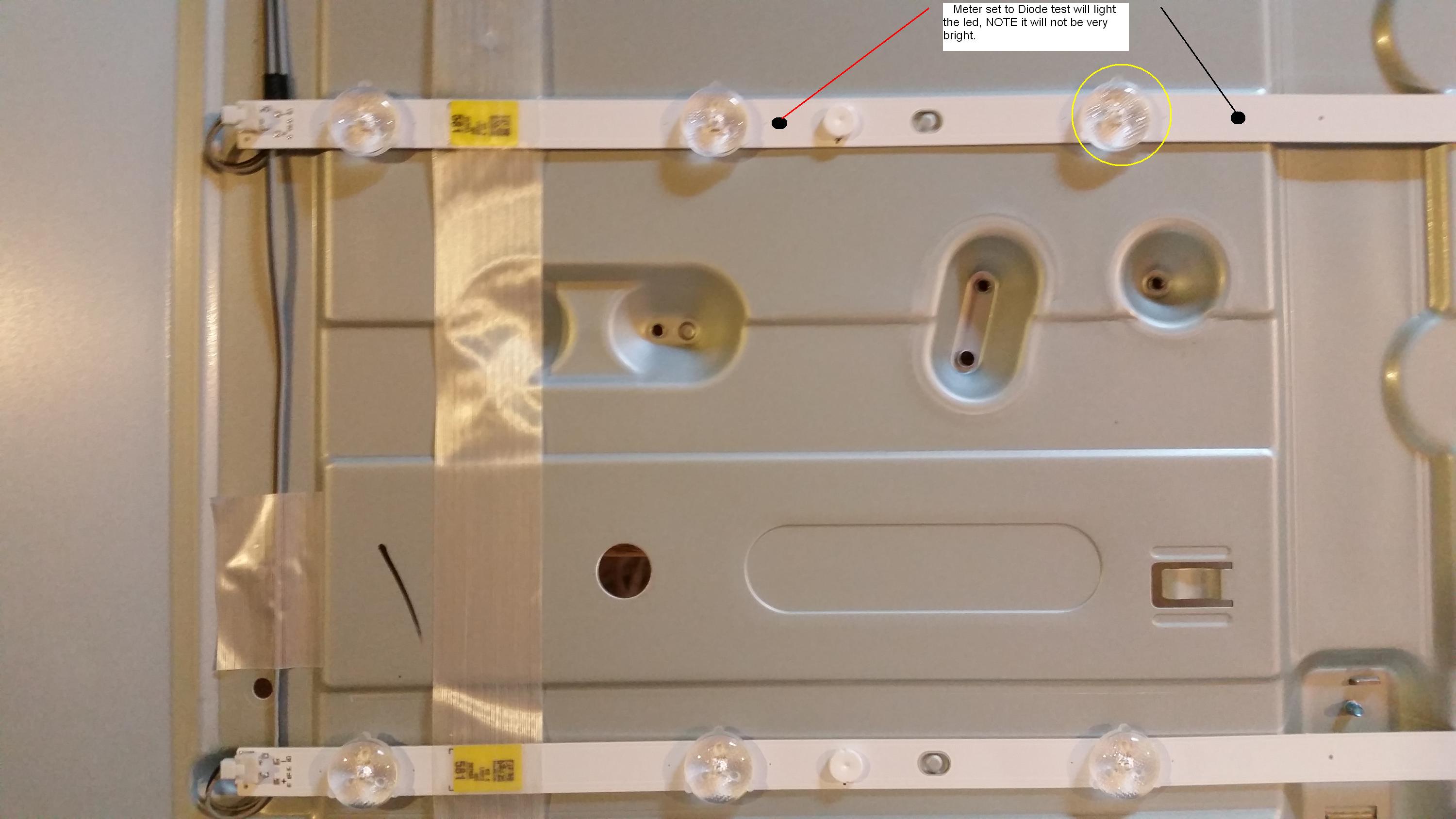

                I just looked at one of these Samjunks, The led voltage at the plug is around 210 volts unloaded with the set on.
                I opened the panel and there was one shorted led and 3 open leds. The one shorted led was on the 5 led strip, the open ones were on the 6 led strips.
                The led's can be checked by pushing your meter (set to diode test) probes through the white paint to contact the copper trace, this eliminates removing the lens from each led to check them
                the 5 led strips can be checked by supplying them with about 12 volts accross the plug that connects to the 6 led strip

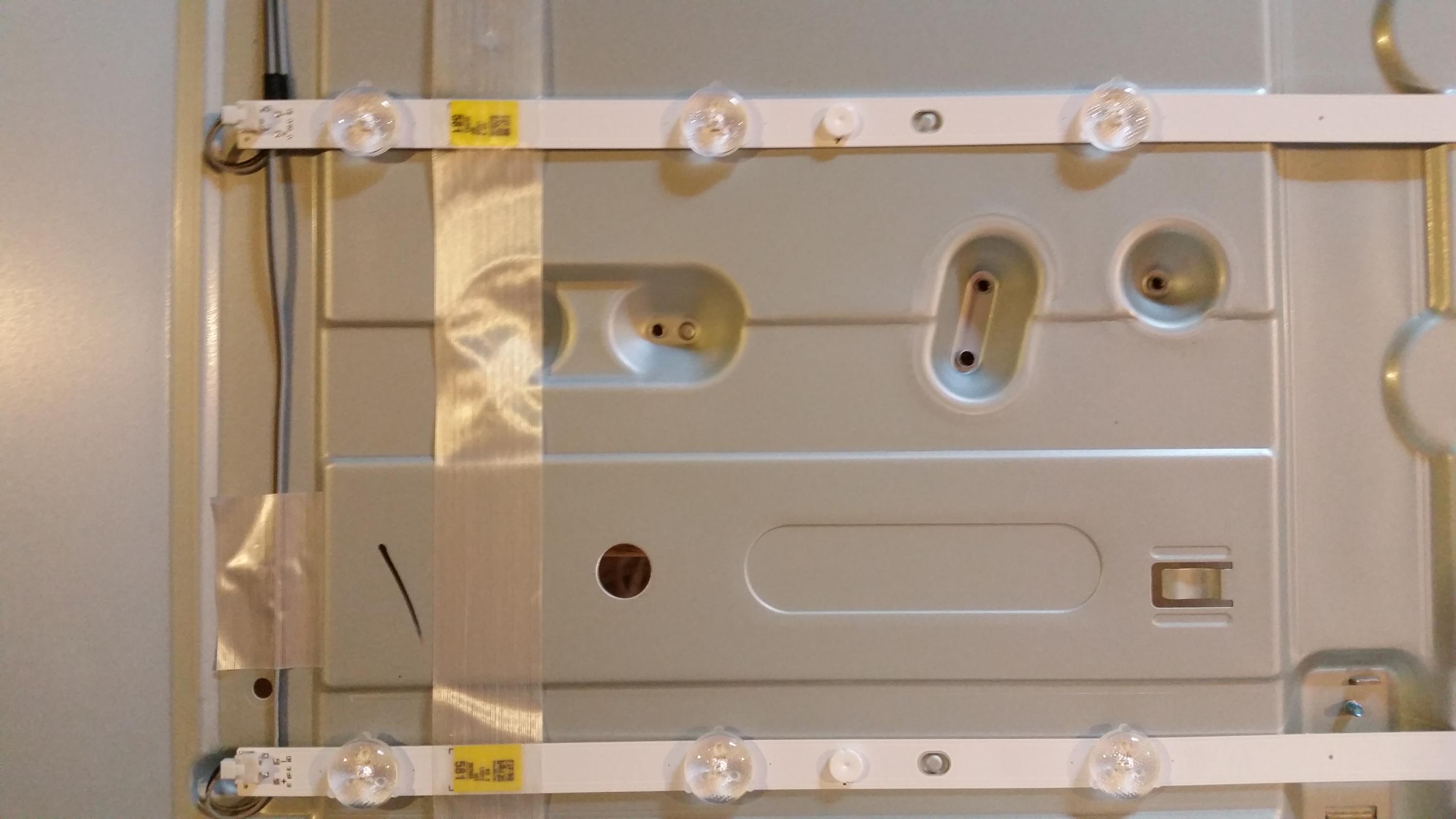

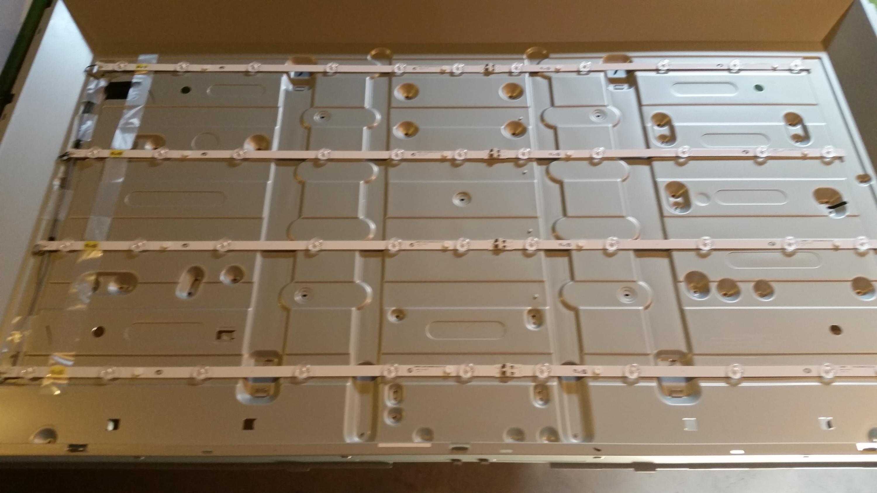

                    ok i got this thing open but i have no idea what to do next.
                    i managed not to break anything so im happy with that.
                    i just don't know where or how to test these with 12v.
                    here is a pic of what i am looking at.
                    hopefully R_J you can direct me a little bit more.
                    thanks so far for all the help

                      I salvaged diodes from a led strip from another led tv with a broken screen. Do you have a meter with diode test?

                        Make sure all the connect on each strip is seated properly.
                        Look real close at each LED, you may see one or more that has turn brown or black.

                          ok went through each strip. 2 bulbs do not light. both are on 6 bulb strips. both are first bulb in the strip near power connectors top 2.
                          Anywhere i can buy a couple of replacements?
                          How do you remove them off the board
