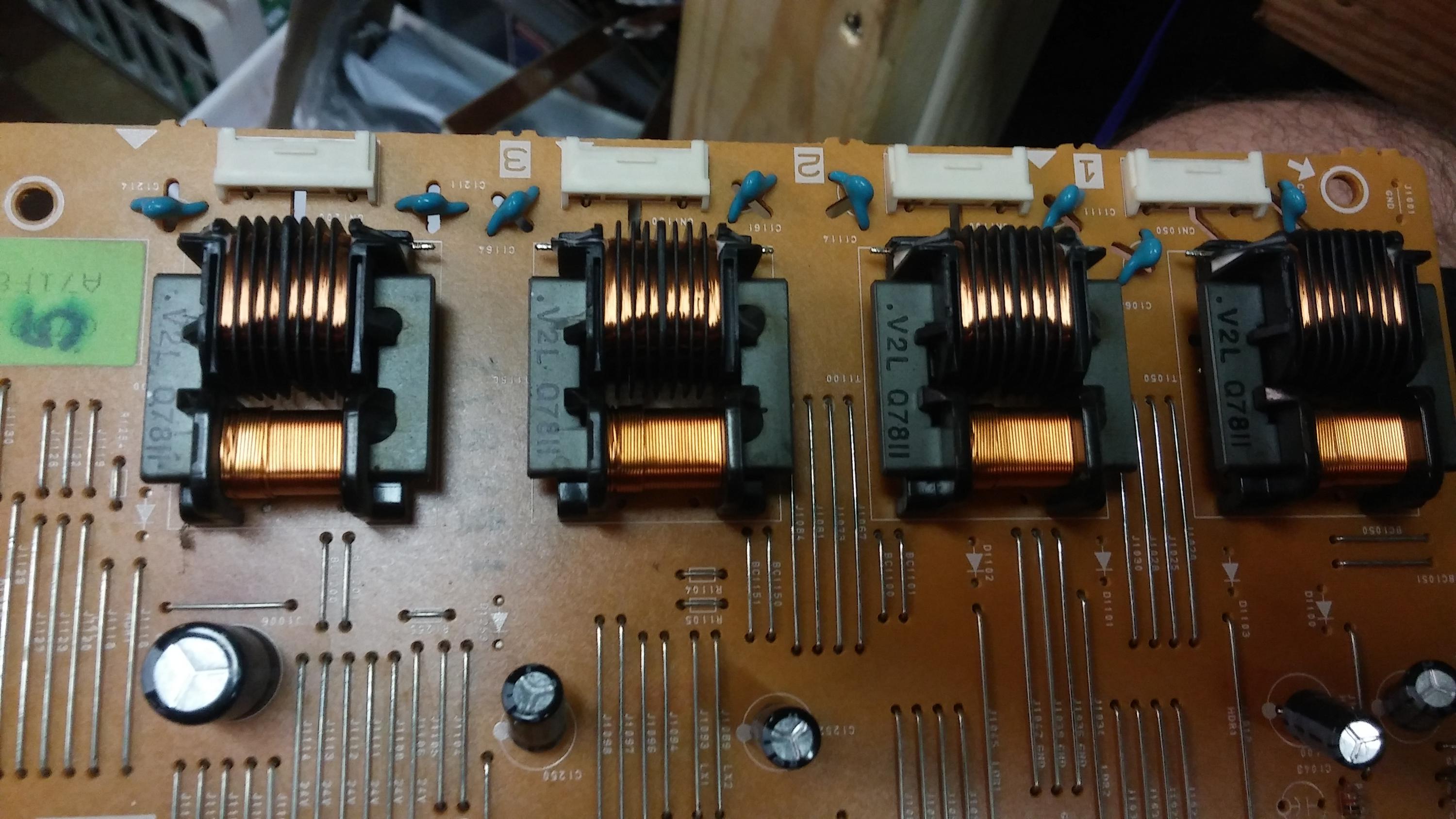

    im trying to find which transformer is bad can anyone tell me how to test these? I was told to Ohm out the secondary (small windings) of each transformer to find the one that reads >0
    but I don't know what windings are ive never learned how to test a transformer please help with pictures also if you can thanks

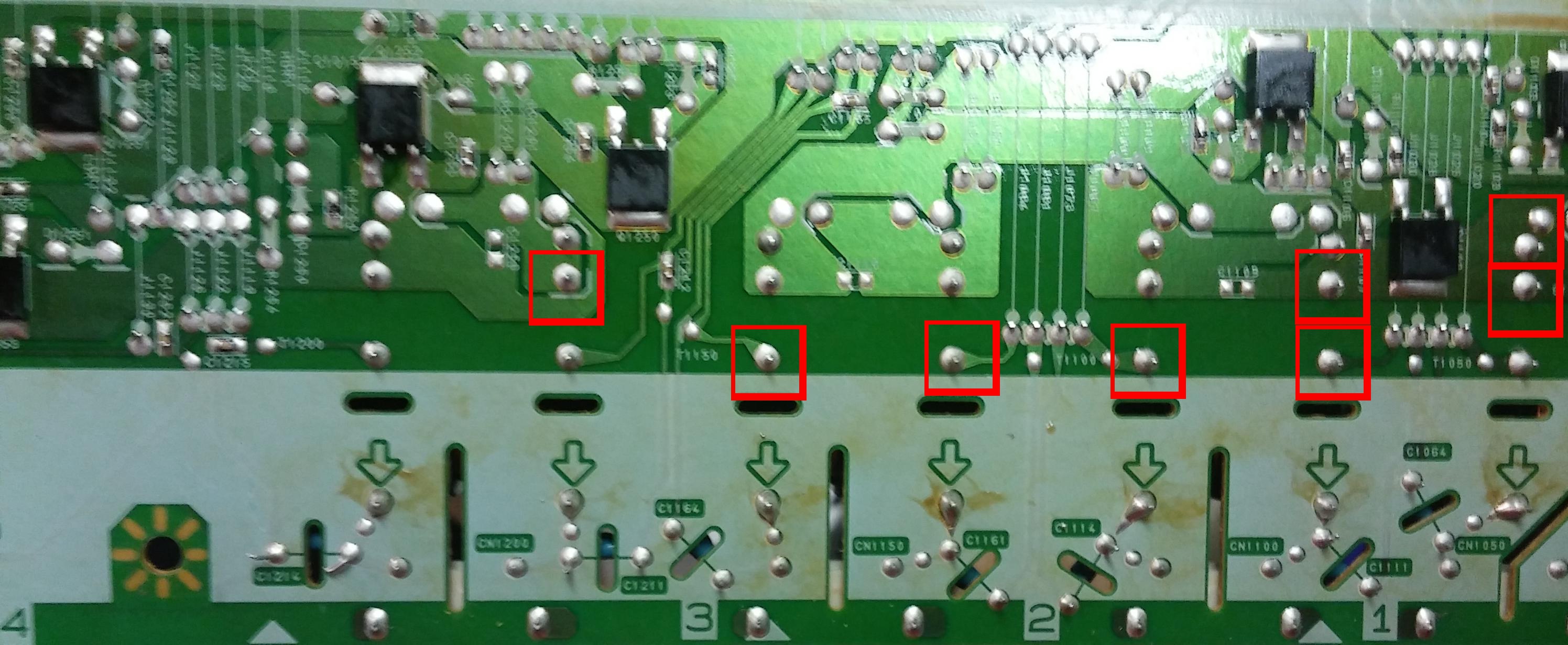

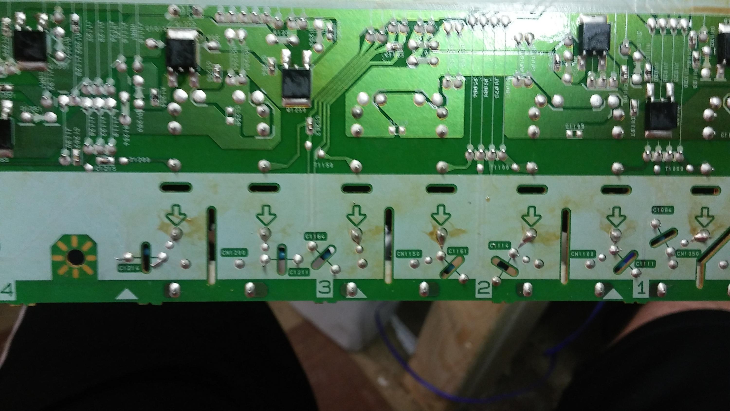

      • 31003
      Re: help me to test transfromer?
      those transformers have cracked soder joints.
      • R_J
        • Jun 2012
        • 9535
        Measure the secondary of each transformer (circled in yellow) It should read around 900 - 1100 ohms, but each of the 4 transformers should read the same if one is lower or higher it is most likely the bad one.
          Are these transformers to CCFL backlight to a Screen or monitor?
          • mattstolte
            • Dec 2013
            • 612
            • usa
            these are for a 32 inch emerson lcd, I put my meter on 200k ohm they all read 112-115 the tv turns on them after 30 seconds shuts down
              I don't see any cracked solder joints from the pics. Please point them out for us.

                    • 31003
                    probably more - the blured pic dont help!

                      • SteveNielsen
                        Retired Tech
                        • Jun 2012
                        • 2327
                        I consider it to be inconclusive. It is just too blurred to tell. Nothing looks shiny where it is that far out of focus.

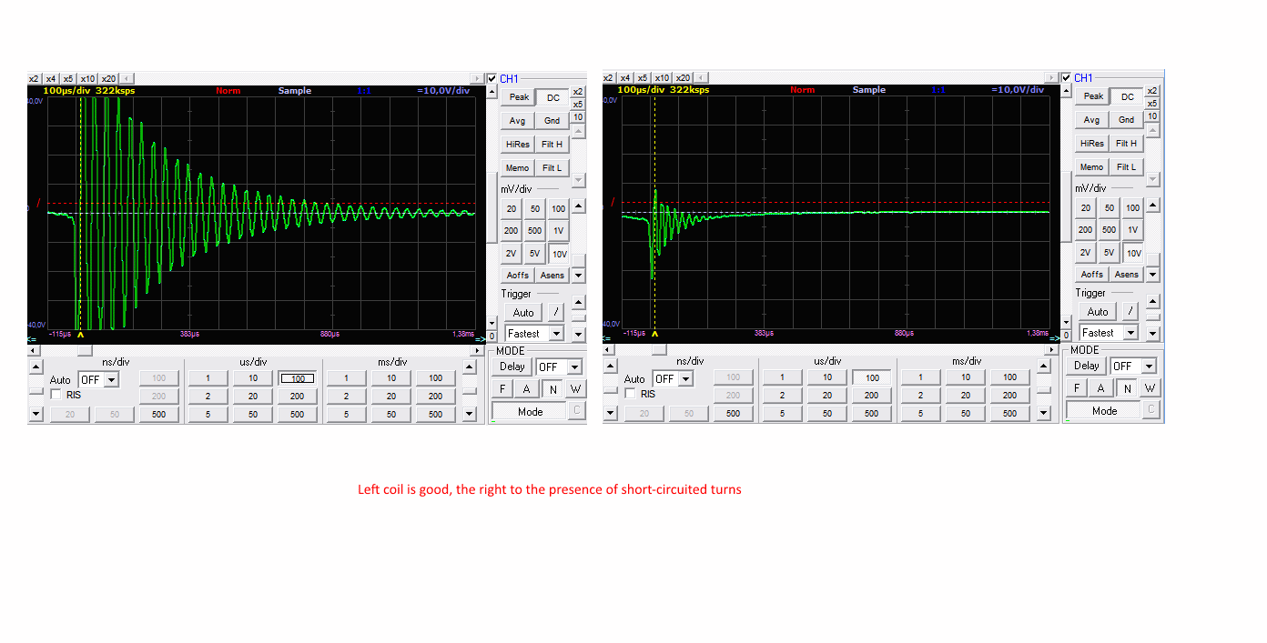

                          • R_J
                            • Jun 2012
                            • 9535
                            try only hooking up one ccfl at a time, disconnect lamps 2,3, & 4 and see if the # 1 light flashes on. then disconnect #1 and connect #2, then repeat with lamp 3 & 4. if a lamp does not light (for example #2) connect #2 lamp to transfomer #1 or #3 and see if it lights.
                              Originally posted by CAIIIA
                              Ok. Add full picture.
                              So I do not know if op has a scope, etc. to measure 800 volt P to P on 100 usec div.
