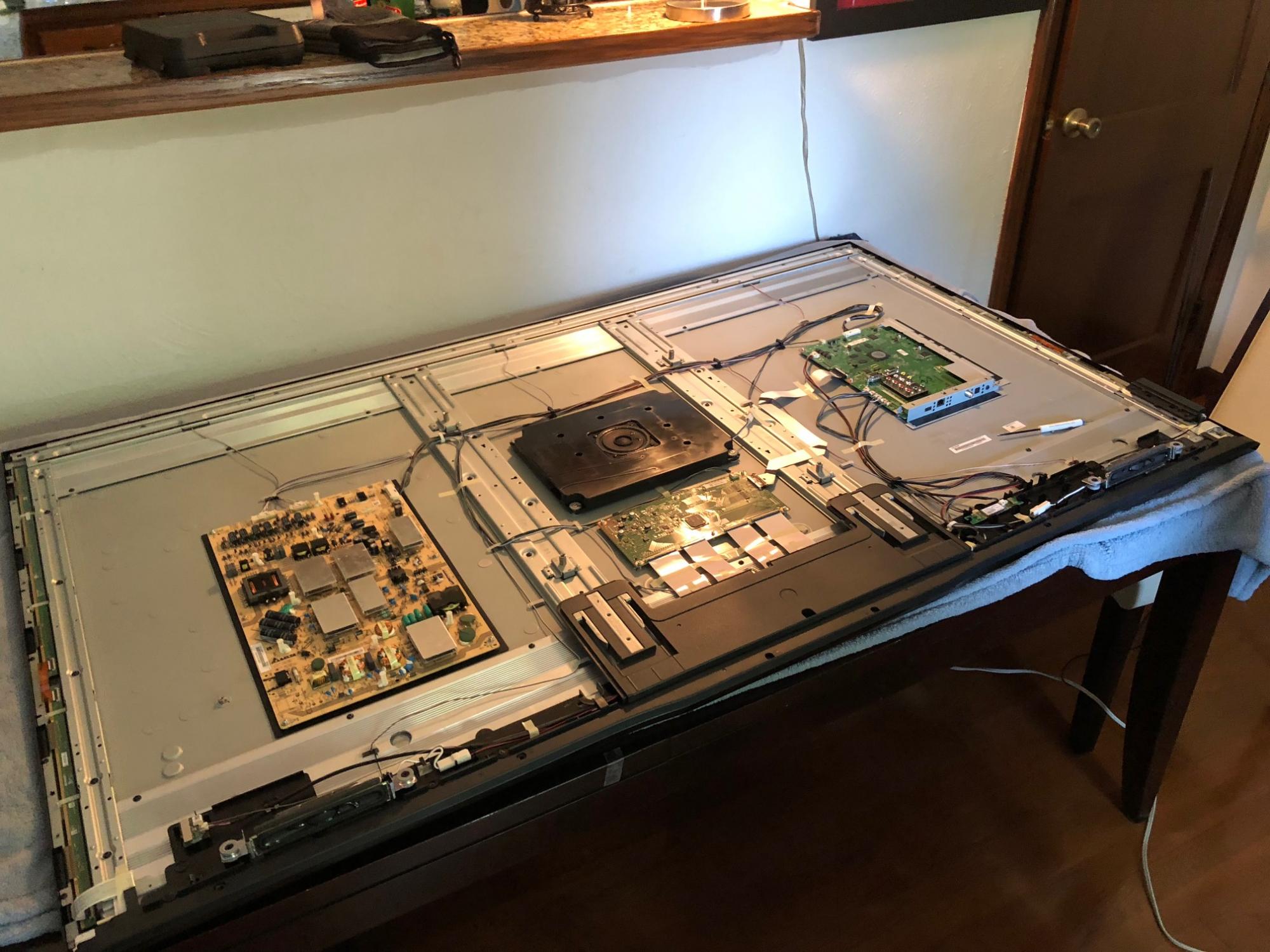

        I just picked up a FREE 70" 70LE757U yesterday. I was getting the 2 slow, 5 fast blinks. I unplugged the 2 ribbons from the T-Con that controlled the right side, and the TV powered on, but obviously with only half the screen. Every thing I found online said the panel was dead....then I found this thread!
        I figured, what the heck..I'll give it a try. So I removed that side of the bezel to get to where the ribbon attaches to the panel, and removed those ribbons. The right side/top ribbon showed a burnt chip. I removed all the ribbons and the TV powered on and looks great!
        Thanks for all the info, and great save!

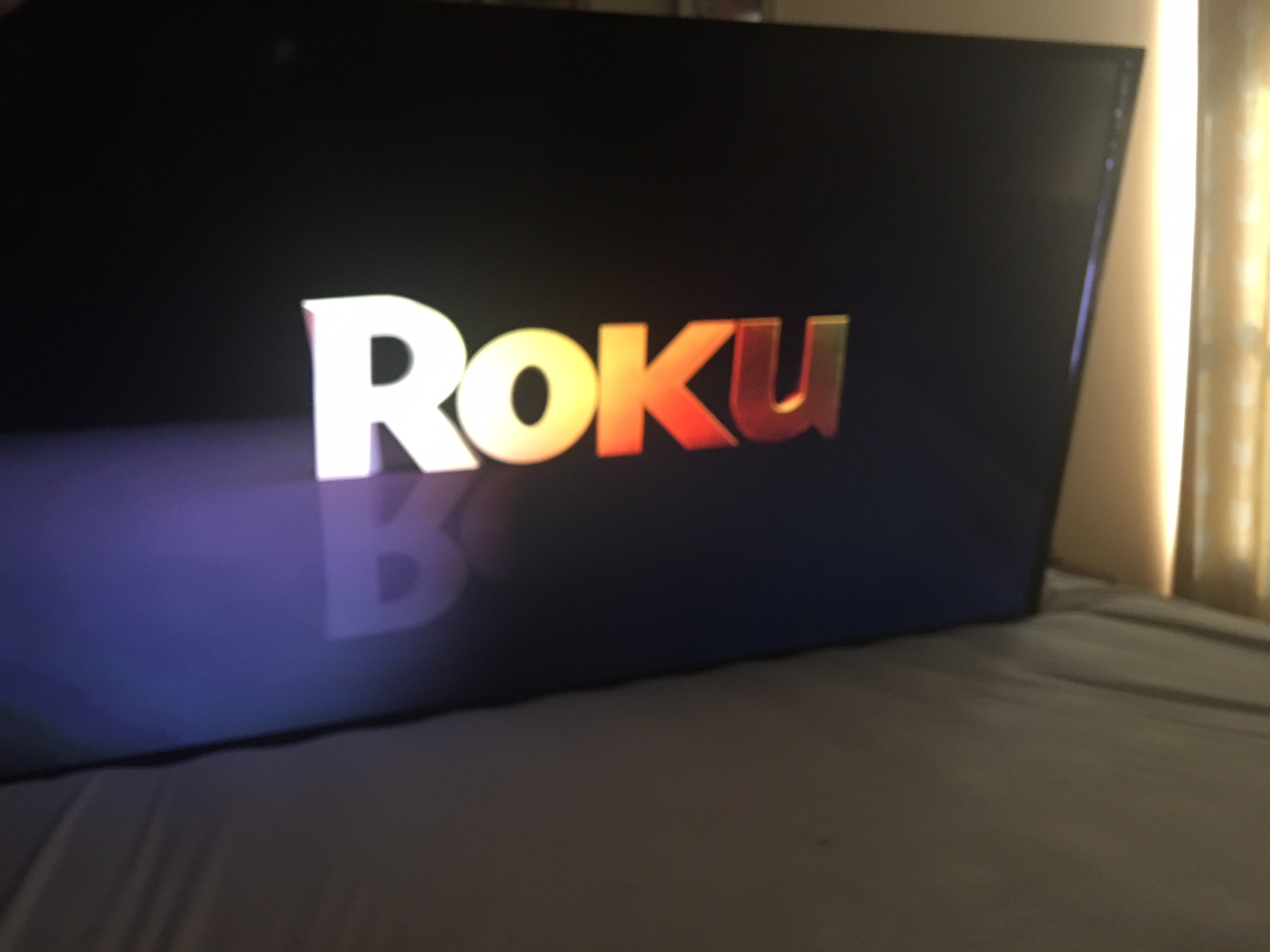

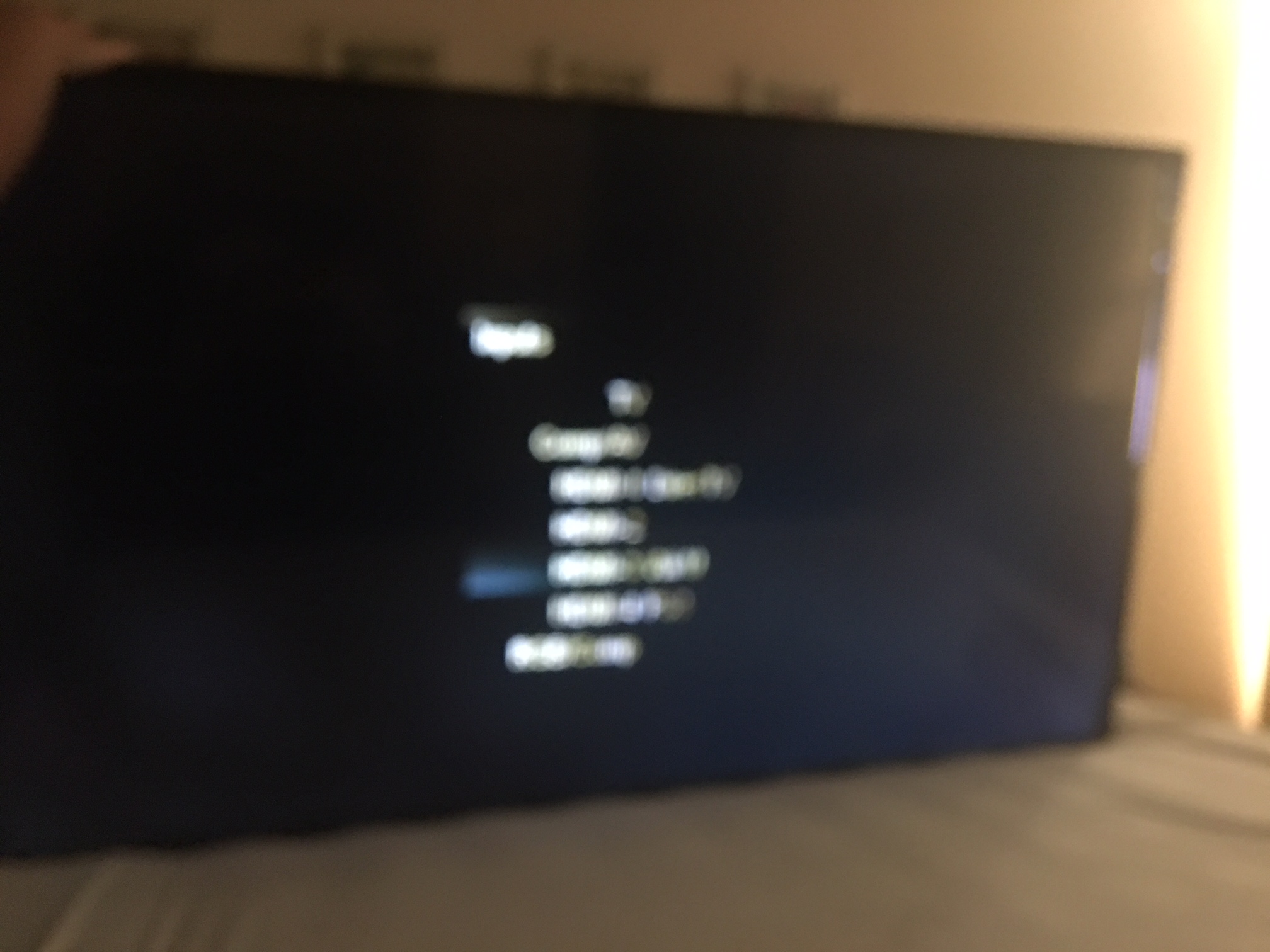

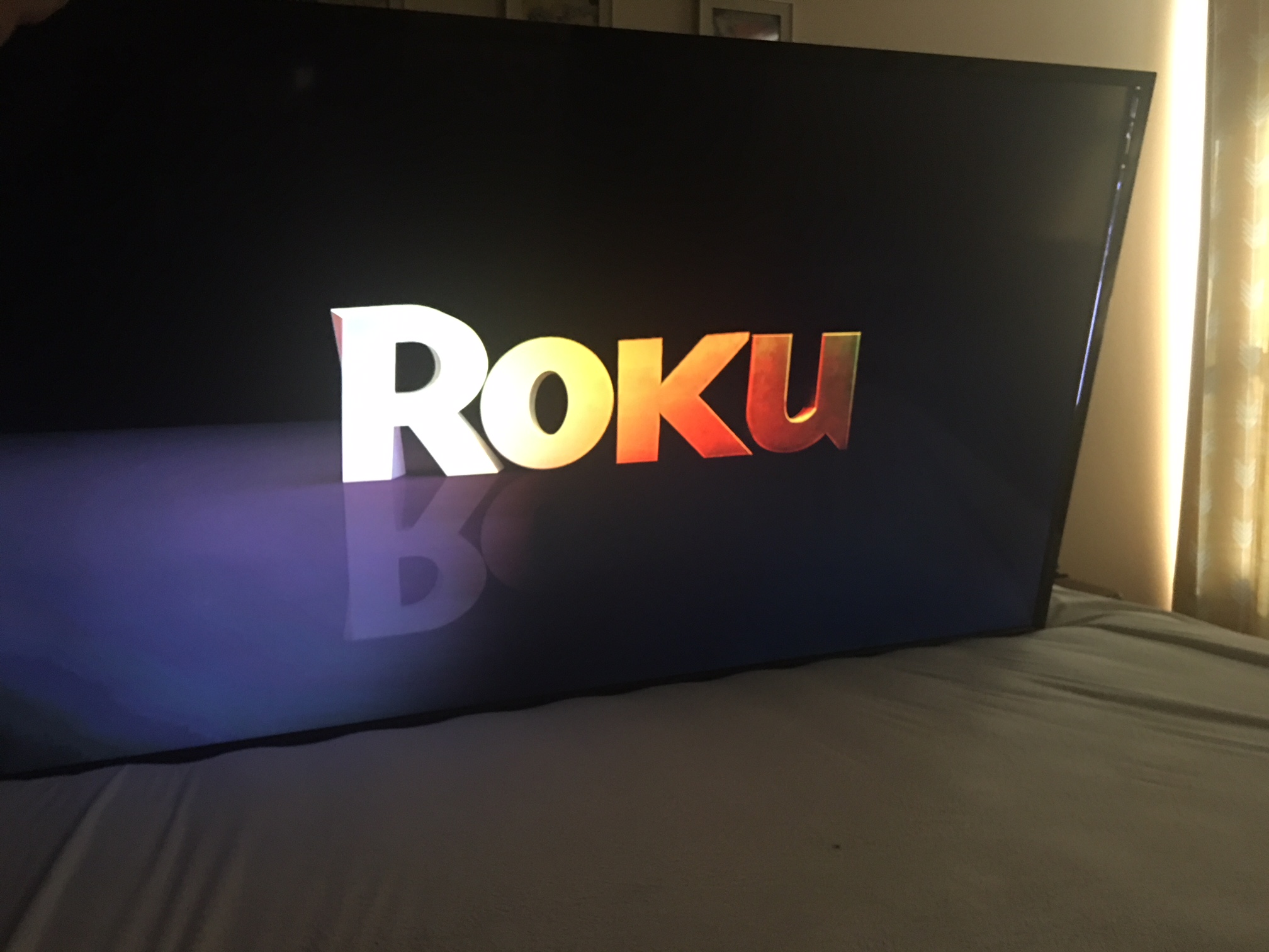

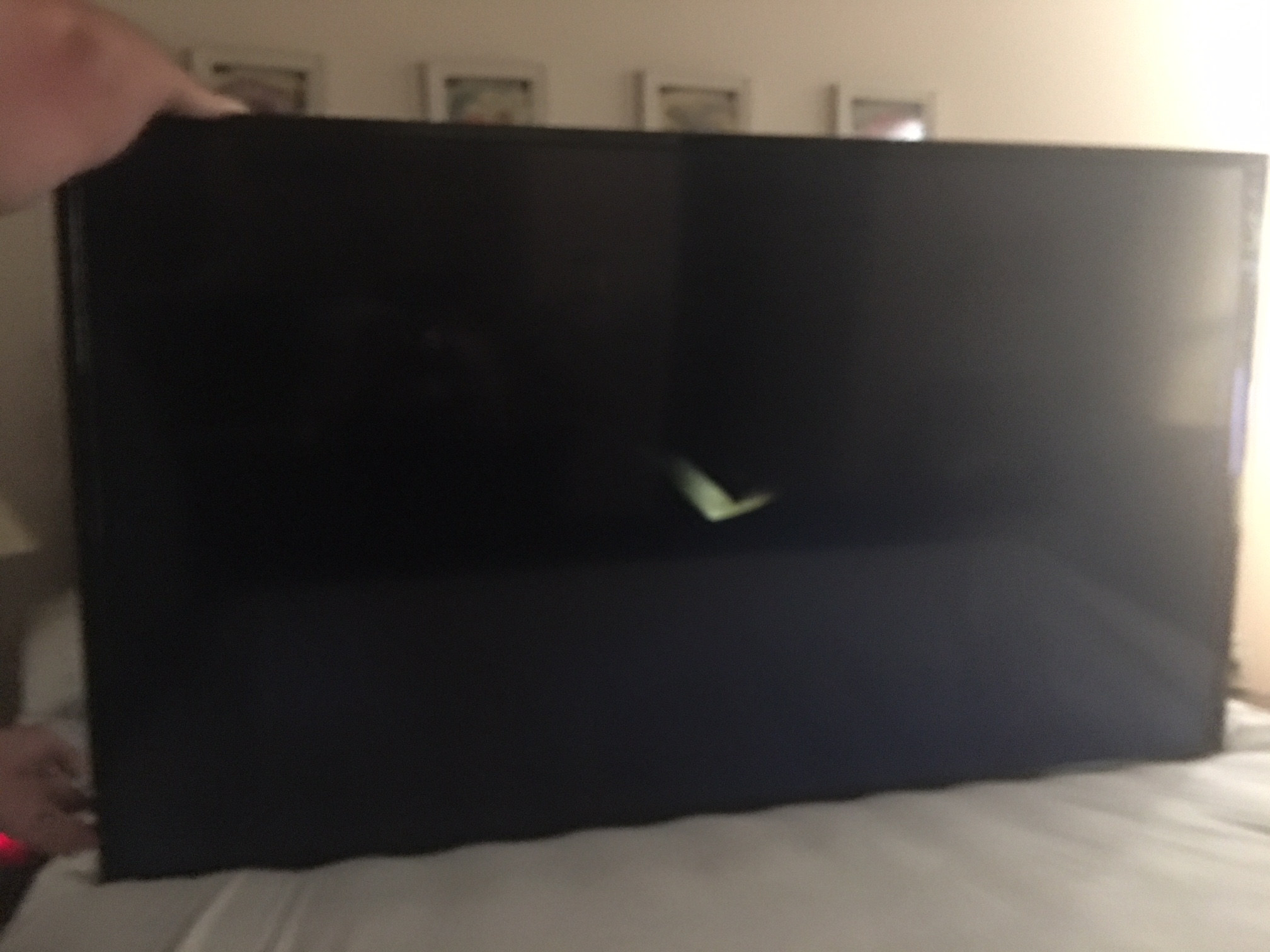

          Hey Guys, I posted in the other thread, but this one appears to have more life to it, so I'll post here as well, just in case..
          Looks like the Right side is def. the culprit... Please see below, confirmation would be greatly appreciated, but I'm going to take the leap one way or the other in the next hour or so.. I'm running on borrowed time, my in-laws are returning home tonight and the TV is on their bed.. Don't think they'll want to sleep with it! hahah
          TIA!
          eGo
            Re: Sharp LC-70LE757U Flashing 2-5 :-( can it be saved economically?
            Yes it appears the right side has failed.
              Thanks for getting back to me! I took the leap and it's working! I can't thank you enough for posting these through walk throughs for everybody's benefit. You have saved me at least $1k! If you're ever in the Redneck Riviera, I'm buying you a beer!
              Thanks Much!

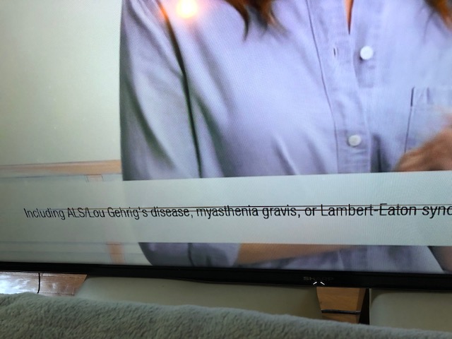

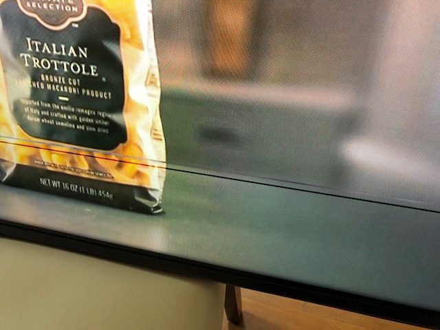

                                          looks like i found the right thread! greetings guys.
                                          The culprit: LC-70LE757U
                                          I haven't read all 12 pages of this thread yet but does this look like anything familiar to you guys who've been working on this model for a while now? Just 2 thin solid lines toward the bottom of the screen shown in the attached pics. No flickering, no power on/off issues, no blinking lights. It will stay on and play all day like this. Just wondering what I can do to get rid of these lines. Thanks in advance!
