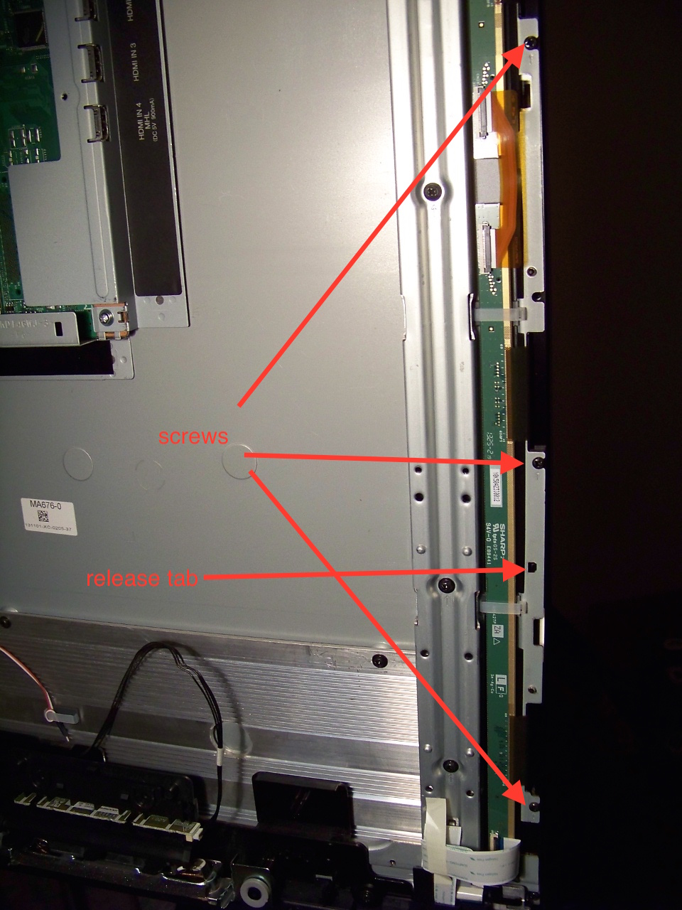

                    from what I can see, there are screws holding the bezel all the way around. Then there are also finger "tabs" that have to be "unlocked" / pushed to get the bezel off. So basically, you are saying undo all the screws, then place the tv face up on a carpeted area and then release the tabs and lift the bezel off?
                    see the attached picture... hopefully you can see what I am referring to in terms of bezel mountings.

                      Re: Sharp LC-70LE757U Flashing 2-5 :-( can it be saved economically?
                      budwich just remember as we have said theres no gaurantee this will fix your fault, and once you have removed the tabs etc they cant be put back on so this could make the set act worse. theres also a chance you could crack/damage the lcd i dont want too put you of trying this fix as it may work you just need to be aware of the risks even more so if its a tv your repairing for someone else. saying that though just take your time and ask and maybe upload pictures if your stuck and we will try too help.

                          Nawww, they really don't care what you recycle. I dropped off a smashed Pioneer 6G 50" plasma that had a completely shattered screen and held together with duct tape. The guys there asked me if I lost at FIFA!
                          As for the bezel you need to remove the screws, loosen the bezel then flip the TV over so you can access the panel itself. On an insulated surface the set should operate fine.
