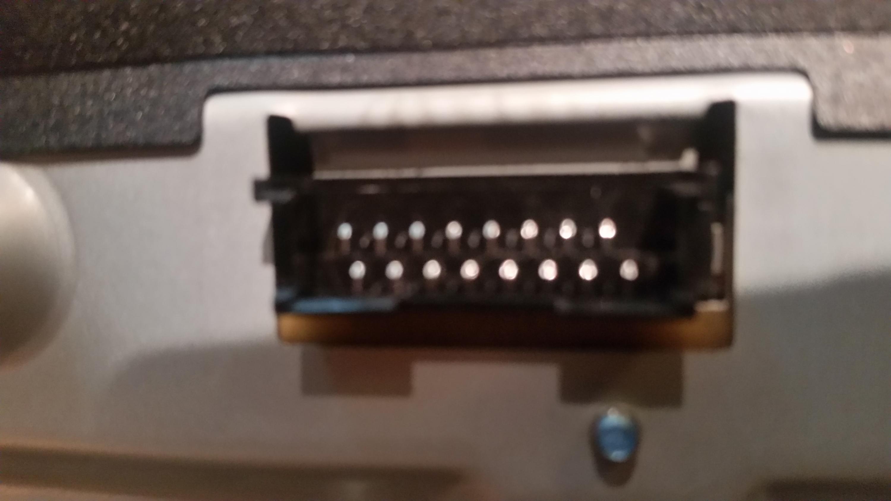

      Hey, there are 5 led strips with 9 leds on each.
      Is it 200-220 V in Pin 12 input to LEDs are expected?

              My boss said he had a bad Samsung tv, which sounded like a bad cap, but turns out I'm having a similar issue with the backlight. The unit has 5 bad leds over 3/5 led strips, tested with my fluke117 (via diode+resistance functions) and ~3v battery pack.
              I've measured the power pins 1-16 to the led array. All produce zero volts aside from pin 11: 188v, pin 12: 213v. when I measure min/max it cycles ~+/-14 v. Just an observation Autorange mode seems to light up the top strip while manual does not.

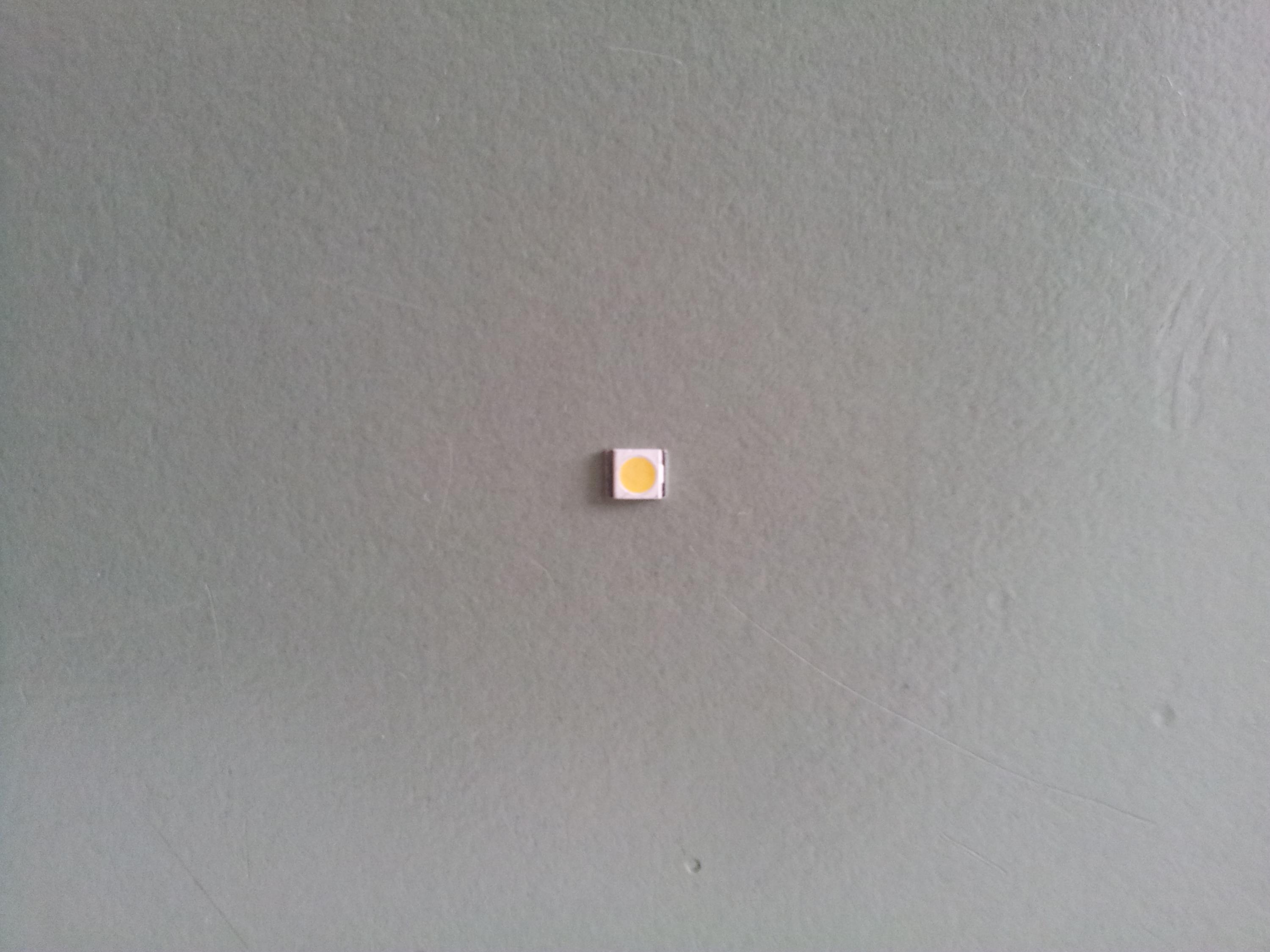

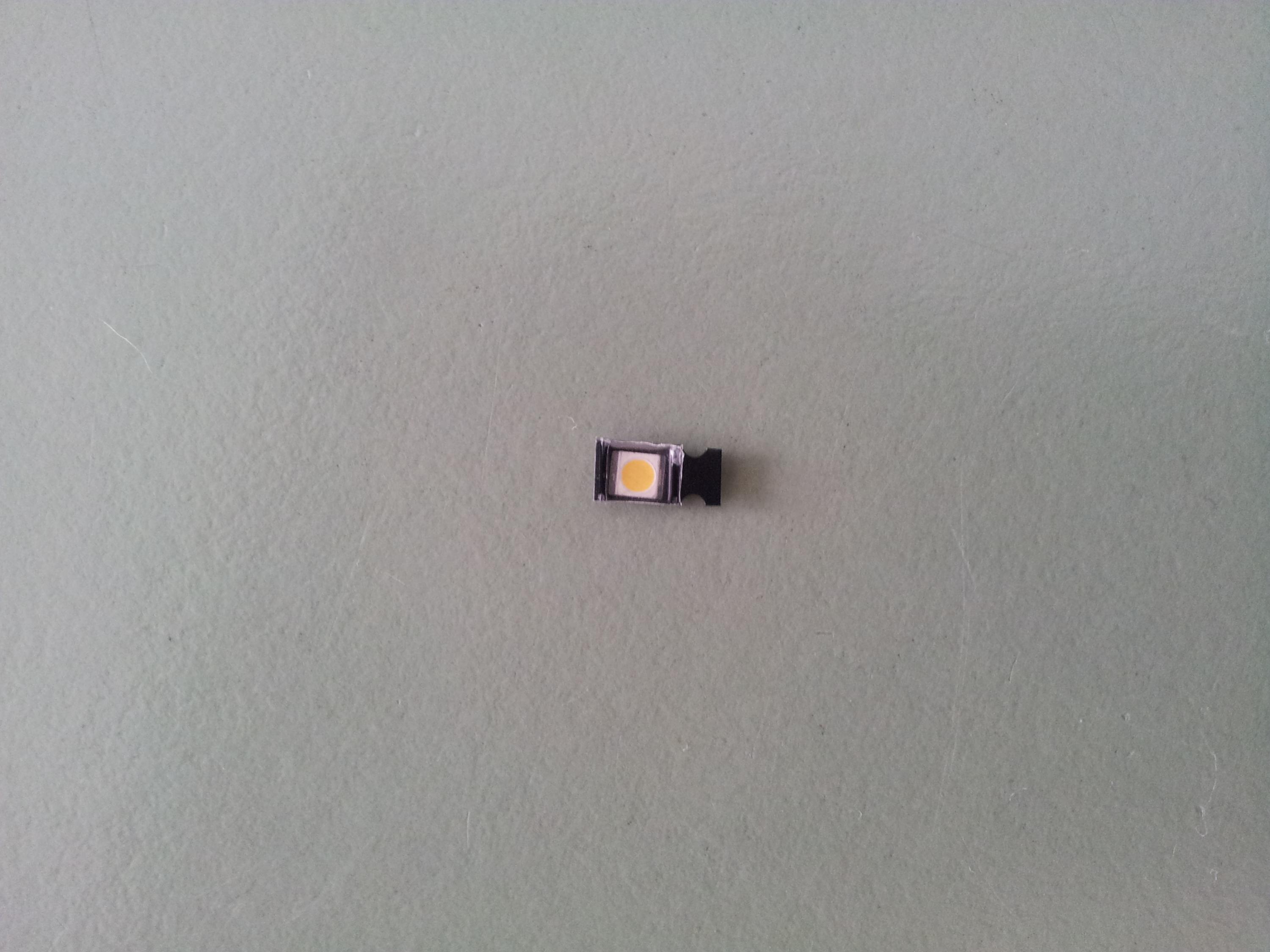

                            I used LATWT470RELZK led to repair the led strips.

                              The temp of the LEDs seem to match very well. I couldn't tell which ones were replaced when they were lit up.

                                  Personally I scraped old the led with soldering iron then cleaned the contact. Use caution as you can damage the contact and may need to rebuild it. When you put the new one on, use flux. It's essential to get the solder to flow under the contacts on the led. LEDs melt super easily, so I wouldnt apply the iron directly to them, let the solder flow into the contacts. Double check polarity first as well. After that I used electronics grade silicone to glue the lens on again. Good luck buy extra LEDs in case you damage the first couple. May take practice.

                                    Just an update on the tv I was working on. I fixed it and it's back in its home.
                                    The leds I used were not a great match for the existing ones. They were more white or yellowish when compared to the purplish factory ones. Even across a single batch there was variability in regards to brightness, and color temp. I assume part of this is due to damage incurred during soldering. I improved my technique by the end. I cannot recommend the LEDs I mention in the previous post. Perhaps if all the strips were redone the color wouldn't matter, but 45 LEDs x 1.2 leds for mistakes at 1 dollar a price makes that not worthwhile. I hope this helps.

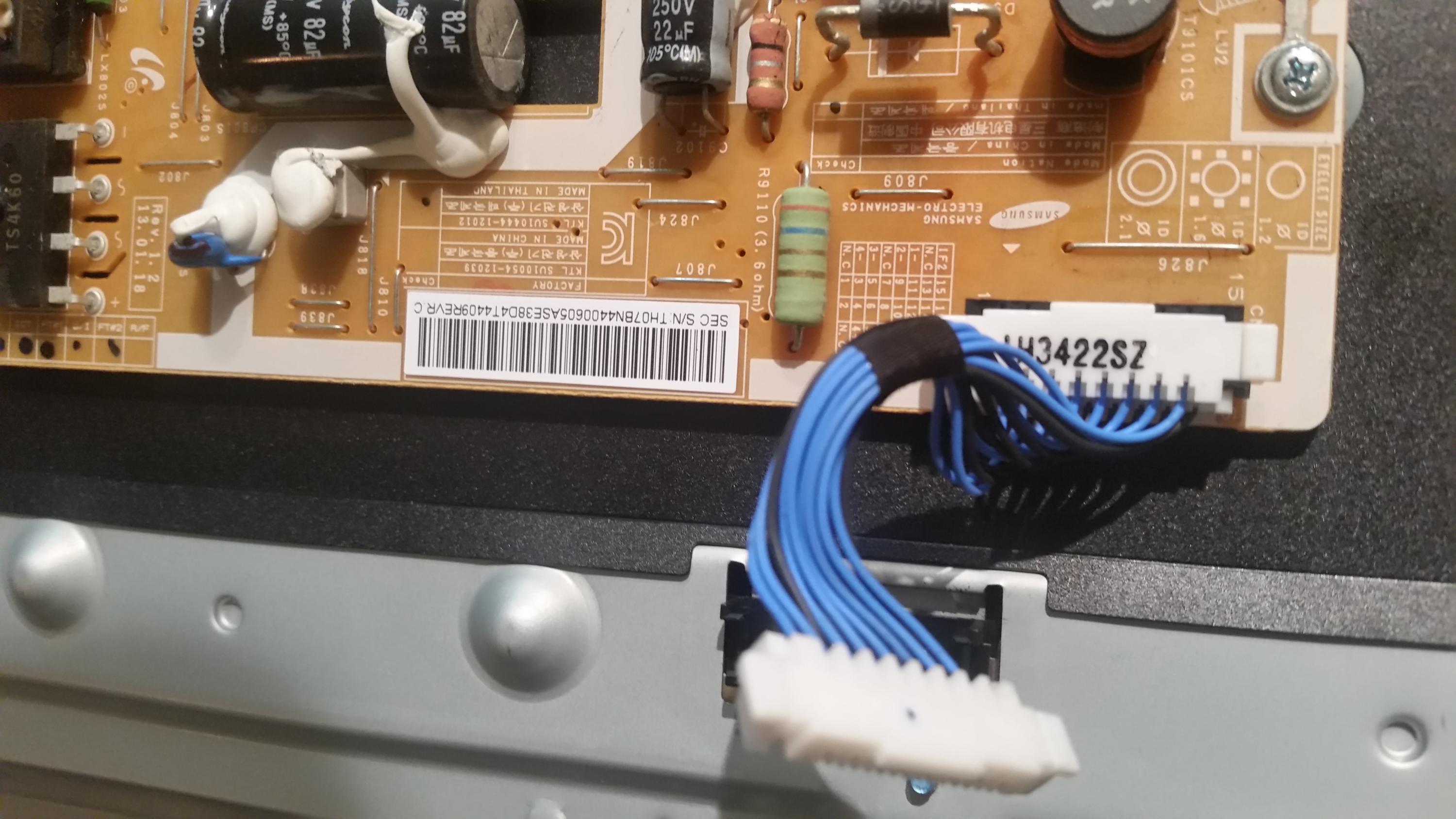

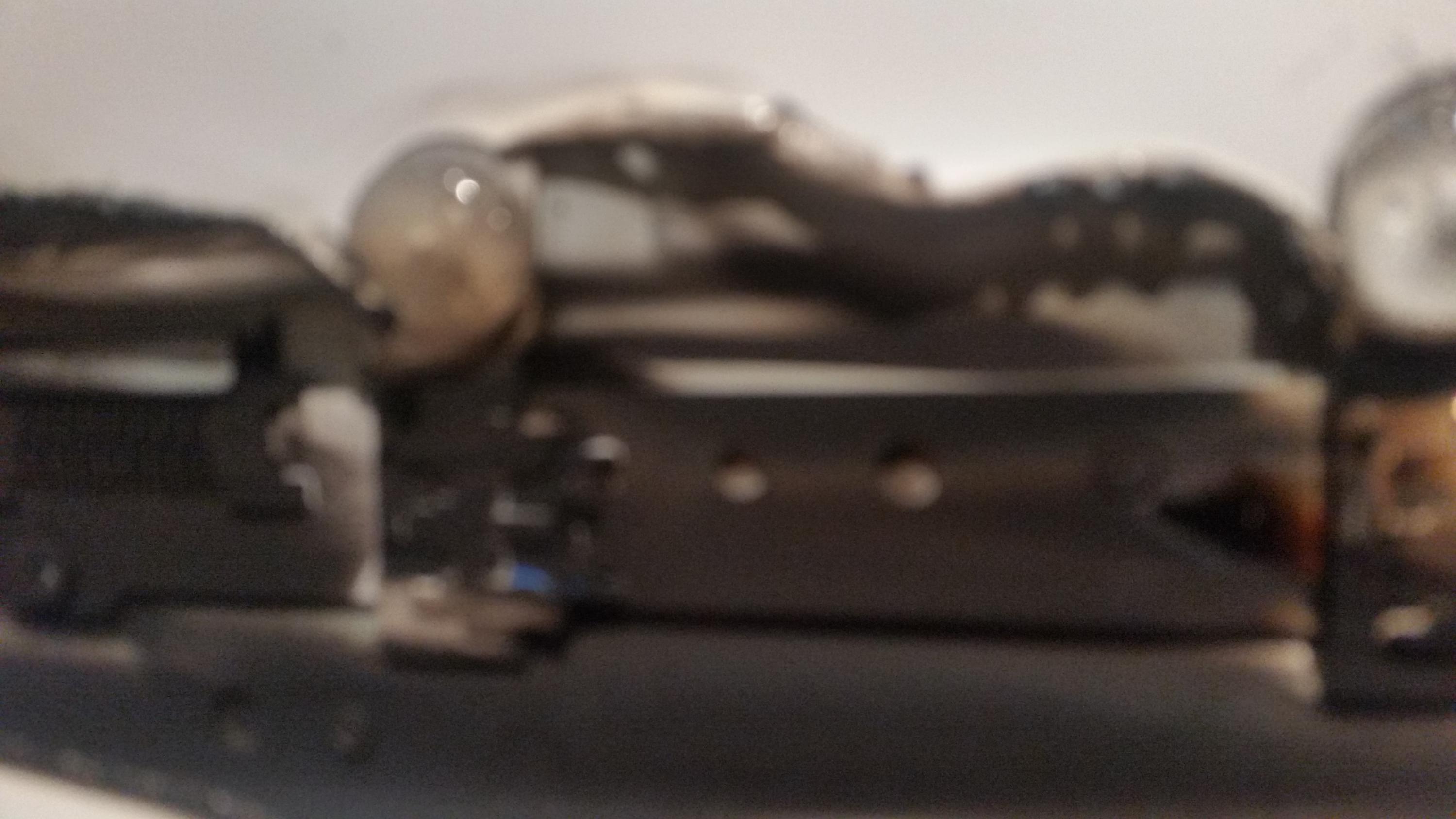

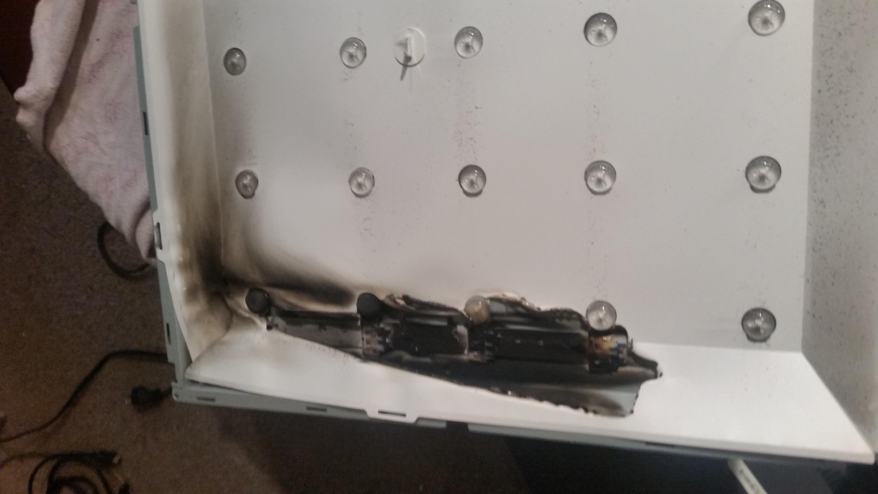

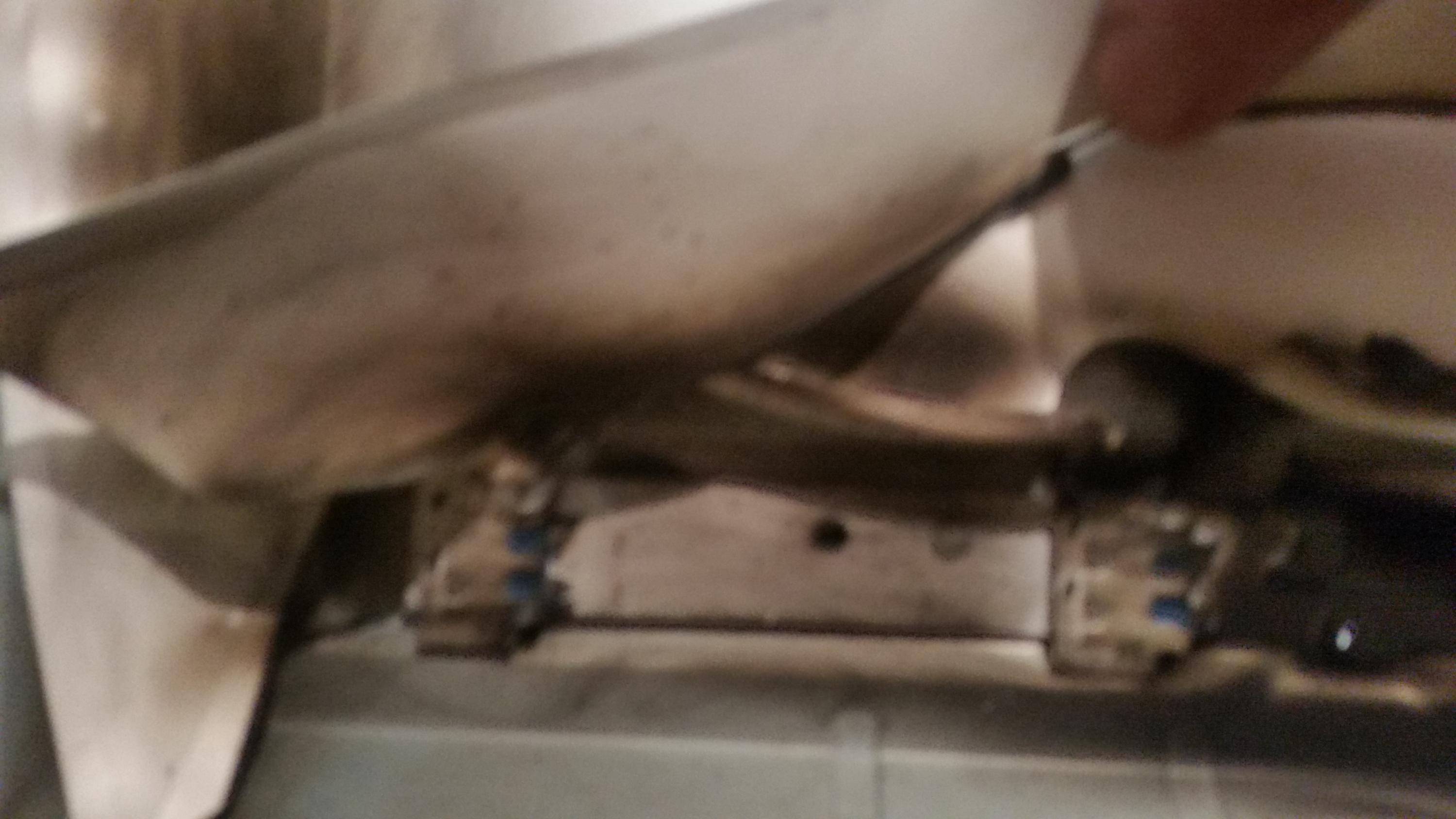

                                      Well my Samsung UN32F5500AFZA Backlights went out yesterday everything else was fine so i opened it up and this is what I have, these pictures are from today. Luckily I unplugged it last night or probably wouldn't be here posting this.
                                        #39
                                        Re: Samsung UN32F5500 LED TV Backlight issue
                                        Sorry about the quality of the photos i used a phone. I will take some with a camera later tonight.
