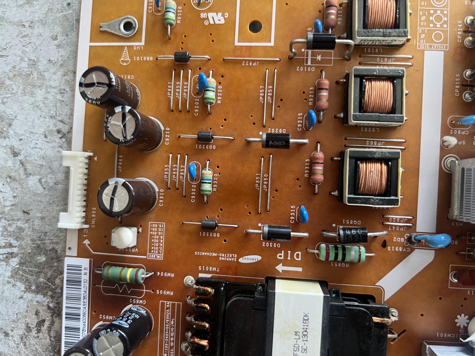

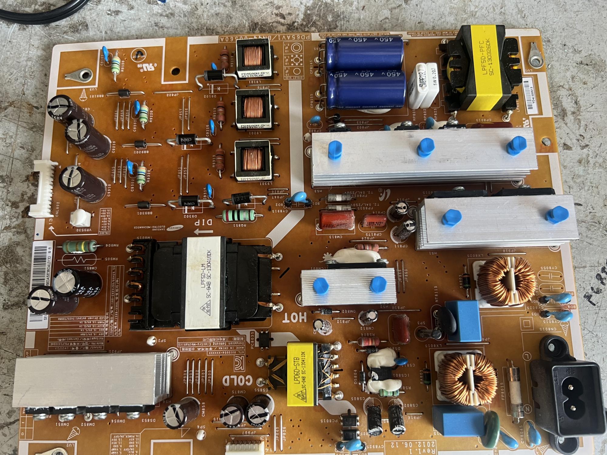

    I have a Samsung Un65eh6000 with a backlight issue.
    The original issue was backlight current was present but led strips did not light
    I tested the backlights and all tested to be working properly.
    I assumed then that the power supply was not sending current to the led strips.

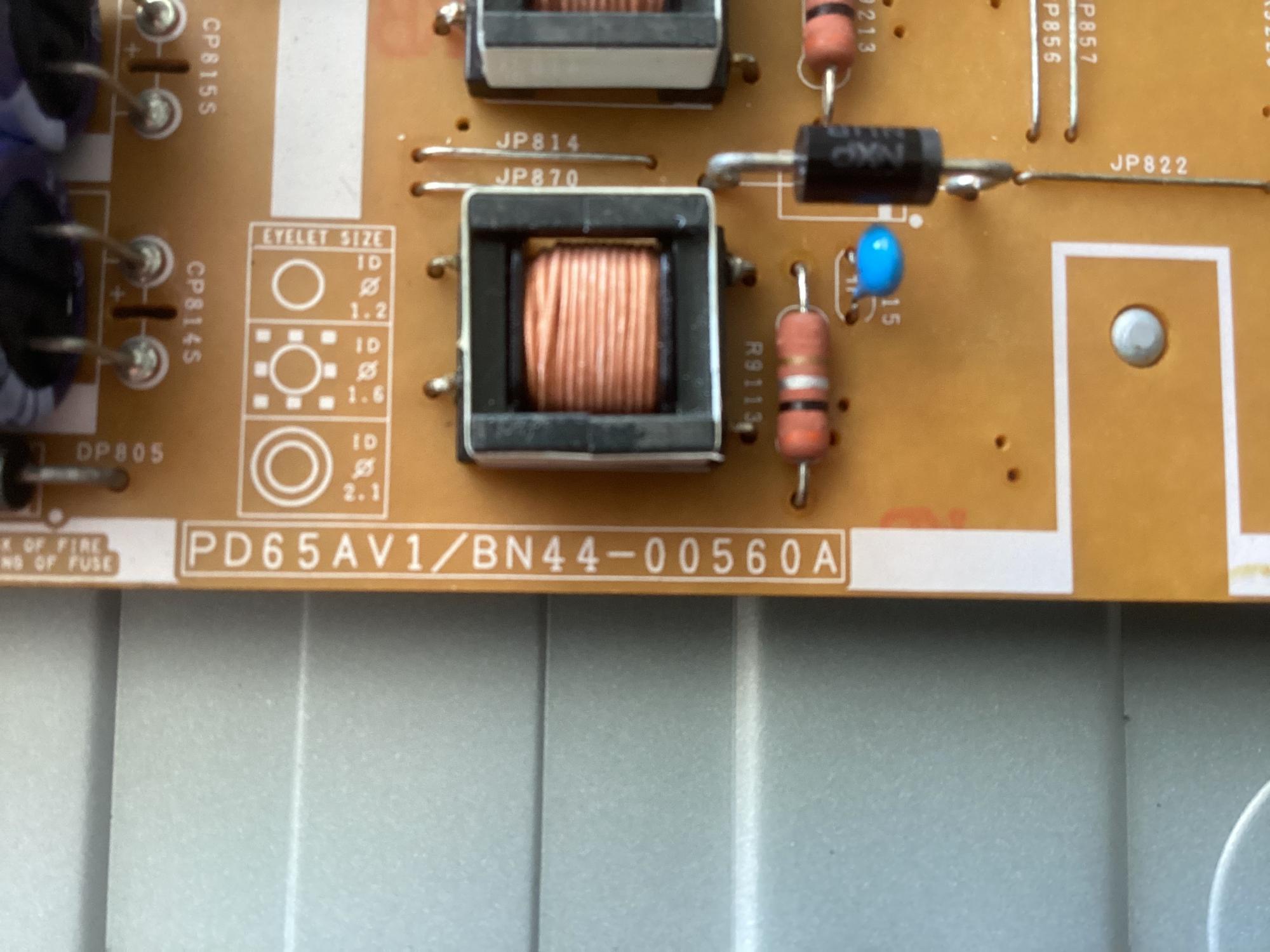

    Power supply board part number BN44-00560A.

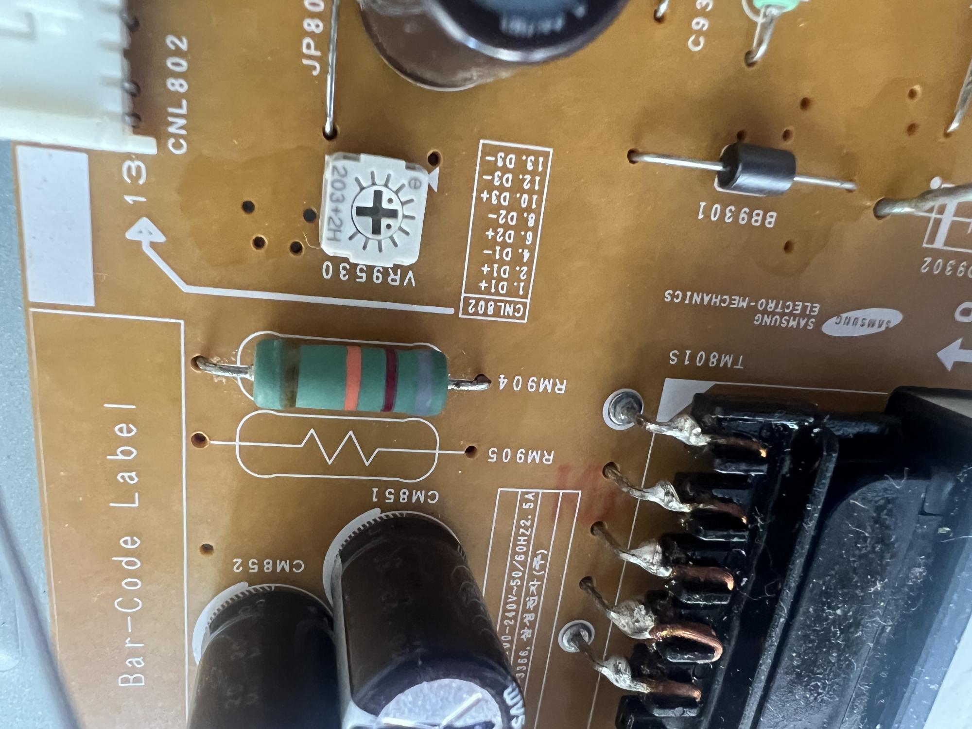

    After checking voltages it appears that current output at connector CNL802 was outputting the correct current 189 VDC on pins 1,2,6, and 8.
    The issue then was there was no ground on the connector 4,8,11, and 12.
    I then created a case ground on pins 4,8,11, and 12 and all backlights came on.
    My issue now is they're at approx. 30% and will not ramp up to normal range?
    Would anyone have any suggestion to what is limiting the backlights to ramp up to normal operating parameters?

          • R_J
            • Jun 2012
            • 9535
            Re: Samsung un65eh6000 backlight issue
            How are you testing the backlights? The problem is very likely one bad led in the circuit causing the protection to shutdown the backlight circuit.

                    • alfatv
                      • Sep 2020
                      • 353
                      Originally posted by bstewara
                      Hi All,
                      This is voltage, not current.
                      By grounding other sides of the strips, there is no current limiting in place, you can damage the strips by doing this. However they might on last legs anyways based on your description.
