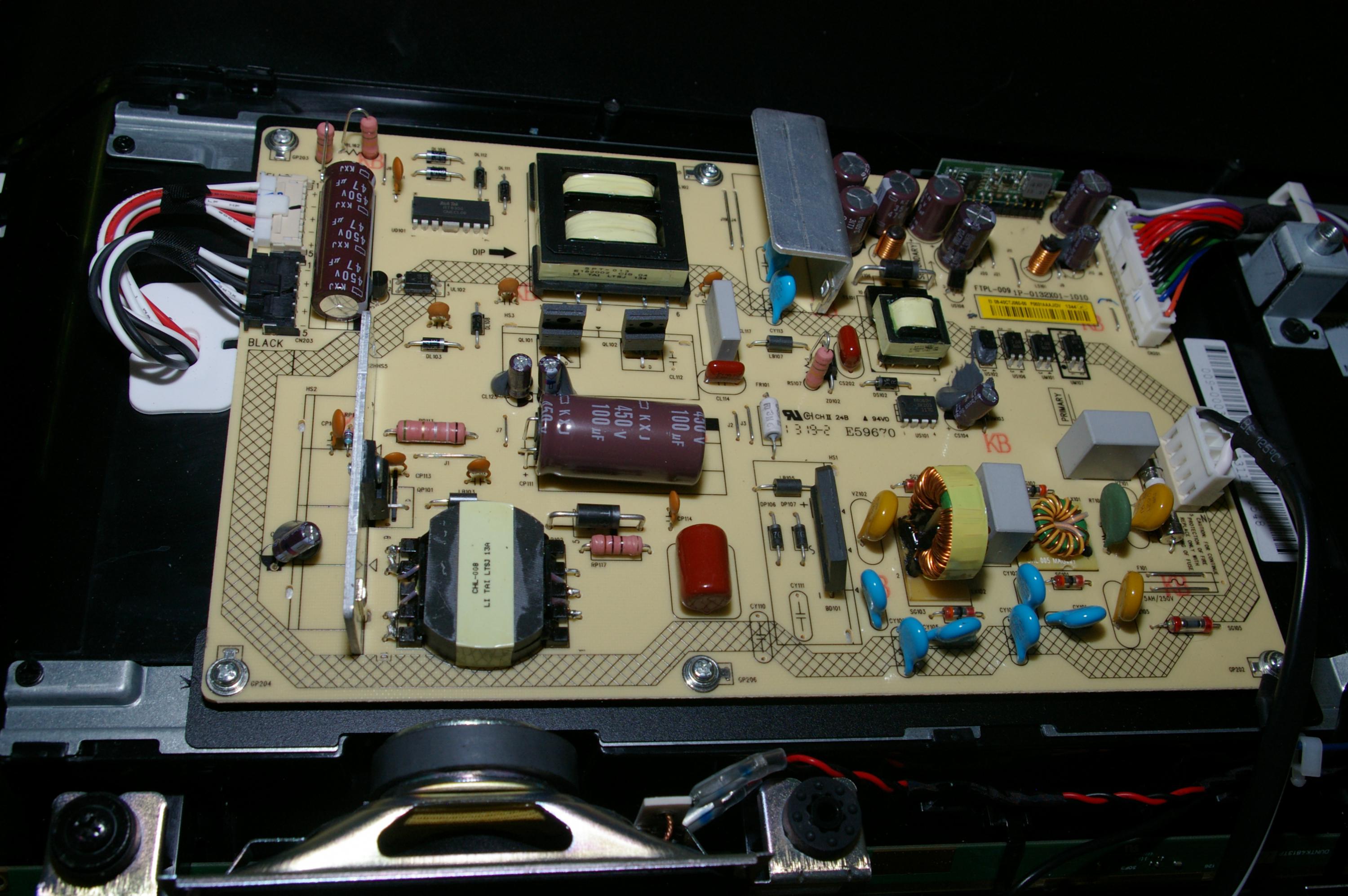

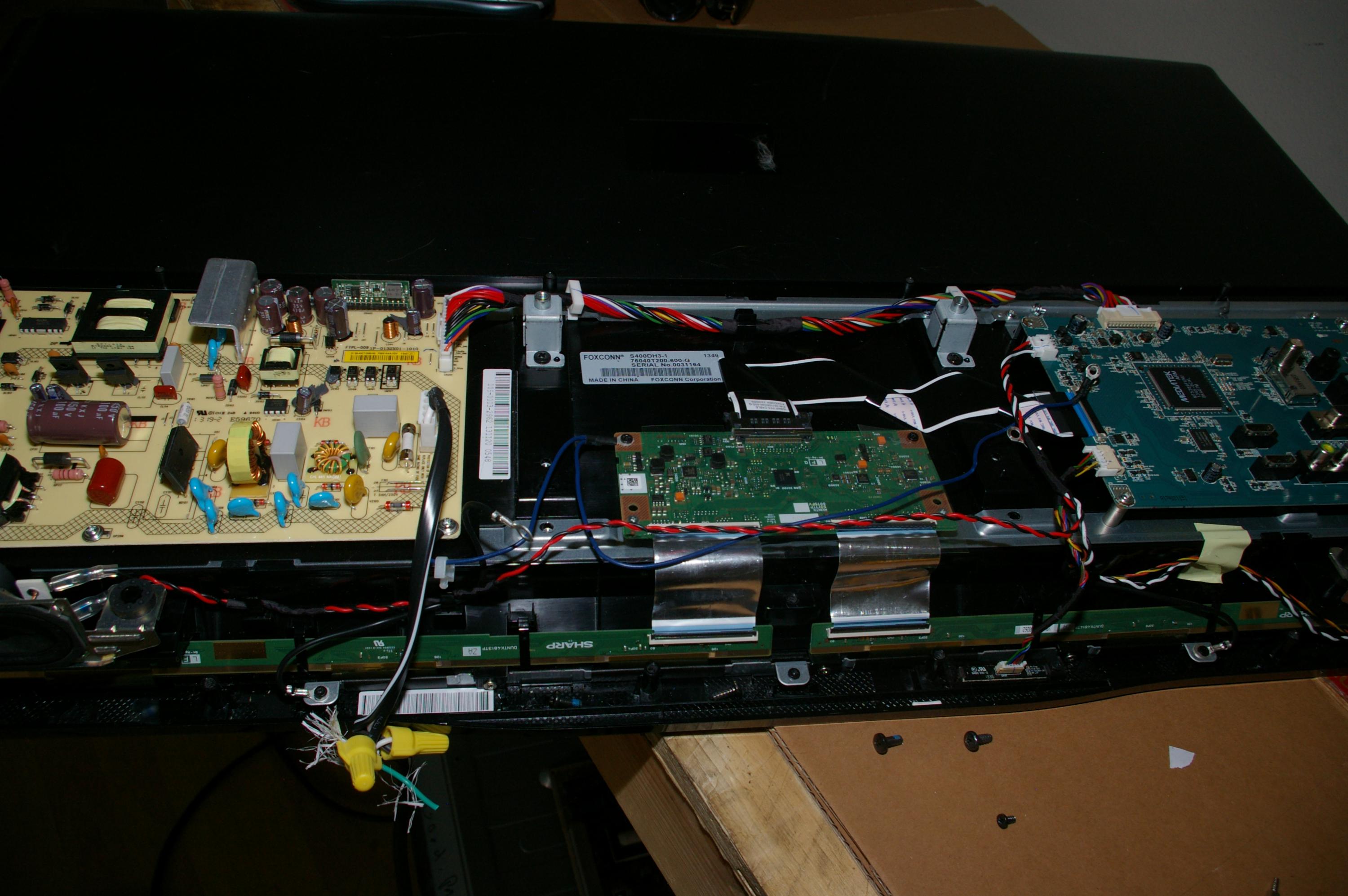

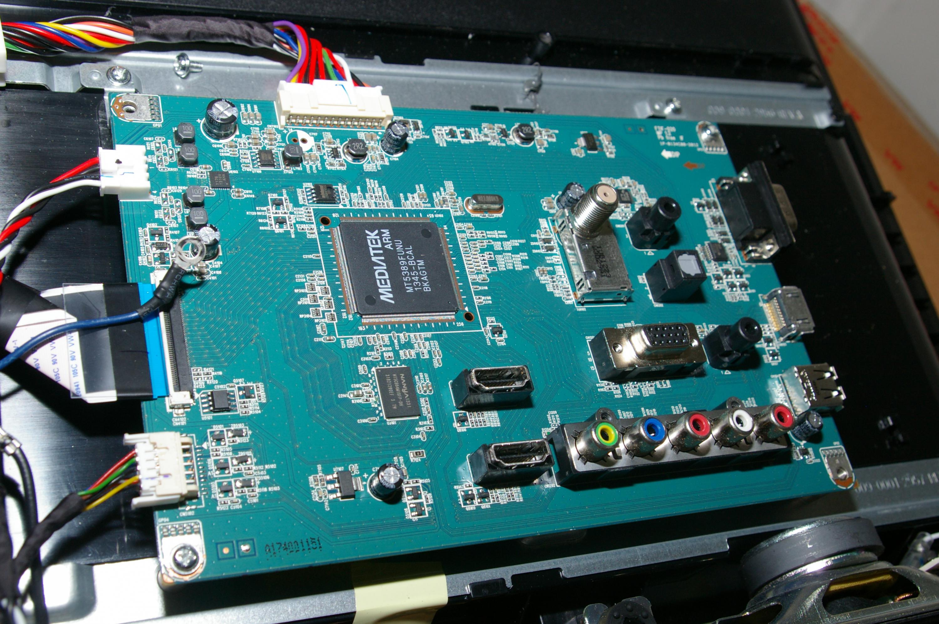

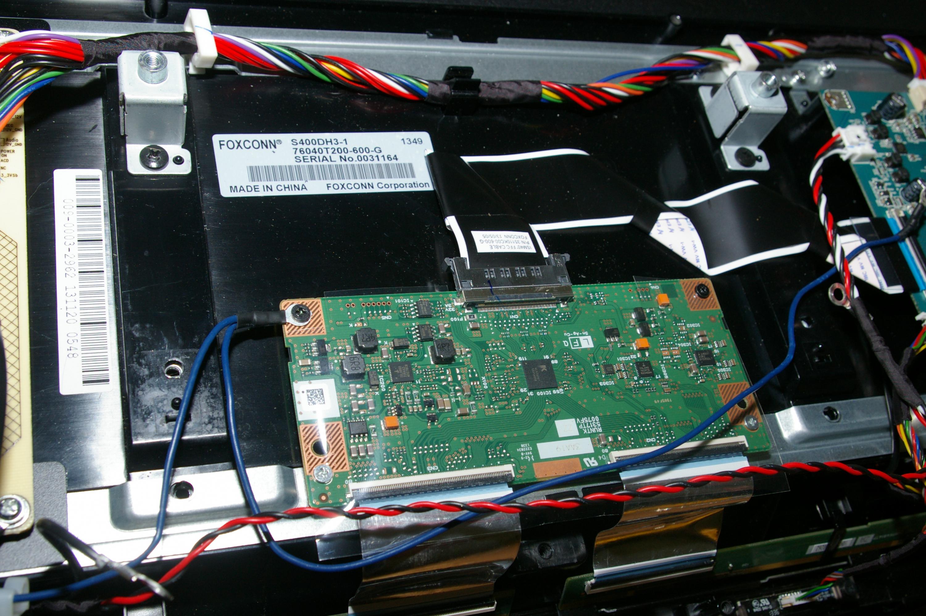

          Re: Sharp LC-40LE550U. Green light, but no picture/audio
          Bud,
          Took cover off mainboard , and pictures of each board. Thanks!

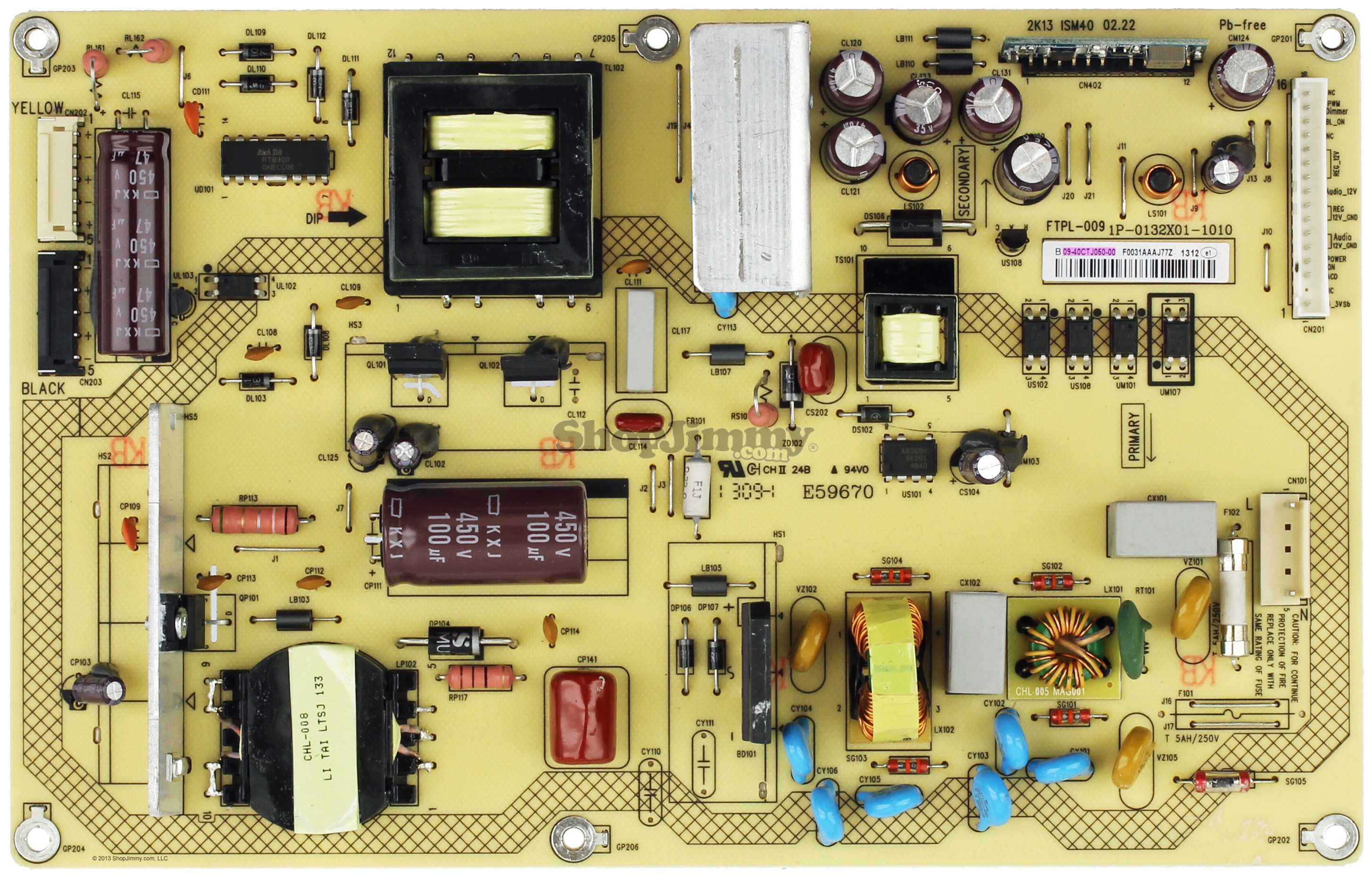

            So what DCV do you have on all the pins (EXCEPT GND) of the connector CN201 when TV is OFF and when the power switch is activated?
            Pictures provided by SHOPJIMMY.
            http://www.shopjimmy.com/catalogsear...rp+LC-40LE550U

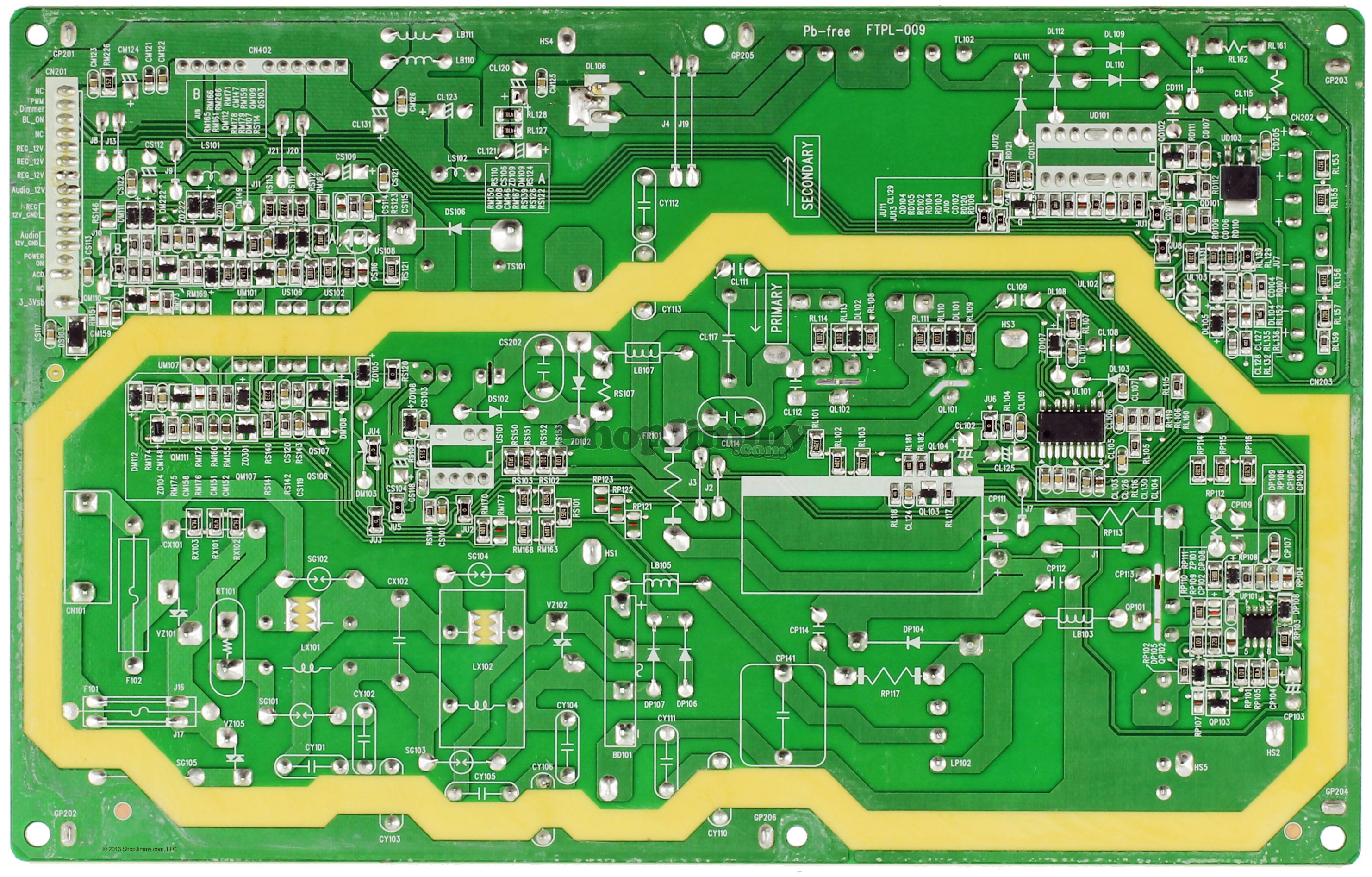

                      Upload good clear pictures of the whole back side of the board.
                      is your board the EXACT same board as shown in my post #6.
                      OP never have follow through on the request in post 6 so you need to report the DCV readings.
                      You do have meter and know how to use it, right?
