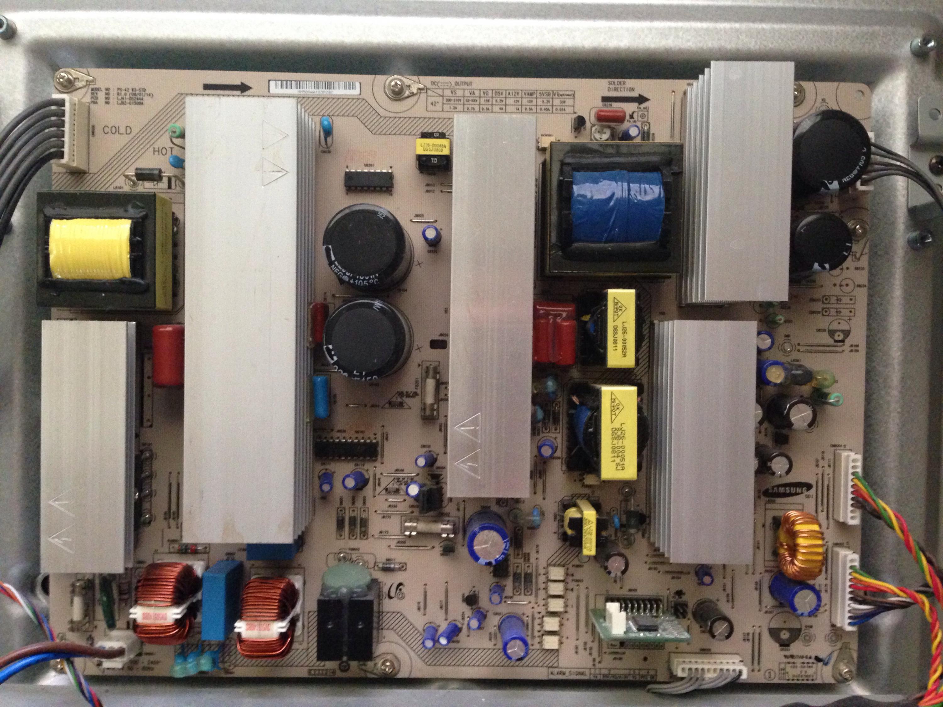

    Hey guys, I'm extremely new (first day). so, I had a power surge a couple weeks ago, it took out my wireless router and also my 42" vizio.
    It's a VP422 HDTV10A.
    It has no amber/white light at all. Completely dead, I can see a small green LED through the back panel however. If I unplug it, and plug it back in, the screen flashes white like it's trying to come on, and the amber light comes on for a half a second, then it is again completely dead. the power button doesn't work, only unplugging and then re-plugging(?). I was hoping this is just the power supply? The only thing that got fried on my router was the power supply transformer.
    Anyway I did read about a "2 seconds to black" issue that sounded similar, but after reading about it a little, it sounds a bit different....
    Any thoughts/suggestions?
    Thanks for any help guys...

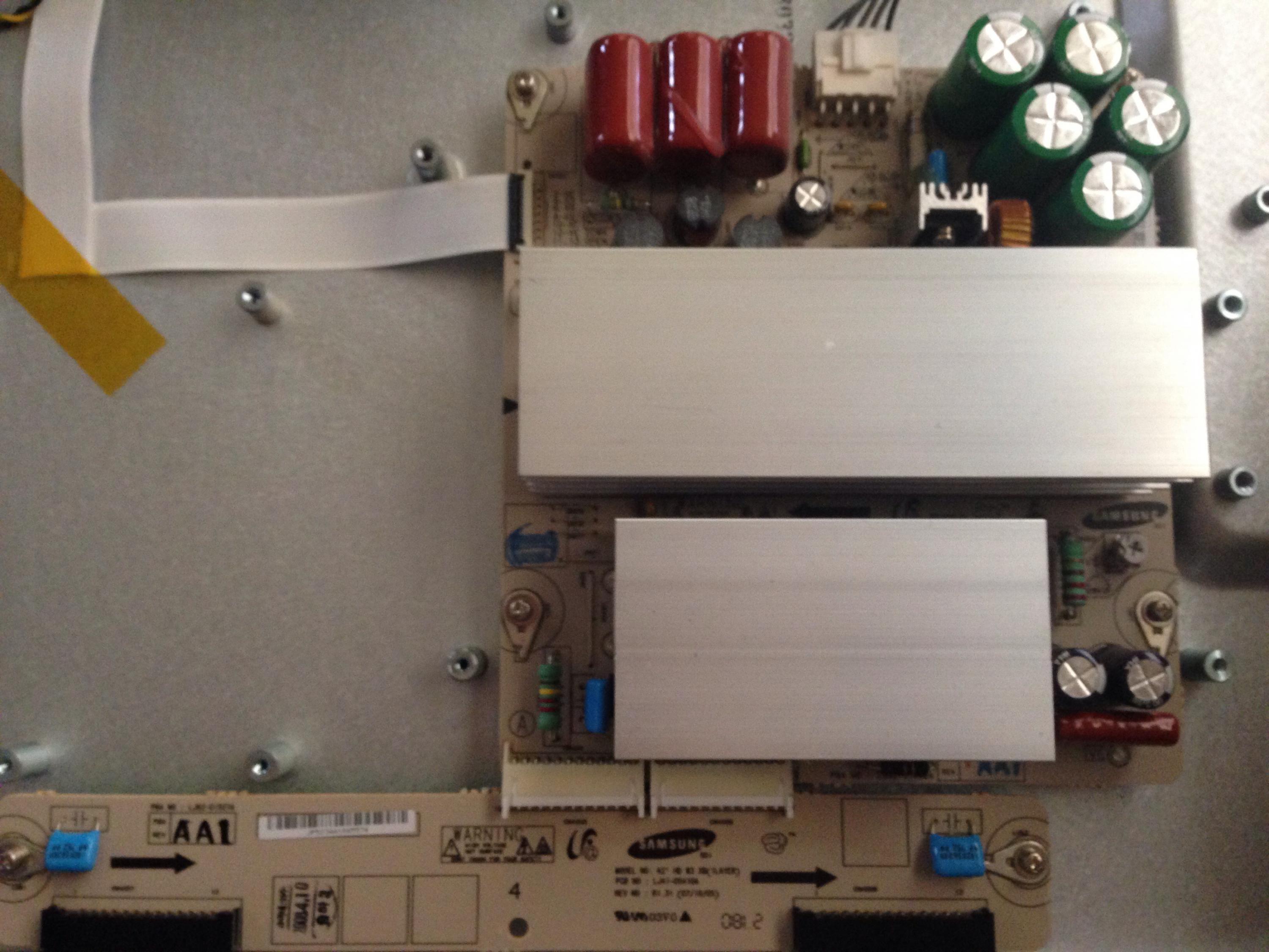

              Re: Vizio vp422 wont power up
              All the fuses I could readily identify are good.
              • chrisman183
                • Aug 2015
                • 10
                • usa
                Have to do these 1 at a time apparently...

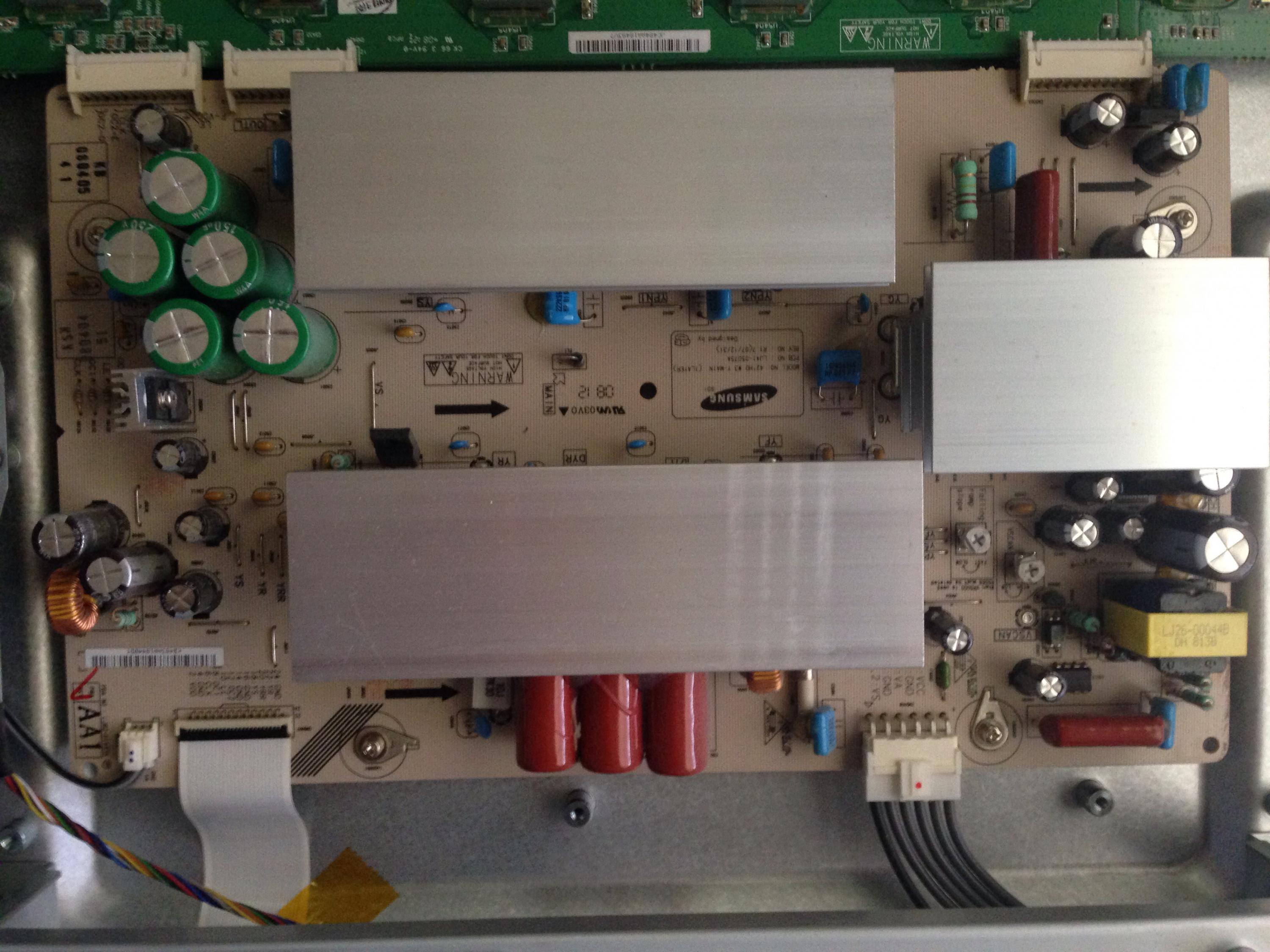

                  3rd one
                          Thread necro here:
                          Found same problem today on same model.
                          Problem was OPEN cap C8002, 22uF / 450v, 16 x 30mm just below central heatsink. In the picture in post 7, it is left of the smallest of the 4 transformers in a row, T8001, and right of fuse F8002.
                          Also, several of the small caps (5mm) are all over the place in ESR, so they'll be going too.
                          Yes, set is a bit long in the tooth, but the client doesn't have a lot of money to spend.
                          Cheers!
