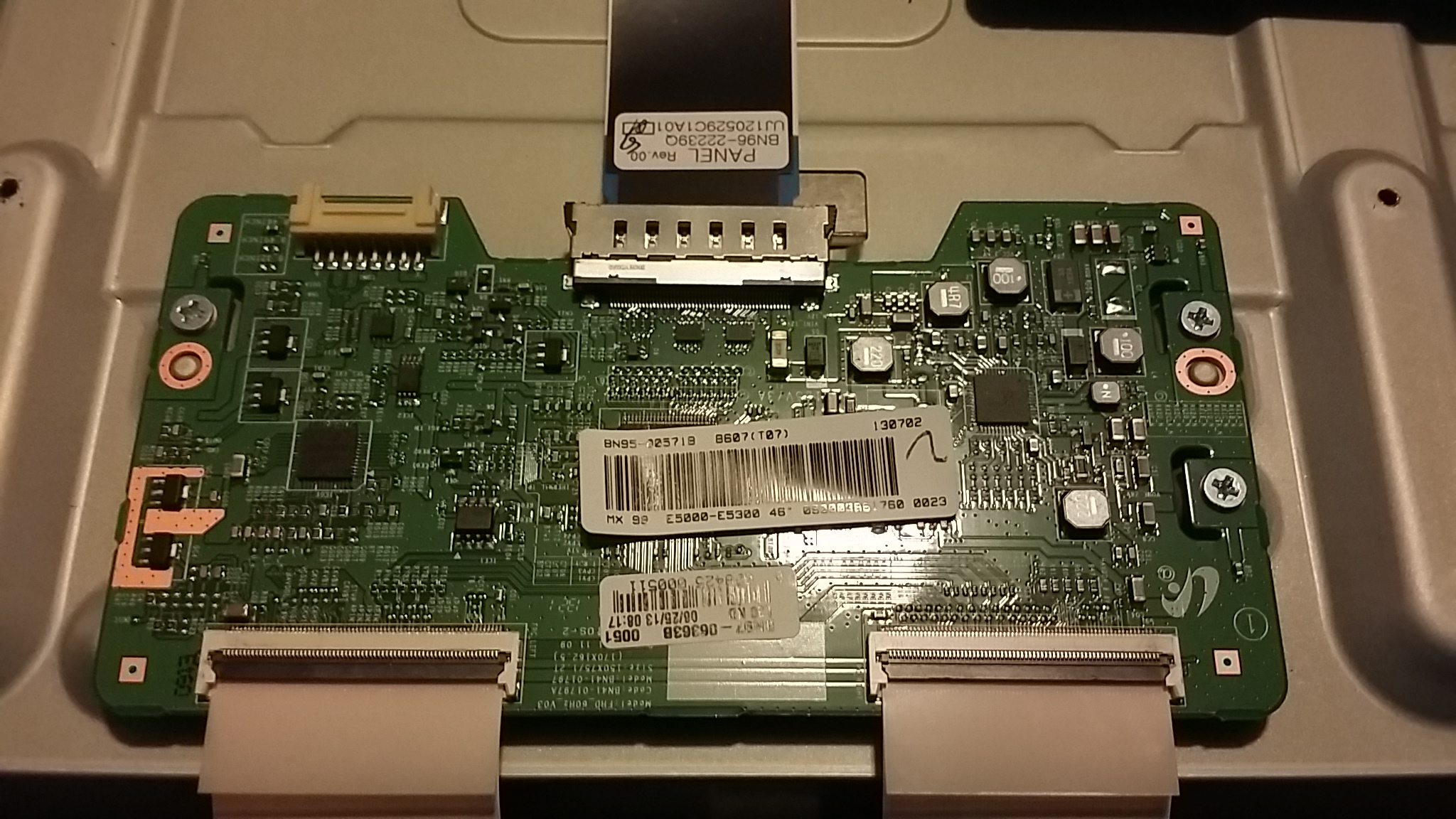

    Hello all, this is my first thread and honestly I'm stumped on this TV repair. I picked it up for cheap because the owner said there was no picture (looks like the set has never been opened previously) so I dug in and to my surprise the TCON board had a blown IC chip in it. So I though "ah there's the problem" so I ordered a replacement and plugged it in annnd I still have no picture. The back lights stay on and I can hear the menu. So I did some more research and found that my EEPROM chip may need reset due to the blown IC but I cannot find the EEPROM despite searching Google for two days. My main board model is BN94-O5750Q. I really do appreciate any and all help. Thank you

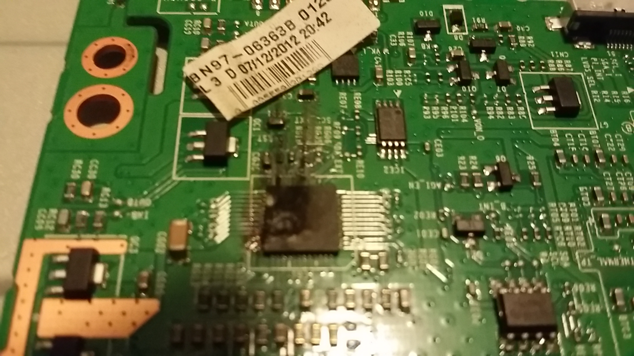

    Which IC on the T-CON board that is blown?

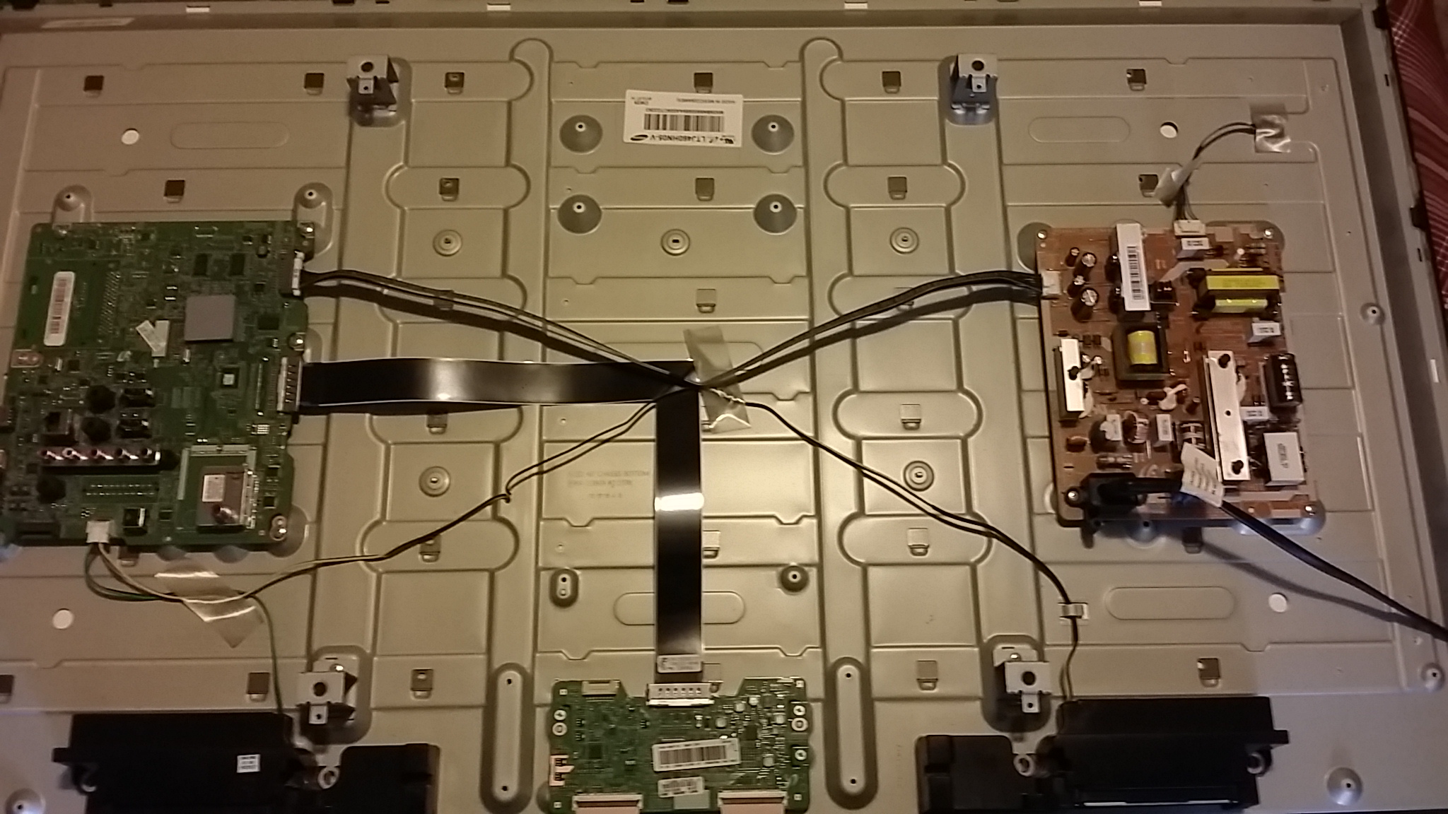

    How about the pictures of the boards and the whole back side of the TV?
    I have never heard of EEPROM of the main board has to be reset due to blown IC on the T-CON board.

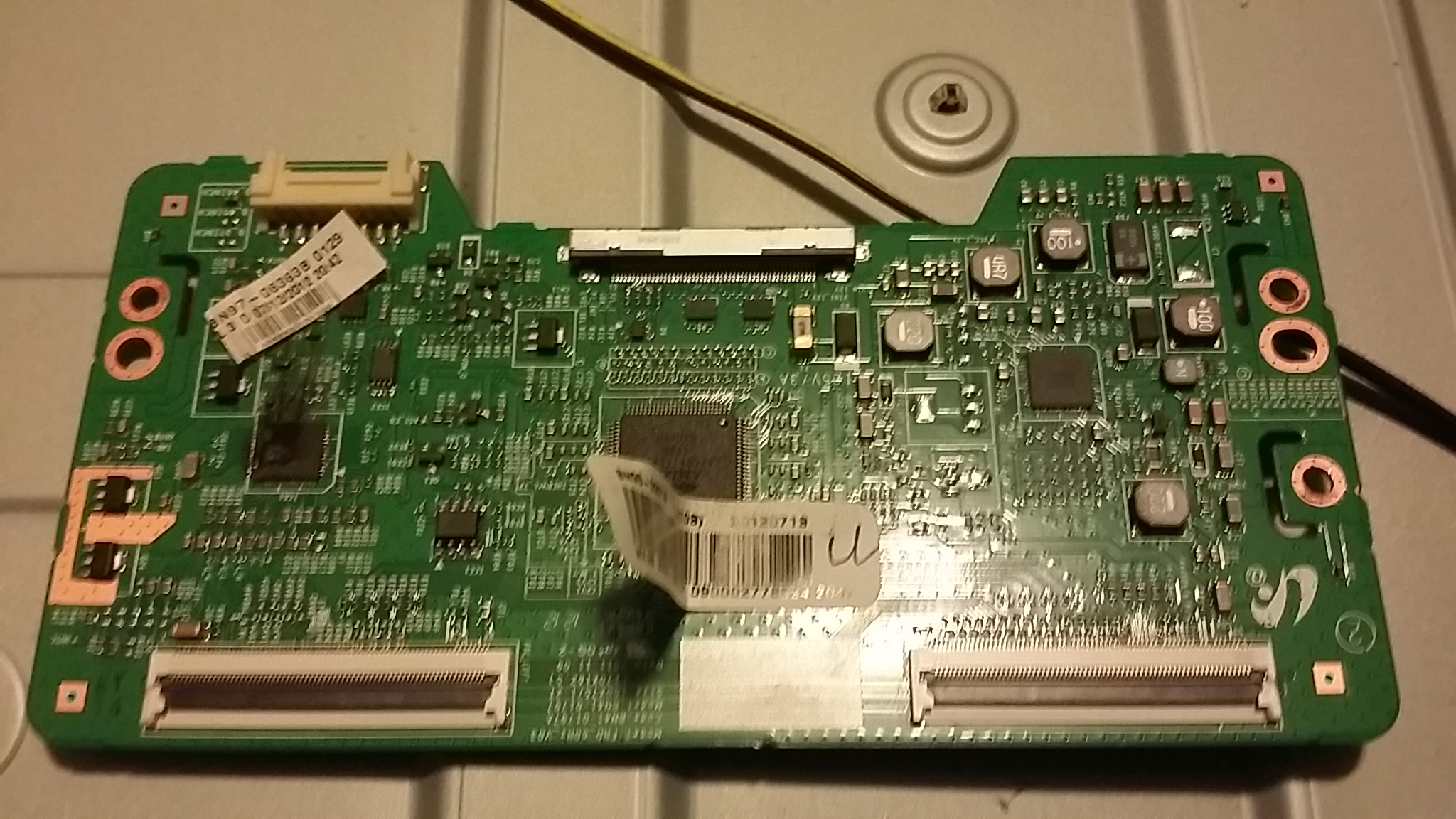

      The EEPROM is on the TCON board? Here's some pictures of the boards. Included two pictures of the bad TCON
      Edit: the blown IC has this written on it :17939A...H32090R.

          So you install the new T-CON board? Is it a KNOWN GOOD board?

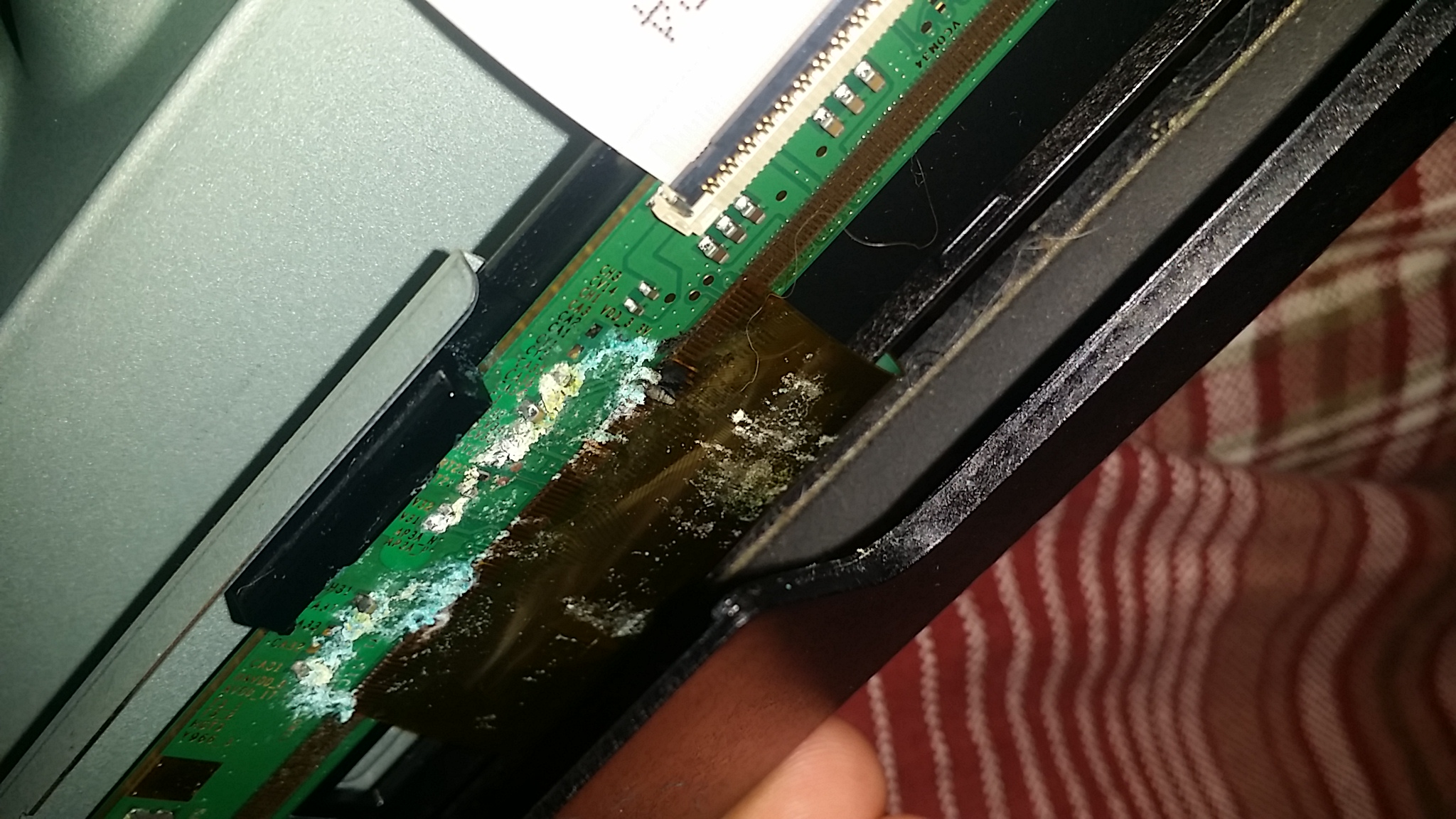

                    Re: Help with Samsung Un46eh5300. No picture. Backlight on
                    Ahhhh, found where the clicking is coming from.....doesn't look too good :/
                    Looks like this caused the IC on TCON to pop...maybe try and clean it off with rubbing alcohol and see what I can do.
                      That not good, the panel is gone I'm afraid.
                        Yea, well thank you both for helping me with this. I'll try the rubbing alcohol route as a last resort but it is looking grim. I'll post if anything changes or if I have another TV I'm attempting to fix and I'm stuck. (Next one is a RPTV convergence issue in a week or so)
                          someone cleaned the screen and the water ran down. not good!
