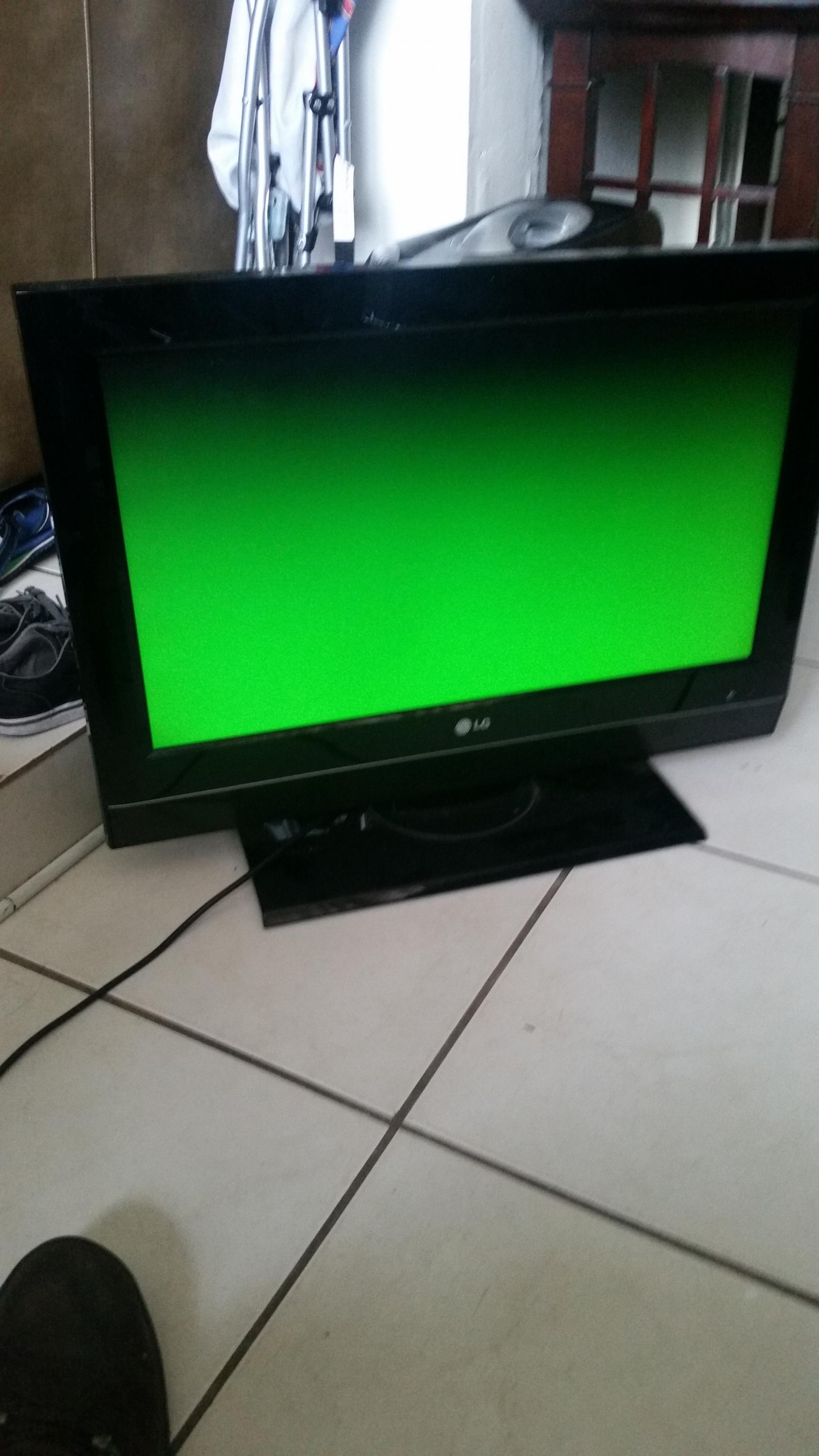

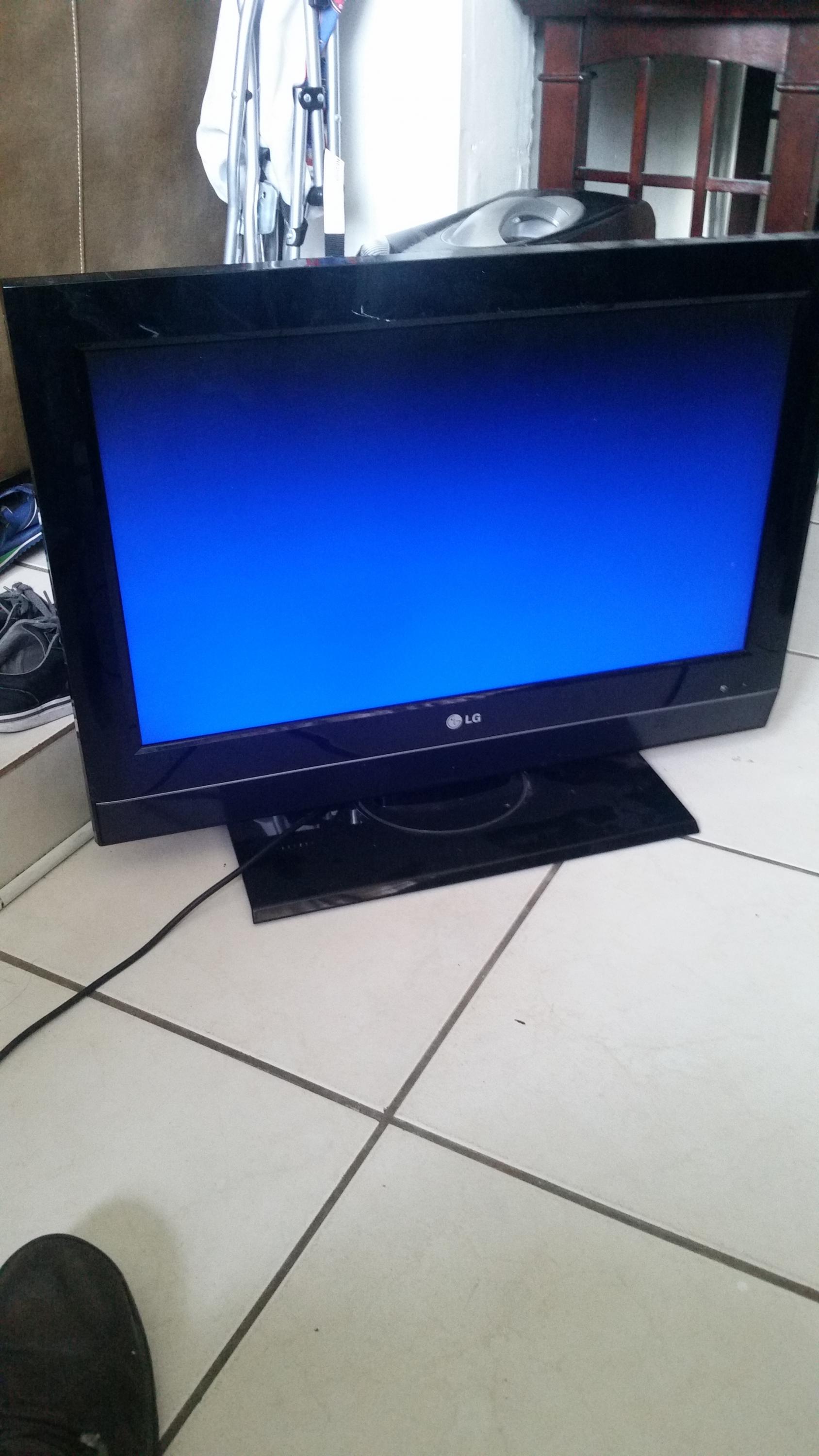

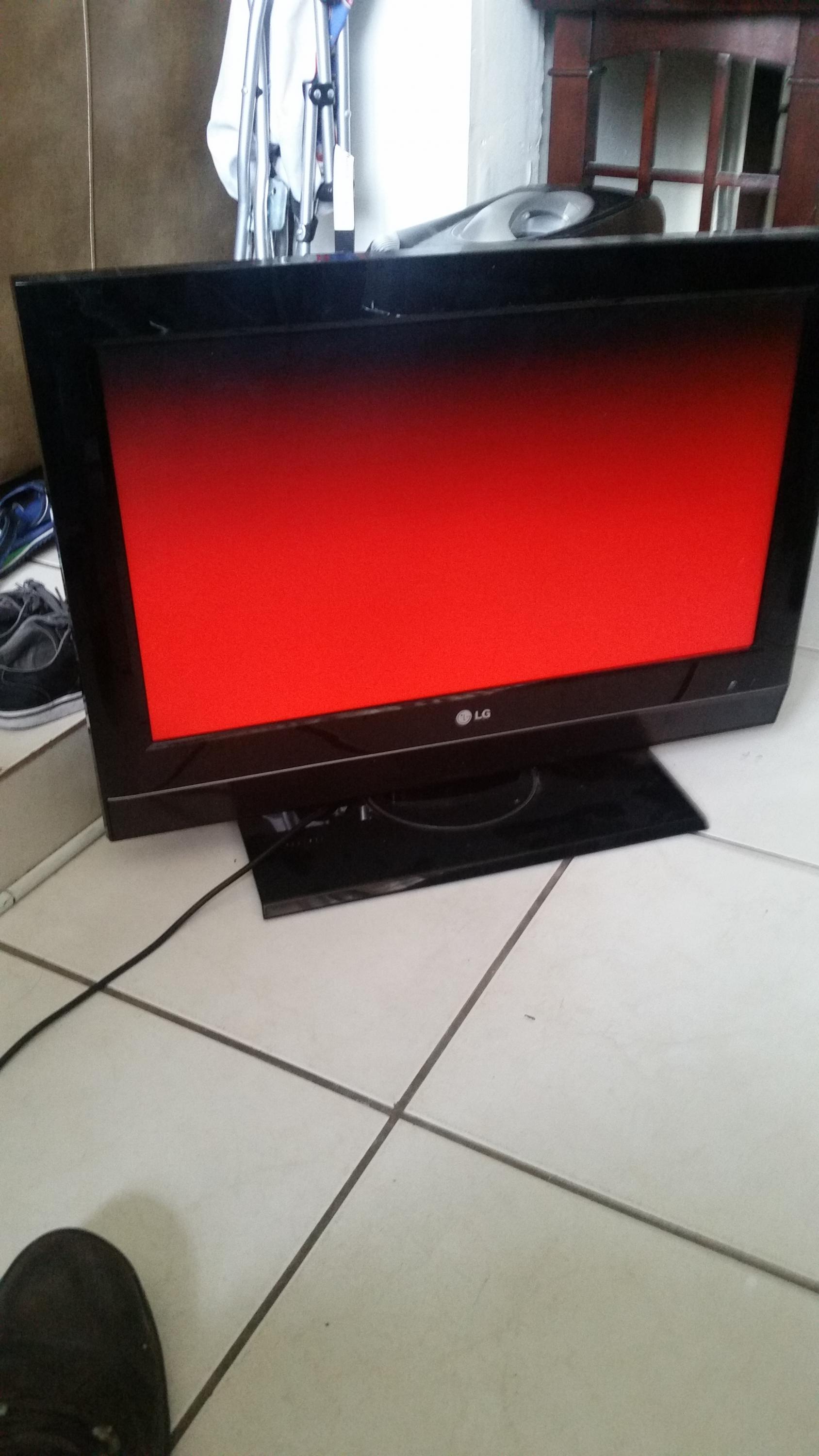

    Hello again. I need your help and advise one more time
    Some time ago a friend gave me a non working tv top see if I can fix it to give it to my kids.
    Well, this tv as soon as I turn it on it starts changing colors one color at a time on the whole screen for a few seconds each color.
    I googled and some people mention a reset pressing menu enter and power but that didn't work. I have no remote control and can't access any menu or change inputs.
    What could this be?

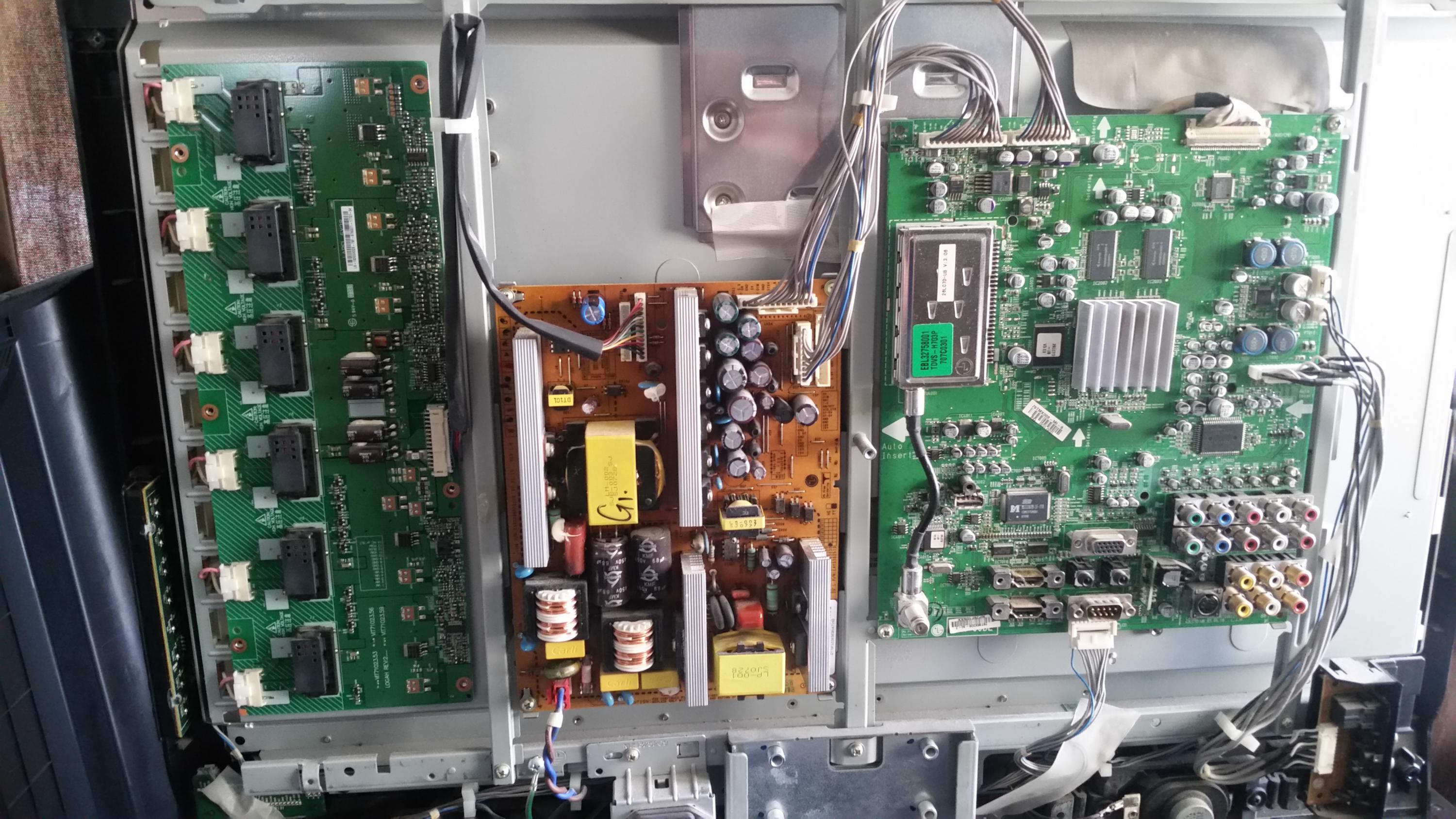

        Pictures of the boards and the fault please !

                  I found a remote that works with this tv and did the button pressing thing menu+ enter+ power and nothing happened, the tv just turned off, after turning it on the problem was still there.
                  Then did the menu on both the remote and tv then the ok on remote and tv and waited for about a minute on each combination pressed at the same time and nothing came up.
                  Here are some pictures of the problem and the back of the tv

                        Is this a mainboard problem?
                        If it is , is there something that can be done physically to that board to reset it without using remote or tv buttons?
                        Or can the problem be fixed by replacing the mainboard?

                            1 Your TV is stuck on a test pattern mode
                            2 You have to have the right remote for this TV before you can get into the Menue to cancel out the test, Google the model of your TV to see if you have the right remote.
                            3 In most cases the service manual will tell u how to get into the menu to do a reset .
                            4 If you do not have the right remote,Look around your local pawnshop and see if they have a TV like yours with a remote and if they do, hand the clerk a $20.00 bill and borrow the remote and work on yourTV then return the remote .
                            5 Or replace the main board .

                                      With lg TVs you need a special service remote to enter service menu. Probably easiest to just buy a replacement main board.

                                        Update
                                        Replaced main board with a used one from eBay and that fixed the problem.
