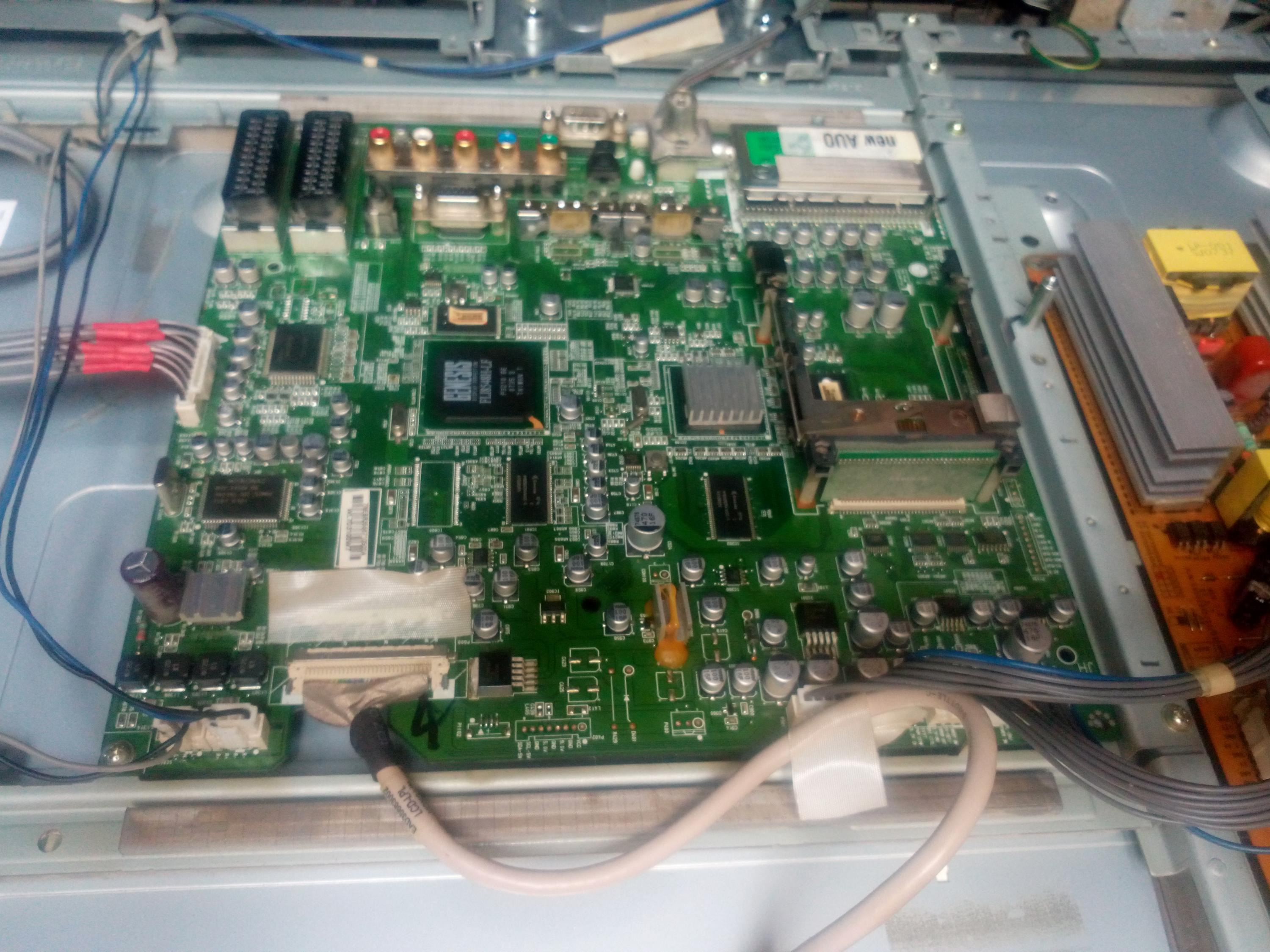

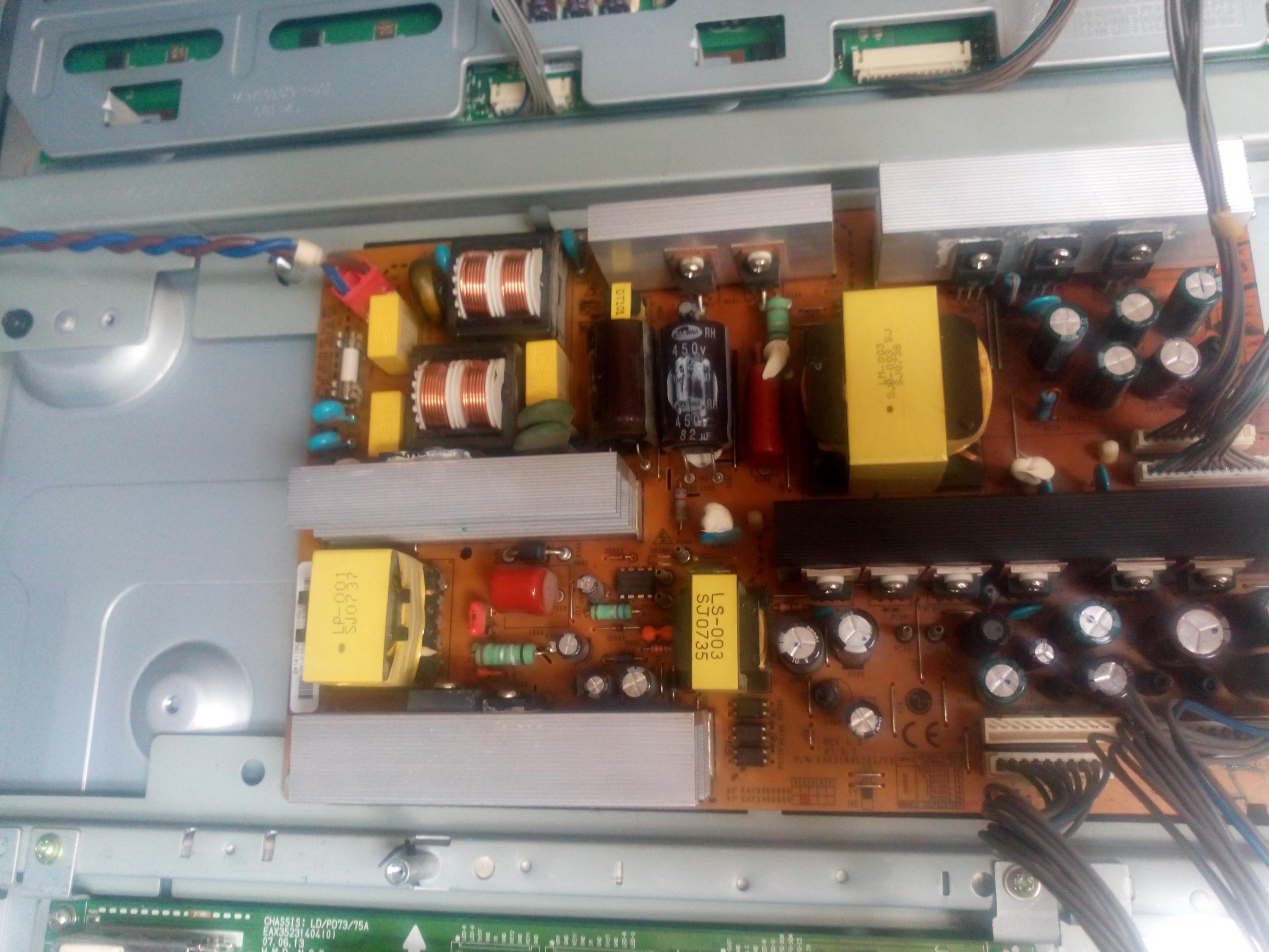

                                #35
                                Re: LG 37lc55 turns on few minutes later screen goes out
                                check the smd caps next to the voltage reg on the main board. and the smd mosfets on the rear of psu
                                post pics of main board,
                                • Blueeyes
                                  • Jun 2015
                                  • 60
                                  • Uk
                                  #36
                                  I'll check the MOSFETs on psu I had a new main board off eBay but same problem persisted unfortunately not sure if it was dodgy board or psu. Will upload photo in morning
                                  • Blueeyes
                                    • Jun 2015
                                    • 60
                                    • Uk
                                    #37
                                    Here's picture

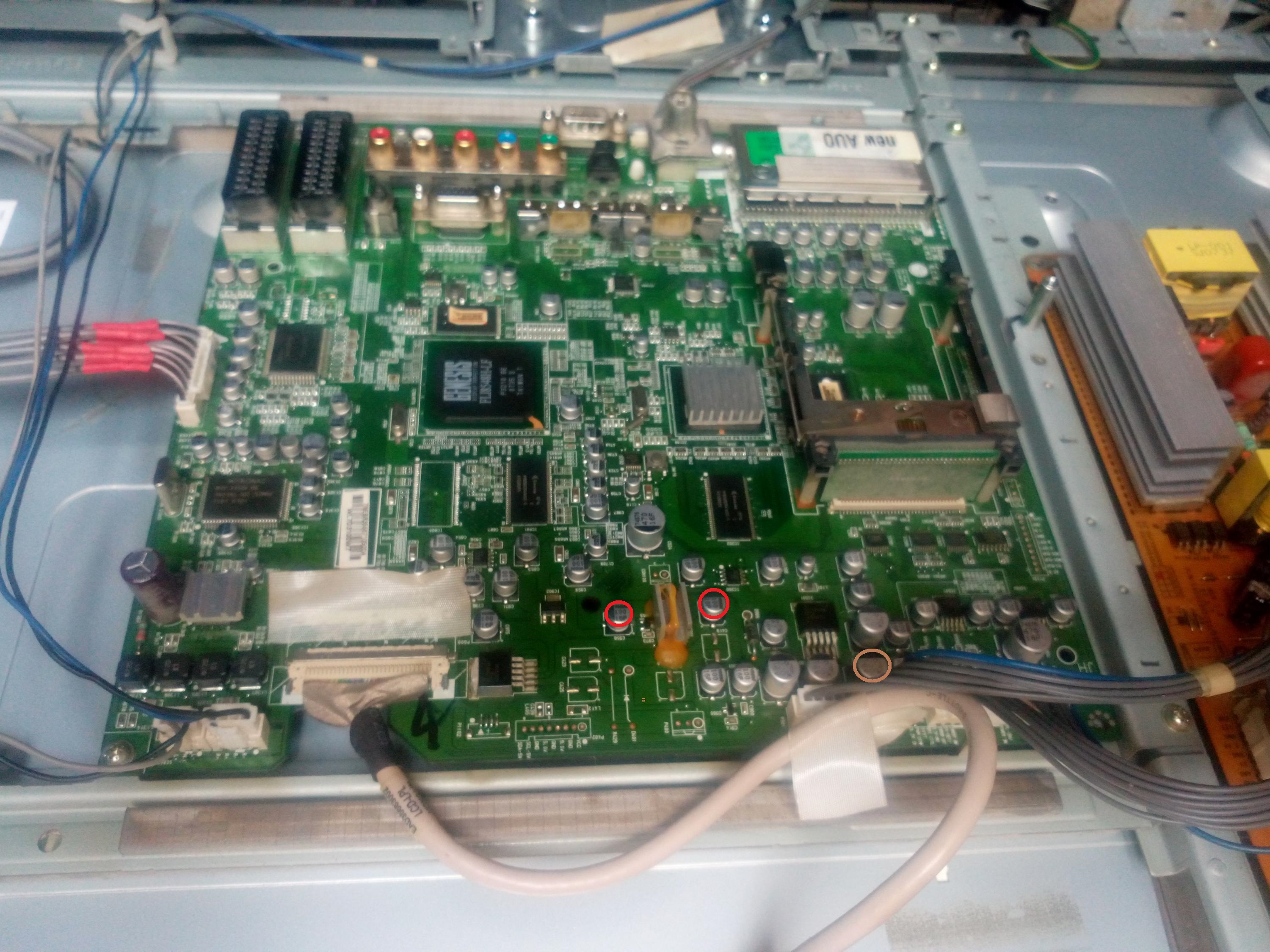

                                    • ozy
                                      • Jun 2009
                                      • 44
                                      #38
                                      change the caps I have marked in red, and check the one I marked in brown.
                                      The two red ones cause picture flicker or total lose of picture. I always change these for reliability.

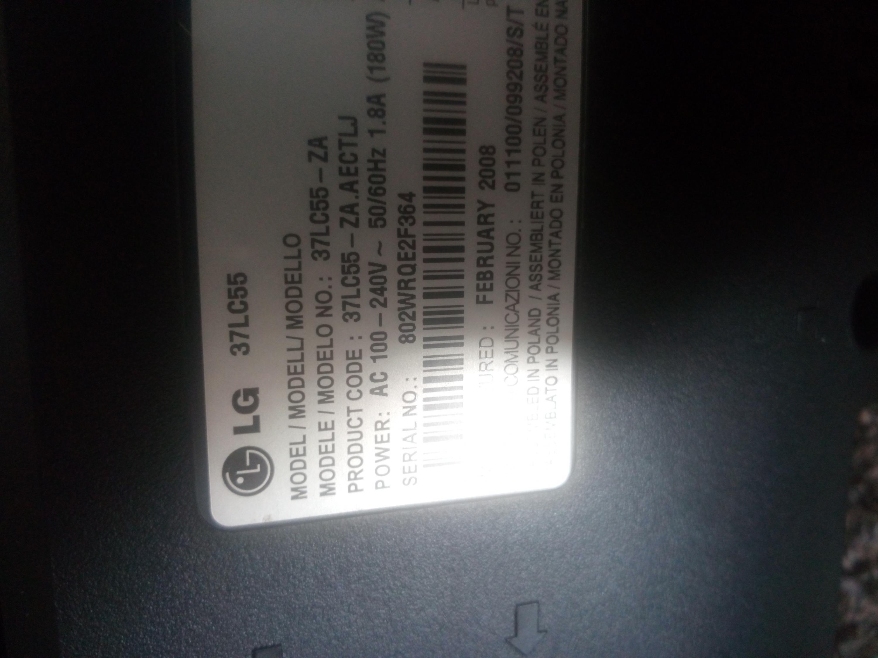

                                        Just reading this now are you sure this is a 37lc55 because I have one in atm which is a completely different chassis ? Also the one I have is a panel fault what panel does yours use ?
                                        • Blueeyes
                                          • Jun 2015
                                          • 60
                                          • Uk
                                          #40
                                          Yeah positive well its what's stated on model sticker on back and no idea the panel make sorry, doesn't appear to say anywhere.
