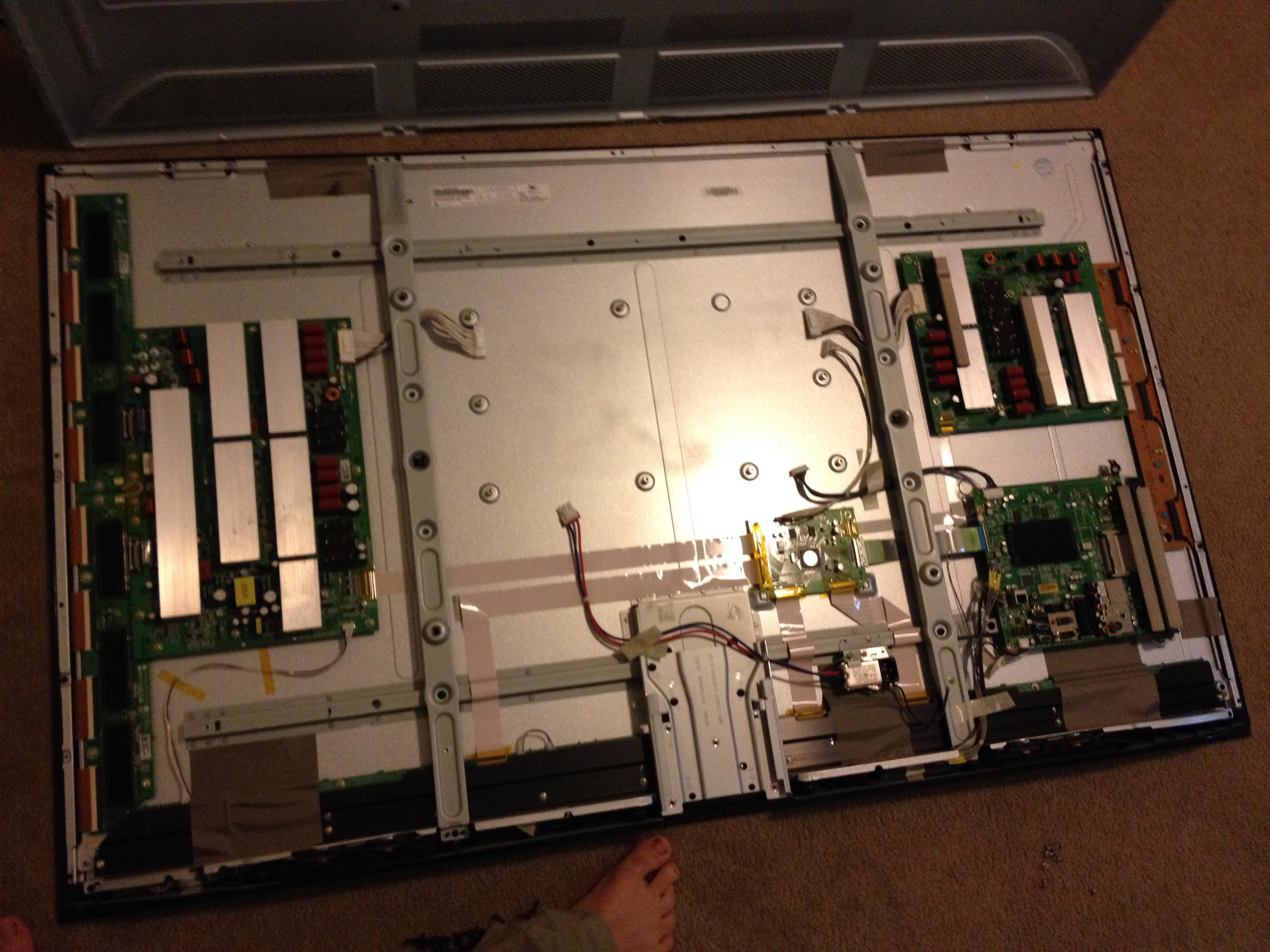

    Can you get photos of the boards inside the set?

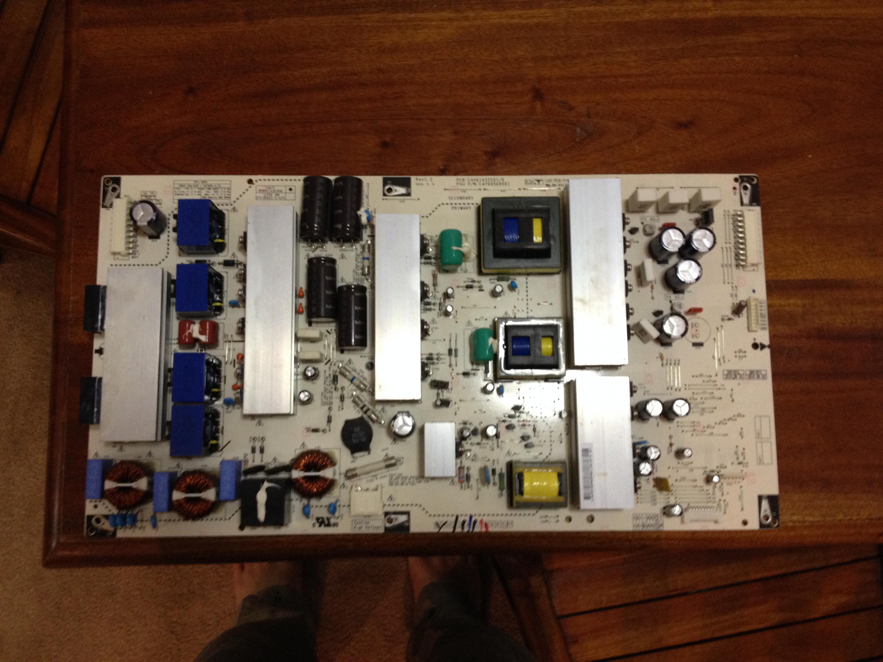

      Hey I took some pictures,
      and the power board is out
      Sorry I couldnt take any more pictures it takes forever to upload pictures here

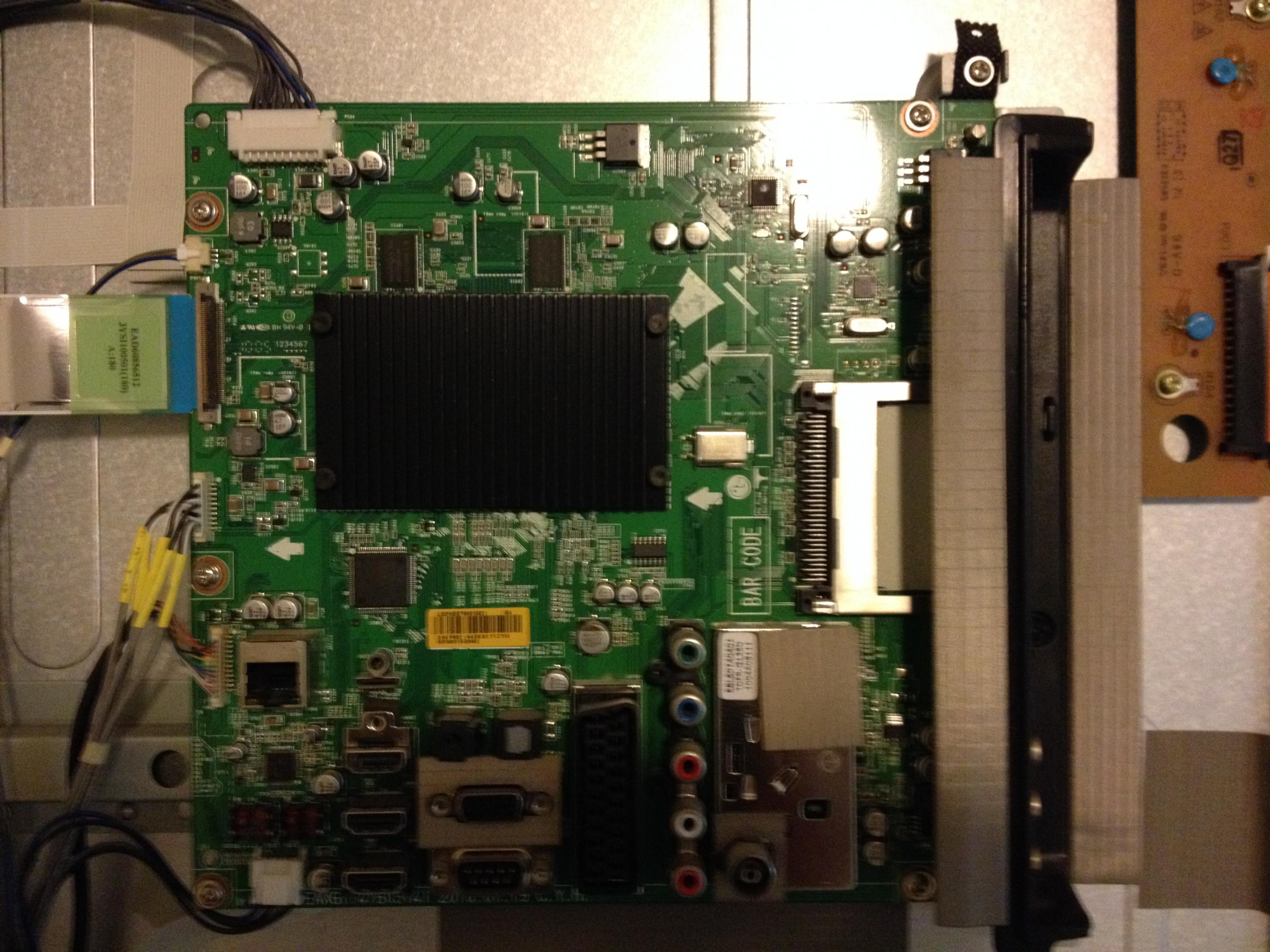

        I'm going to need two more pictures. One of that small green board to the left of the main AV board (the main AV is the one with the HDMI inputs on it) and one of the legend for the pins next to the connector on the power board which goes to the main AV board.

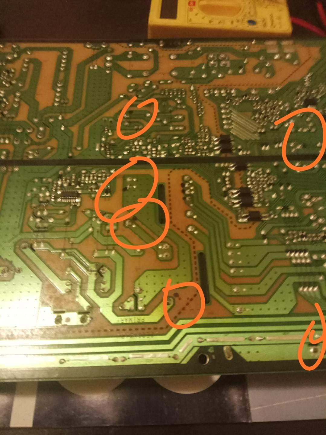

              Check for Cold Solder on back of Power Supply, very common issue on this series with the fault described.

                  Check these areas as pictured for cold solder.
