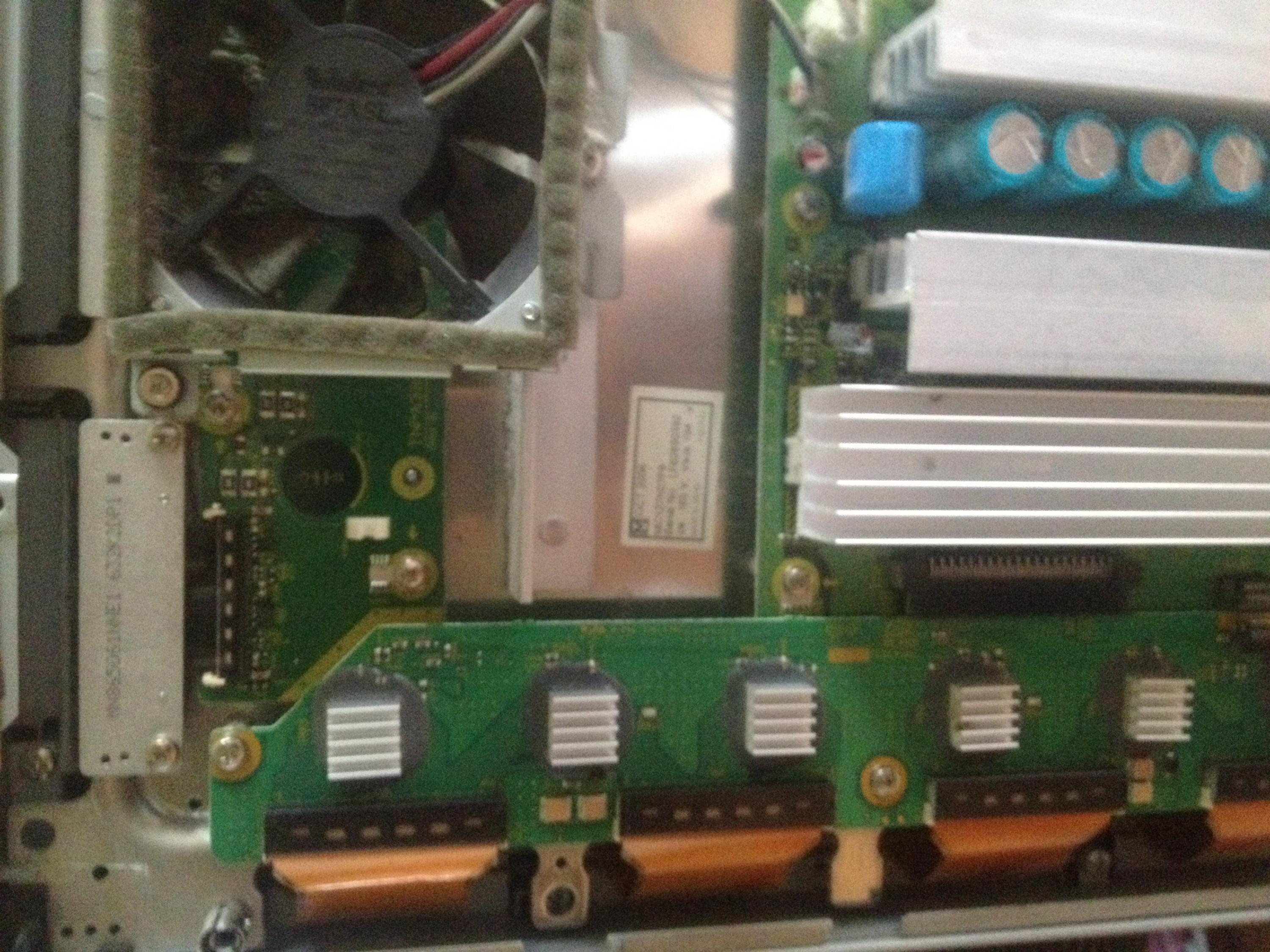

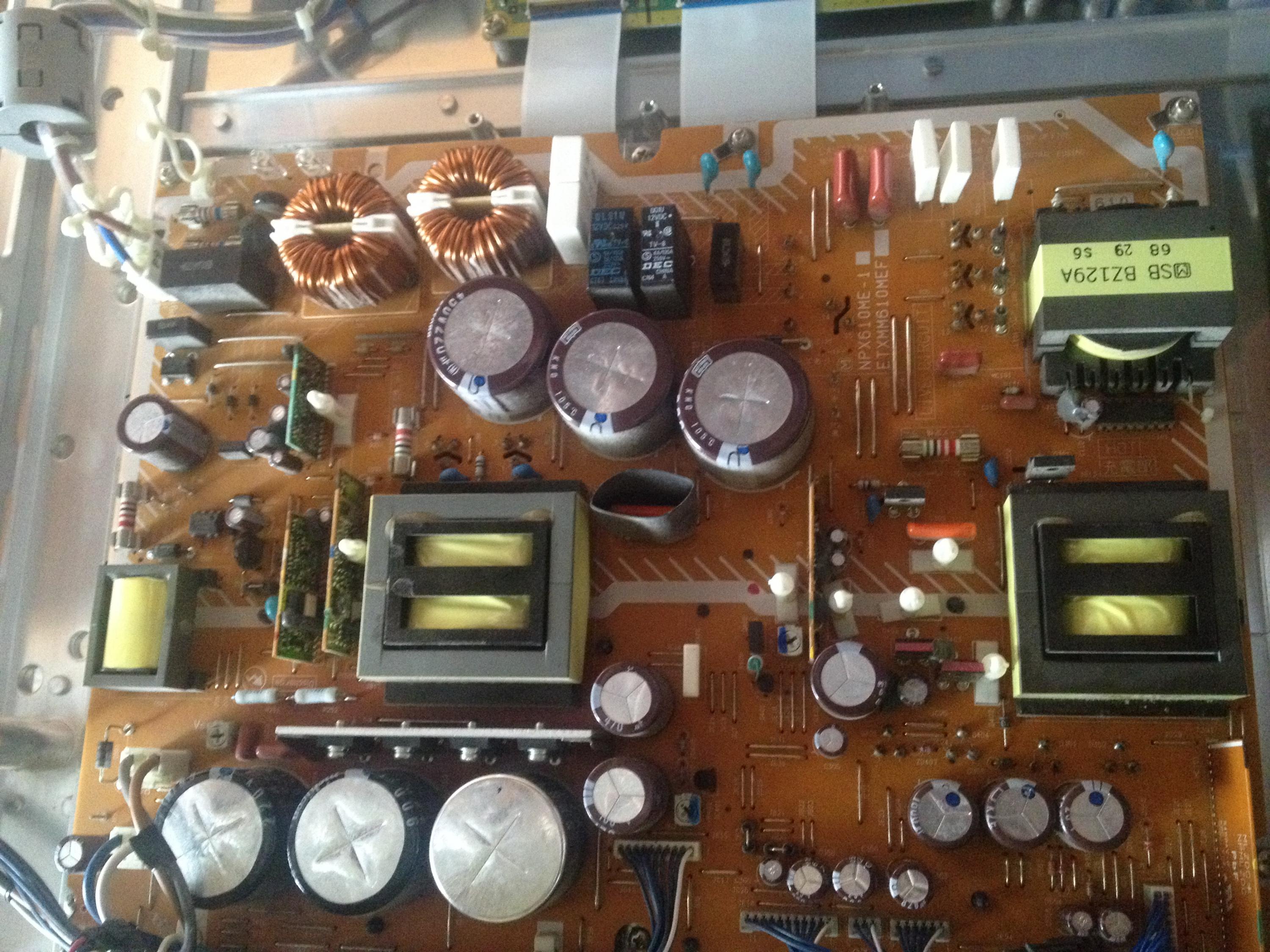

    hello i bought a Panasonic TH50PX60U its used and not working i was told it took a shock it has no lights or power and all the fuses on the power supply are not blown any suggestions?

        Clear straight shots pictures would help... to point. Other than that, you need a multi meter to measure AC and DC voltages.

          Re: Panasonic TH50PX60U Power Problem
          Here's a pic

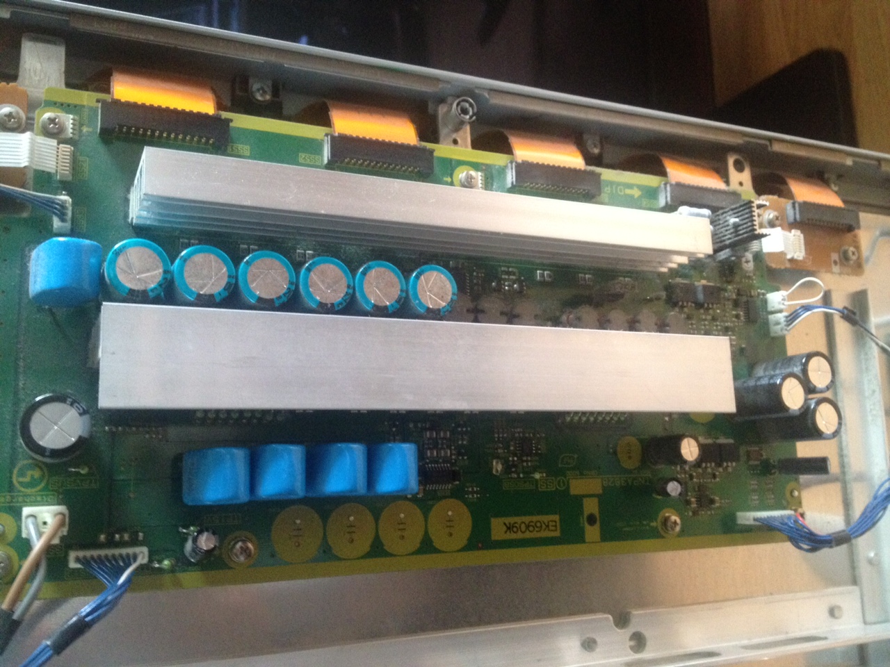

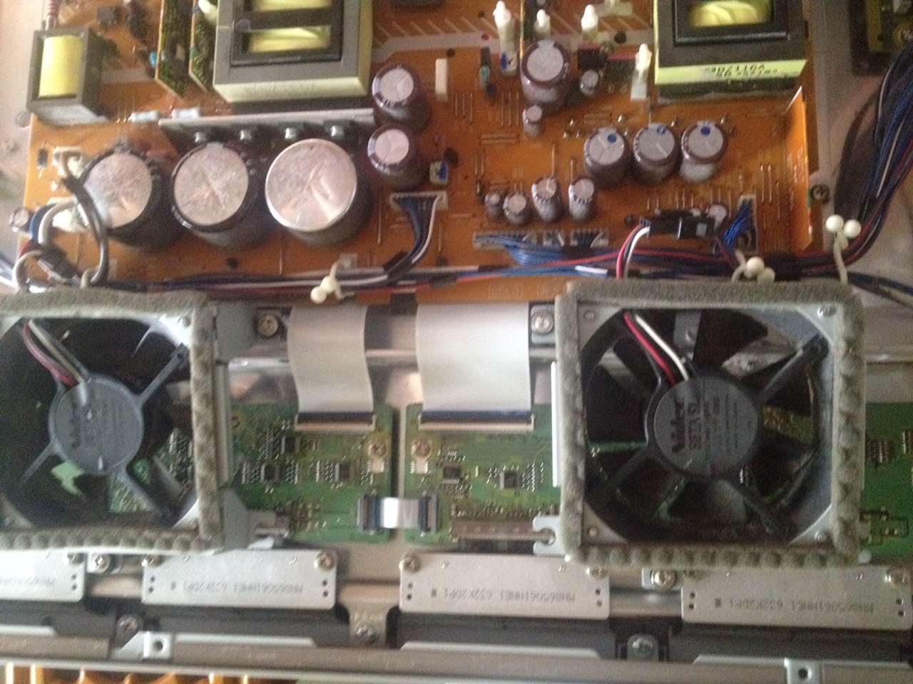

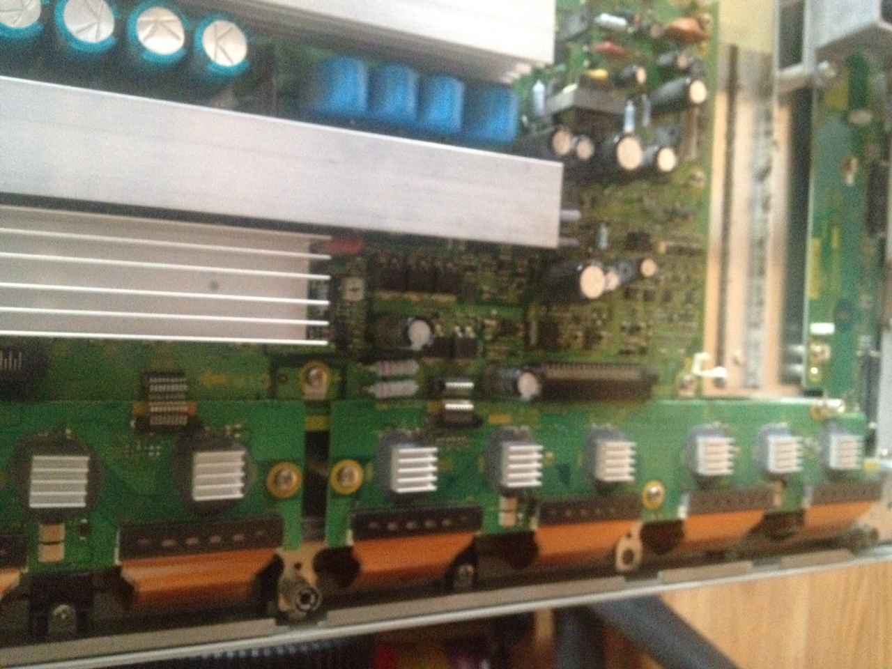

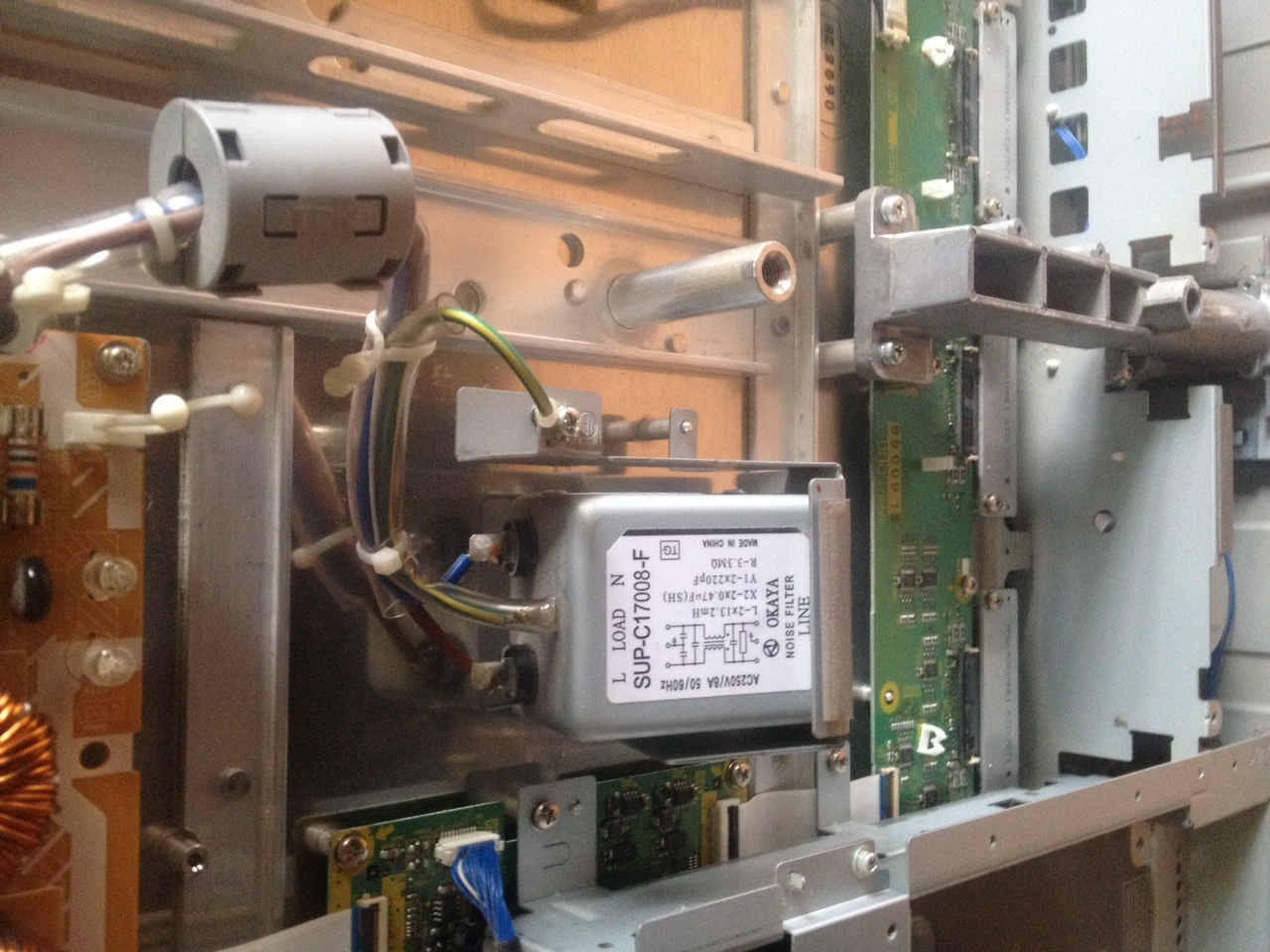

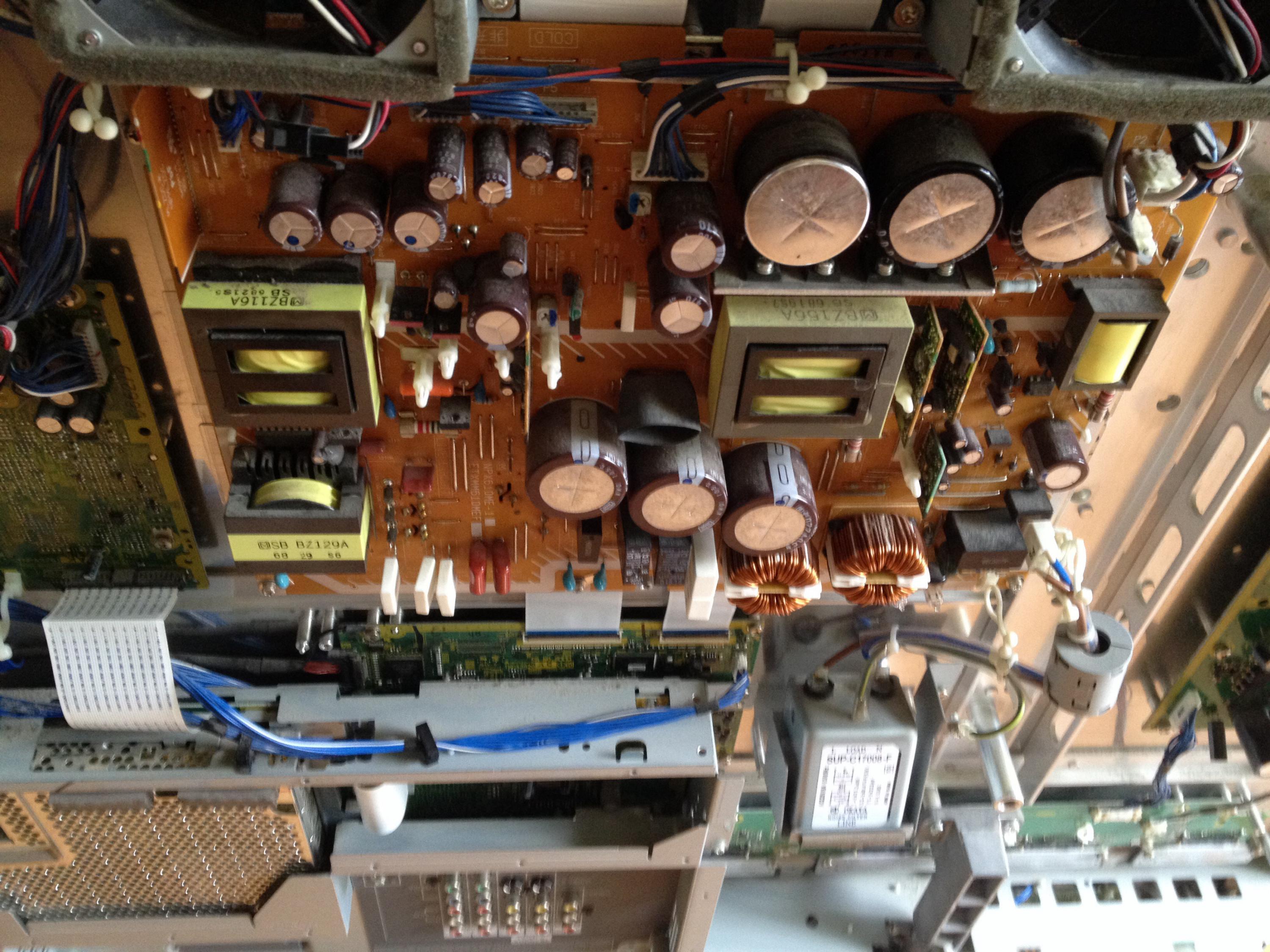

              You'll need better pictures than that.
              One pic of the whole assembly.
              Then a picture of each board.

                  Check those capacitors that have the shrunken sleeves as well, they might be bad, or deteriorated.

                    Pictures and what do you mean by shrunken caps?

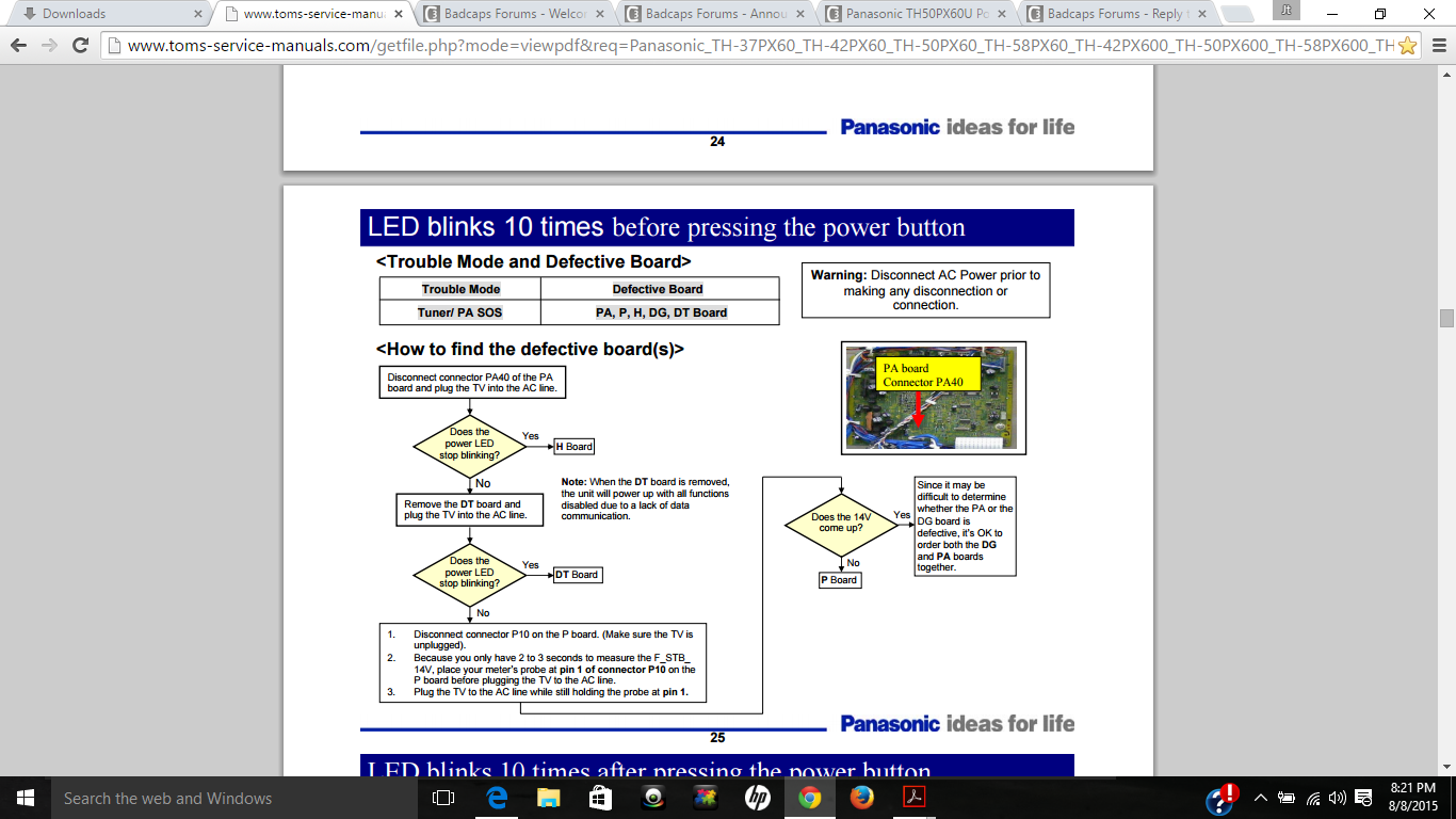

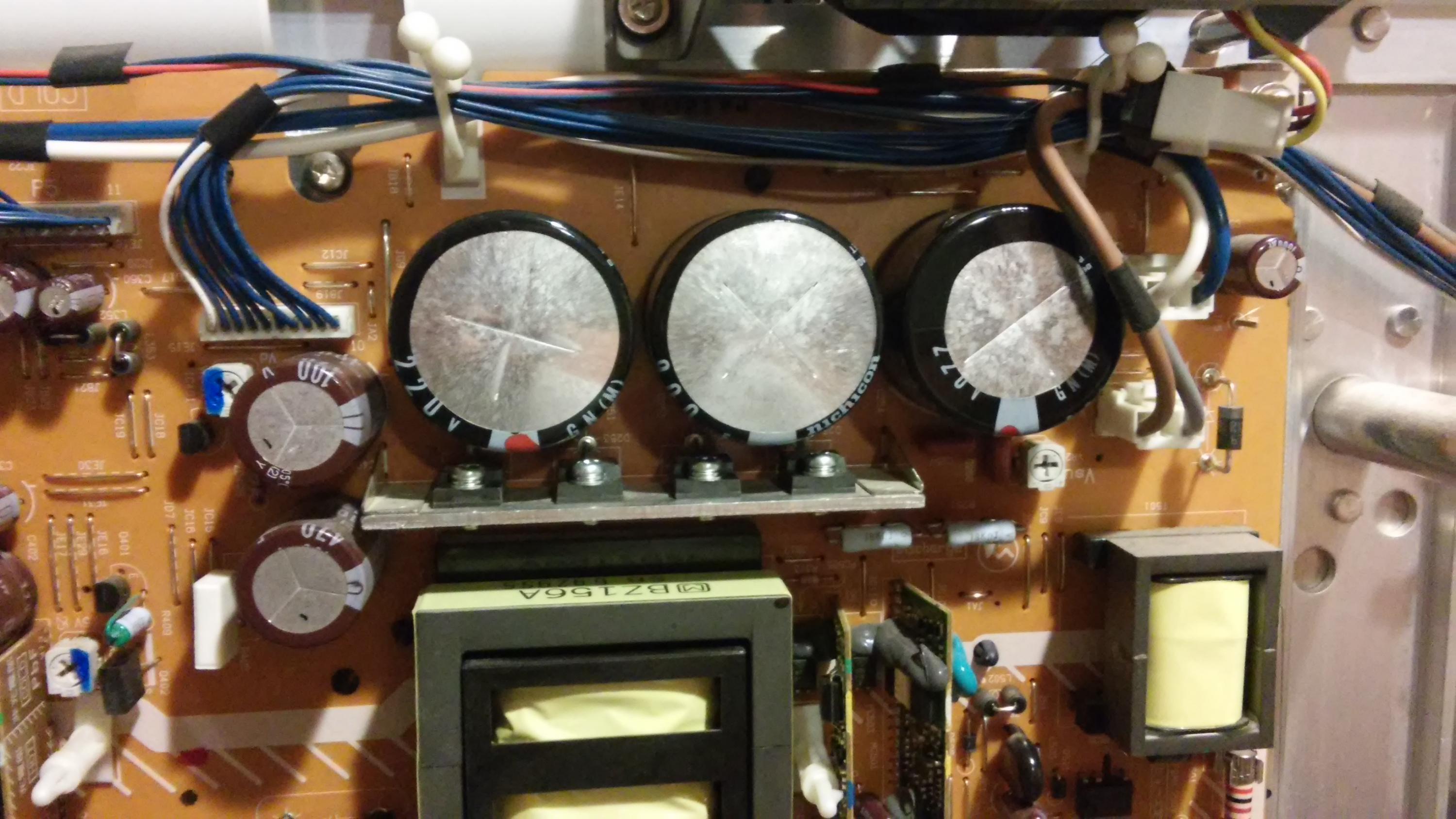

                                I have the same TV and the same problem. So instead of making a new thread I'd like to ad on here and hopefully it will help the other gentleman out. I have attached the 10 blink before power button pressed flow chart from toms serice manuals. I have followed all directives on it and found myself at NO 14V at Pin1 of Connector P10 on the P-board. I would much rather find the exact fault instead of replacing the whole P-board, as I was trained to troubleshoot faults and replace components as part of my job in the Navy. If anyone on here could assist with the next steps in either halfsplitting/ troubleshooting the exact issue so that I may fix this I would be very appreciative. Thanks
                                • jtgamble89
                                  • Mar 2015
                                  • 4

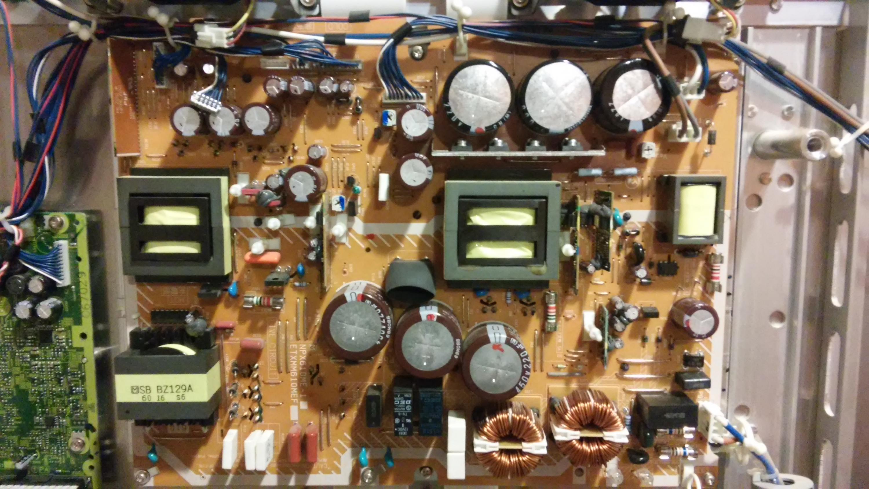

                                  Also I have included a picture of the P-board. It looks as though maybe 2 of the three 220V/900microfarad capacitors at the top may be a bit heavy. not sure if they are bad, how to test, or if that is an issue regarding no 14V due to no schematic or more detailed troubleshooting guide.
