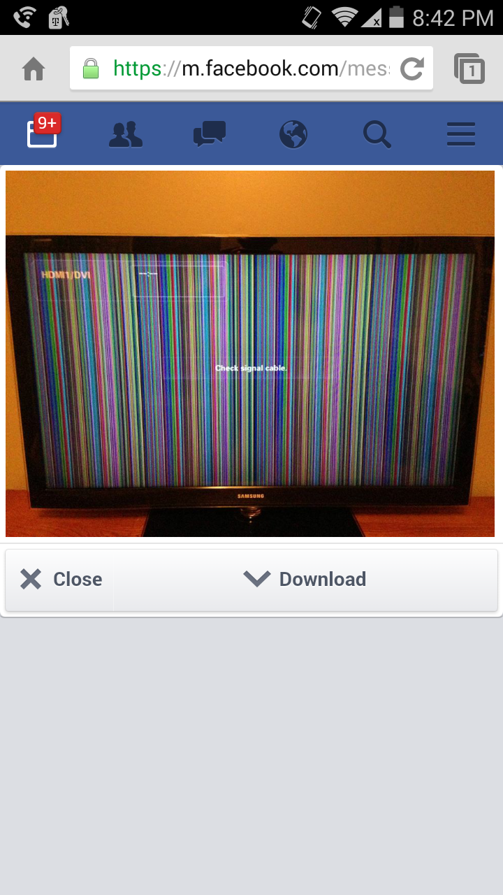

Samsung tcon or panel?

    Just trying to see if this is worth getting an new tcon

    Re: Samsung tcon or panel?
    It does seem like a ridiculously high amount of stuck columns for a bad panel.
    Also, the pattern seems to repeat over and over. Might even be something like a faulty graphics processor in the mainboard.
      If it is bad T-CON I would not expect the TEXT to be normal at all. I suspect something on the main board.
        Bad mainboard, LVDS connector on the main is probably the suspect part. Common issue with those.
          Would say main board too maybe soldering under processor or bad RAM around the processor.
