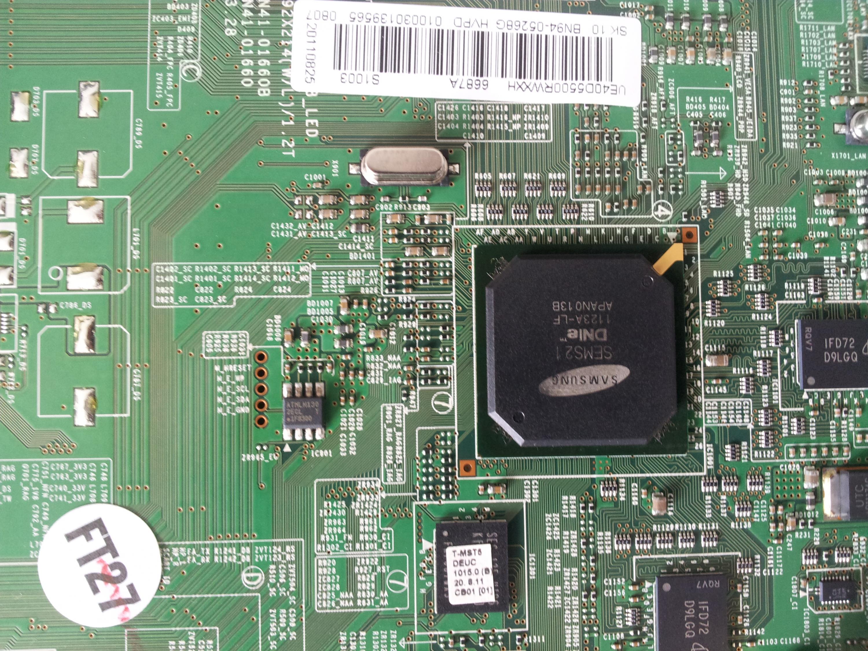

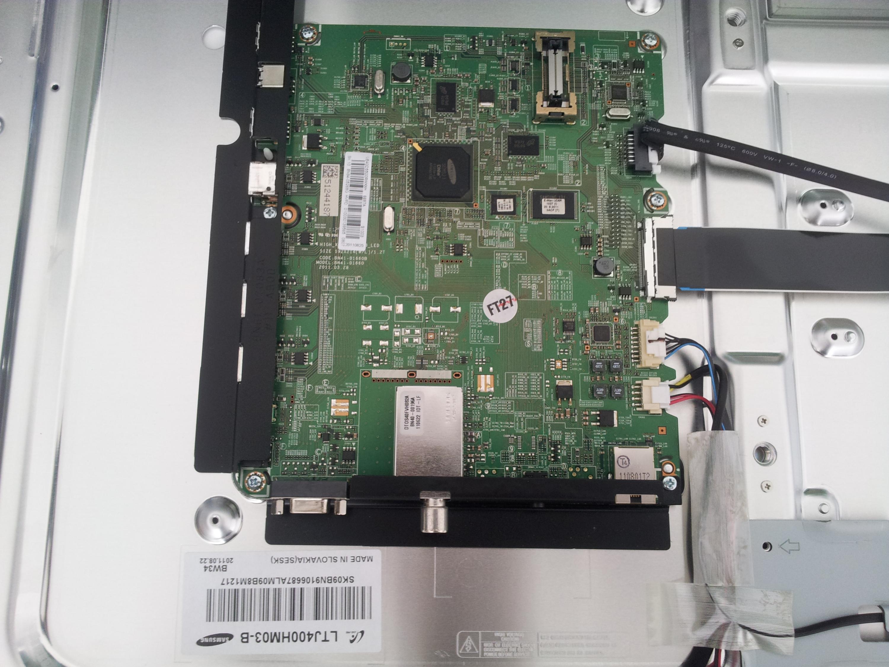

                      Re: Samsung UN40D5550RF power cycling
                      I had UE40D5500RW with SEMS21 IC1001 and K9GAG08U0E IC1302 faulty.
