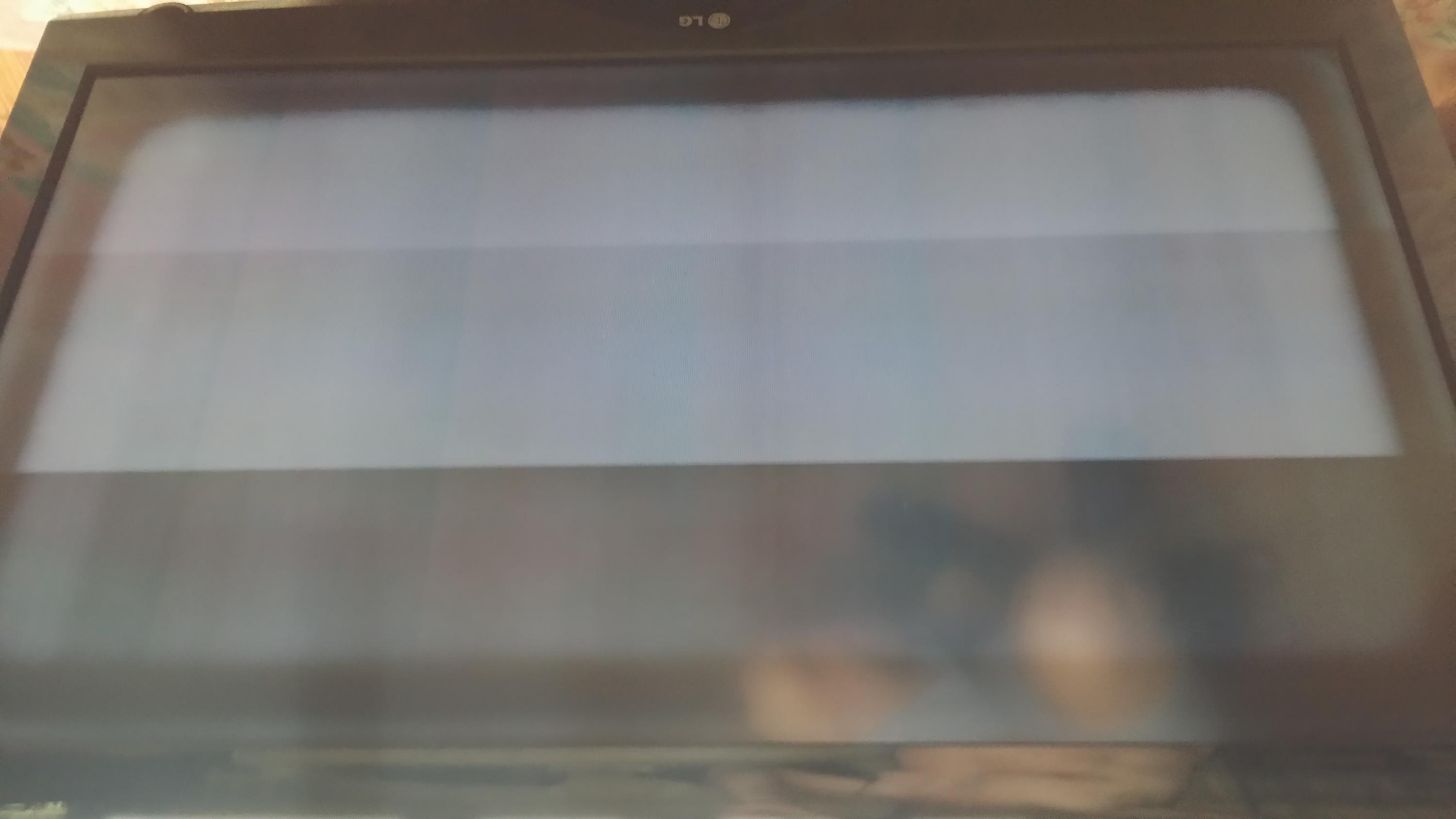

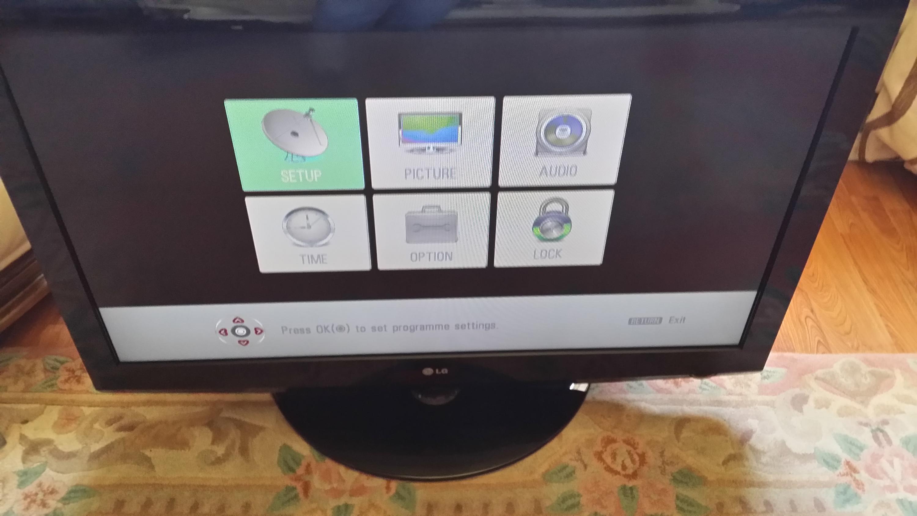

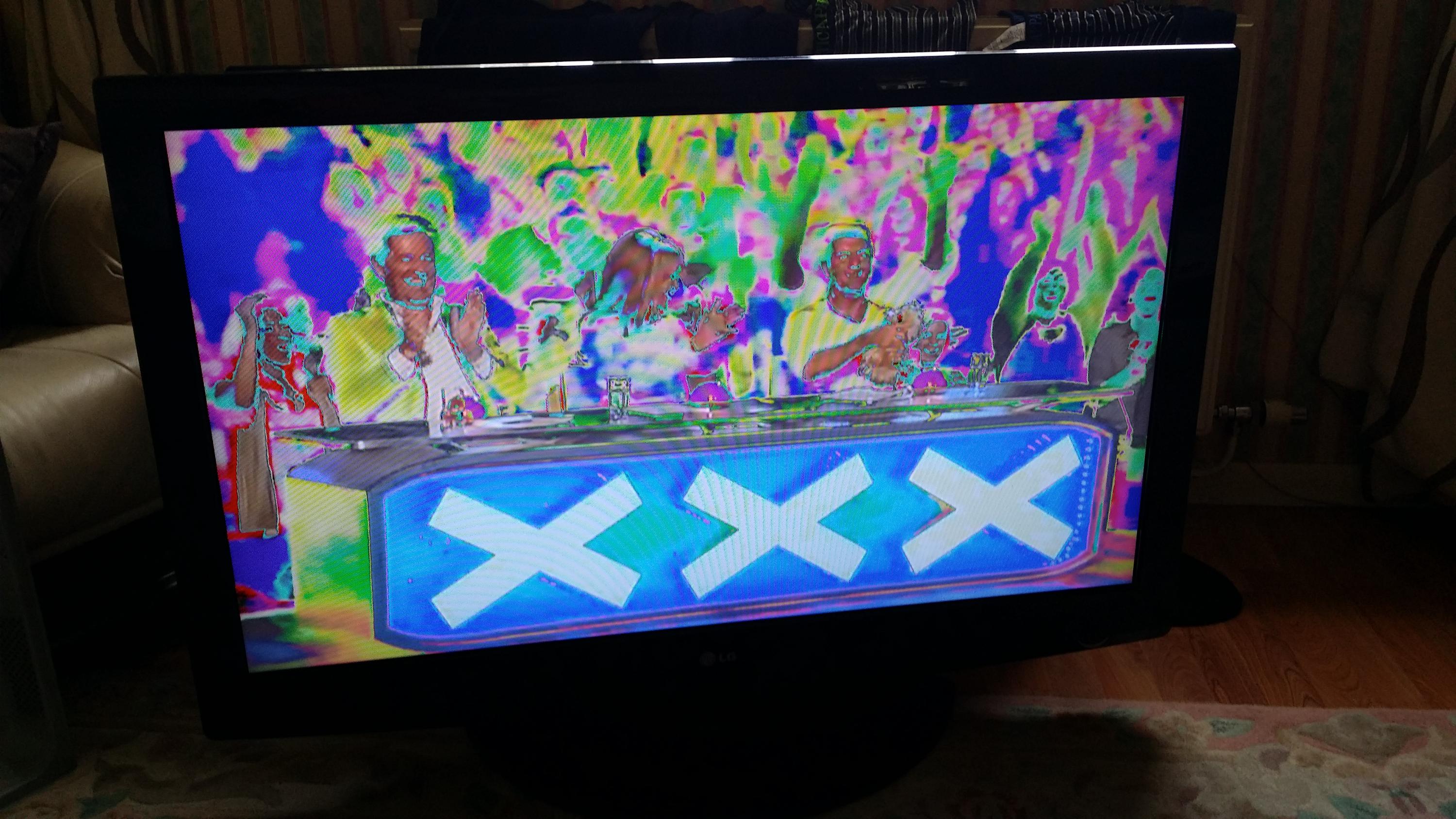

    Help needed please, been given this faulty 42LG3000 that was going to landfill.
    TV all seems to work fine apart from picture
    when first switched on screen is white with a dark shadow around the edge after a few minutes warming up the picture comes on heavily solarised, menus also are same
    Removed and refitted lvds cable from main to tcon no change in picture
    Anyone experienced this before,
    I assume it must be mainboard, tcon or lcd panel, but which one

        Re: 42LG3000 solarisation, tcon or lcd faulty
        Looks like two faults.
        The solarisation is a known fault due to AS15F (T-con IC failure) - easy to fix with the right equipment.
        However the white banding is likely to be a panel tab bond fault that may or may not be fixable.
          do you think its worth trying a replacement tcon board
            tv has been on for several hours now with a solarized picture, however picture is now flashing constantly from solarised to perfect picture every few seconds
              Tcon board replaced tv working fine now
                Thanks for the follow-up, I did not really expect that the banding was caused by bad T-CON, learning something new today.
