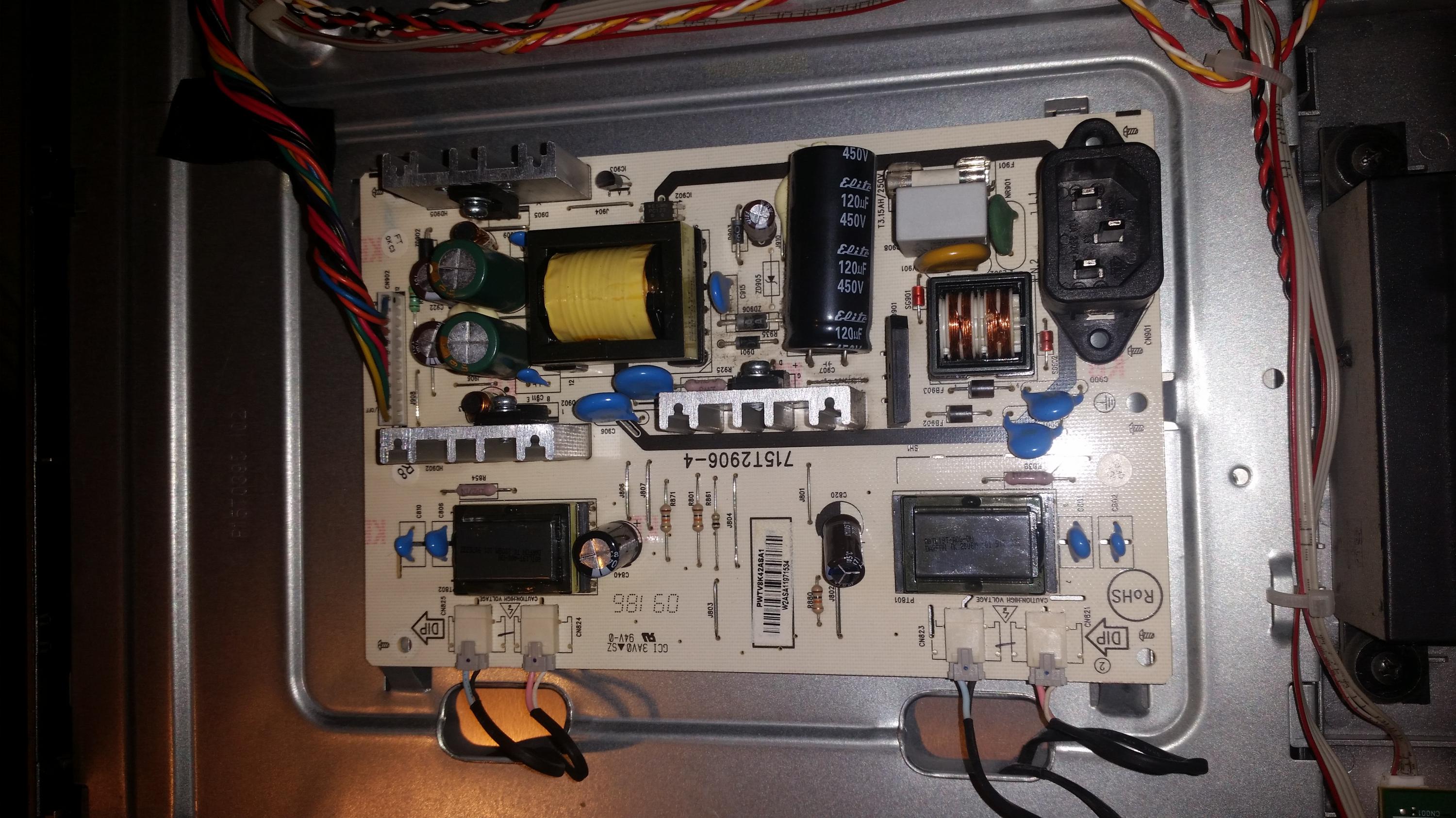

    Picked up this vizio TV. It powers on flashes the screen but backlight isn't staying on. Checked with a flash light and was able to see the no signal image... Found one bad cap on the main board. Still no backlight. Changed the 2x 16v 470uf by the inverters but still nothing. I'm getting the correct voltage to the main board.. (12v and 5v) power and inverters are on the same board.

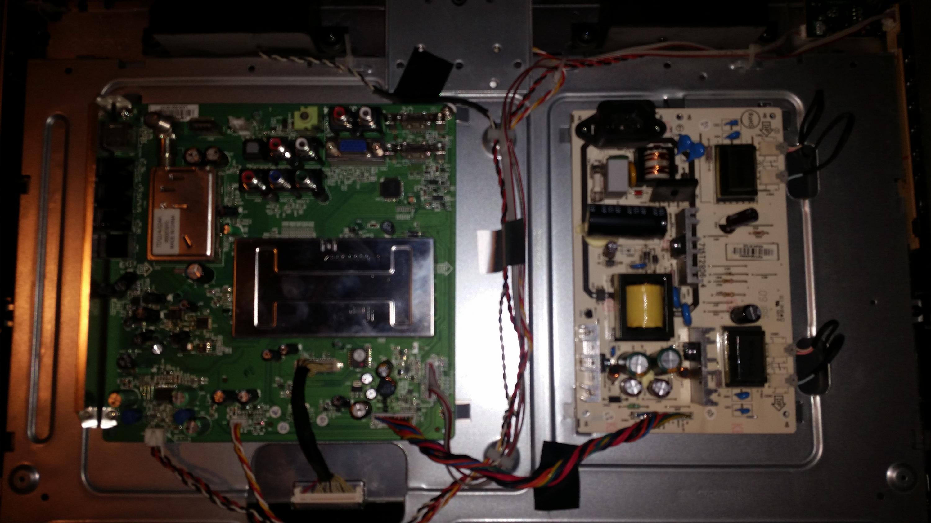

      Any good clear pictures of the boards and how they are all connected together?

          The inverters are on with the power board. Will get pictures up soon

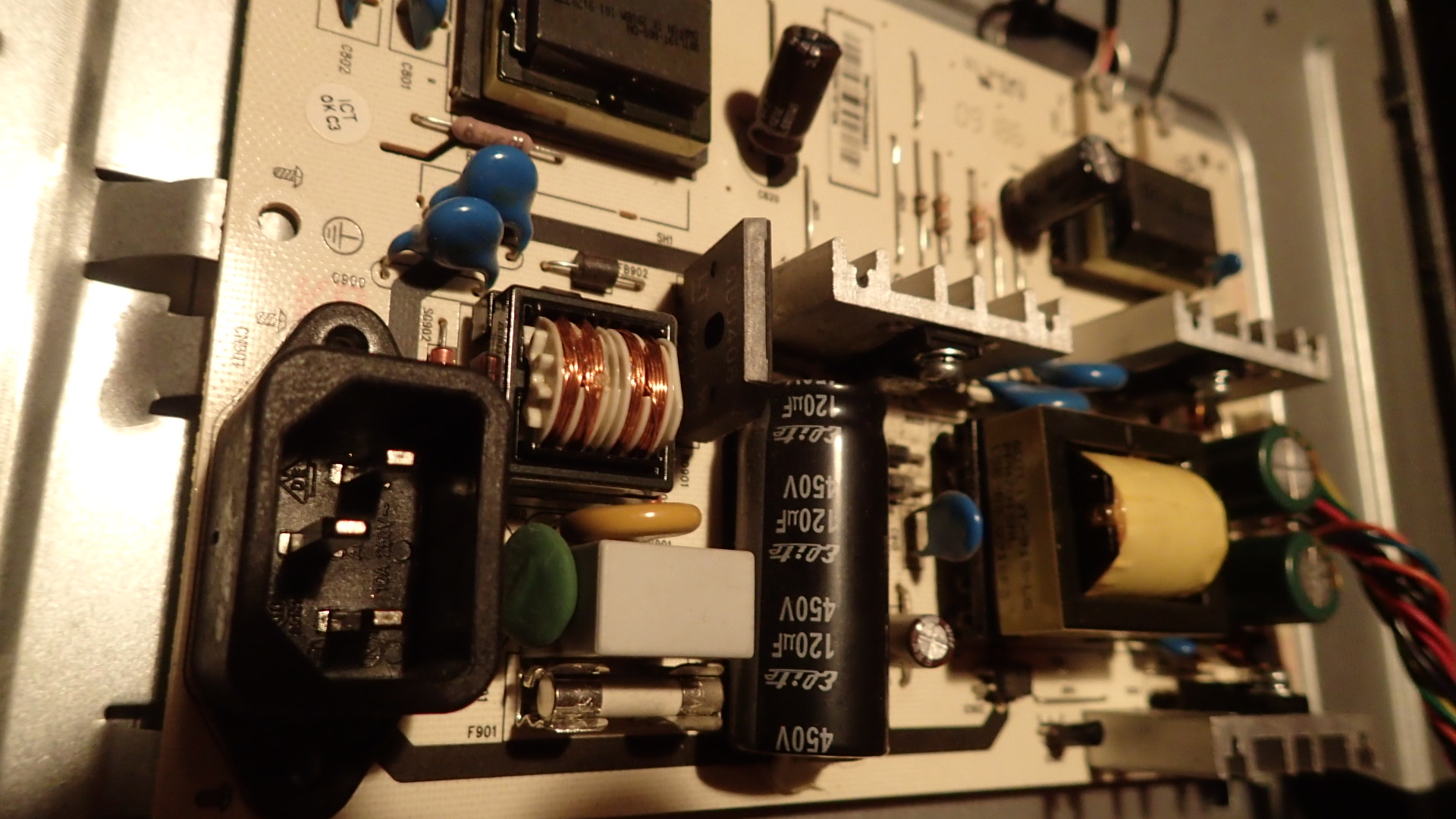

                Re: Vizio va22lfhdtv10t no backlight.

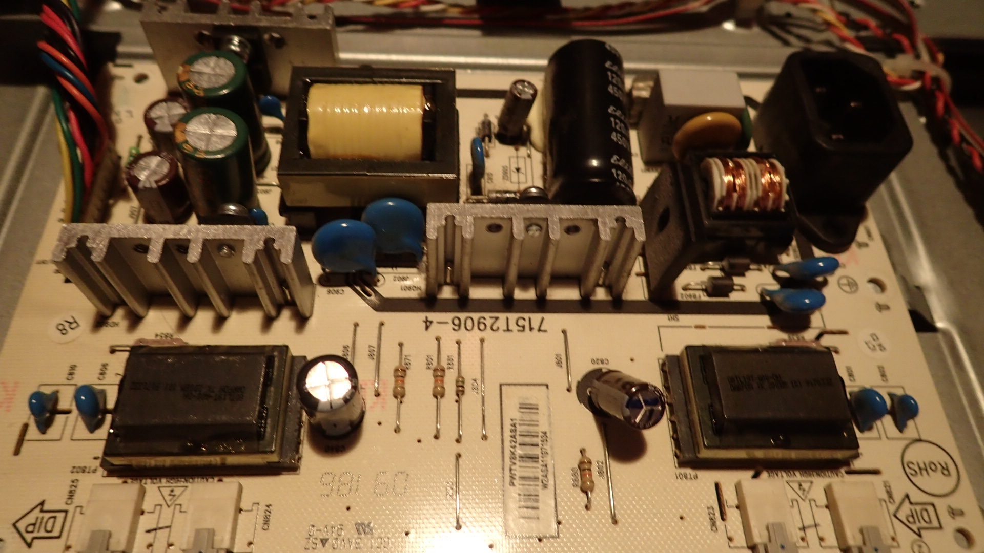

                Ok finally was able to get some pictures.

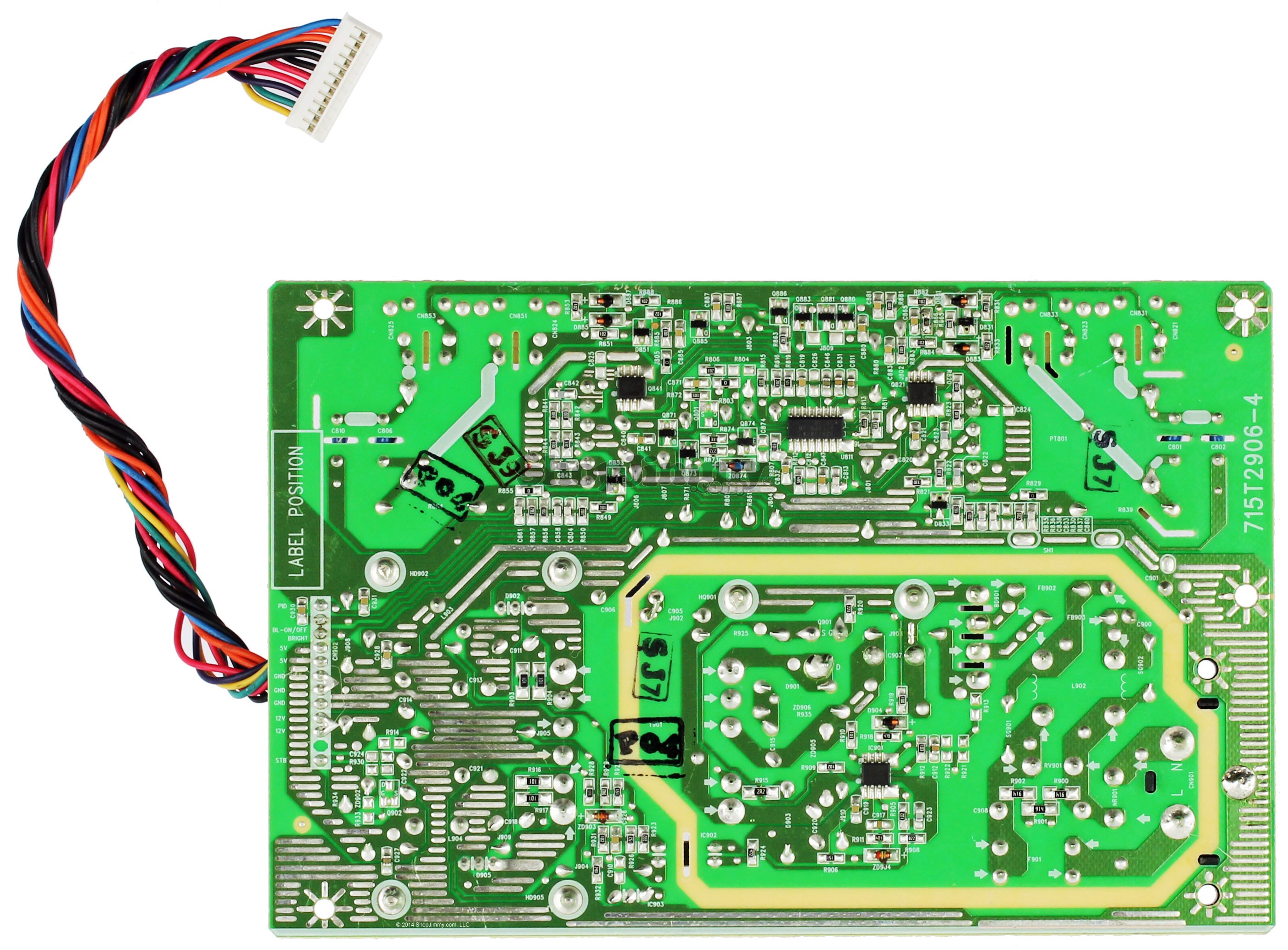

                  Can you please post a good focused straight down photo of the bottom of the power supply board? There are some switching mosfets that should be checked.

                    • erickeri1234
                      • May 2013
                      • 98
                      • usa

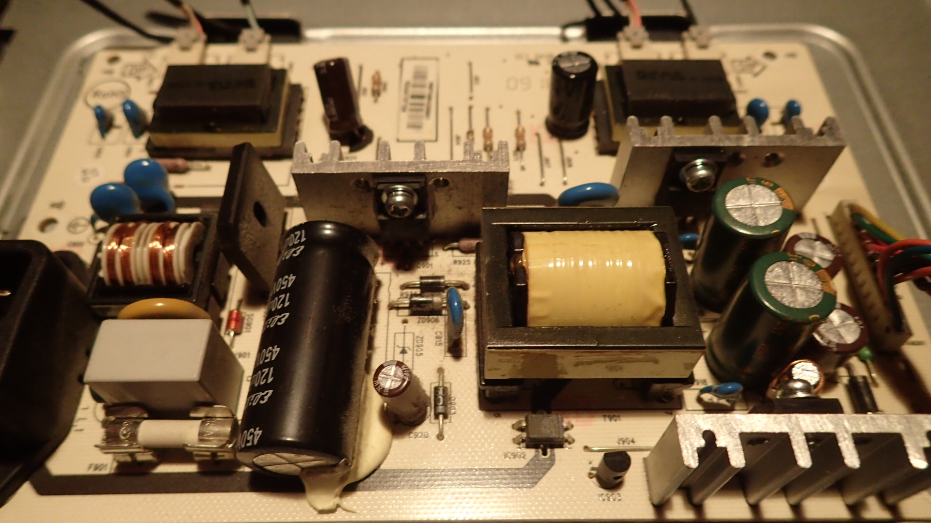

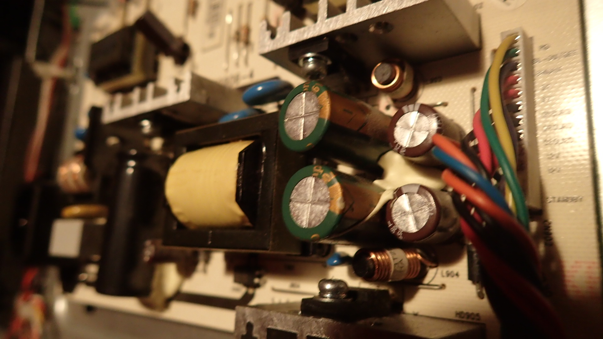

                      Updated with more pictures

                            • jetadm123
                              • 2169
                              When I said photos of the bottom of the board, I meant turning the board over. We need to see what's underneath. Your photos need to be in better focus.

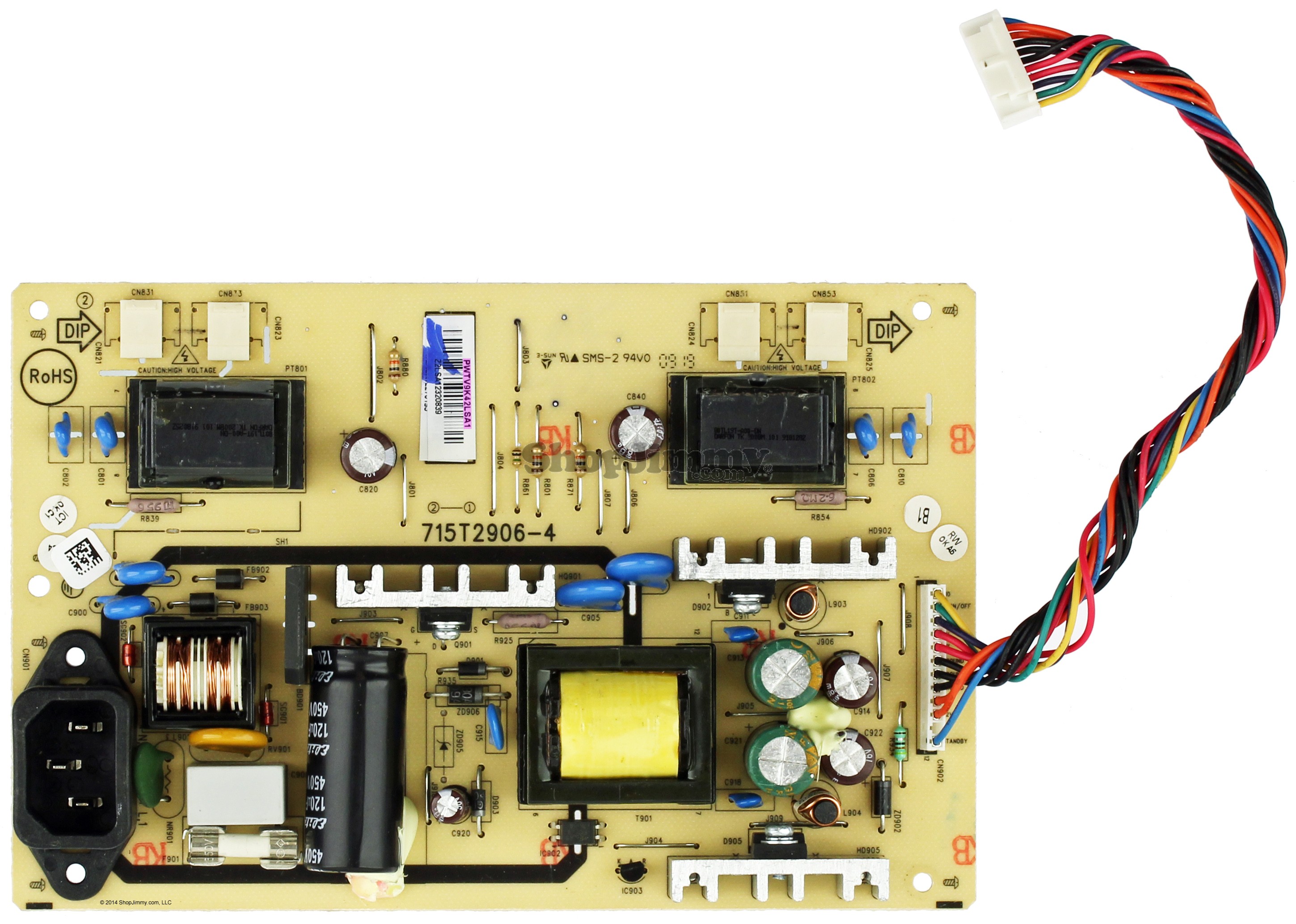

                                  "PIN 12 - STandby - 0.0v" STBY on this board is the same as PS-ON pin, it is not being used on this board because this is an always on power supply.
                                  There are two 8-PIN SMD power MOSFETs on the bottom side of the board that need testing as mention by the other.
                                  Pictures are provided by SHOPJIMMY.
                                    Sorry jetadm you did say bottom. I read it to fast.
                                        OK I tested the two SMD power MOSFETS.
                                        There are three of them The two I tested are close under the inverters. On both of them pins 1 throu 4 have 0.0 v , pins 5 throu 8 have 13.3v .
