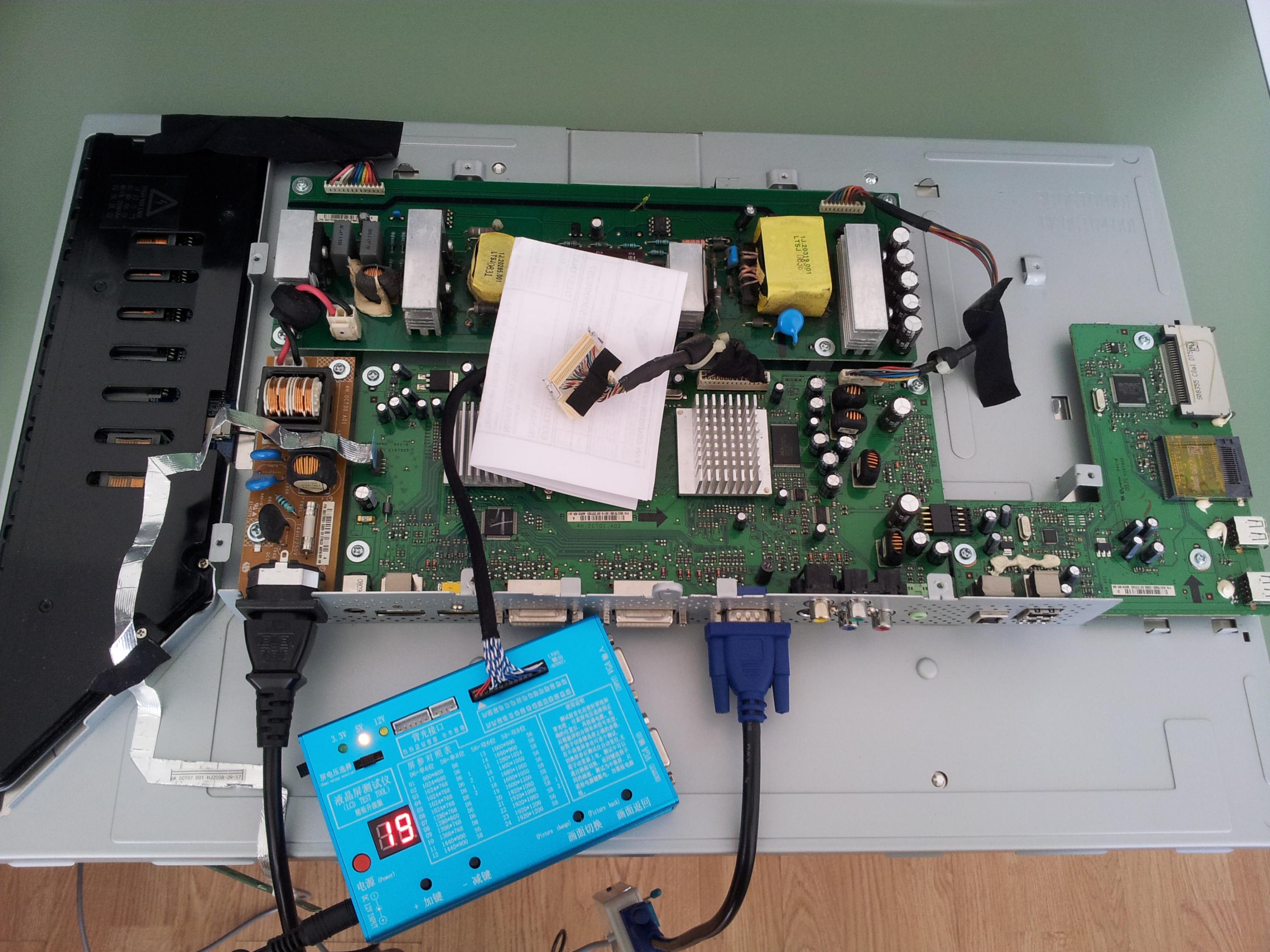

        Re: Samsung Un55eh6001F
        Originally posted by MikeyW View Post
        Does anybody else know any tricks on how to isolate the problem?
        You need a LCD TEST TOOL.
