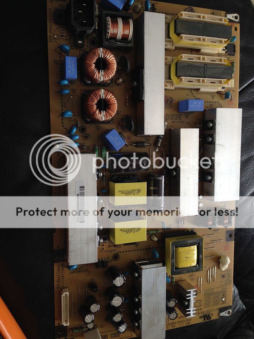

    I have an lg that won't turn on.
    The red standby lights on and when I press the on button the light dims
    Nothing else happens.
    I've replaced all the caps.
    It has the 3.3v and when power button is pressed the power/on pin jumps to 3v the straight back to 0v.
    Also tested rectifier. Diode. Resistors. And regulators. All seem fine.
    If I jump 3.3v to the pwr pin I get the 12v on the other pins
    This is a clue.
    What do the power board outputs do when this happens?
    How long does it jump up for...?

        So... would it seem to you that the power board is working... esp since it works when jumped?

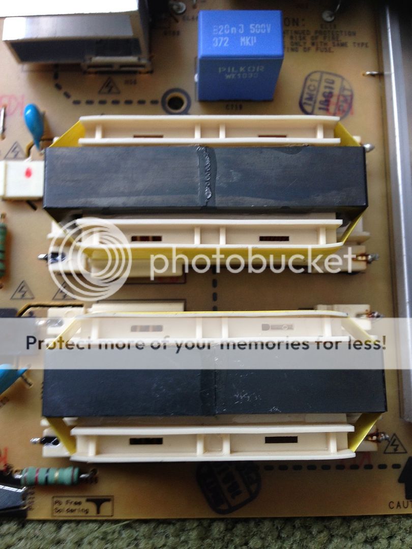

                        Could it be these. As don't know how to test
                          Re: LG Won't turn on 47ld450

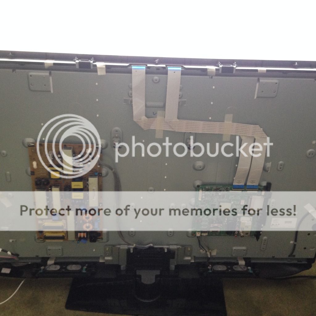

                          Those two are high Voltage inverter transformers for CCFL, your TV does not have LED backlights.
                          Pictures of the whole backside of the TV?

                            LED TVs, have T-con boards as well.
                            Most likely, the "new" mainboard is bad. Do you get power on and inverter on signals? I have repaired a 47LD550 and 42LD450, with bad mainboard.

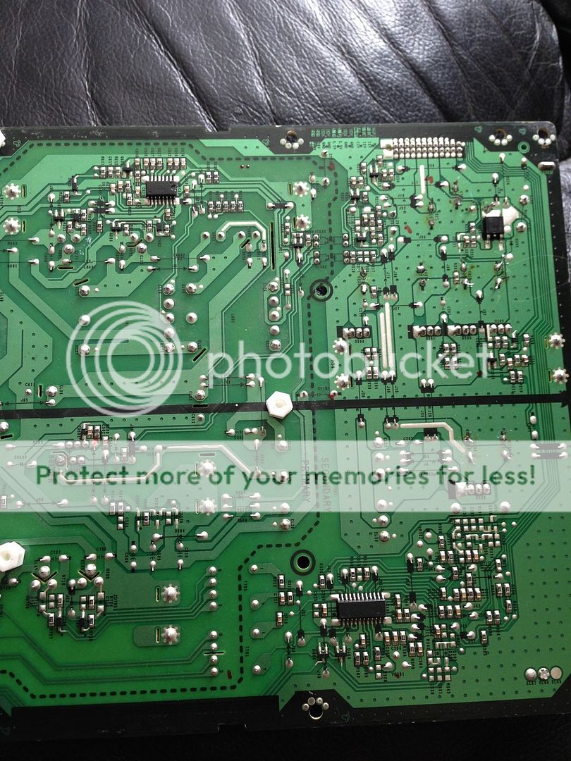

                                  Every pin gets power except inv on/off
                                    LCD panel with integrated T-CON.
