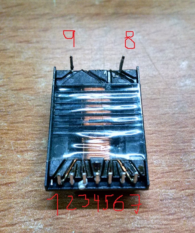

    Hello all, I have never tested a transformer before, this is the reading (out of circuit) I got:
    1-(2-6) = open
    7-(2-6) = open
    1-7 = 0 ohm
    1-8 = 4 Mohms
    1-9 = 7 Mohms
    7-8 = 0.5 Mohms
    7-9 = 3 Mohms
    I attached picture of transformer with the pins sequence. It's an IT-003 inverter transformer.
    If it's bad, do I have to find an exact replacement? I have lots of dead PSU's laying around, the transformers are not the same, how do I solder them to test on the inverter board?
    Problem with monitor is going dark after 2 seconds (the backlight, power LED is still powered on).
    Re: Is this transformer bad? (Measurements inside)
    Looking at your picture, Pin 1 & 7 are for the Primary winding, it will have very Low OHM.
    Pin 8 & 9 are for the high Voltage winding, typical value can be from 500~1K Ohms range.
    Compare the readings of this transformer with the other one that is the same as this one.
        1 & 7 are primary winding 0,2-0,5 OHMs,8 & 9 are secondary winding and value can be 500-1,5 KOHM .....your transformer is bad.....between primary and secondary is infinite resistance
          Nope, you have to get the same one.
          What kind of monitor is this that uses only one small inverter transformer?
          Inverter transformer output voltage is around 1500V start and then drops down to about 800~1000V once the lamp is on.
            It's an LG W1943. Forgive me if I'm wrong, so if 8 and 9 are secondaries, they should be shorting right?
            Because, measuring pin 8 against pin 9, I'm getting 0.9 Kohms.
              "Because, measuring pin 8 against pin 9, I'm getting 0.9 Kohms." That is about right.
              It may have lamp problem, power supply problem, inverter circuit problem, etc.
                  Originally posted by orientalsniper
                  Thank you both! I will order a new transformer.
                  I doubt that it is bad transformer. The mega ohms reading may be due to your hands are on the probes and it shows your body resistance.
                      My bad! I misread your reply, you were right, that was my body resistance, primary against secondary reads infinity.
                      I don't think it's the lamp, because I'm having same problem with my inverter tester (turns off after 2 seconds).
                      Here's photo of tester: http://i.imgur.com/iyWbEBR.jpg
                      Thank you. At least I know transformer is good, so I can keep testing the other components.
