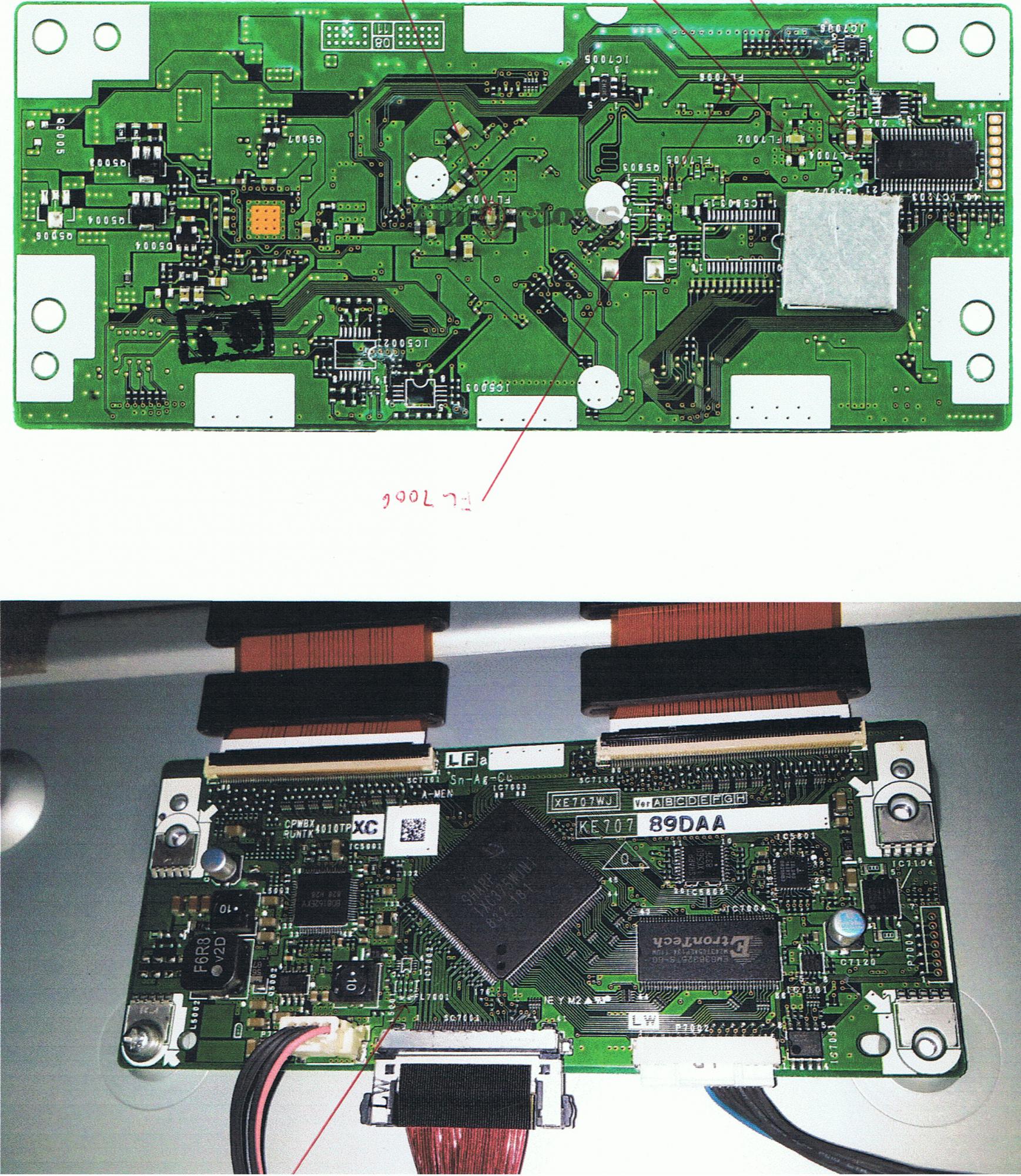

        Having trouble locating T-CON fuse ?
        Also looked in manual for T-CON layout bit vague to say the least could do with pointer where located on T-CON board !
          Re: SHARP LC-46D65E Dead power led blinking twice
          Check those FLxxxx:
          http://assets.shopjimmy.com/media/ca...pxc-bottom.jpg
          http://www.shopjimmy.com/sharp-cpwbx...con-board.htm#

            Not sure if this scan will be clear enough to see but if the ones i have circled are correct i am getting 0v either side ?

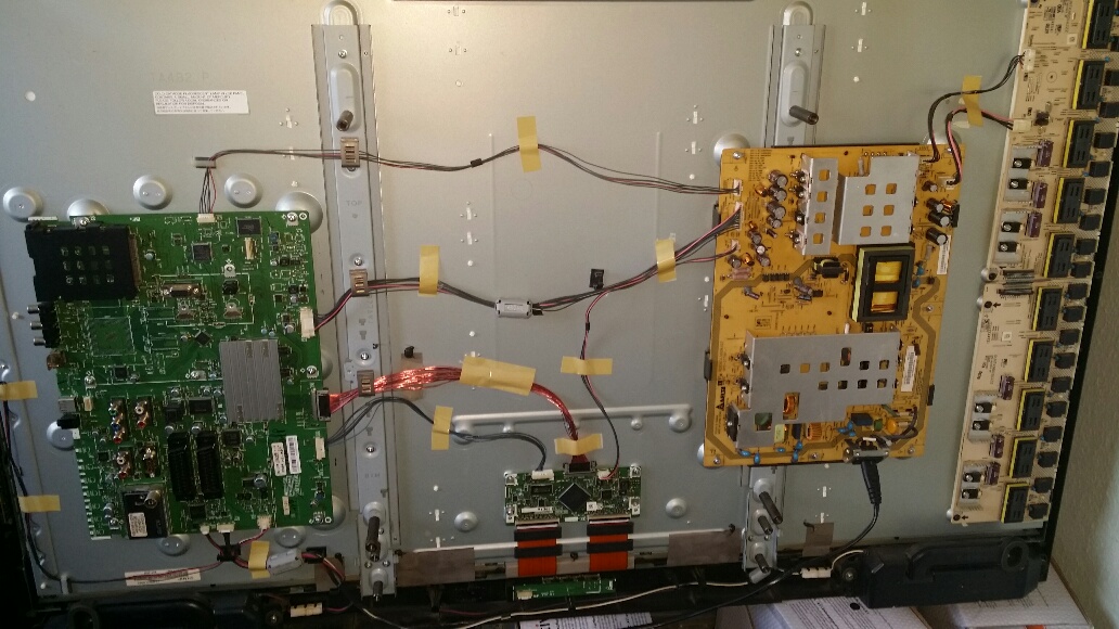

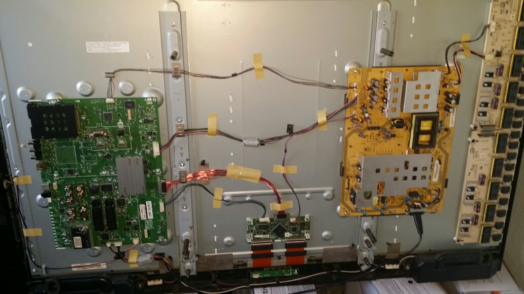

                                  Can I see the pictures of the whole back side of the TV so I can see the cables Tom is talking about?
                                  The service manual does not show how all the boards are connected together.

                                      Here is a couple of pictures of the complete rear of the set .
                                        #39
                                        Man! that is lots of cables to the T-CON.
                                          #40
                                          The smaller 4 pin one carries power to the T-con (Sharp do not use the LVDS cable for T-con power), the larger one carries some control signals, I believe related to gamma voltage programming as the gamma voltages can be adjusted from within the service menu on many Sharp TVs.
