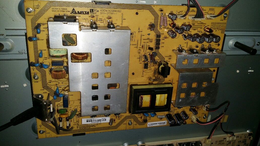

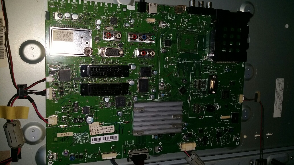

    Hi All
    Does any one have a list of the faults for blinking power led on these sets ?
    I picked up this TV today when plugged in and the power button is pressed the green standby light comes on then after a while it starts to blink red twice and just repeats doing this nothing else happens.
    I am including pictures of the power board and the main board with this post.

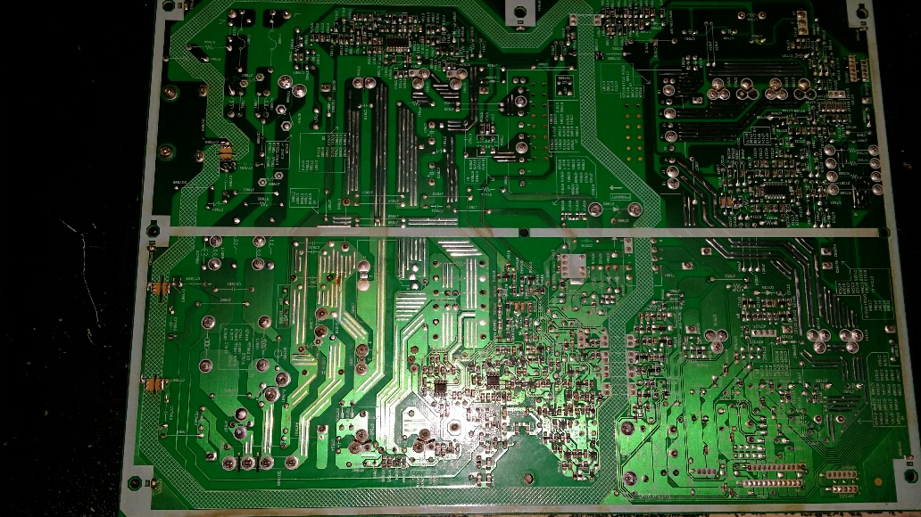

                I have now pulled the power board on this set and had a good look at solder joints on under side of board and could see quite a few that did not look to healthy so went about re-soldering them.
                I then reinstated the board and powered up the set, only to be greeted with the same fault ?
                Coming back to your other input that the inverter being short would i have still managed to get the back lights to power on if it was short?
                I am including some pictures with this post again of main board resized and a couple of the power board was wandering if you manage to have time could you please cast your eyes over it and see if you can see anything obvious ?

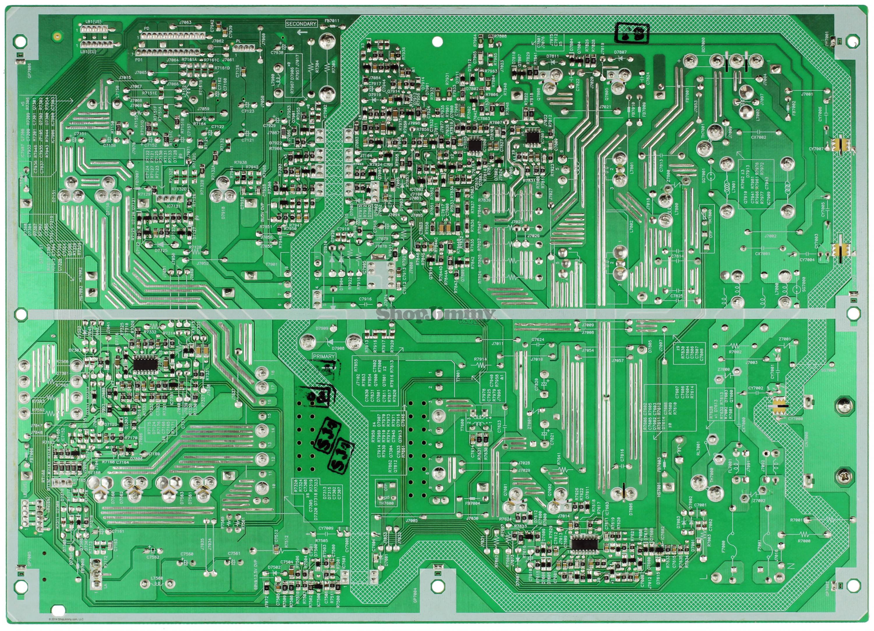

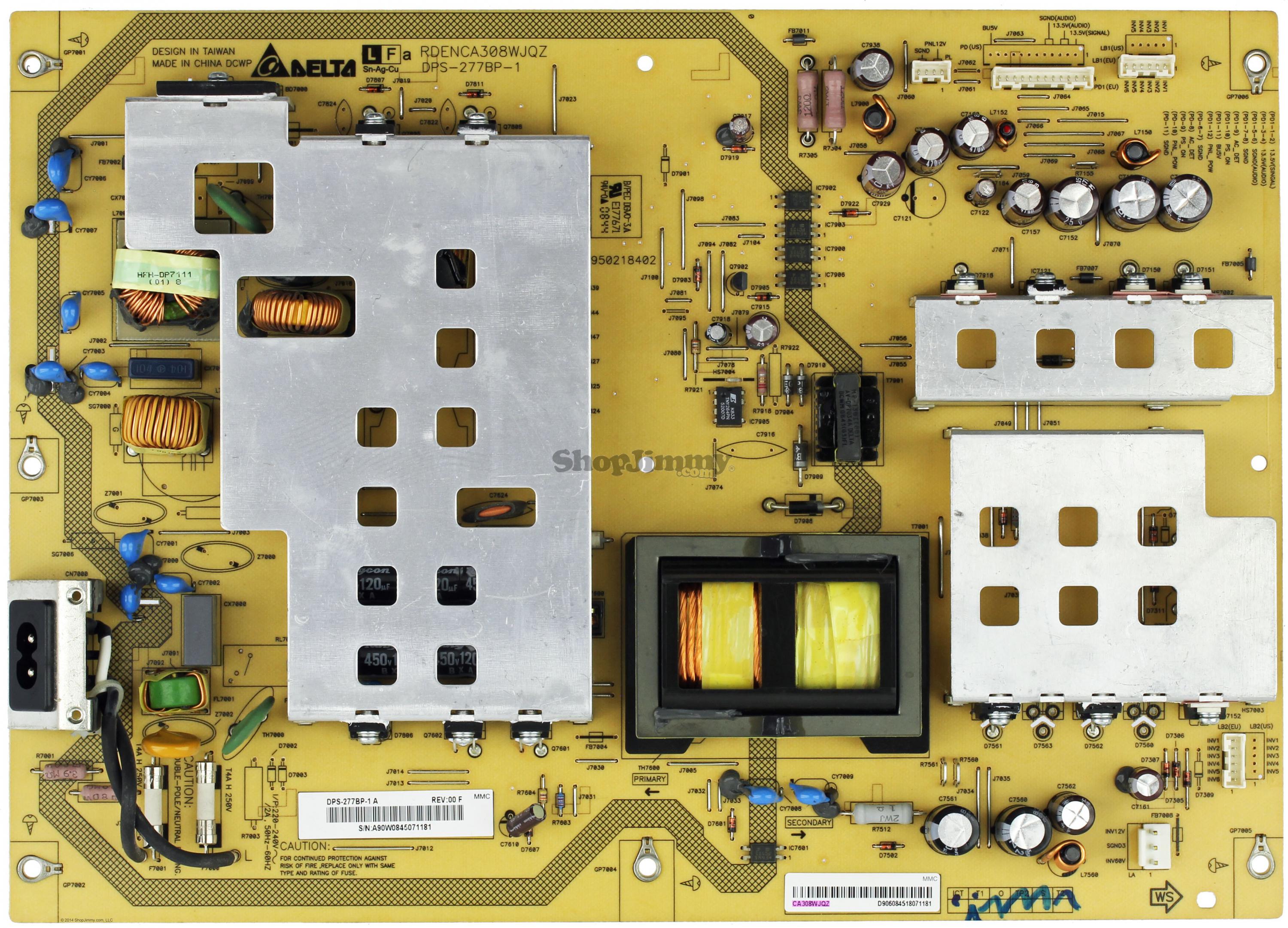

                    Re: SHARP LC-46D65E Dead power led blinking twice
                    Tell us what Voltages when TV is OFF and when POWER SWITCH is activated are missing on the power supply connectors.

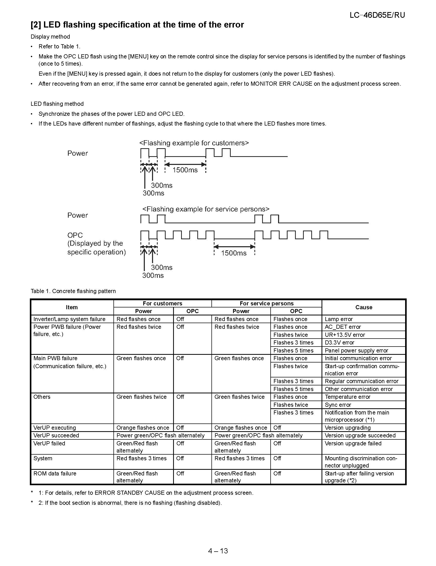

                          Reagrding to the OPC, it looks like you need to press MENU button on the remote:
                          [2] LED flashing specification at the time of the error
                          Display method
                          • Refer to Table 1.
                          • Make the OPC LED flash using the [MENU] key on the remote control since the display for service persons is identified by the number of flashings
                          (once to 5 times).
                          Even if the [MENU] key is pressed again, it does not return to the display for customers (only the power LED flashes).
                          • After recovering from an error, if the same error cannot be generated again, refer to MONITOR ERR CAUSE on the adjustment process screen.
                          LED flashing method
                          • Synchronize the phases of the power LED and OPC LED.
                          • If the LEDs have different number of flashings, adjust the flashing cycle to that where the LED flashes more times.
