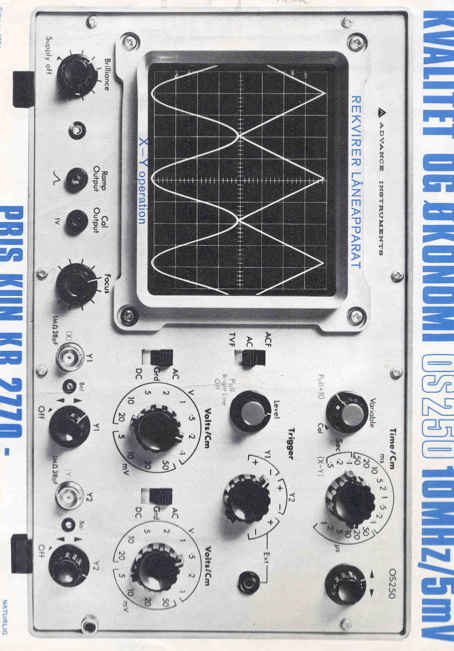

                                          Hi Tom
                                          I have placed a order for a T-CON board but it will take a few days to arrive.
                                          So in the mean time i decided to dig out my old Oscilloscope from the loft (well wrapped of course) believe me it has been up there for quite a few years now and would you believe it still works ! .It is a Gould Advance SO250A-TV duel channel, and with it is a probe
                                          PM8927 10m ohm //11pf 1.5 ns 10:1 500v max .
                                          Now looking at the main board in this set i can see some test points where i could check for signals just in front of the LVDS connecter ? But unfortunately the service manual that i downloaded (kindly supplied by budm) does not give any of this info regarding what state to have set in and what range to have the scope in i:e DC/AC volt range time range?
                                          I know this is a bit of a tall order but it has been a very long time since i used a scope as you can see from my profile i was out of the trade for a long time and was more used to CRT models and these LCD/PLASMA's are a new adventure for me but starting to really enjoy it now.
                                          If this is to much to ask not to worry but thank you for your time anyway.
                                          It would be nice to test for these signals for future reference ? I will try and add a picture from google what my scope looks like from the front.
