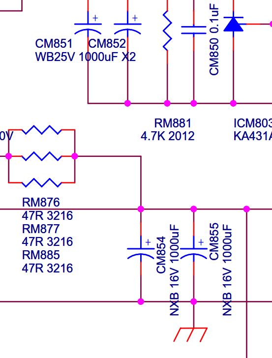

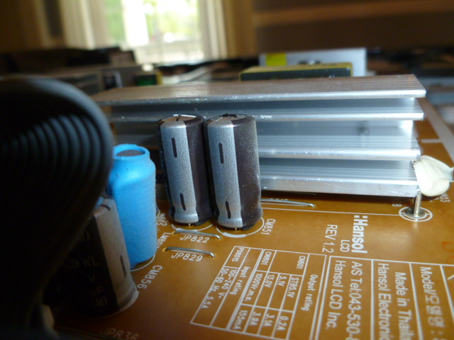

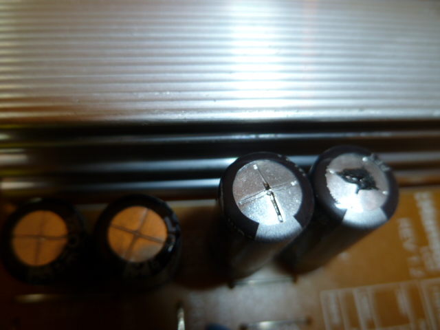

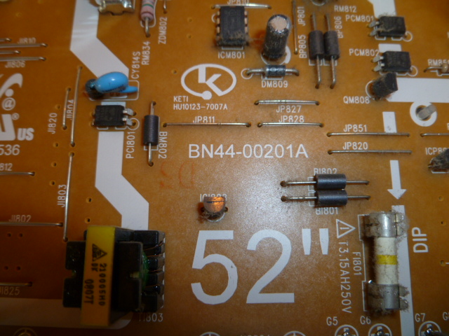

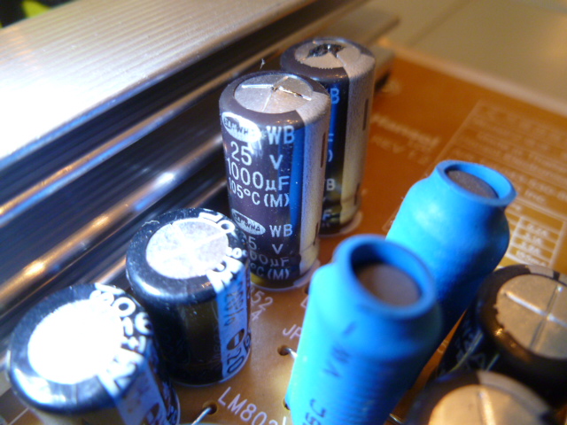

    Hello everyone - 1st post - I was hoping someone can help me with the closest spec of a Panasonic cap for the Samwah WB series on my board
    The TV model is LN52A650A1FXZA
    The power board with 2 bulging caps - BN44-00201A
    The 2 cap locations are CM851 and CM852 - both caps are identical
    The 2 caps are Samwah WB 1000uF 25V 105C Size 12.5x20 MM
    Pics are attached along with the WB series data sheet in PDF -
    I can use Digikey or Mouser
    Based on the reading I've done here I would like to go with Panasonic replacements I am not sure how to pick the closest specs in Panasonic (other than the obvious 1000uF and 25V) . If someone could assist me with that it would be greatly appreciated.

    Really any good brand low esr capacitor will do.
    Panasonic FR series are my usual replacement.
    I buy them form HM Comp on eBay, but don't know if they deliver in the U.S.
    Also I'd replace the caps next to the ones that have failed just for good measure.

                UCC KZE is an almost exact match. Same size, same ripple, slghtly lower ESR, and same 5000 hour endurance.
                http://www.digikey.com/product-detai...1681-ND/756197

                  ESR on FM and FR are lower than WB, but ripple is also lower. if you have room for 22mm height, 35v FR will work.
                  For some reason Digikey doesn't show ESR, just impedance, which is essentially the same.
