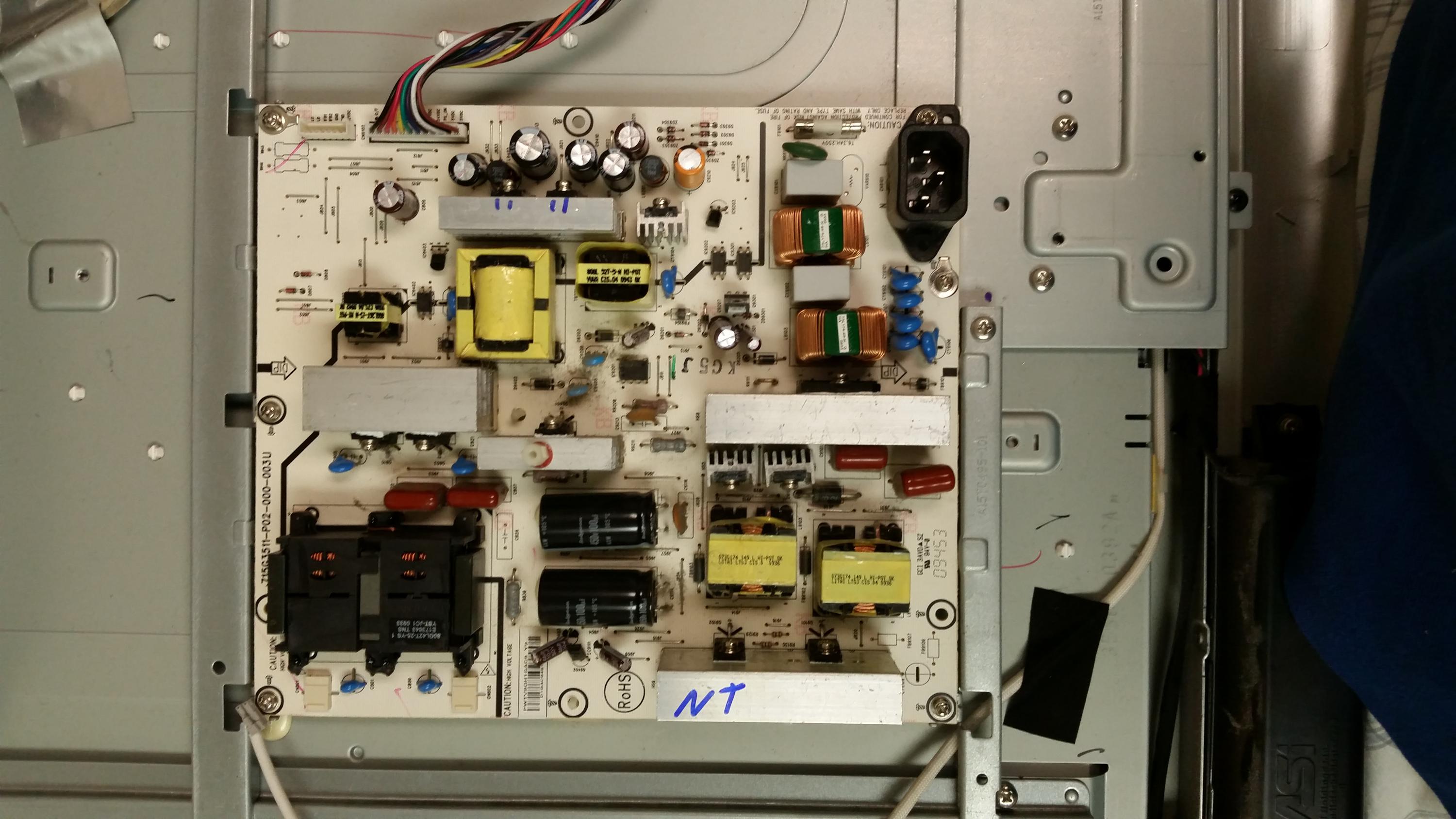

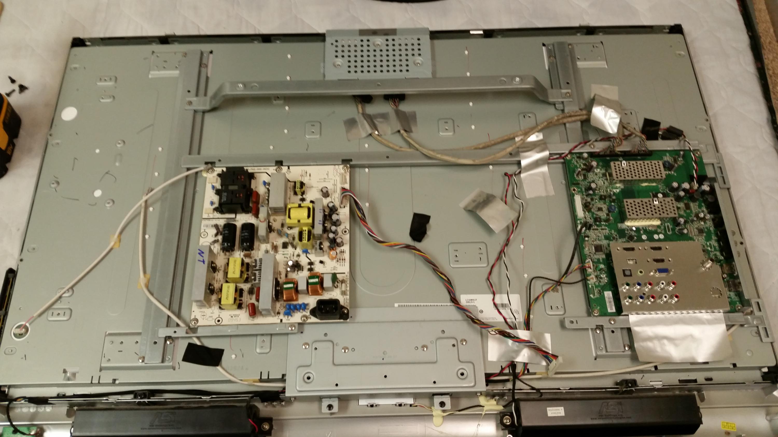

          Re: Vizio VT420M No backlight but seems to turn on
          Attached below are the pictures
            Is this the exact match of your power supply?
            http://www.shopjimmy.com/vizio-pwtv9...pply-unit.htm#
            The SJ pictures have wires in the way so I cannot read the label of each pin.
            Please provide good clear pictures so I can each pin name.
            • Nick's Tvs
              • Jan 2014
              • 621
              Here are additional pictures

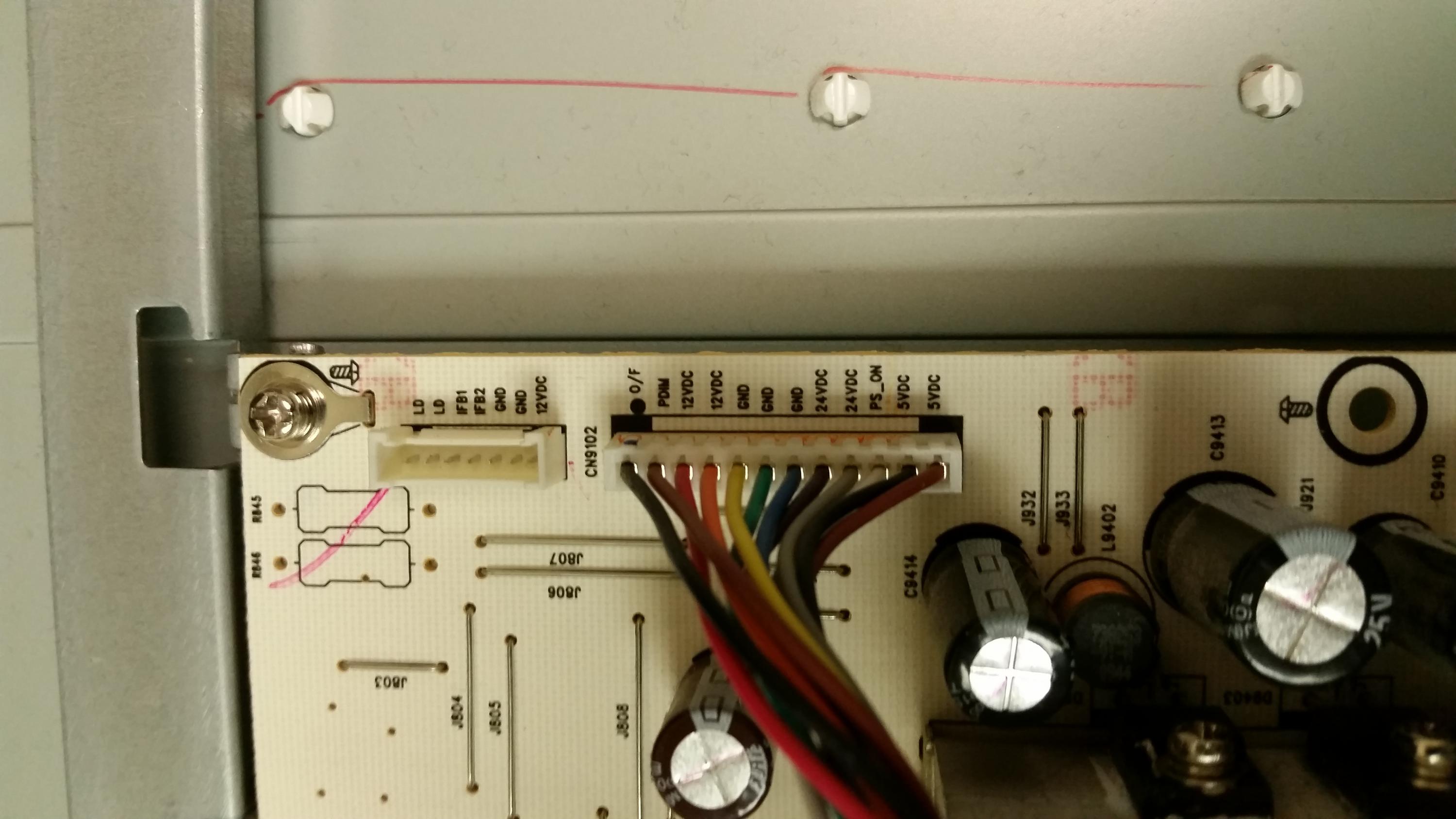

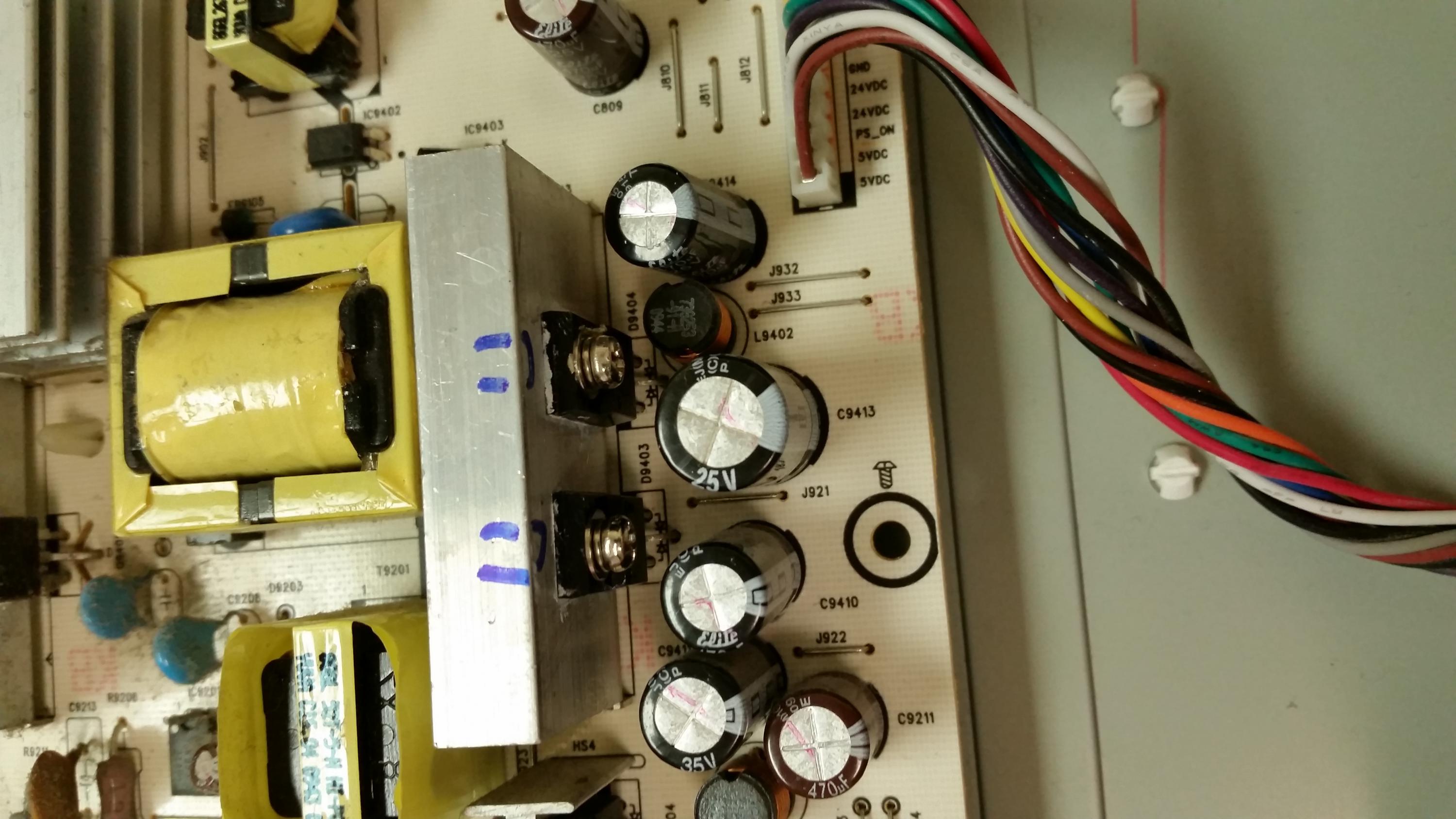

                The second set of pictures are of the connector going to the main, and of the diodes that are bad. They are the 2 that are screwed into the silver heat sink. I put 2 little blue pen marks above them.
                And yes the SJ power board you just linked previously is the same board that I have
                  Can you please give clarification to the two bad rectifiers? Are they shorted out?
                  They are Common Cathode dual rectifier that have two outer pins (Anodes) tied together to form 1 Diode (parallel Diodes).
                  • Nick's Tvs
                    • Jan 2014
                    • 621
                    Ok so this is how they are set up.
                    The middle pin is pushed forward and the outside pins are sitting back straight down from the rectifier. The middle pin that is pushed forward is the Cathode, and the outer pins are both anode. -->!-!<-- is as close as I can get with a computer keyboard to mimic the symbol on the circuit board. And actually if you look closely on the picture of the rectifiers, you can actually see the symbol.
                    On the both rectifiers, I believe both of the anode pins are shorted together.
                    Now what I am getting that is strange is that when I put my black lead on cathode and red on anode, I am getting 0.210V on the DMM and when I switch my leads to black lead on anode and red lead on cathode, I am still getting the same exact reading of 0.210V when normally I think I should be getting OL. This is for the D9404 rectifier.
                    Now on the D9403 rectifier, I am getting 0.276V when I have black on cathode and red on anode, and I am getting .590v with red on cathode and black on anode. I believe I should be getting an OL on one of those no??
                      There are bleeder resistors in the circuits.
                      So are you getting 12VDC and 24VDC at the connector CN9102?
                      If you look at the bottom side of the board, you will see lots of bleeder resistors.
                      If the Diode is shorted, then it should show <1 Ohms when test them in Ohm mode.
                      The 12Vdc and the 24Vdc, and the PFC Voltage booster are turned on by the PS-ON signal from the main board.
                      Post 1 "Using a DMM I got perfect voltages for all pins going to the main." Then that cannot be true if those two diodes are shorted.
                        Please give me the DCV readings of each pin of CN9102 with the name of each pin and the Voltage reading when TV is OFF and when TV is ON.
                        For example:
                        O/F TV OFF = xxx V, TV ON = xxx V
                        PDM TV OFF = xXX V, TV ON = xxx V
                        I need to see the readings to verify the function of the main board.
                                Ok, so I made a big mistake, I have been working on 2 different Vizio tvs with the exact same symptoms, but one is a 32 inch. I may have crossed over some of my data from that 32 inch onto the 42 inch we are currently discussing.
                                All the info I did write on the previous post is correct, except for the voltages that I took of the connector.
                                So I am getting with tv off:
                                5v from 5vdc
                                0v from PS_ON
                                0v from 24vdc
                                0v from 12vdc
                                70 Millivolts from PDIM
                                0 from ON/off
                                I am getting with tv turned on:
                                5.17v from 5vdc
                                5.05v from PS_ON
                                0V from 24 vdc
                                1.1v from 12vdc
                                and I wrote it down somewhere at the shop but I am getting I think 3.3 from PDIM or on/off not sure. I wrote it down when at my work station, but i can't find the paper and I don't have the tv in front of me right now.
                                But regardless of those last 2 voltages, I think I am fairly confident that we have a bad power supply now and that indeed the spare one that was sent to me was also bad.
                                • Nick's Tvs
                                  • Jan 2014
                                  • 621
                                  Also I made a mistake earlier in my post I stated I took out the resistors from the board, but I actually meant to say I took out the diode / rectifier. Not sure why I said resistors. That is my bad.
                                    So you do not have 12V or 24V after all, but I thought you do have all the Voltages as posted in post 1.
                                    OK, the ps-on is present but no 12V or 24V which both them comes from the same circuit and same power transformer and this circuit requires boosted Voltage from the PFC Voltage booster to run, same for the inverter circuit.
                                    So you need to find out if you do have >360VDC between the two legs of main filter caps or not.
                                    So you get the new power supply board for $29 or try to fix it.
