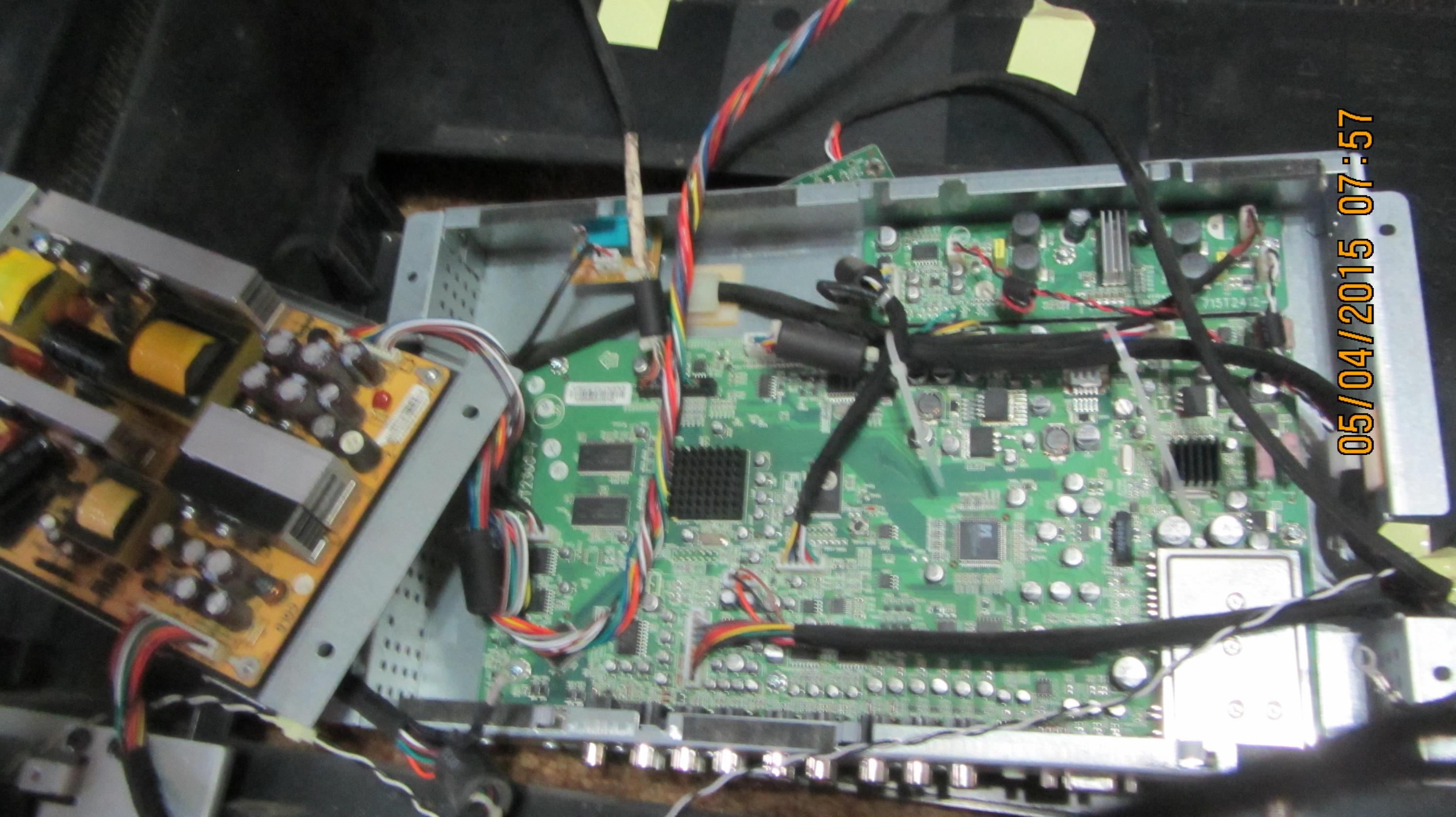

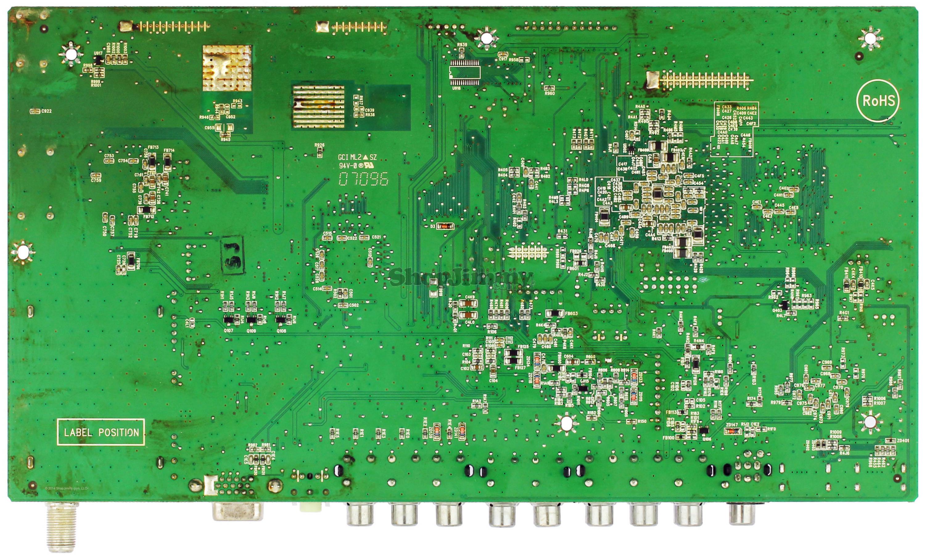

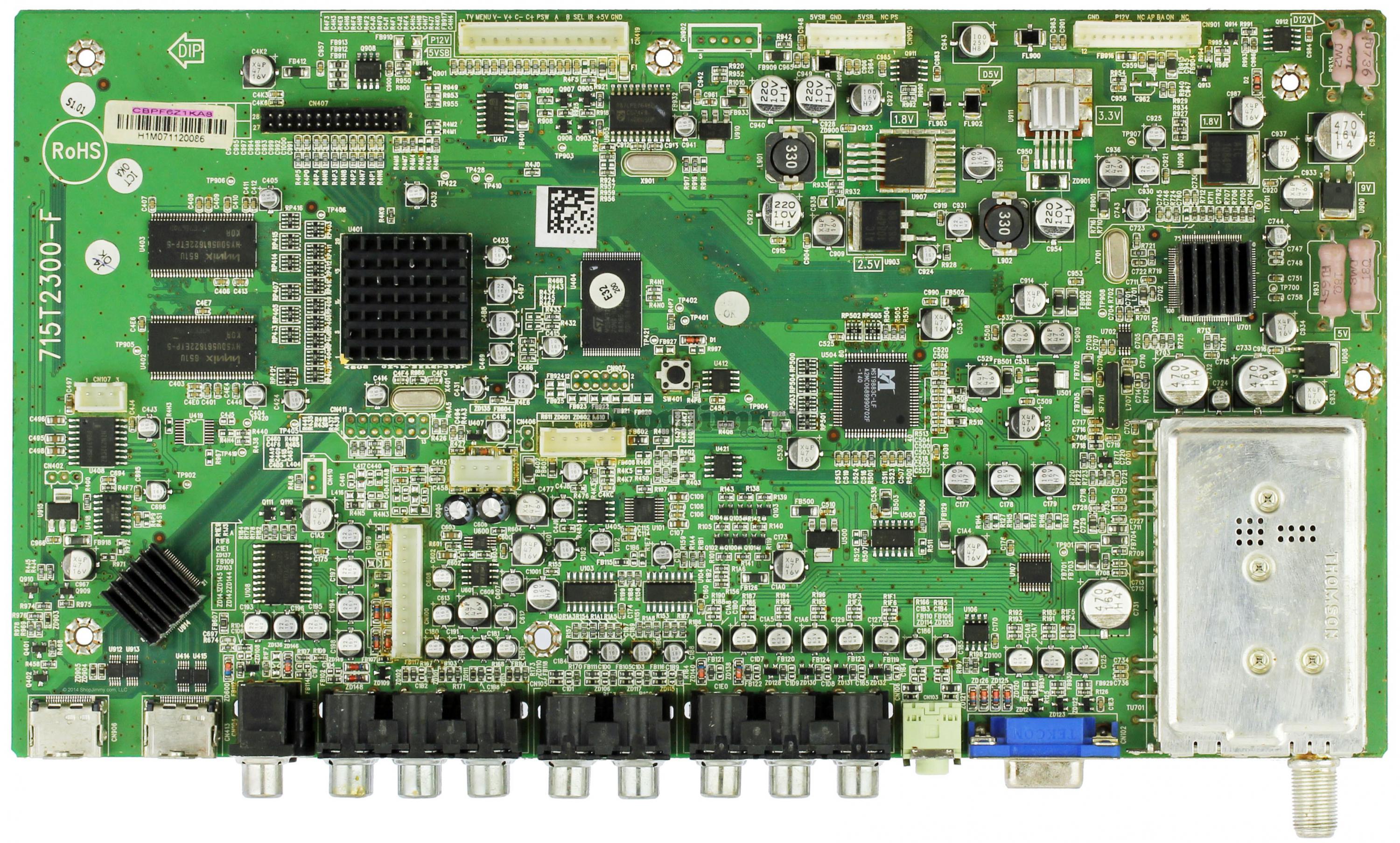

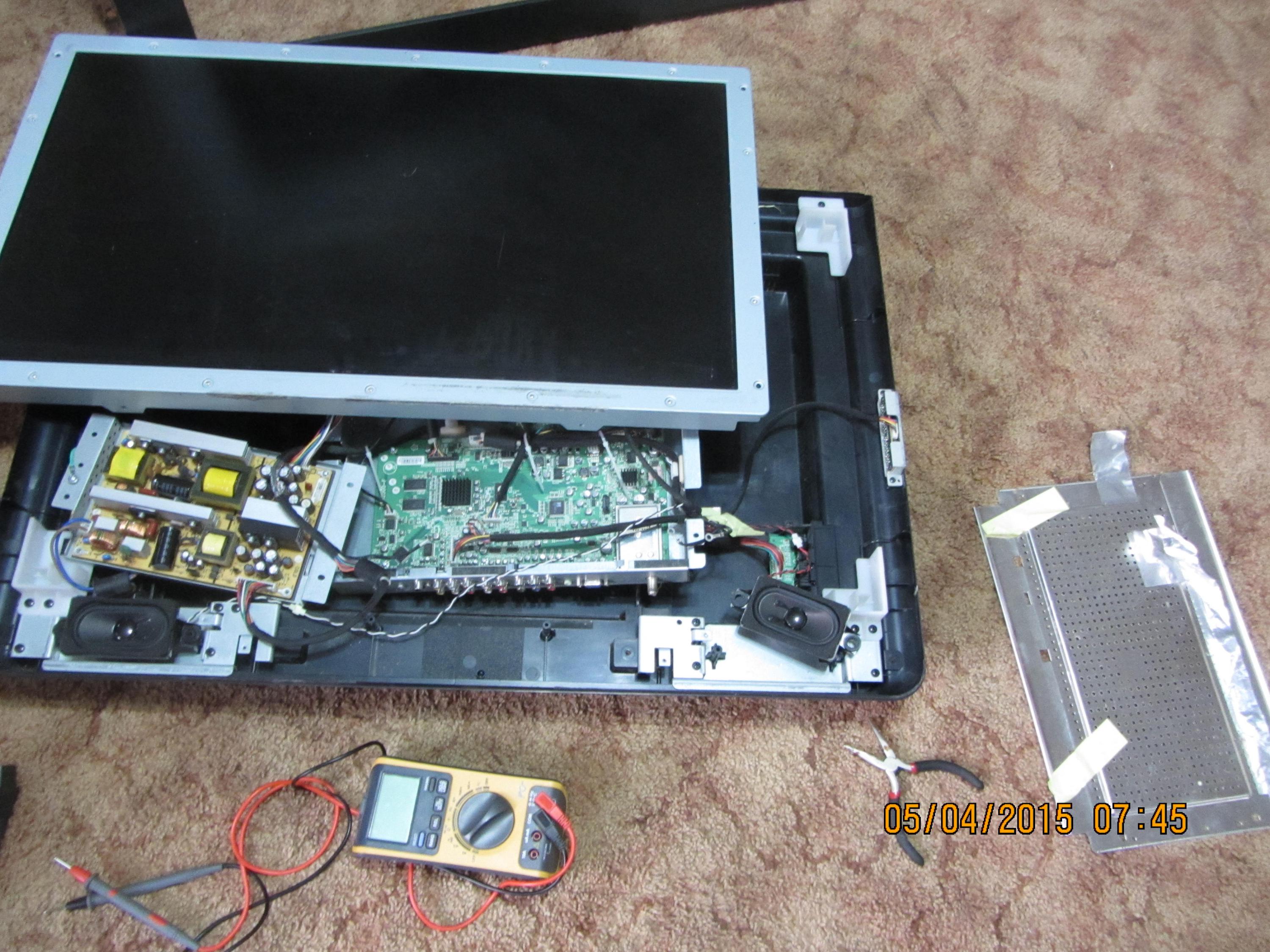

              Mainboard These readings are with everything connected the TV the inverter the Tcon the Mainboard the switches the audio board and so on.
              12 is 12.4
              5 is 5.25
              PSW pin on main video board goes from 5v to 3v
              The filter cap on SMPS the cold side is 162.5v
              The filter cap SMPS on the hot side is 160.2v
              ON which is located on video main board connector goes from .4 when off to 4.5v when on.
              PS which is located on video main board yet another connecter goes from .4 when off to 4.8v when on.
              ON/OFF on the SMPS that goes to the TCON this is the only other label close to what you ask. .4 when switched off 3.2 when switched on.
              Have a few TV boards lying around to do some parts robbery if need be willing to try any angle.
              But nothing is labeled specifically PSON on the main board just as the above mentioned.
              So from what is being said the Power Factor Correction Circuit is not working correctly what exactly is this comprised of and would this be considered active or non active and what makes it that way?
              REASON FOR EDIT:
              Uploading Pics of mainboard had to use shop jimmy camera battery is dead running on steam thanks!
              Please note: I am not responsible for any harm caused to you anything discussed is just discussion. Before you try anything discussed be sure that you have the appropriate knowledge and safety gear for the job. Like with anything education and safety are first! Do not try anything @ home without it.

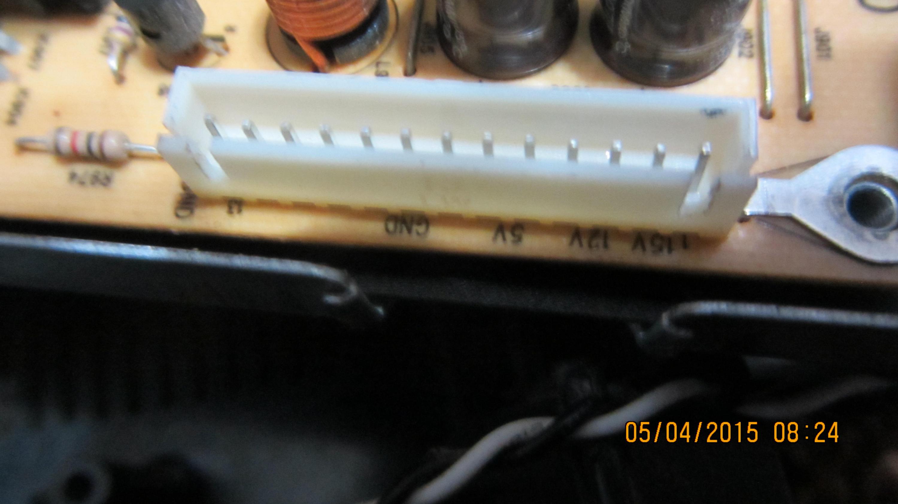

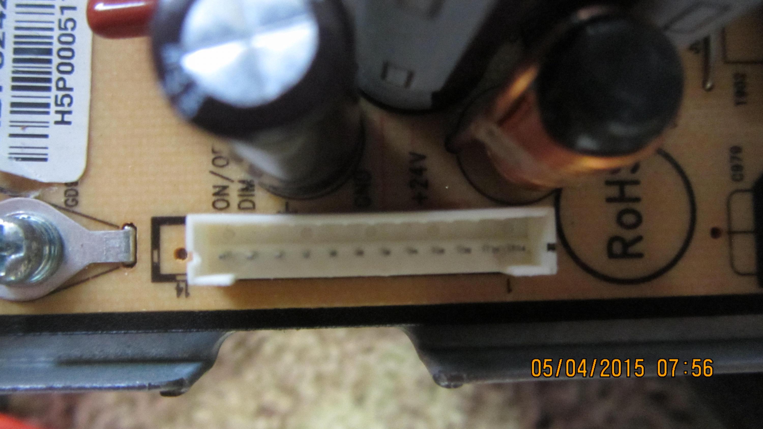

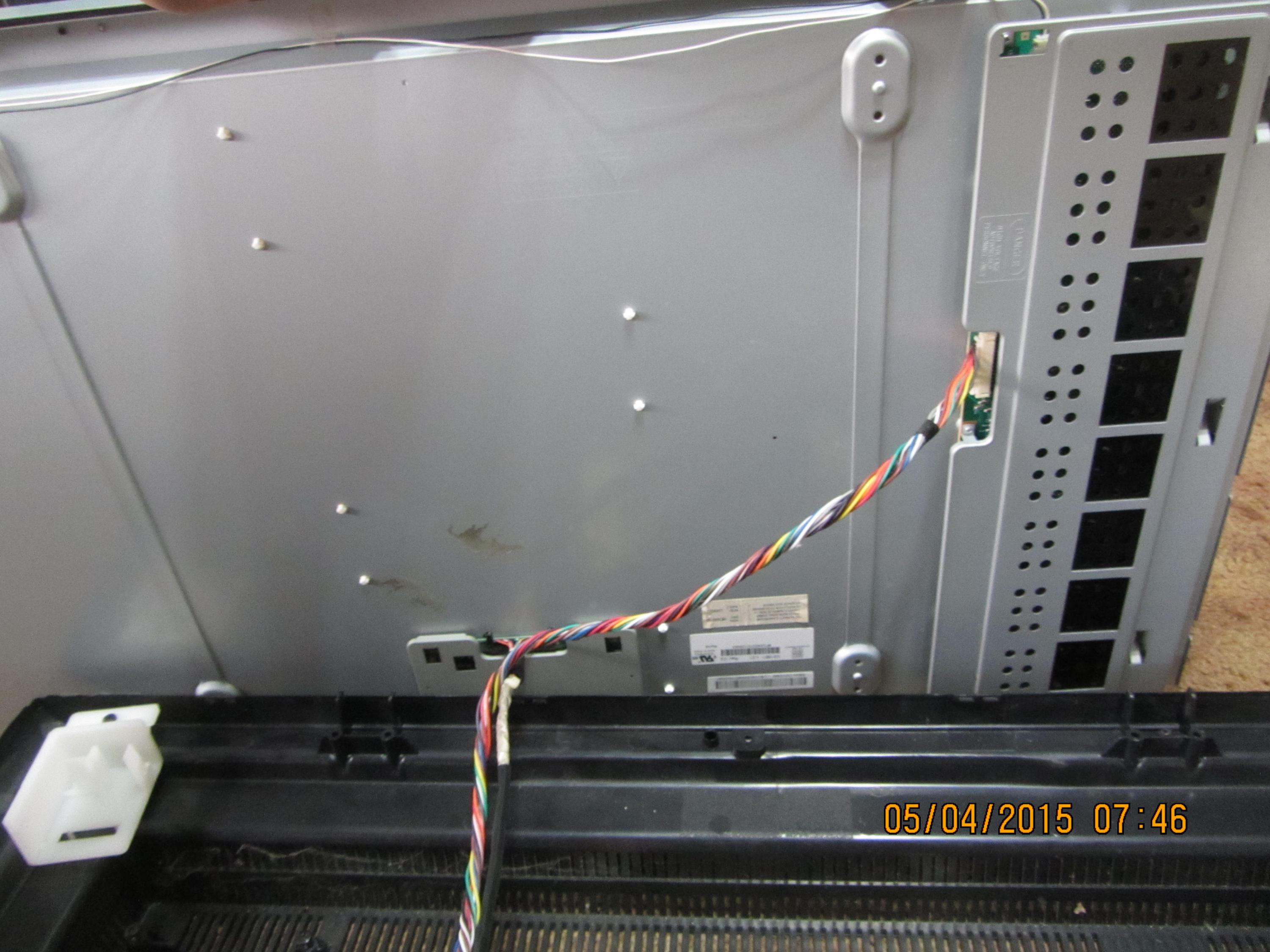

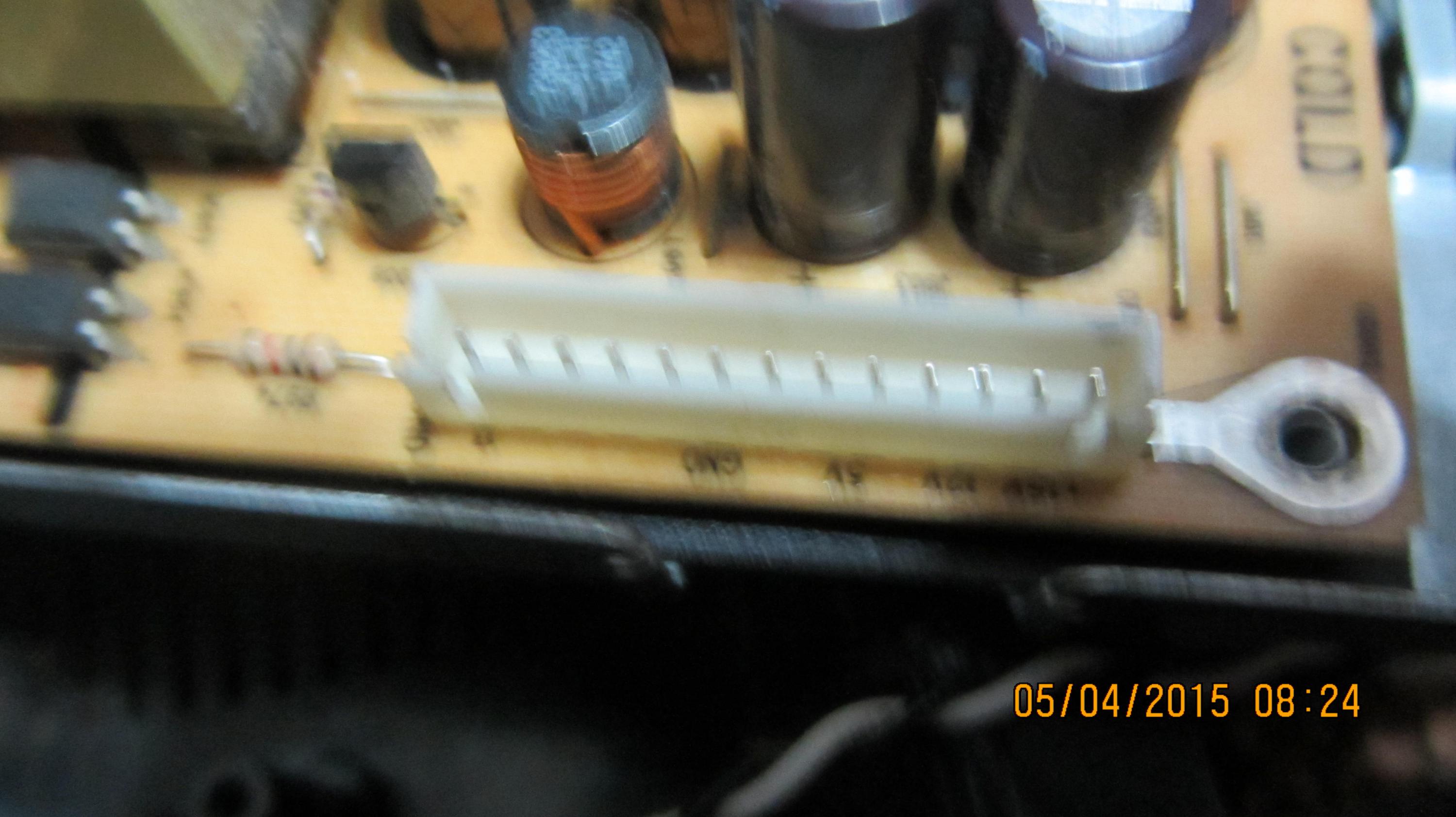

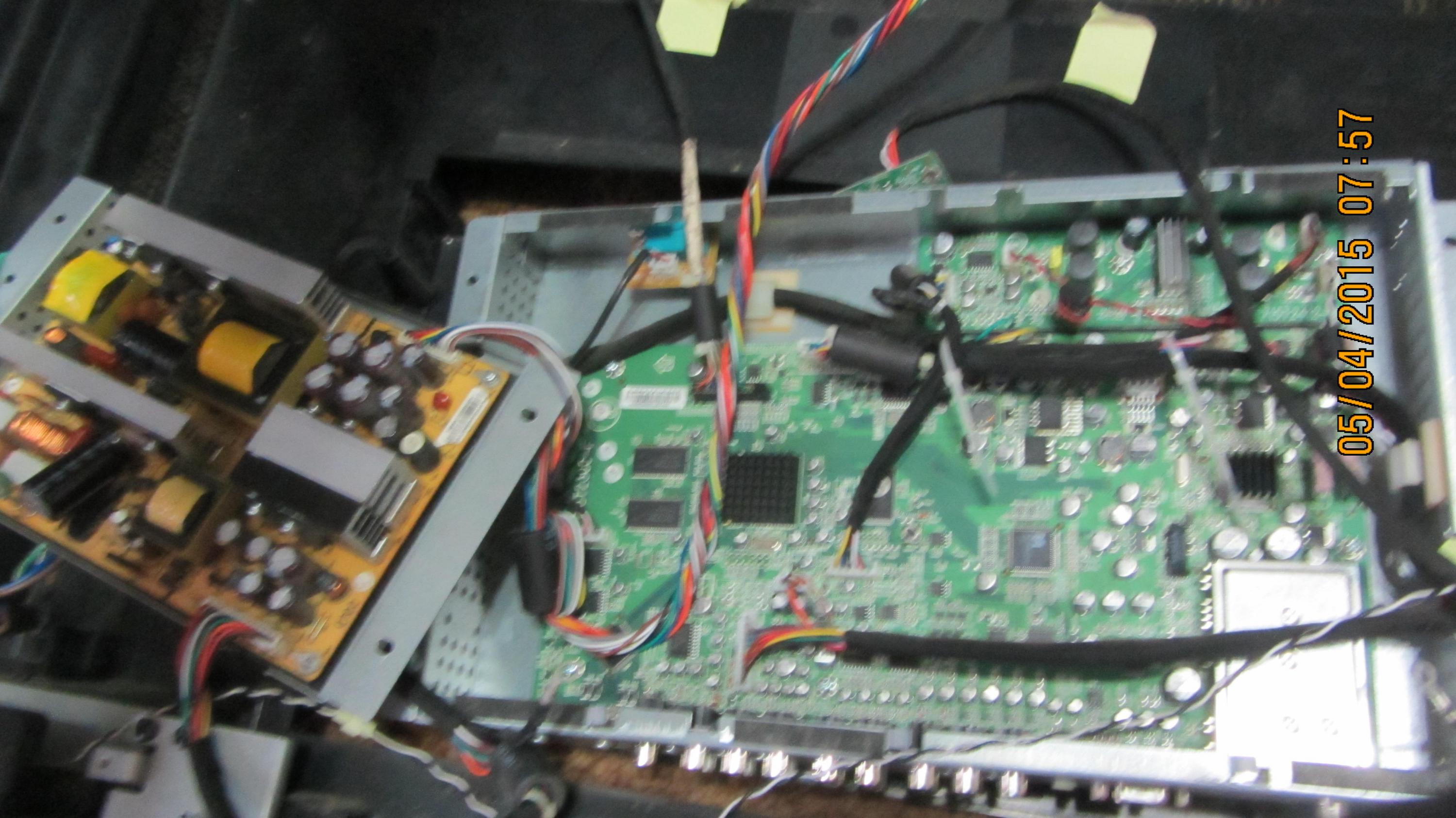

                    Re: RCA L32WD22 No 15v No 24v no backlight

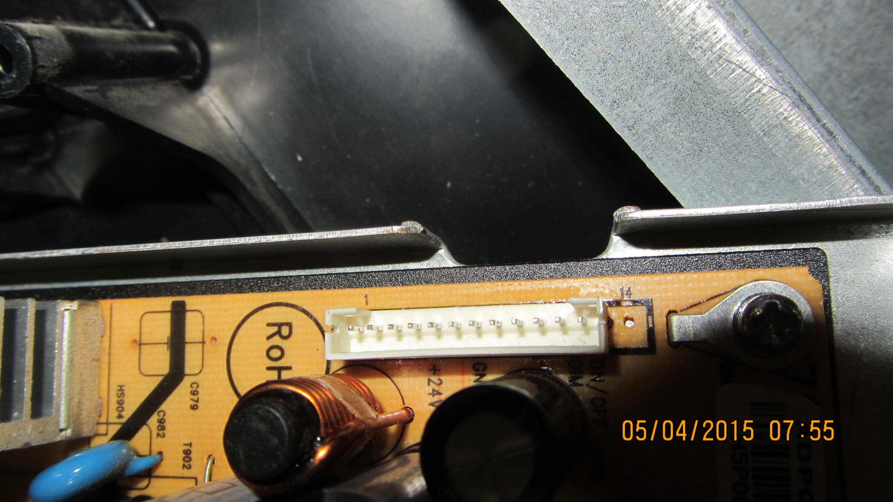

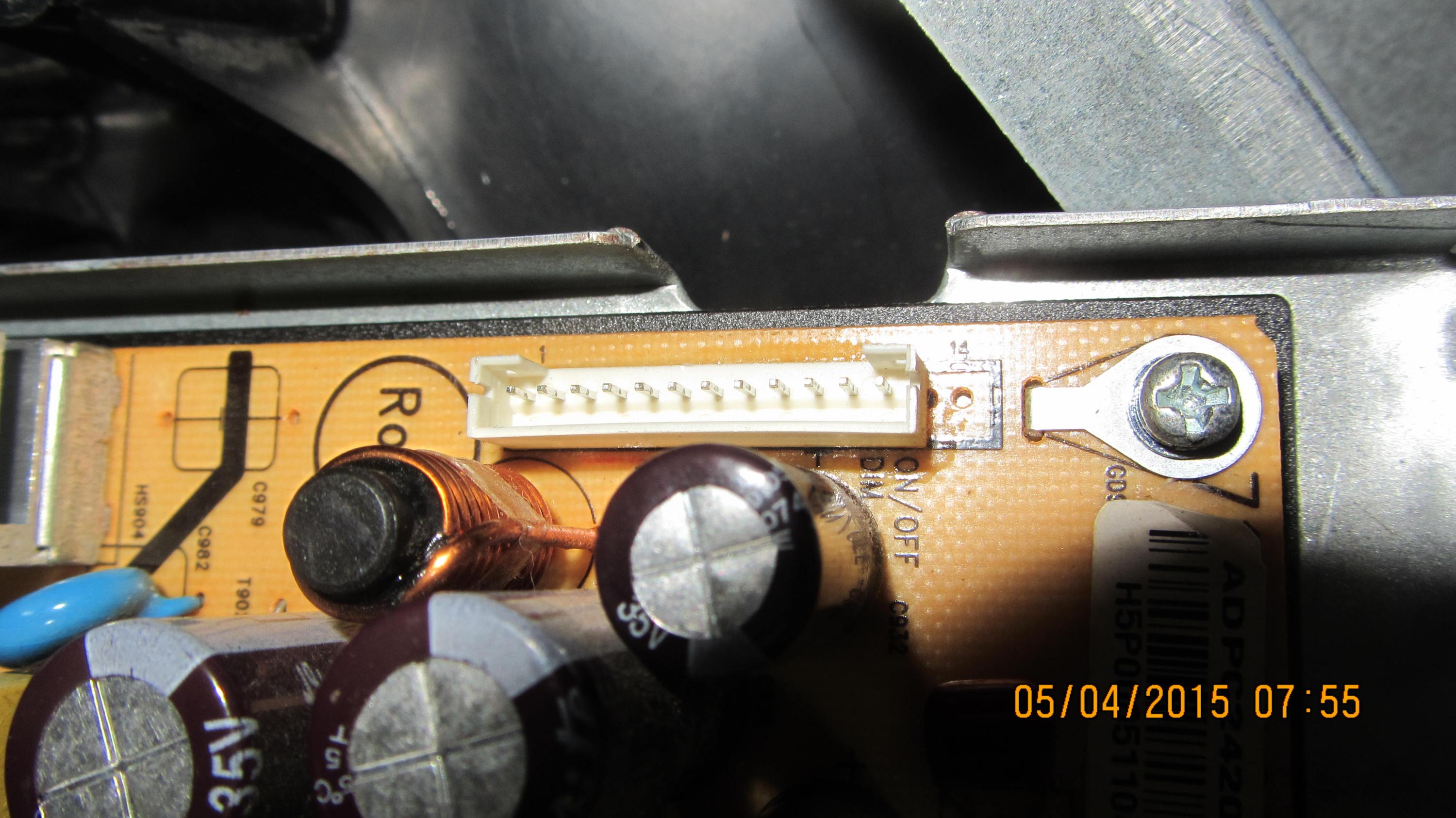

                    Can we see the whole back side of the TV? The ON/OFF pin is for the Inverter ON/OFF.
                    Also give the list of the pin names for those two connectors of the power supply board.
                    • infringer
                      Badcaps Member
                      • Sep 2009
                      • 244
                      • United Frickin States

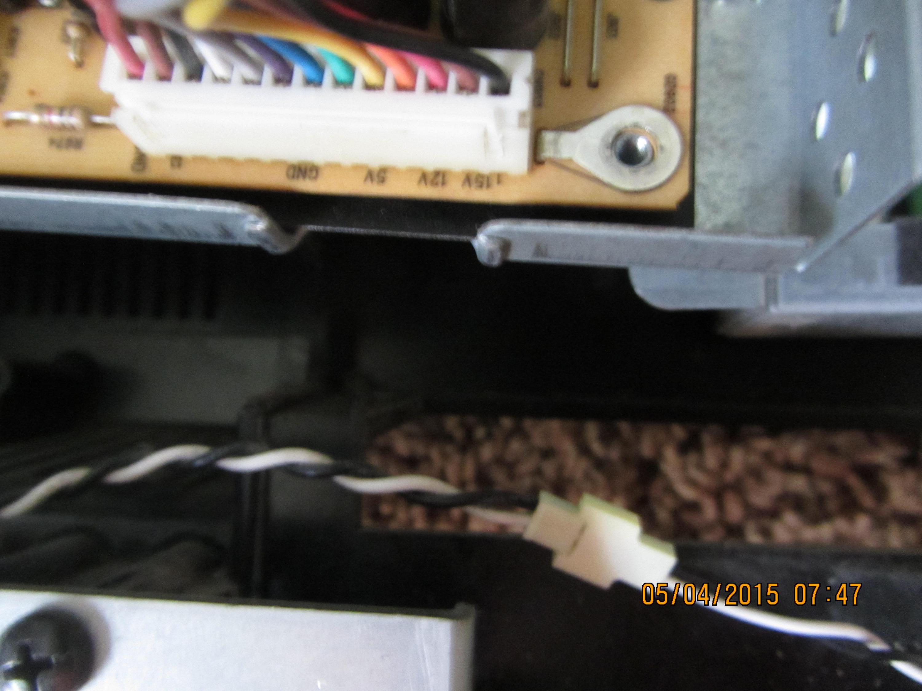

                      Andrew F Ali,
                      Caps are labeled fairly well to tell the difference between negative and positive legs and often they are labeled well on the board as well and yes my leads are hooked into the correct ports unless there is something other I am not aware of the nice strip down the sides of the caps indicate the negative lead fairly well odd that you say that though the cap I had put on I almost put on backwards like a dummy heh good thing I like to check things twice before soldering them in so I had to reverse the bends on the legs.
                      newtothis,
                      As BudM stated yes it is to the inverter not the TCON sorry for the mixup on that one just called it the wrong thing for whatever reason can't explain it to be honest but it does not hook to the TCON it hooks to the inverter board assembly.
                      BudM,
                      Code:
                      1
                      2
                      3
                      4
                      5 +24v
                      6
                      7
                      8
                      9
                      10
                      11 DIM
                      12 ON/OFF
                      13 NC
                      14 NC
                      Code:
                      1
                      2 15v
                      3 12v
                      4
                      5 5v
                      6
                      7
                      8 GND
                      9
                      10
                      11
                      12
                      13 GND
                      Yes correct inverter not TCON sorry for the mix up...
                      I will note when checking for voltages I checked the pins next to what I thought was labeled 15 to the left and to the right just to be certain.
                      Same for the rest of the connections.
                      There were voltage readings on some of those pins not labled as well but a good instance is 12v had another 12v by it and 5v had another 5v by it and so on.
                      I suppose the connection to the cfl's under the heatshrink could be bad but it seemed like it was connected well when looking and tugging so I didn't check when I had the entire screen disassembled to check the cfl tubes for burns breaks and so on. But I doubt it the problem here is we get nothing off the power board so this is where the issue likely lies...
                      Hope this helps BudM
                      Sorry for the mess of wires had the thing all back together in a pile to test.
                      NOTE added a service manual I found online dunno how accurate it is for my particular model.

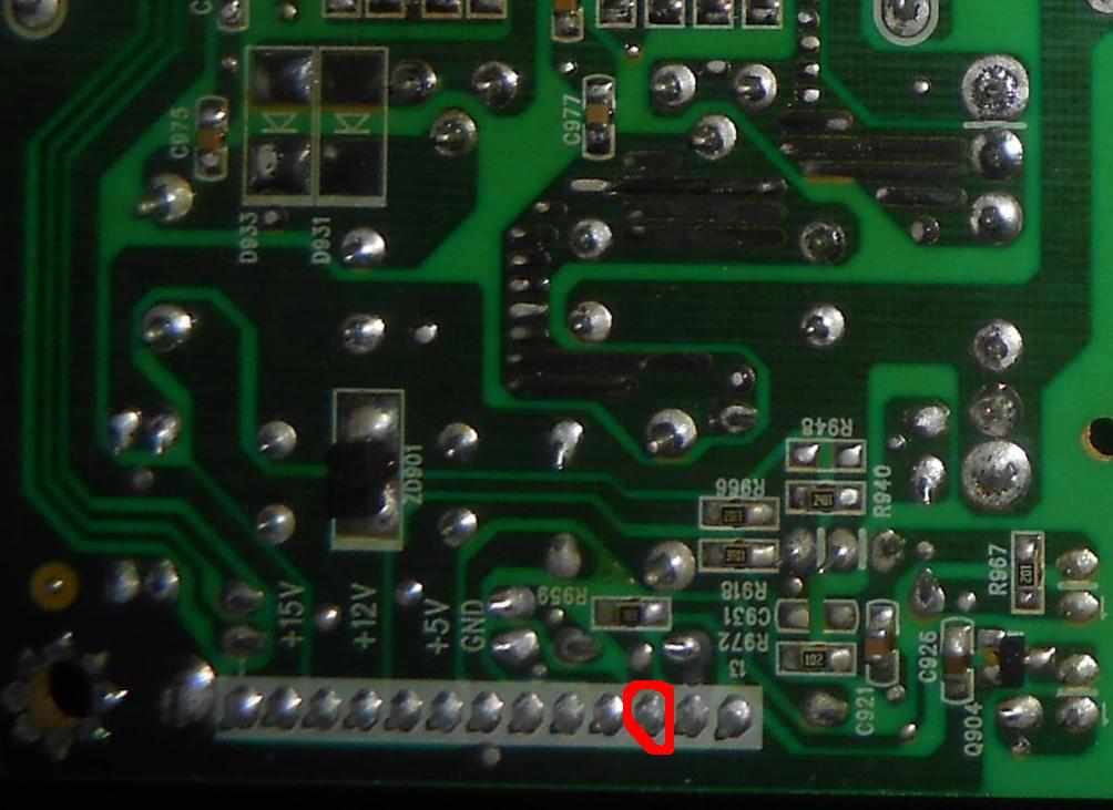

                        PS-ON is pin 11, so if what you show is correct (0V) then the main board is not sending the PS-ON signal.
                            getting 4v when the power is switched on on pin 11
                            getting 3.2v when the power is switched on on pin 12
                            (when I press the power button.)

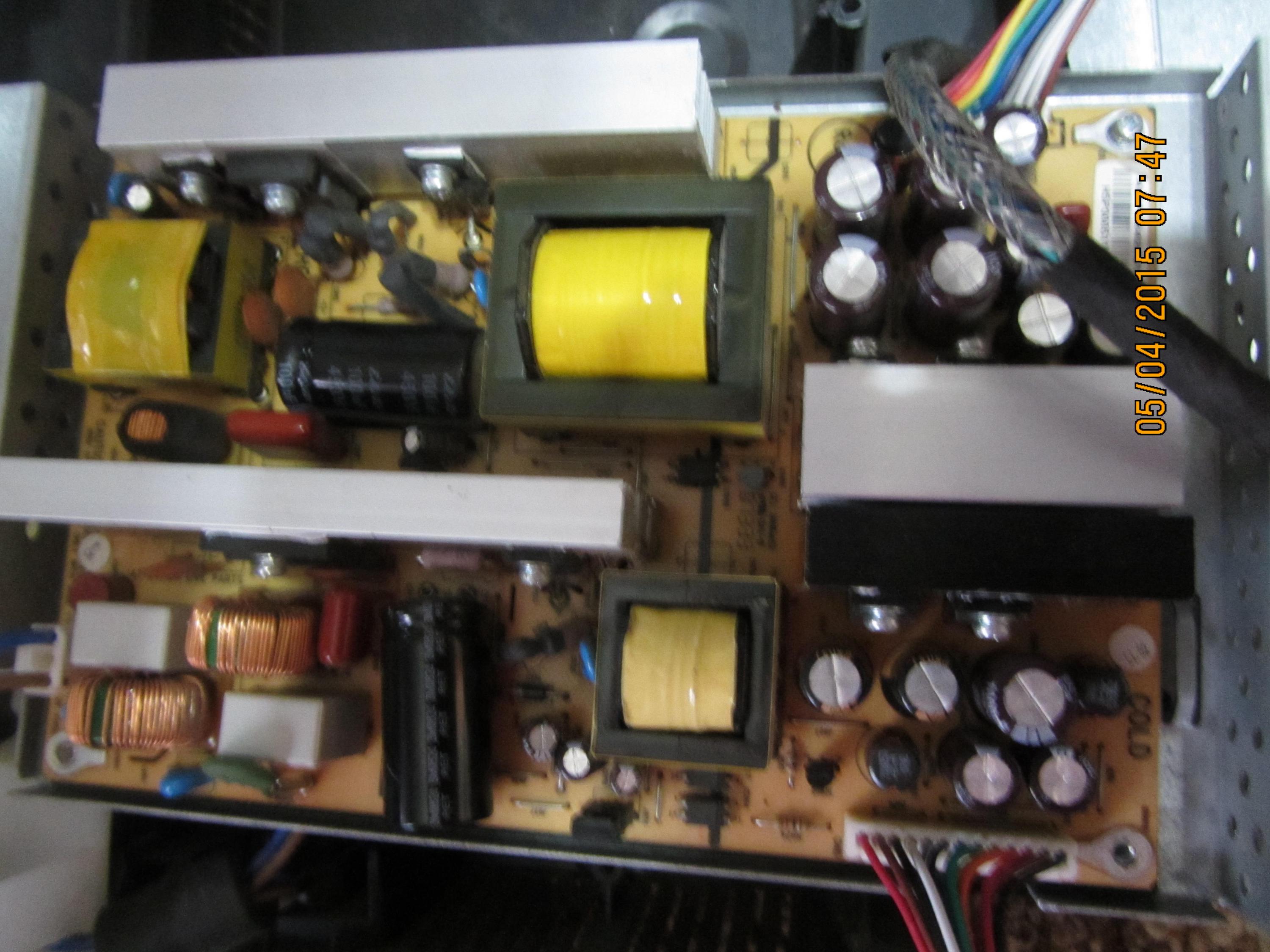

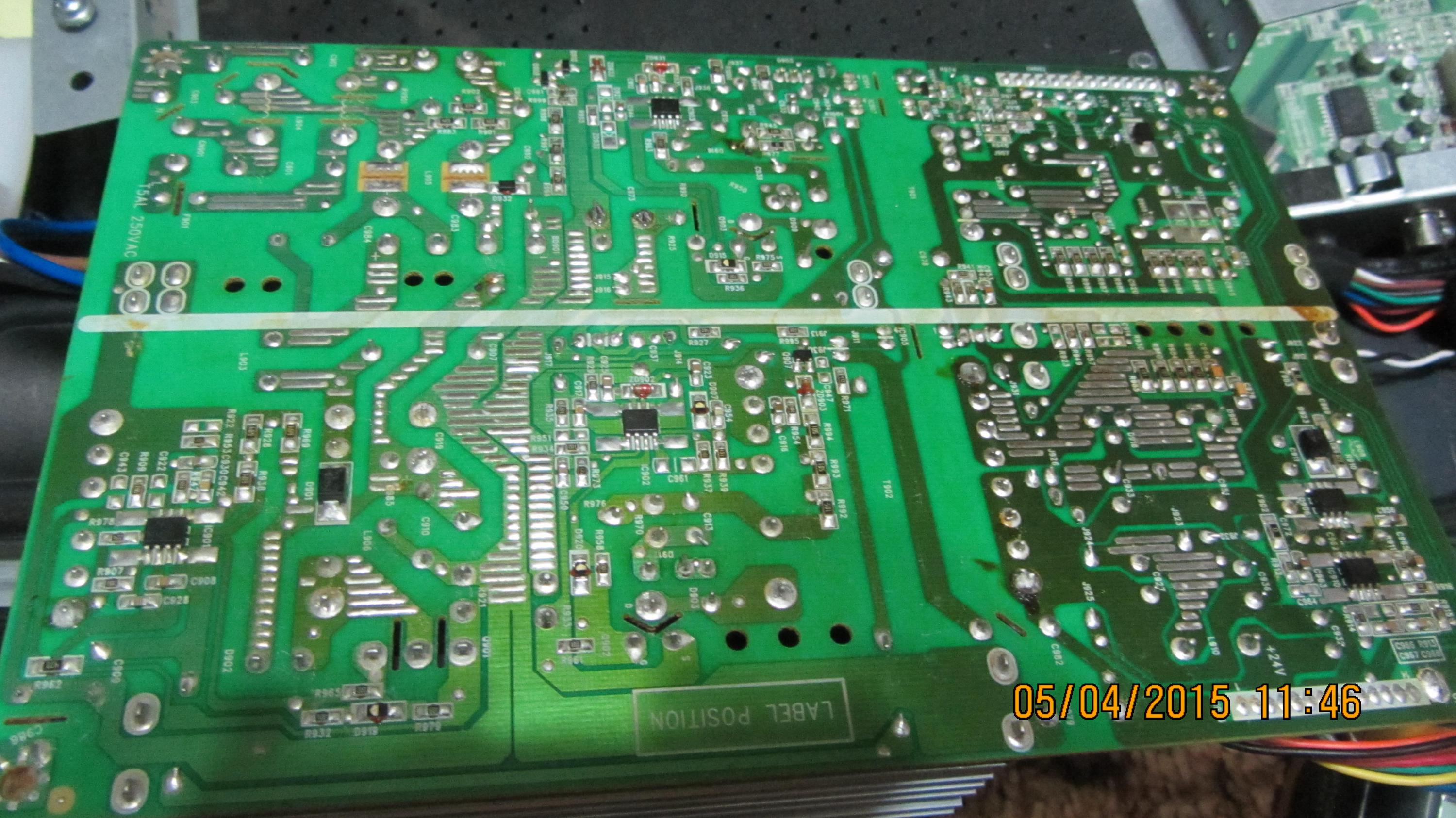

                              If you do have PS-ON at pin 11, then you should have the PFC boosted Voltage on the main filter cap, if it stays at 160VDC then you need to troubleshoot the PFC section next.
                              You need to get the pinout of the PFC controller IC to see if it is getting the VCC Voltage to run.
                              • infringer
                                Badcaps Member
                                • Sep 2009
                                • 244

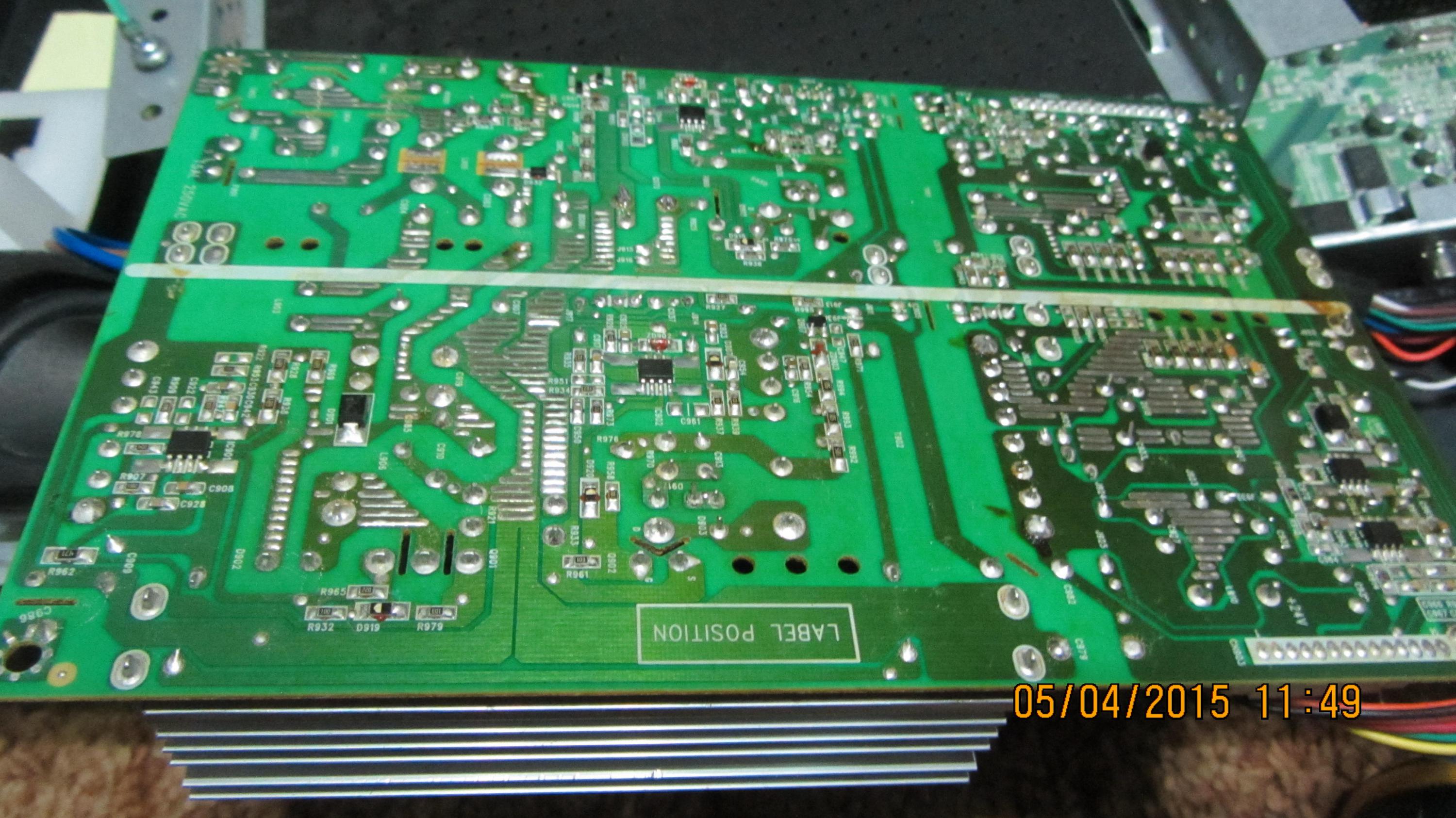

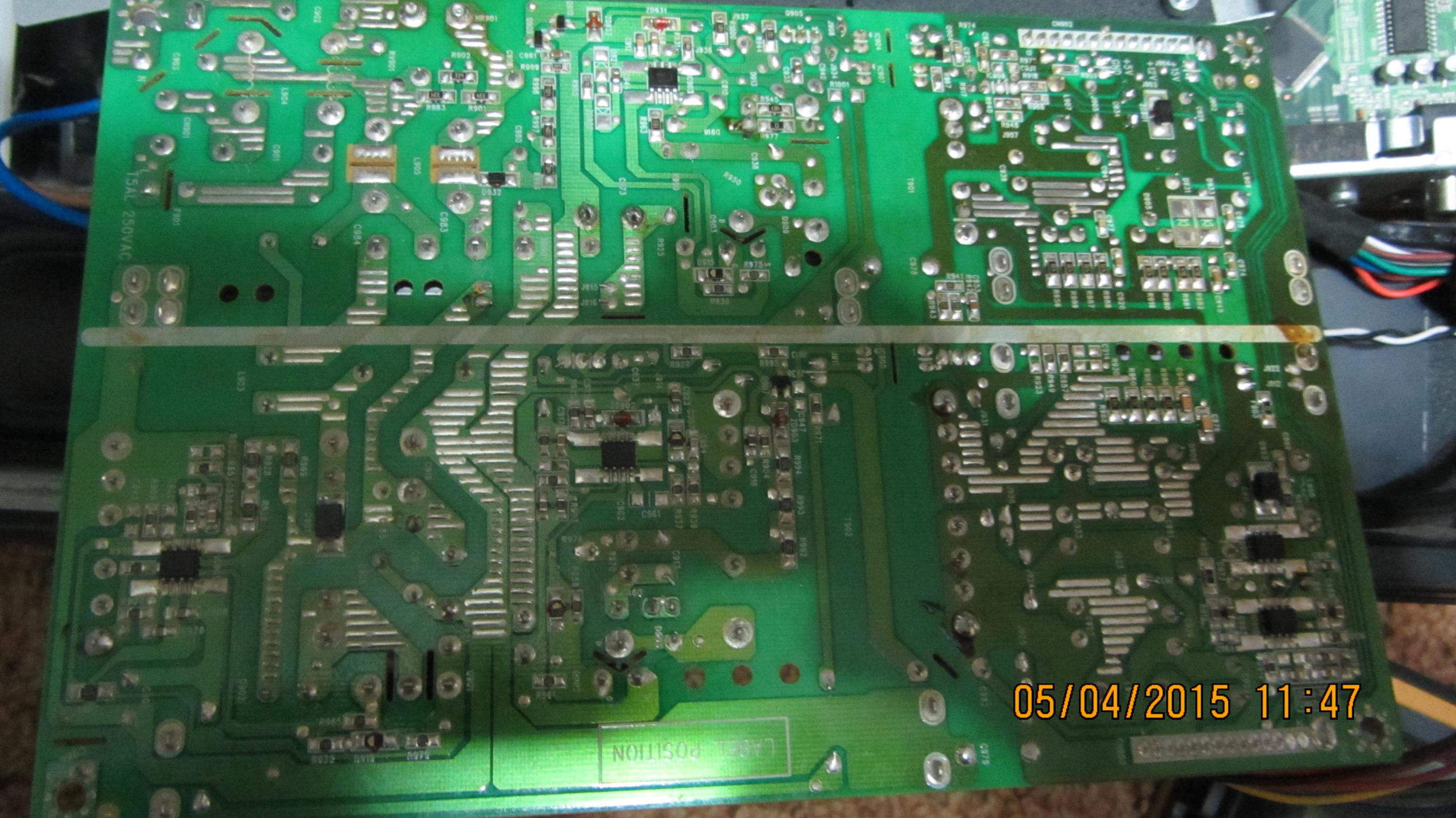

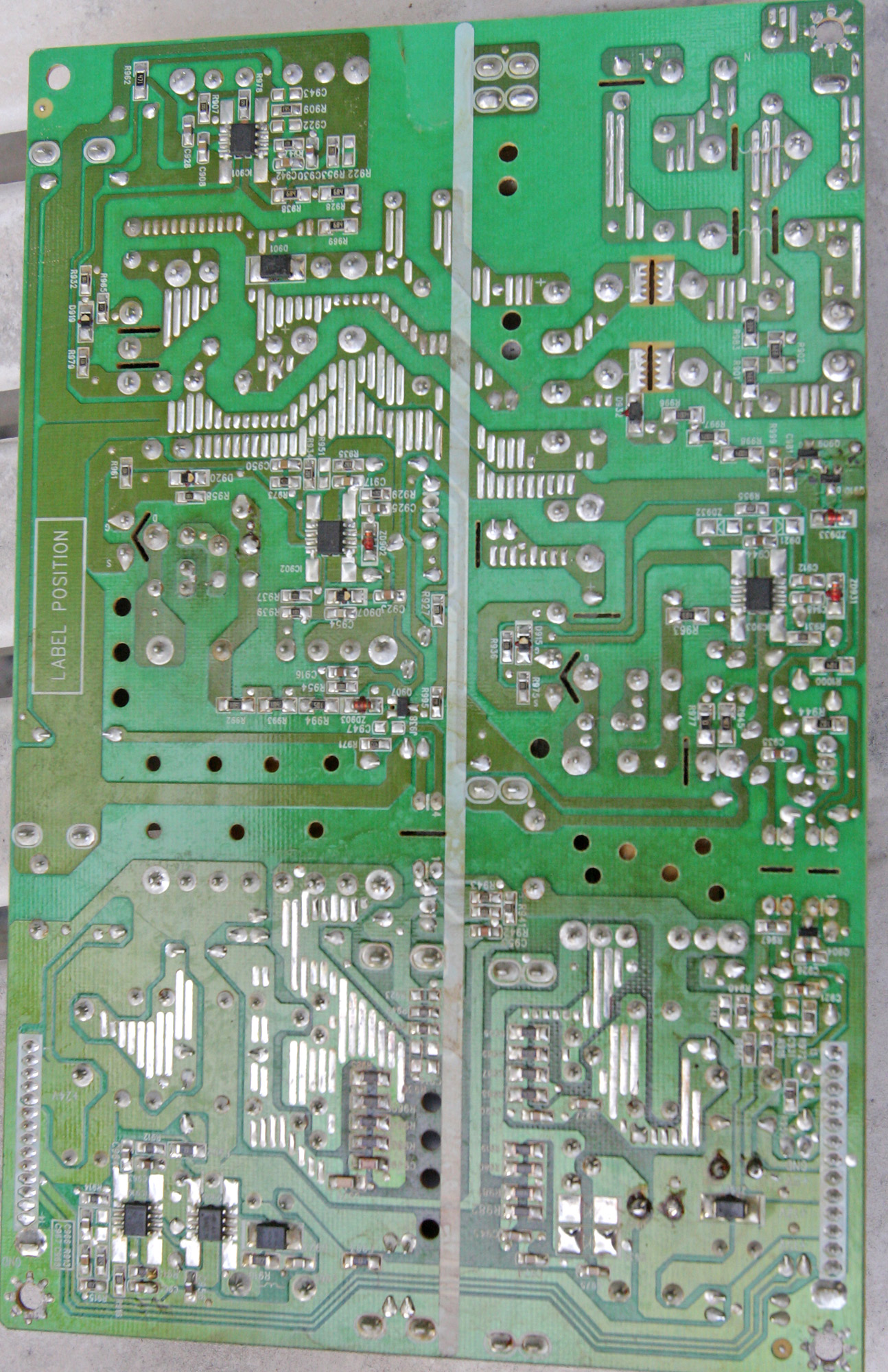

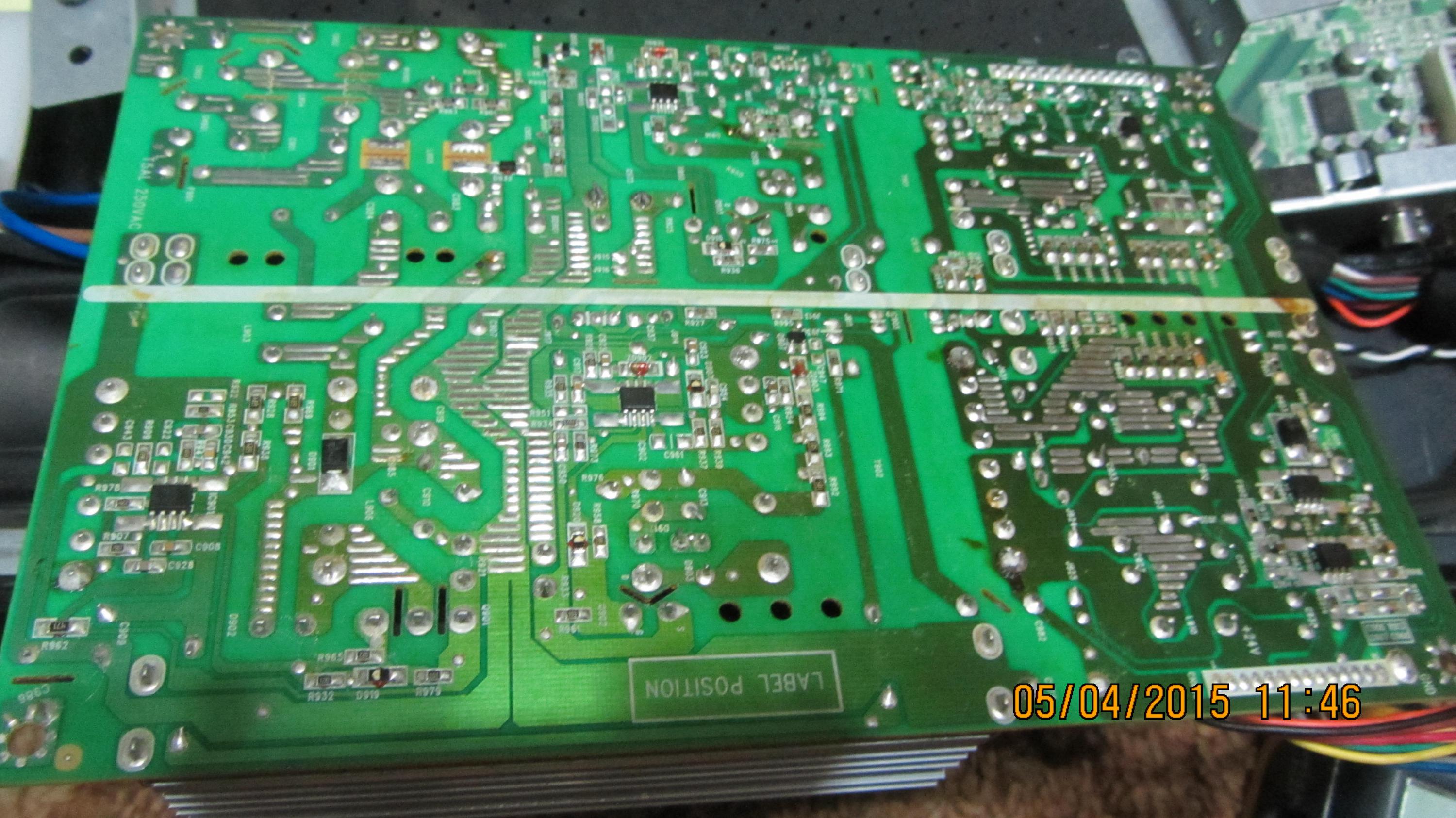

                                bottom of board
                                I will look into the PFC chip on the hot side

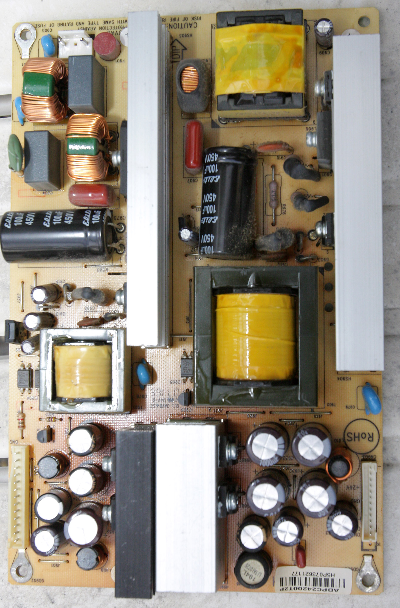

                                  IC 901 (bottom left) is the PFC IC, need P/N as printed on top of the IC.
                                  You need to check PFC Diodes D901 (SMD diode), D902 (mounted on the heatsink).
                                  https://www.badcaps.net/forum/attach...1&d=1430872945
                                  • infringer
                                    Badcaps Member
                                    • Sep 2009
                                    • 244

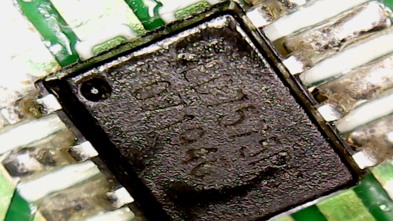

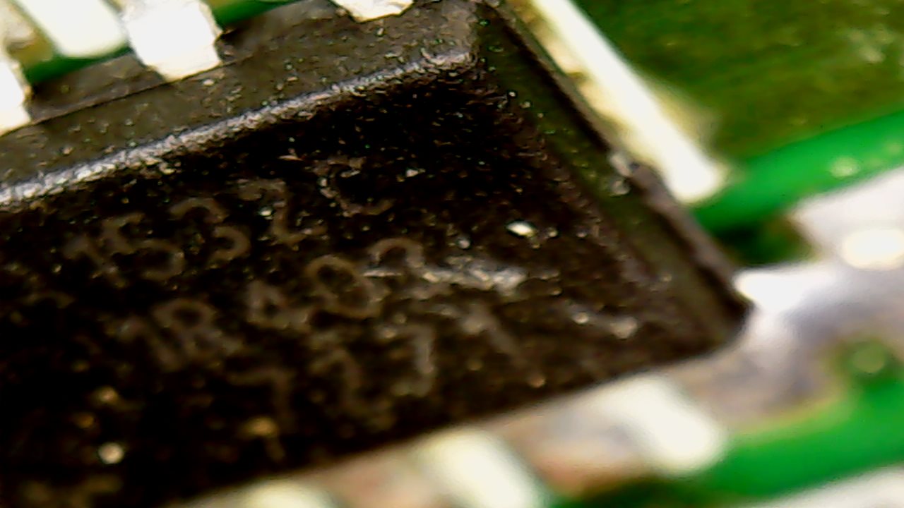

                                    Q903 on the side where the ac comes in on the board with the FBR is IC903 056T 379 61 IC LD7575PS SOP-8 LEADTREND
                                    The side labled hot on my board is IC902 and this would be IC902 056T 564911 1 IC TEA1532CT SO-8
                                    After close inspection the uploaded Manual and using the digital microscope I was able to make these two IC's out somewhat and fill in the blanks that the manual was correct on the numbering of the IC's
                                    I will have to go looking for the datasheets but I have a power supply that is similar like this one and one of these is blown right off the board rather interesting to say the least ... And it is IC903 on that board as well...
                                    • infringer
                                      Badcaps Member
                                      • Sep 2009
                                      • 244
                                      Errr sorry did not see your post in time was trying to number things out!
                                      Let me give them a look.
                                      UPDATE this one matches the service manual as well.
                                      IC901 056T 368 12 IC FAN7529MX SOP-8
                                      Pin 8 vcc it appears
                                      VCC = 14V and TA = -40°C~125°C unless otherwise specified
                                      UPDATE:
                                      D901 and D902 pass diode test.
                                      Trying to devise a way to have everything hooked up and upside down and check the voltage to that pin when powered on.
                                      Start voltages is 11-13v it seems though according to the sheet.
                                        So you are getting 14VDC for the VCC on pin 8, then that is OK.
                                        If d901 is shorted then there will be no boosted Voltage, but the Diode is OK per your test.
                                        Check and see if the Source resistor R921 is OK for the PFC MOSFET Q901, it should be <1 Ohm.
                                        Also check the resistance between pin 7 Gate drive and the Ground pin 6 to see what you have.
