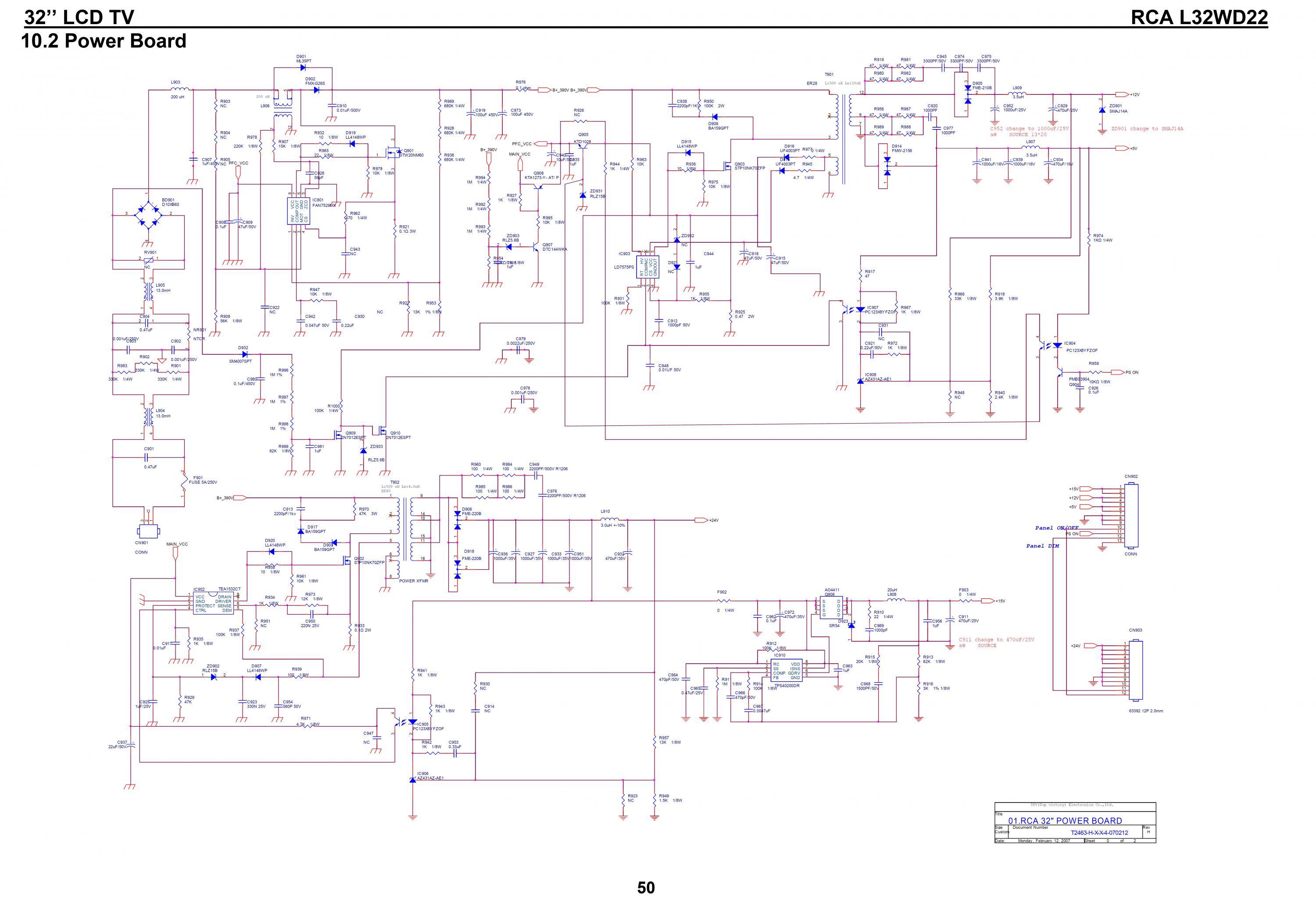

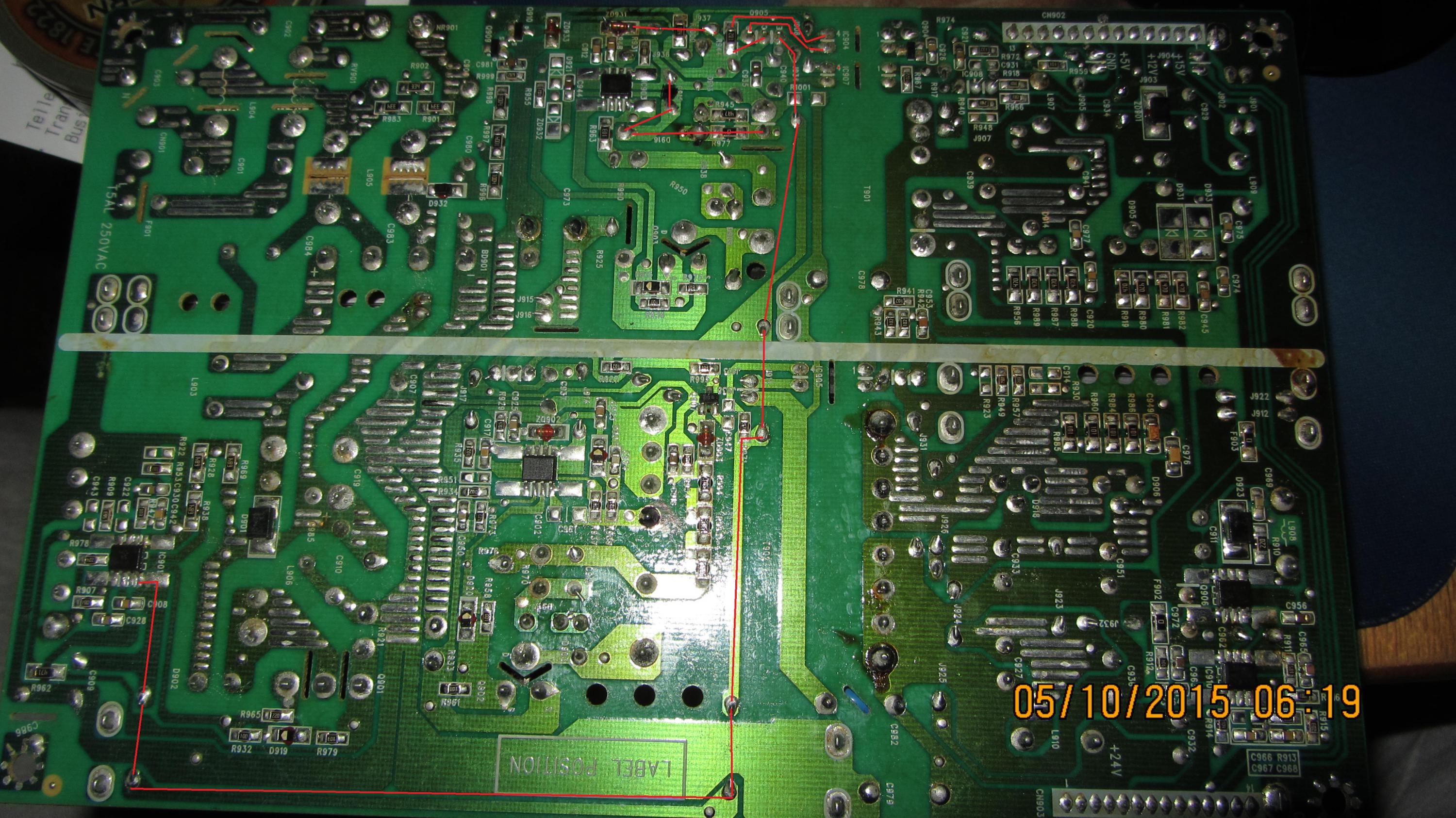

                As far as a schematic ... I believe I posted a schematic of everything a full service manual ... But to make it a bit easier to follow I took the liberty to snap a high resolution picture of the power board schematic hope this helps! Connection 901 three pin is the ac in from the outlet Maybe this will help tremendously on your end now I can see what stuff is a bit easier too! I'm going to follow the schematic a bit.

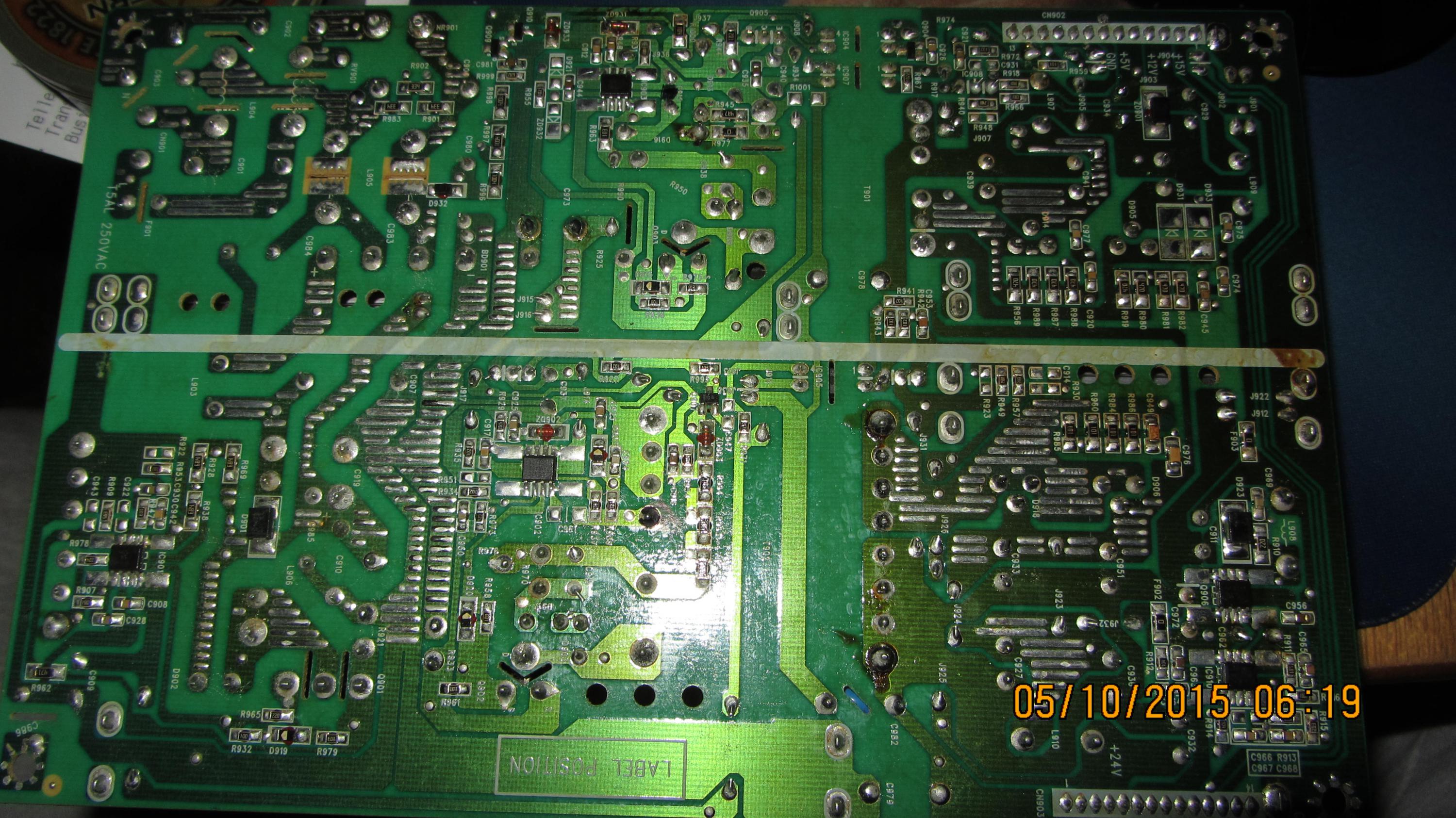

                Before that looking at the board I seen jumpers that basically took pin 8 to an emitter pin on a transistor on the other side of the board checked that transistor and checked out good infinity one way and .577 the other on collector and emitter when checking against the base if I remember correctly a diode test with .600 or there about is a good baseline for testing transistors in circuit well I am going to look and see if I traced it out right by eye although I cant really see how it would be wrong but I guess stranger things have happened with trying to find this stuff.
                Please note: I am not responsible for any harm caused to you anything discussed is just discussion. Before you try anything discussed be sure that you have the appropriate knowledge and safety gear for the job. Like with anything education and safety are first! Do not try anything @ home without it.

                  According to the schematic it is correct Q905 would be the transistor
                  hrmmm d916 checks out as well coming off the T901 Pin 5 so I assume I should check pin 5 and pin 7 and see what voltage I get off the secondary winding there possibly not sure on what I am supposed to get there actually?

                    #29
                    Re: RCA L32WD22 No 15v No 24v no backlight
                    OK, sorry I completely missed the service manual you proided.
                    Do not try to use the scope to take any measurement in primary (hot side) unless you have isolation transformer to power the TV.
                    This is how the PFC IC get its 'PFC_VCC' on pin 8 of the PFC IC:
                    When PS-ON is applied, the PS-ON will turn on Q904 which in turn will turn on the LED inside the OPTO IC904, the PHOTOTRANSISTOR inside the OPTO is then turned on, this will provide the bias current through R944 (1K Ohms) to bias on the linear regulator transistor Q905, the 15V Zener diode ZD931 is to maintain 14.4VDC output at the Emitter of Q905, the Input Voltage feeding the Collector is from the AUX winding of the standby power transformer T901 which is rectified and filter by D916, C915.
                    So verify that the resistor R977 feedng the D916 is OK.
                    Verify that you have around 20VDC between the two legs of C915.
                    Verify that 15V Zener diode ZD931 does not show conduction in both direction.
                    Verify the Voltage between the two leg of Zener ZD931 is around 15VDC.
                    Verify that Q805 is good.

                                hrmmm interesting the zenner is reading 0.00 both ways on the meter on a diode test I would say it is likely toast IDK.
                                Tried diode test and low ohms setting... Sheesh I don't know I checked and double checked the dang thing with two meters dunno how that got mixed up unless I just checked one way both times IDK what happened originally...
                                Well I have another one on a parts board that checks out good with the same color bands it is from an insignia 26" tv should be the right zd I would say got to go to bed though its like 4AM here running on fumes. Tomorrow I wake up and do some smd work although it is killing me I'd like to do it now lol I am aware that it could be possibly the wrong ZD dunno what that would do but I'm going to try it it is free. It is the same color as these http://www.ebay.com/itm/RLZ15B-15V-4...item43ce9e0b88
                                15bux for a few diodes get out of here I say! I'll just try it if I blow up the board I'll buy a new one lol gotta take a risk unless there is some way to test it bench power supply 0-30v available?
                                I will orientate it the same way and hope that it works correctly and if it does well hopefully that solves the problem! Amazing though you must have really dug in deep on a lot of LCD power boards to pick all this stuff out so quickly.
                                  Not 100% positive on the diode if it is correct but the color bands are the same and it came off of a smps that uses nearly the same electronics an insignia 26" lcd tv position R390 I am having trouble locating the service manual for that one.
                                  PSON Pin 11 is 3.5v when switch is turned on to green status light. Double checked that.
                                  This thing is a bit of a whale to tackle but I am not giving up quite yet.

                                    Just use variable power supply and 1K resistor is series with the Zener, you know how Zener works, right? look it up.
                                    Like I said and as shown in the diagram, you have 20V source feeding the 1K resistor and another end of the resistor is fed through one leg of the opto, another leg of the opto is then feed the 15V Zener diode.
                                    using unknown diode will cause more confusionnsine you have to verify if it is Diode or Zener diode with correct Voltage.
                                    There is not much in that 15V regulator circuit and you had already verify that the transistor and the PFC IC are not bad/shorted out per your testing which I am going by based on your reports.
                                    May be at this point you should by new board instead.

                                      I guess I am having confusion matching the schematic to the board I am still not seeing how the circuit works entirely so I need to upload the pictures of what I have traced out maybe you can help me here I am curious on how it is traced out I suppose it is possible that the schematic could be different if the model power supply does not match I am not entirely sure but just to be sure maybe you could help me trace this out further?
                                      Also is there somewhere I can test previous to the zener diode to be sure I am getting correct voltage like possible at the resistor for instance? Where would I put my probes as I assume there is supply voltage like you say of 20v on the bottom side of the R944 resistor however when I test for it I am not seeing that so it must be where I am putting my probes I suppose might be a dumb question at this point I am dumbfounded on how the 20v gets to that point.

                                        C915 Negative leg will be where you put your black probe GND ref for you meter for Voltage measurement of the Zener, the Collector, the Base, the Emitter of the Q905.
                                        Just trace out to see if the positive leg of the C915 goes to the Collector and if you do have 20V at the Collector.
                                        It is just a matter of looking at the schematic and look at the trace and use Ohm meter to see what goes between point A and point B.

                                          odd I get all low voltages through the whole thing putting the black probe to the negative
                                          But I will note when I put the positive lead on the positive end of the cap and check the zener diode it is correct (looking at the photo I uploaded before) 20v on the right side and 14v on the left side so I think it is safe to say that the diode is an exact match and I checked pin 8 like this as well and it displayed 14v dc as well so the zenner has to be good it is somewhere somehow the voltage from the cap is not making it beyond the capacitor I don't understand what the heck would do this but I have learned a bit from this board thanks to you do you have a dogecoin wallet I'd gladly tip you for the help!
                                          Still working at it but I have a full time job to attend I actually work with electronics for a living normally I can figure stuff out fairly well but getting down to the dirt of it all would be nice beyond board or part swapper.
                                          Just got to figure out why there is no voltage beyond the cap really just all really low readings less than 1v... on everything you mentioned the zenner the collector the base and the emitter like .4v - .7v dc while I still do have 20v on the cap beyond the capacitor there is nothing it is just odd to me this is why I have been thinking of a way to test beyond it.
                                          Hrmmm possibly a dry solder joint on the cap itself I think I will run a continuity check tomorrow and see what I can find gotta wake up in a few hours!
                                          Thanks again it is a work in progress at least the zener is correct I know that much.
